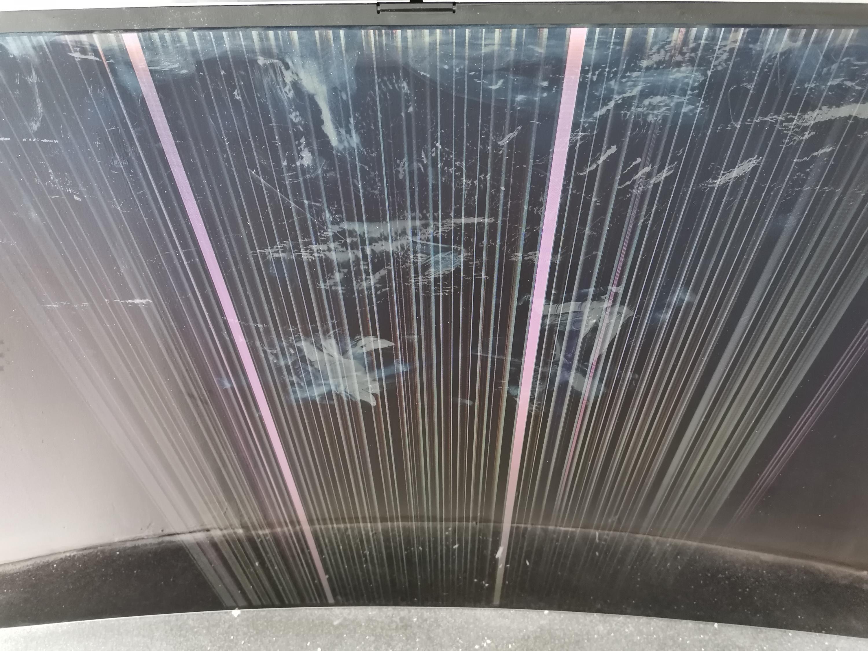

    Hi, yesterday I've got a UE65KS9000 which has some lining on bottom of the screen, and reboots itself every 20 seconds or so. Seems like it gets worse with time, i.e. first boot just the bottom of the screen is wrong, then over time and over restarts it gets worse.
    I've tried the cut tape method on both motherboard-to-panel ribbon tapes as well as both U-shaped tapes on the panel. If the panel woke up the lining was always there, so I guess I wasn't lucky enough with taping.
    Not really sure how to progress, there are no typical test points on the boards. No idea why one of them is blue. See pics attached. Any ideas what to look for or which pins to block appreciated.
    Thanks in advance fir your time and patience

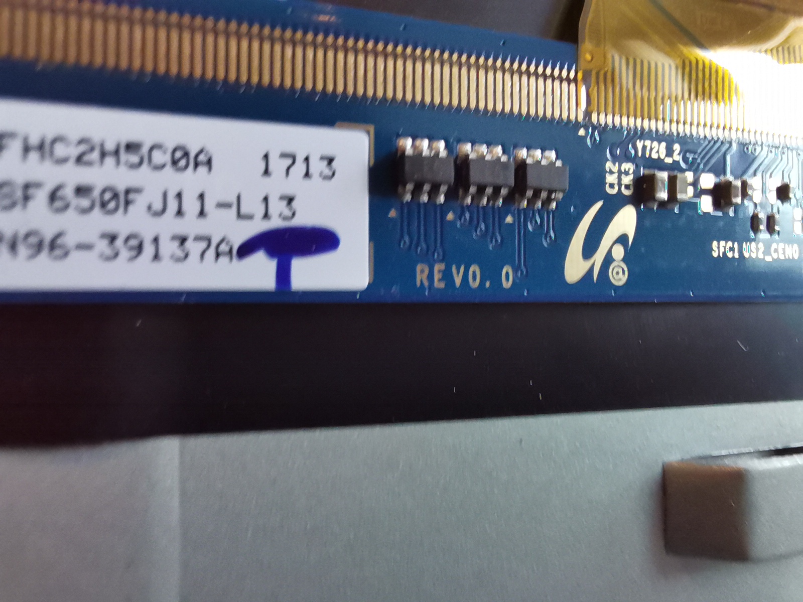

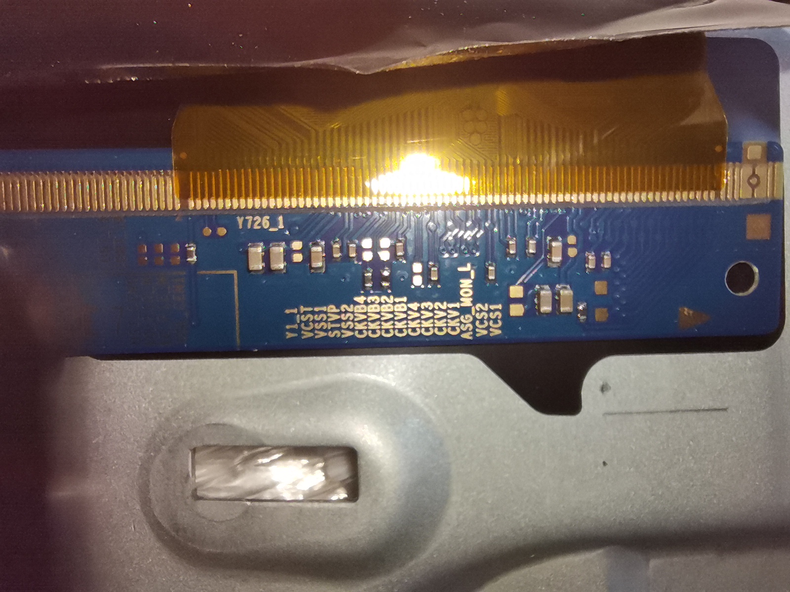

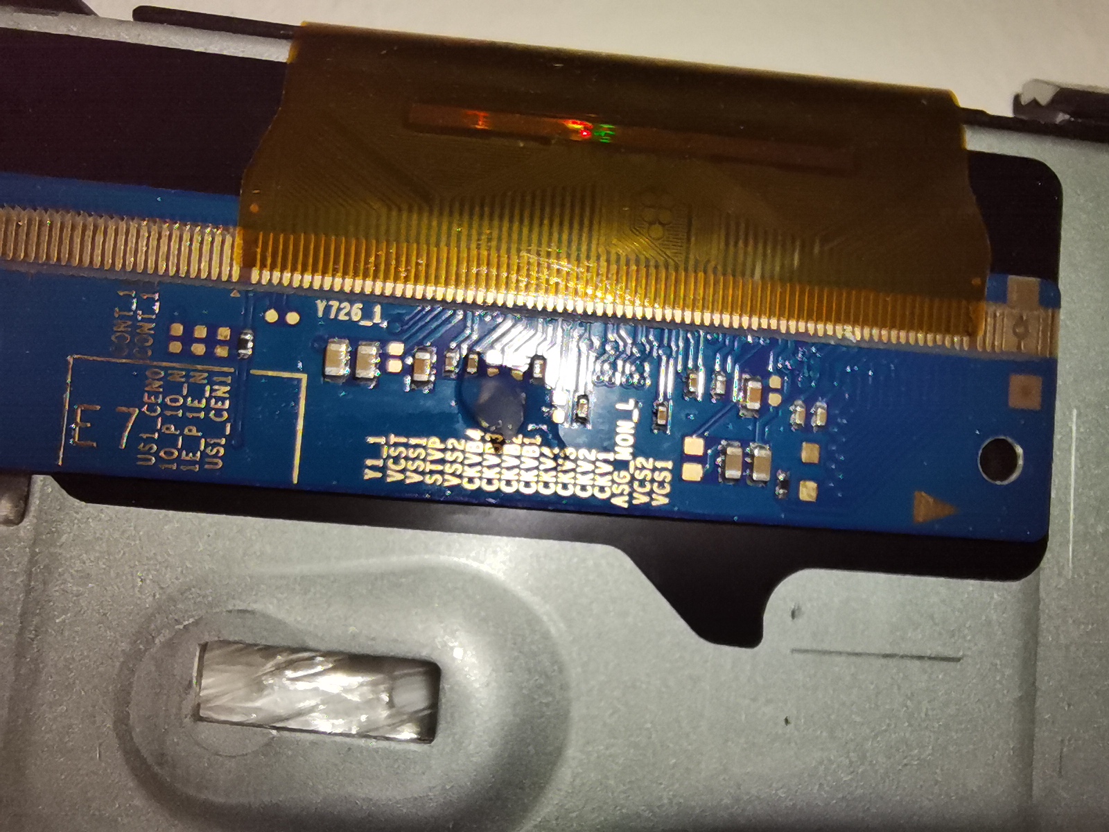

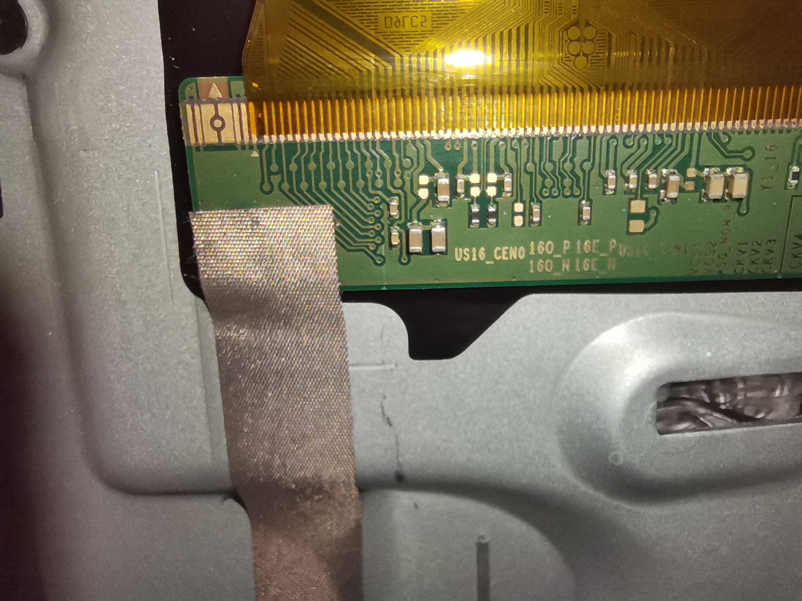

                I have measured every single cap and resistor on the TV panel boards, everything seems okay there. There are a couple of bigger elements I am not entirely sure how to properly test.
                Found a service manual for this model. Tried tape method again, covering all CKVx and CKVBx pins, but again no joy. Checked PSU voltages, not sure if I should be reading almost 4v from fail_count. I've been looking around mainboard as well, trying to find anything wrong, but everythink looks and measures okay.
                Attached pics of the smd's I'd like to test.

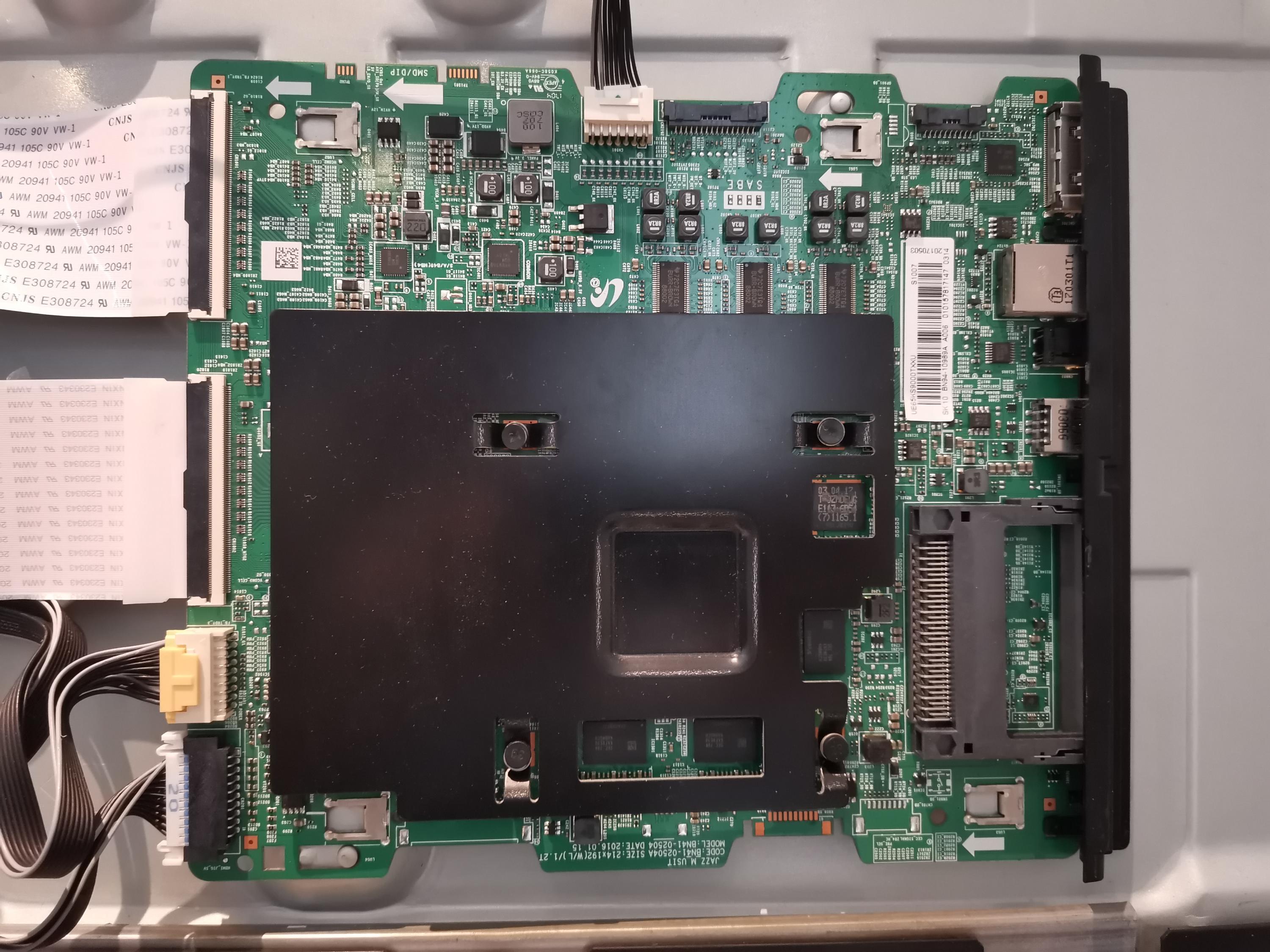

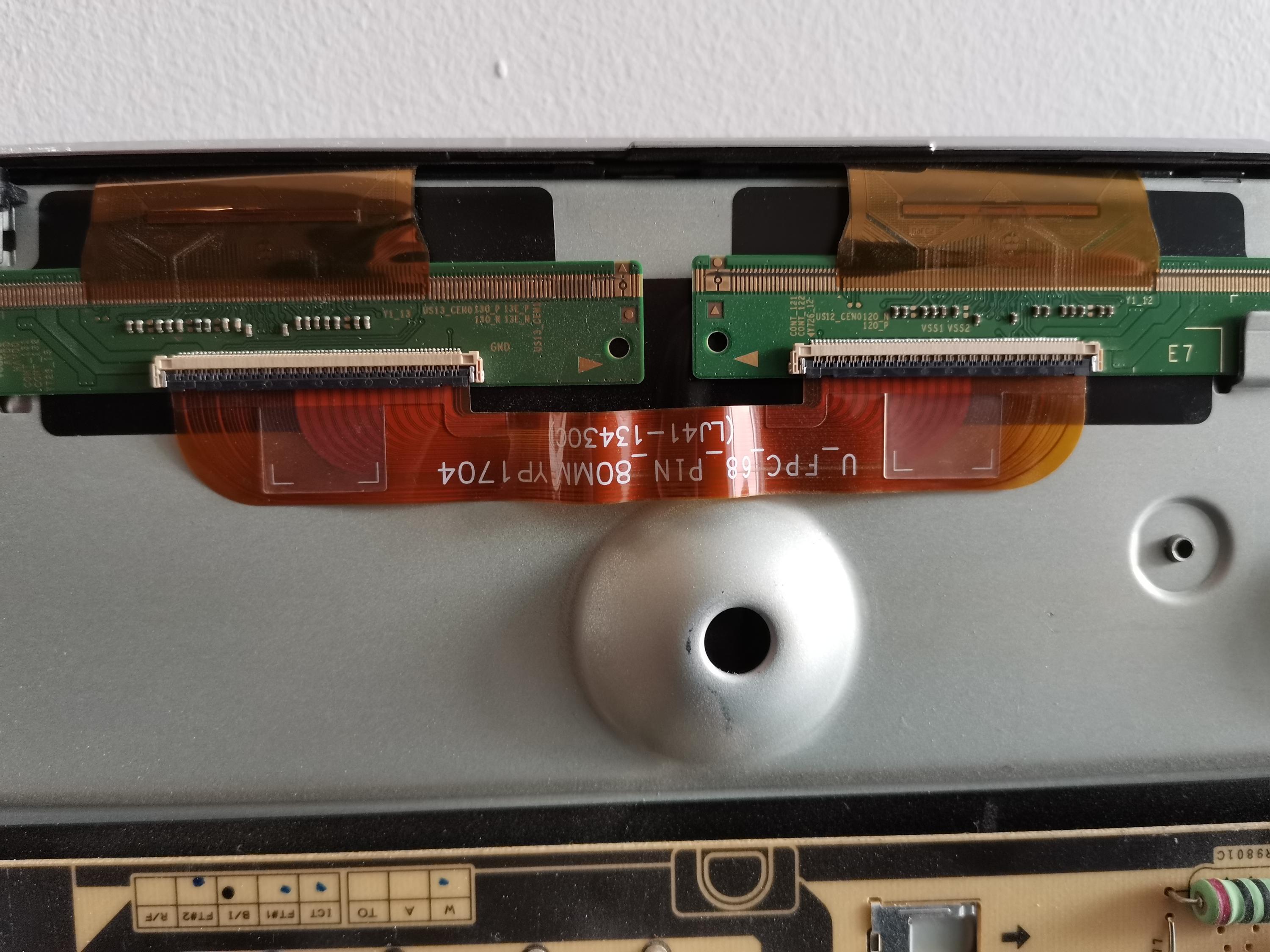

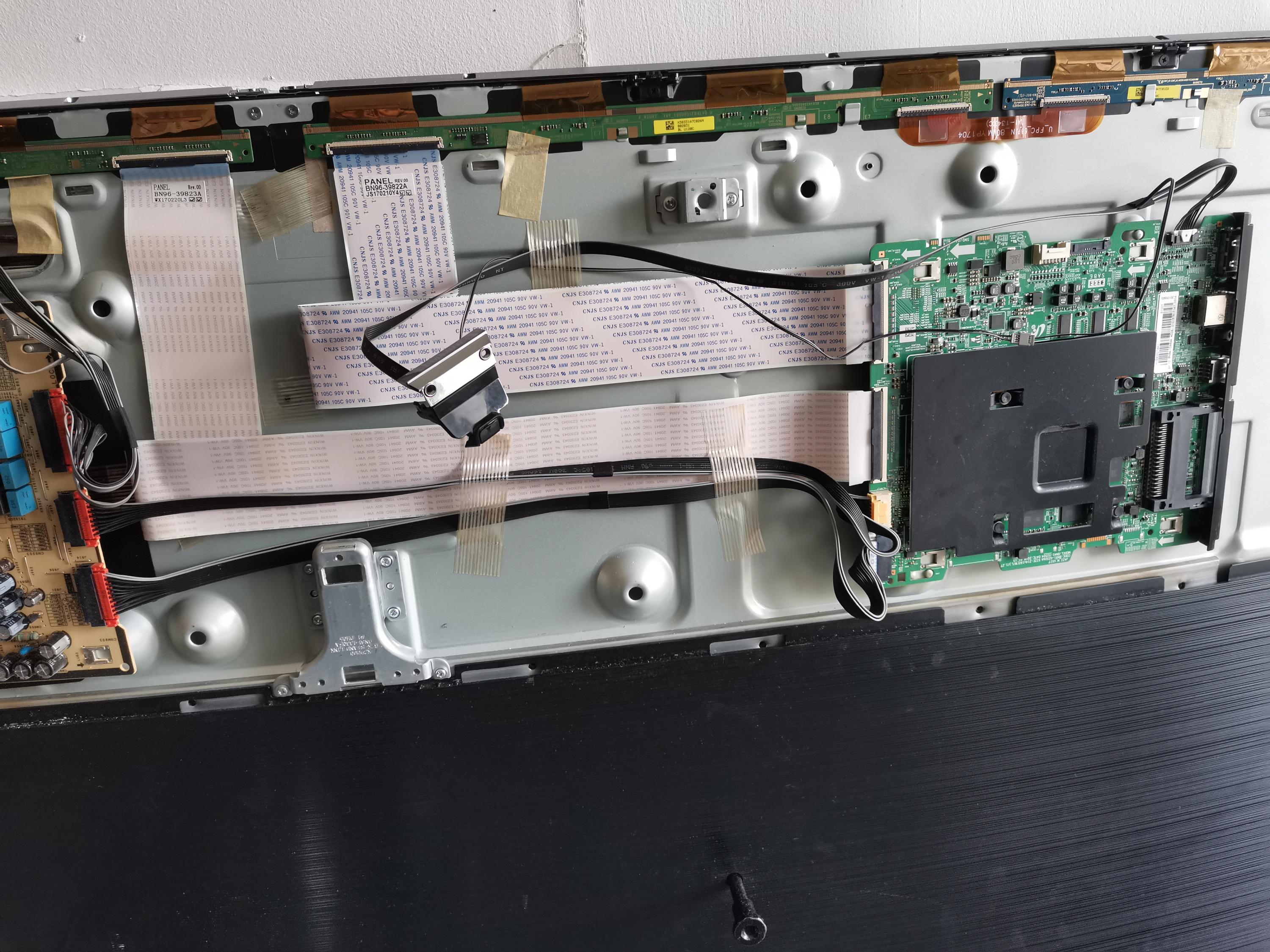

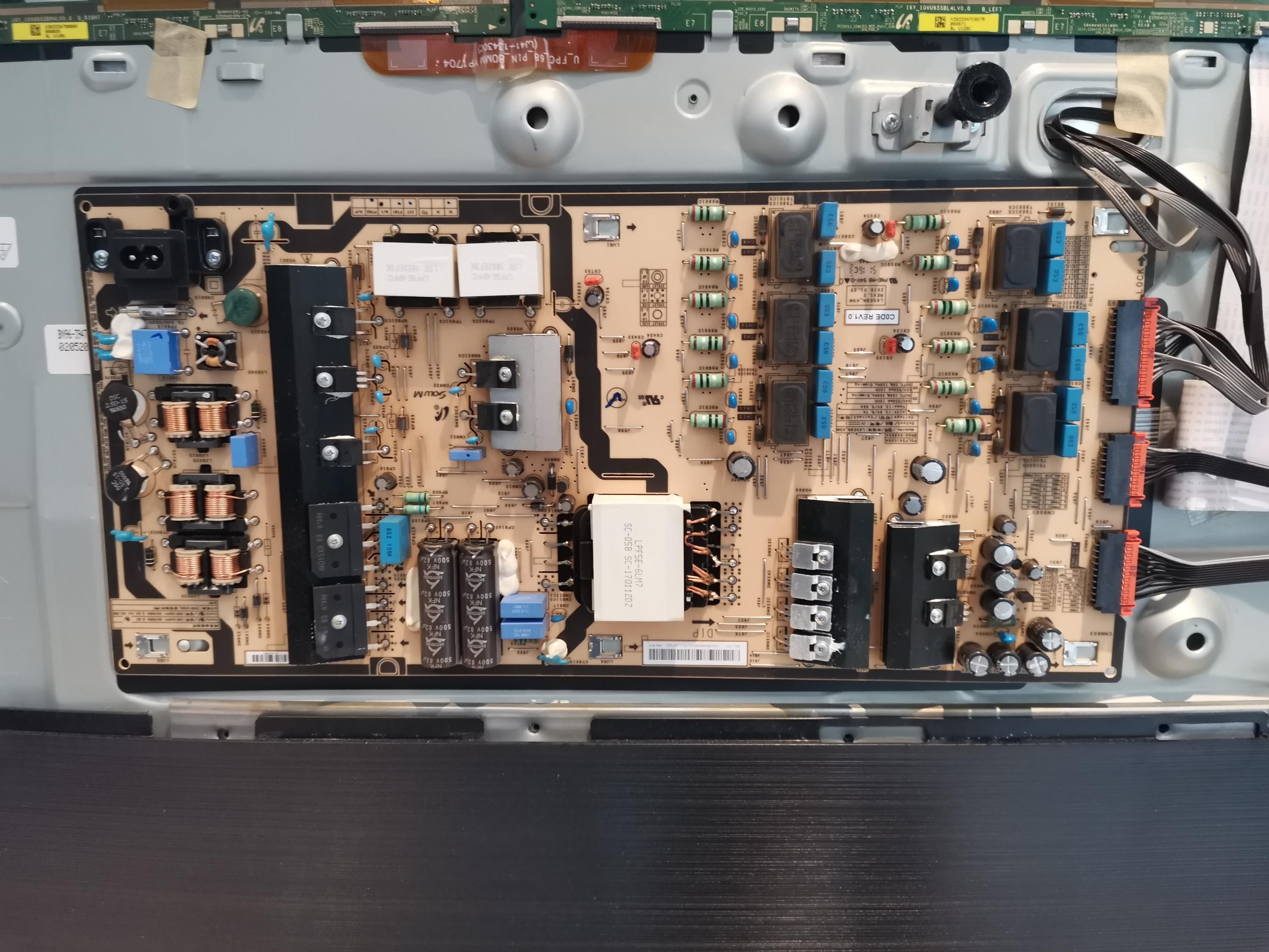

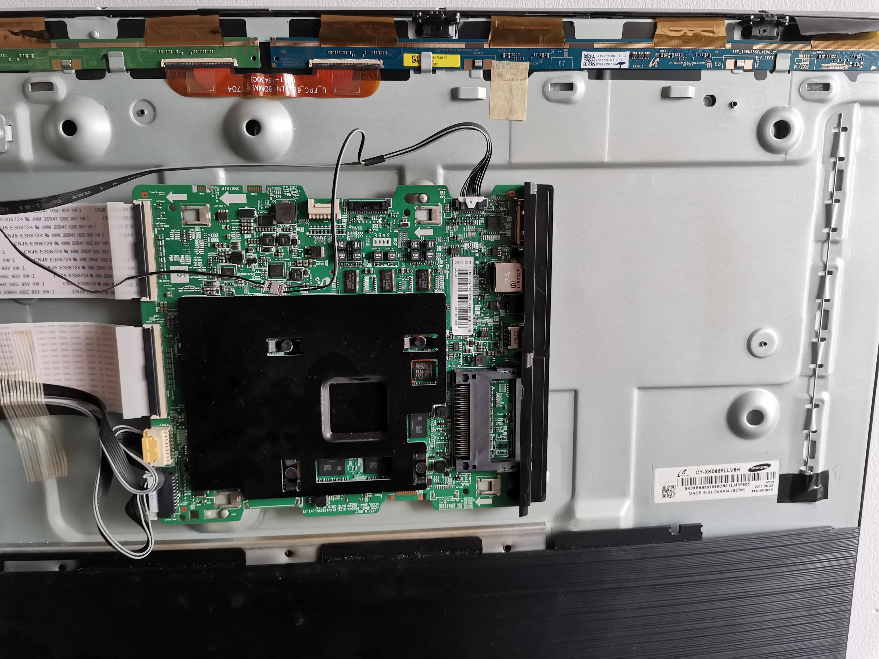

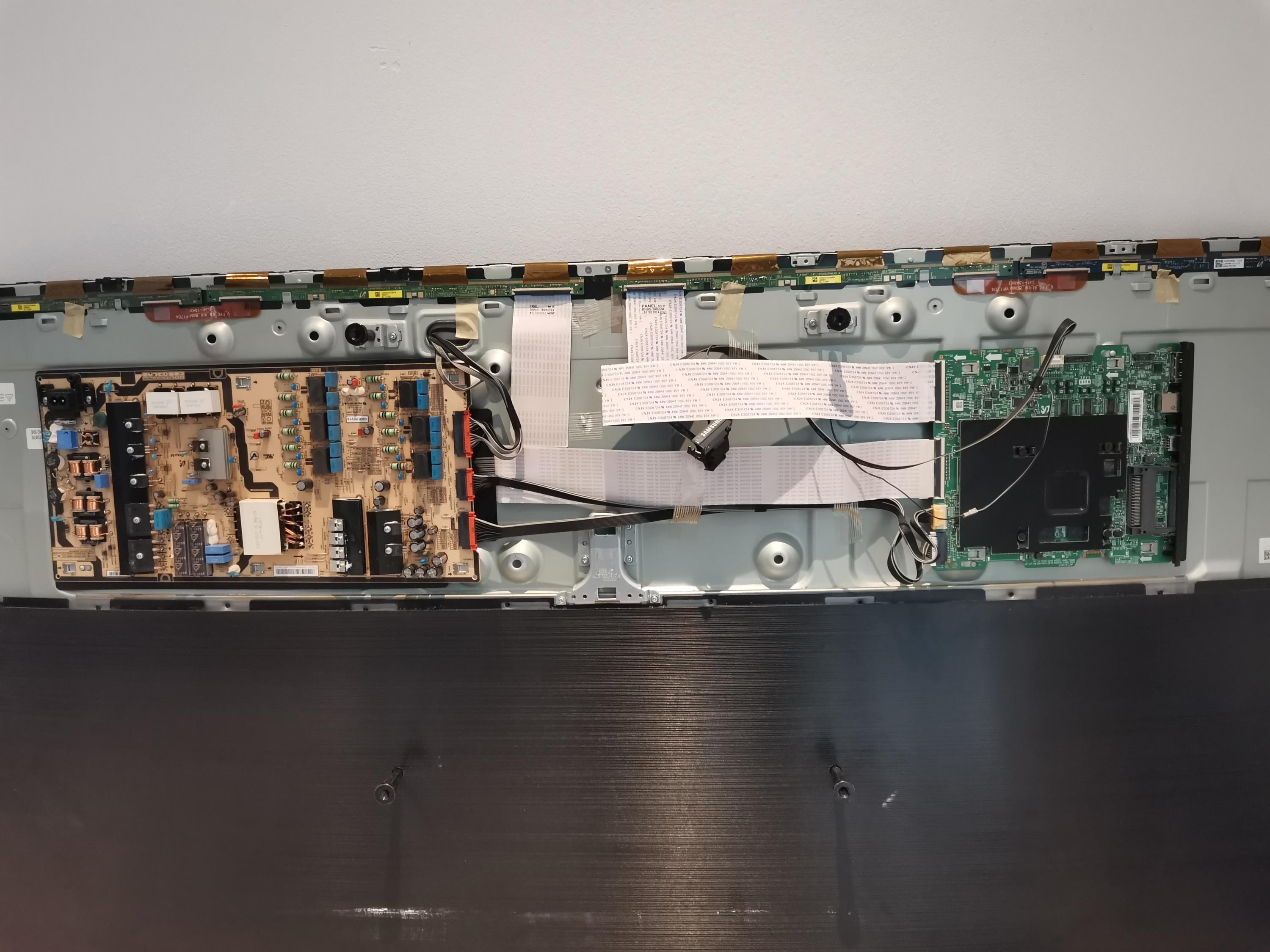

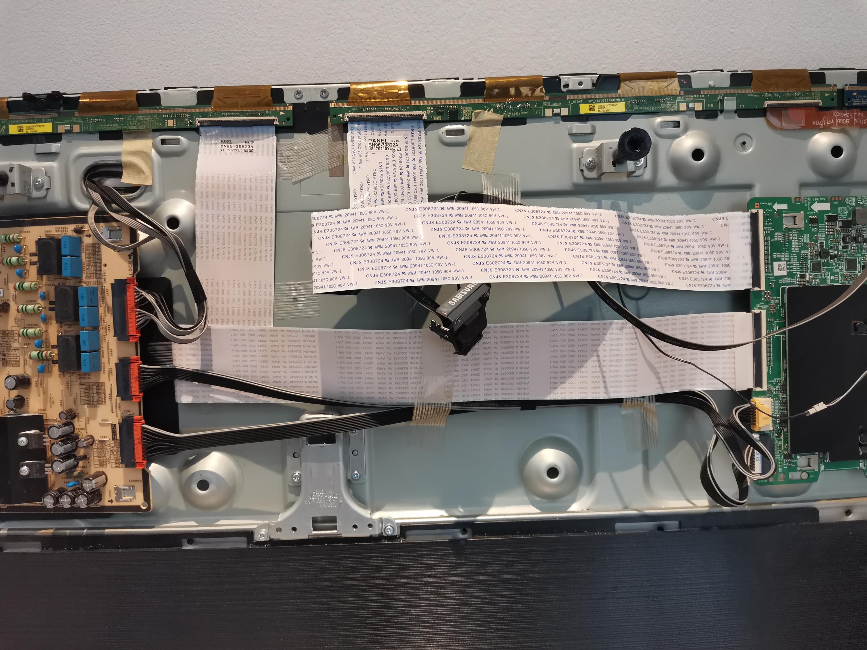

                              Re: Samsung UE65KS9000 lines and reboot loop
                              maybe post some pictures of each board and one of the whole back as to see how everything is connected.
                              • mrsith
                                • Mar 2021
                                • 146
                                • Wielka Brytania
                                Pictures attached. The backlight comes and stays on allright, the rebooting happens only with mainboard connected.
                                I have also included service manual for this TV, just in case it may help you help me

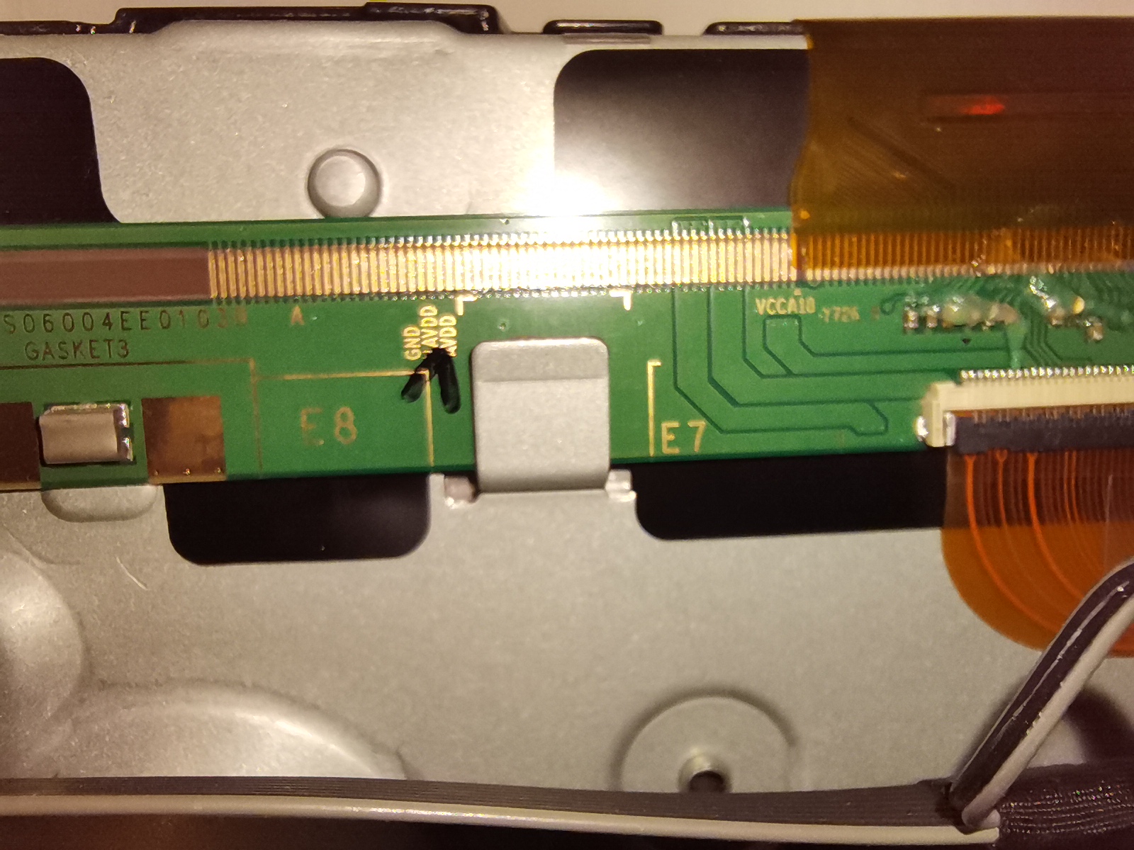

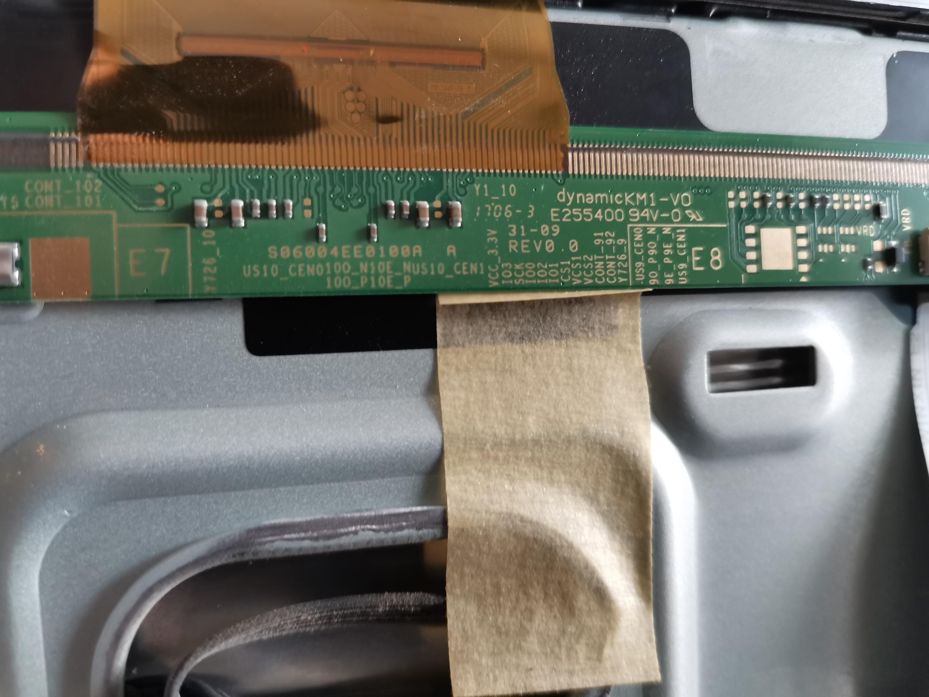

                                    I have actually seen this thread, the thing is - as stated earlier - this TVs panel board doesn't seem to have any testpoints, not sure how to measure/diagnose it and thus where to solder the wire.
                                    What if I'd found the VGH pin using the service manual and measure it from there? Then I could maybe solder the wire directly to that pin on the connector of the panel board. Not really sure which resistor should I desolder to put a wire from there
                                    • mrsith
                                      • Mar 2021
                                      • 146
                                      • Wielka Brytania
                                      The word 'VGH' doesn't appear in the service manual even once. No pin is labeled this way. Nothing on panel board is labeled like that.
                                      Please see pics attached. There are key voltages marked on the boards (AVDD etc), but they don't seem to be related to any particular point. Where ahoukd I check the voltages then?
                                      Apologies for some flux left on the photos :p
                                      edit: after carefully inspecting linked thread, I see that the VGH won't probably be listed in the manual. Seems like the pinout is the same though, so I'll take a look what pin 84 shows and take it from there. Will post update soon.
                                      • mrsith
                                        • Mar 2021
                                        • 146
                                        • Wielka Brytania
                                        If I calculated the pins right, the VGH voltage shows -0.25v when the TV is on, jumping briefly to ~0.5v while it restarts. Even if I messed up and measured wrong side connector and thus wrong pin (not really possible as used CN number as a reference), the corresponding pin on the other side would be VCCA_1.9V_PW, which still isn't -0.25v.
