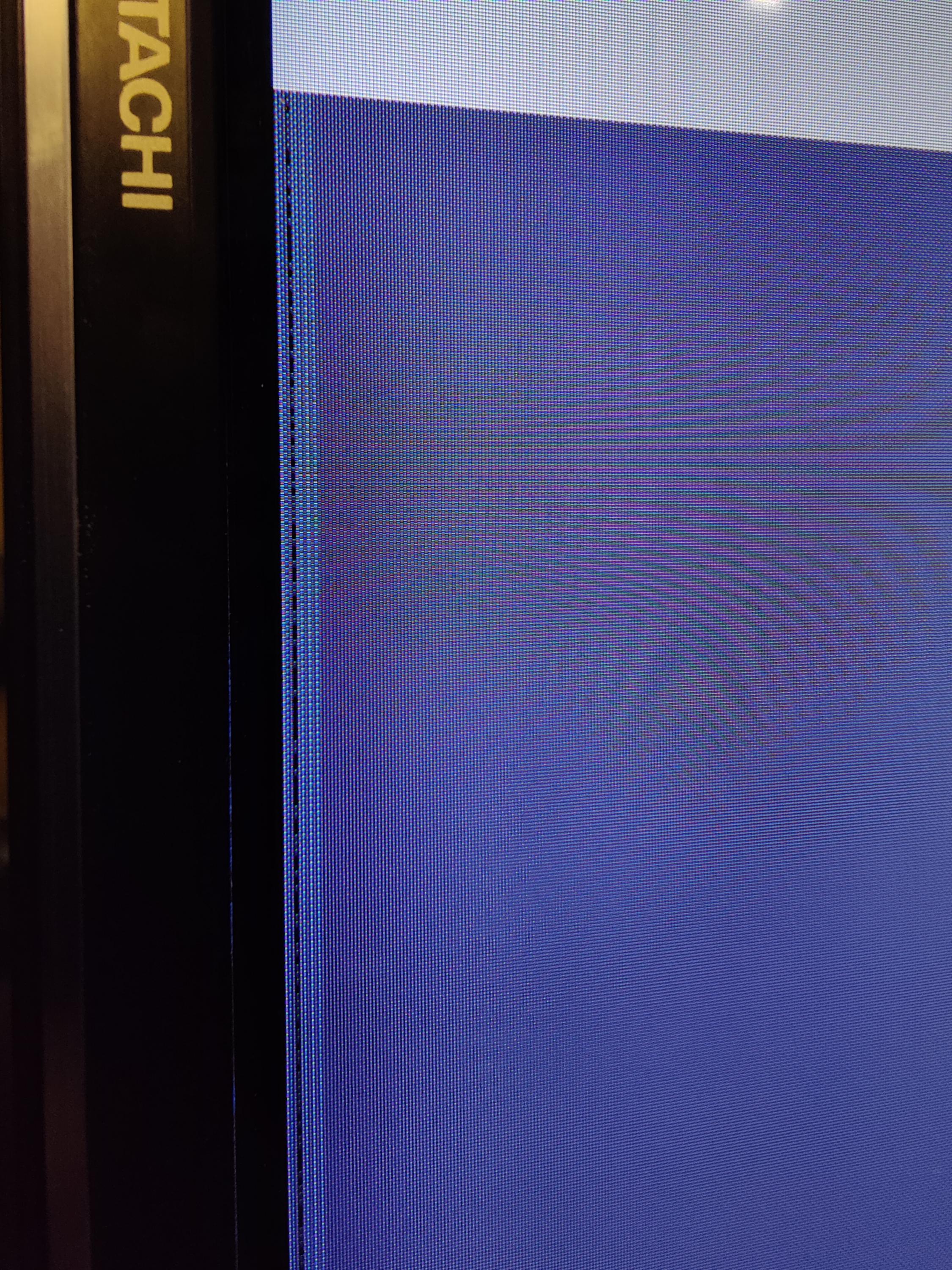

    I have picked up a Hitachi 58HK6100U smart TV with a black/blue screen issue.
    It's a vestel unit, using the MB230.
    Visual inspection shows no obvious issues with caps, and diodes on PSU all look reasonable. I've not been able to check voltages, as I haven't spotted a schematic that matches the power supply, a 17ips72.
    I've confirmed that the set boots successfully, albeit without picture. If I disconnect either the left or right ribbon cables, I get picture on the other side.
    I noted a few bad lines at the bottom on the right hand side of the screen, picture attached. This may have occurred during collection, so might not be related to the original fault.
    Can anyone point me in the right direction as to where to look next?

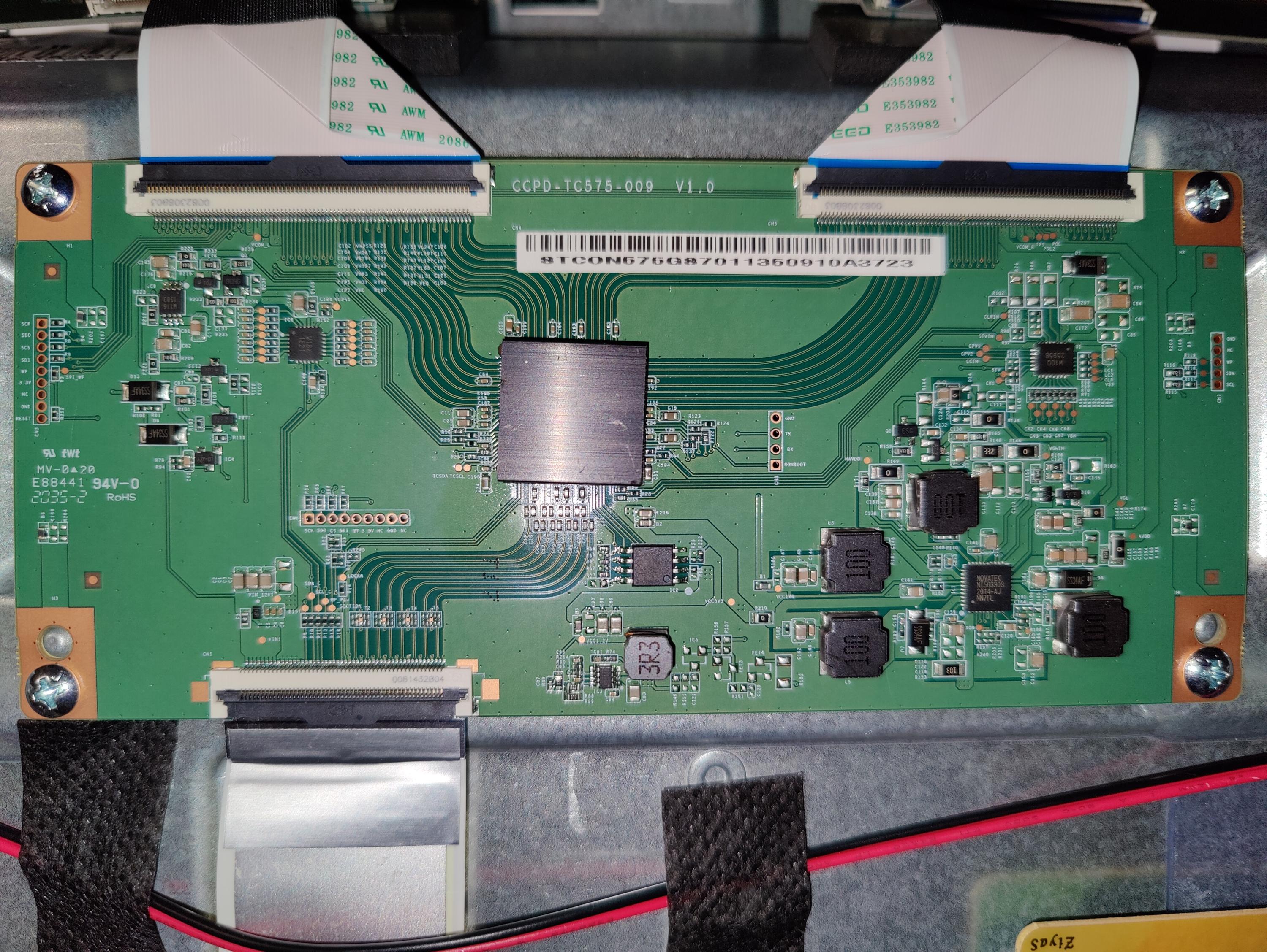

            Need good pictures of t-con.
            • mace
              • Aug 2015
              • 10
              • Scotland
              Re: Hitachi 58HK6100U black (blue tinge) screen
              Photo of tcon as requested. Let me know if you need any close ups?

                You have vgh, vgl, vcom, vcc test points
                • mace
                  • Aug 2015
                  • 10
                  • Scotland
                  Thanks dskall,
                  Following measurements are with both halves of the screen connected to the t-con:
                  vin1: 12.1v
                  vin_12v1: 12.1v
                  vcc3v3: 3.28v
                  vcc1v8: 1.7v
                  vcc1.2v: 1.18v
                  vcom_l/r: started higher, slowly dropping, measured at 380mV after about 5 seconds.
                  vgl: 157mV
                  vgr: 18mV
                  Repeated measurements with either left or right hand ribbons disconnected:
                  vcom_l/r: 7.14v
                  vgl: -6.08v
                  vgr: 24.7v

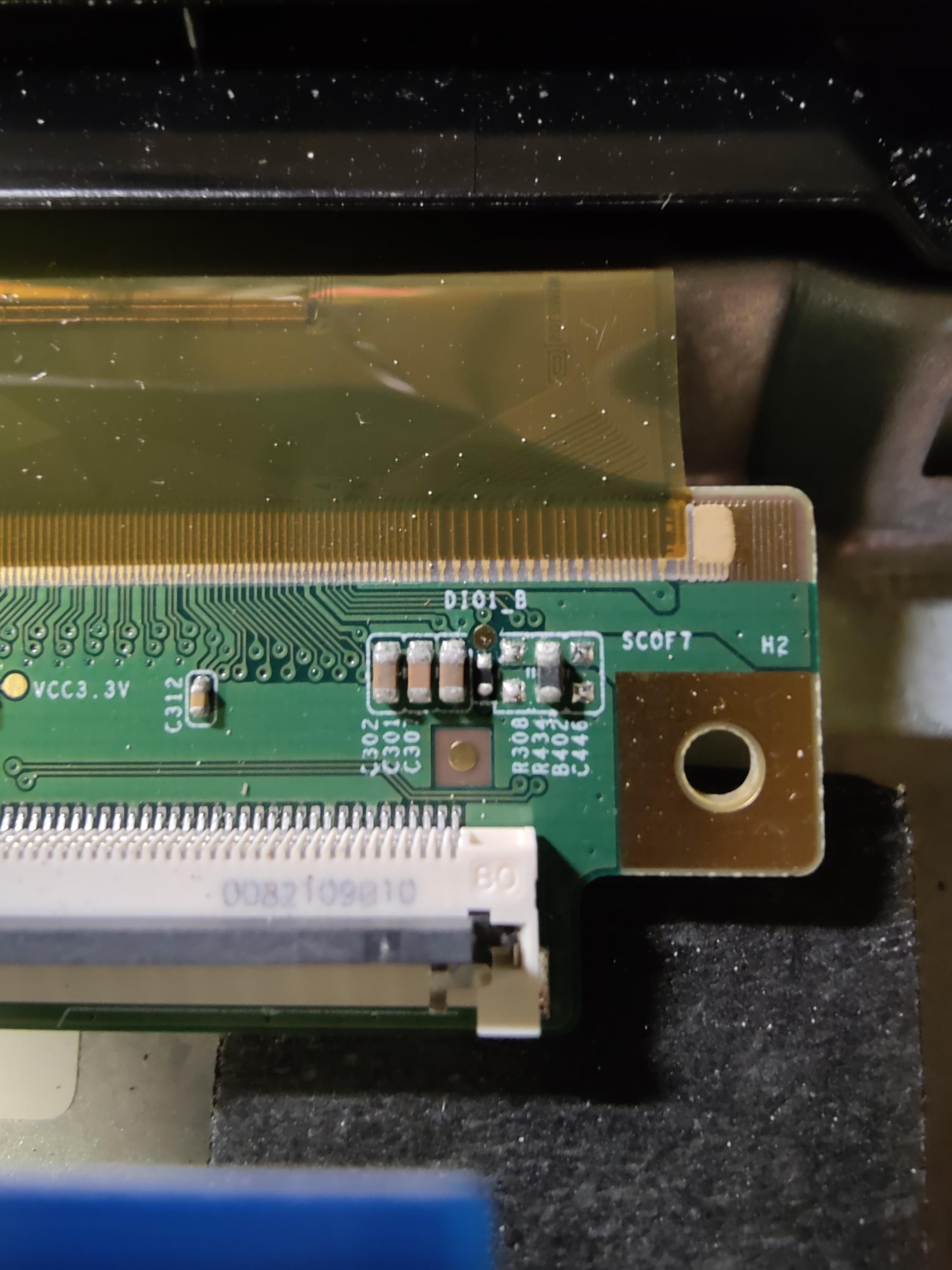

                        The only short to ground I've spotted so far was across B402, is that a bridging link?
                        • nomoresonys
                          • Jan 2013
                          • 12156
                          • U.S.
                          probably is, it's not a cap.

                            • mace
                              • Aug 2015
                              • 10
                              • Scotland
                              Took it off, and lost ground to quite a lot of the bypass caps, so looks like B is bridging link on these boards (for anyone that comes across this thread in the future).
