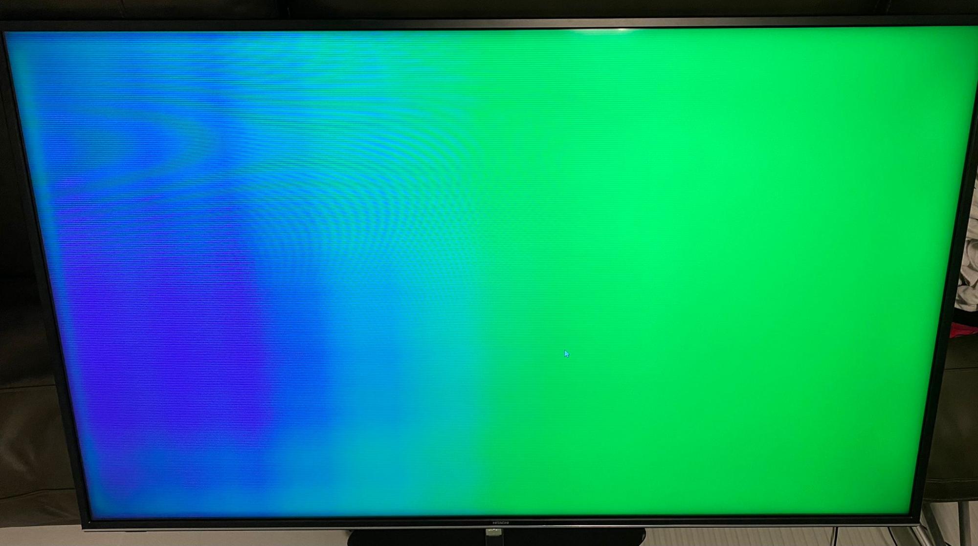

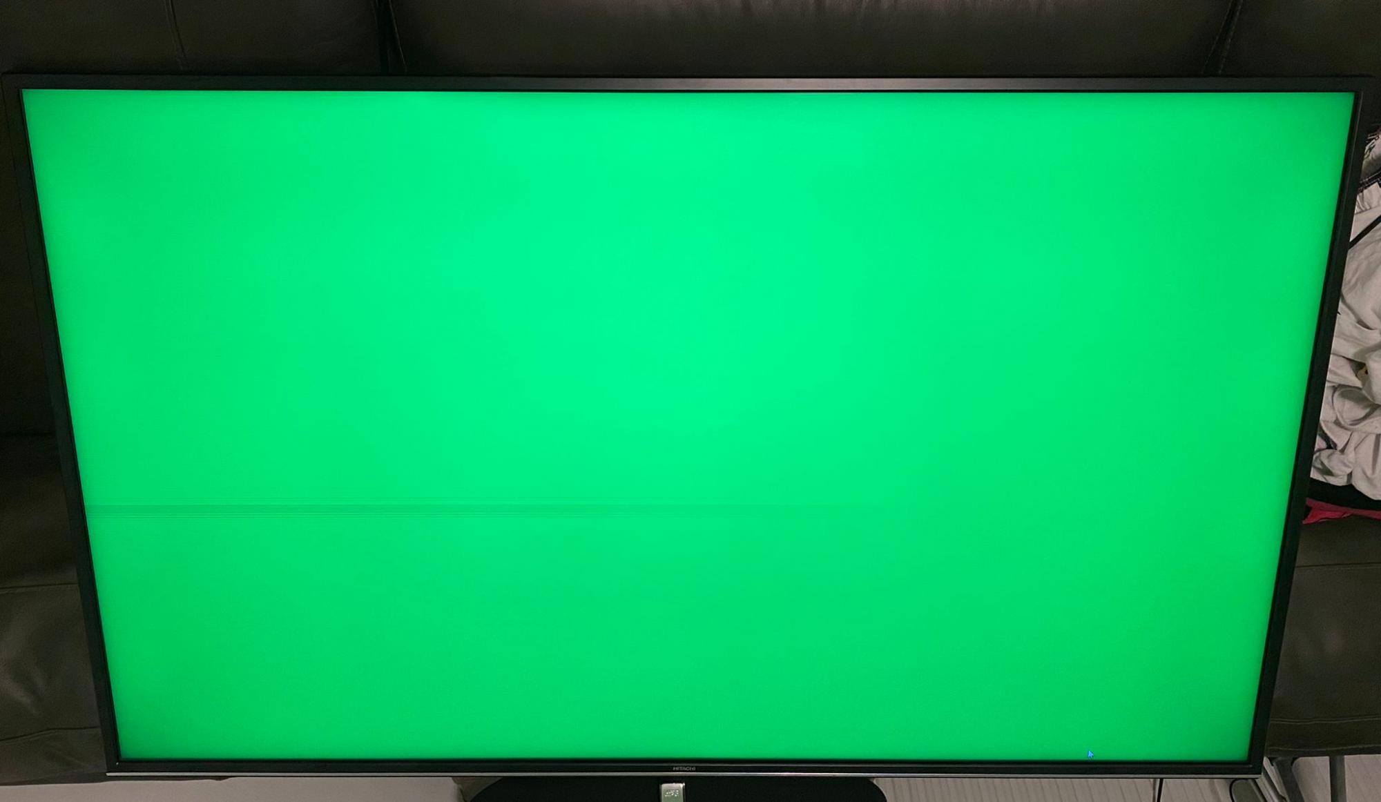

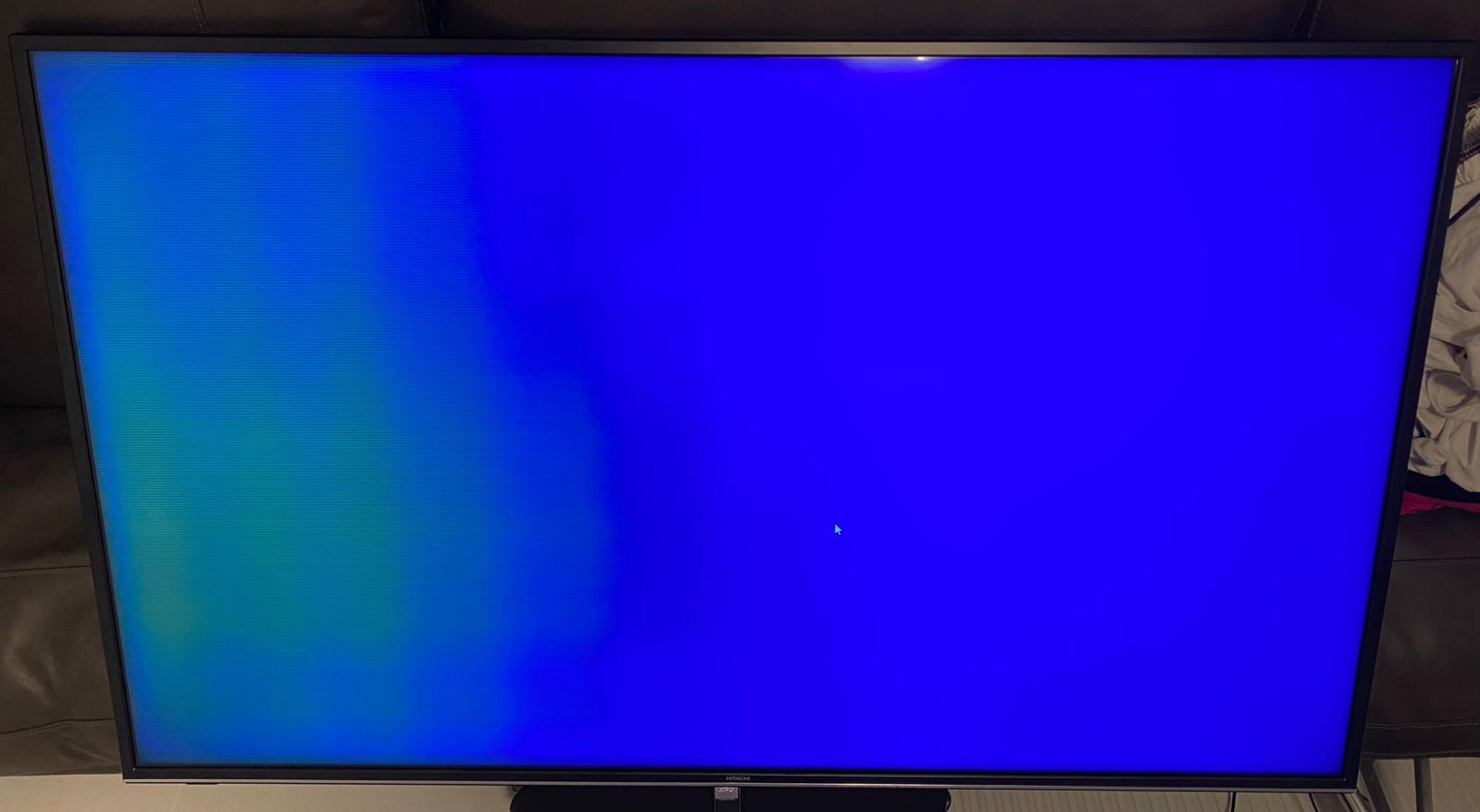

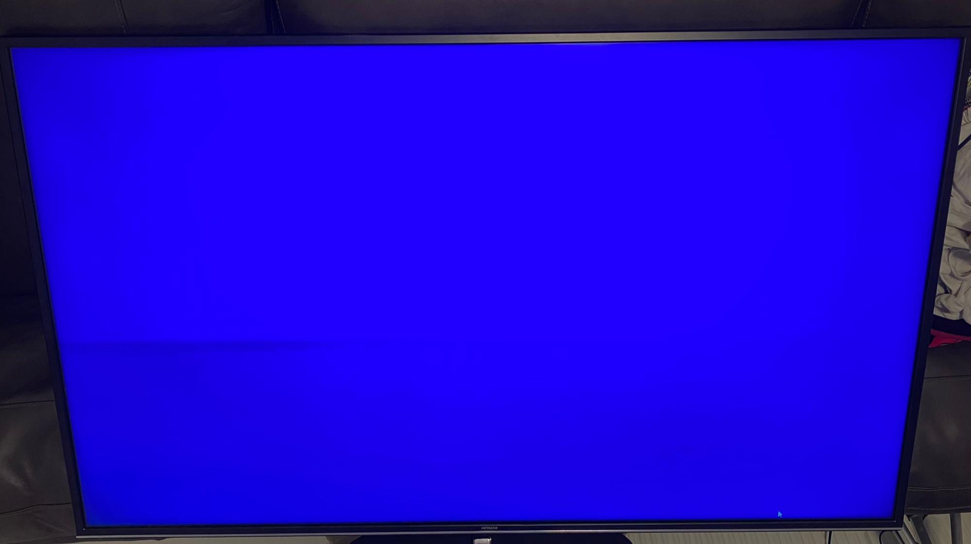

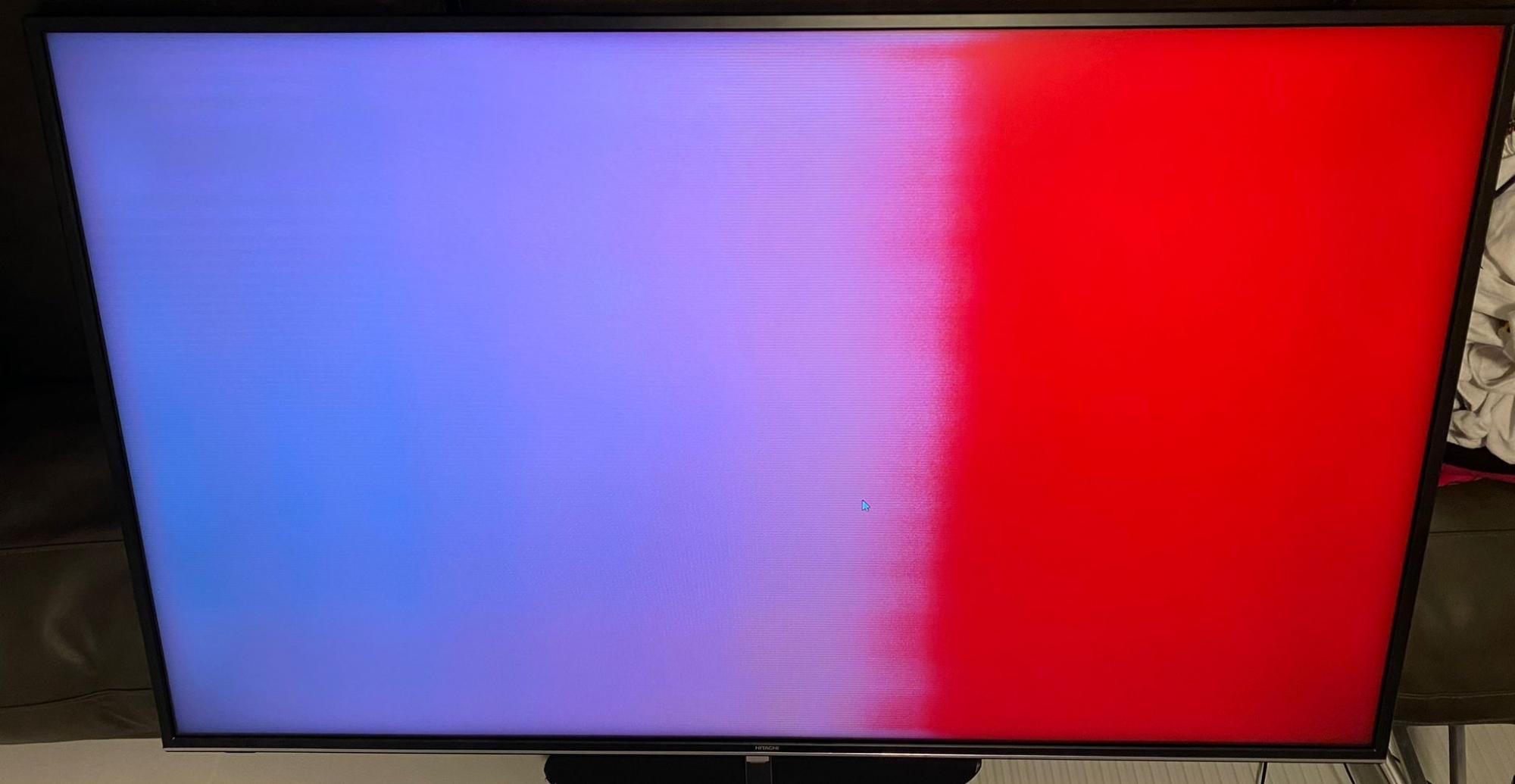

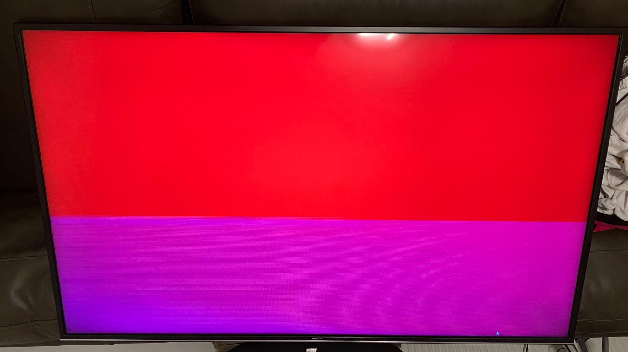

    Hi guys,
    I got this tv with half bottom of the screen flickering, horizontal stripe lines.
    I found when disconnected right side of the screen, the problem is gone.
    I isolated the CK signals (by guessing ) and loose the color.
    Pictures 4,5,6 defect
    Pictures 1,2,3 with piece of tape

    Re: Led TV Hitachi 58HK6100U half screen flickering
    These images are generated by the laptop to highlight the color distortion when the tape is applied
      Can you show picture of the screen with either side disconnected, like you did but not thru the laptop?
