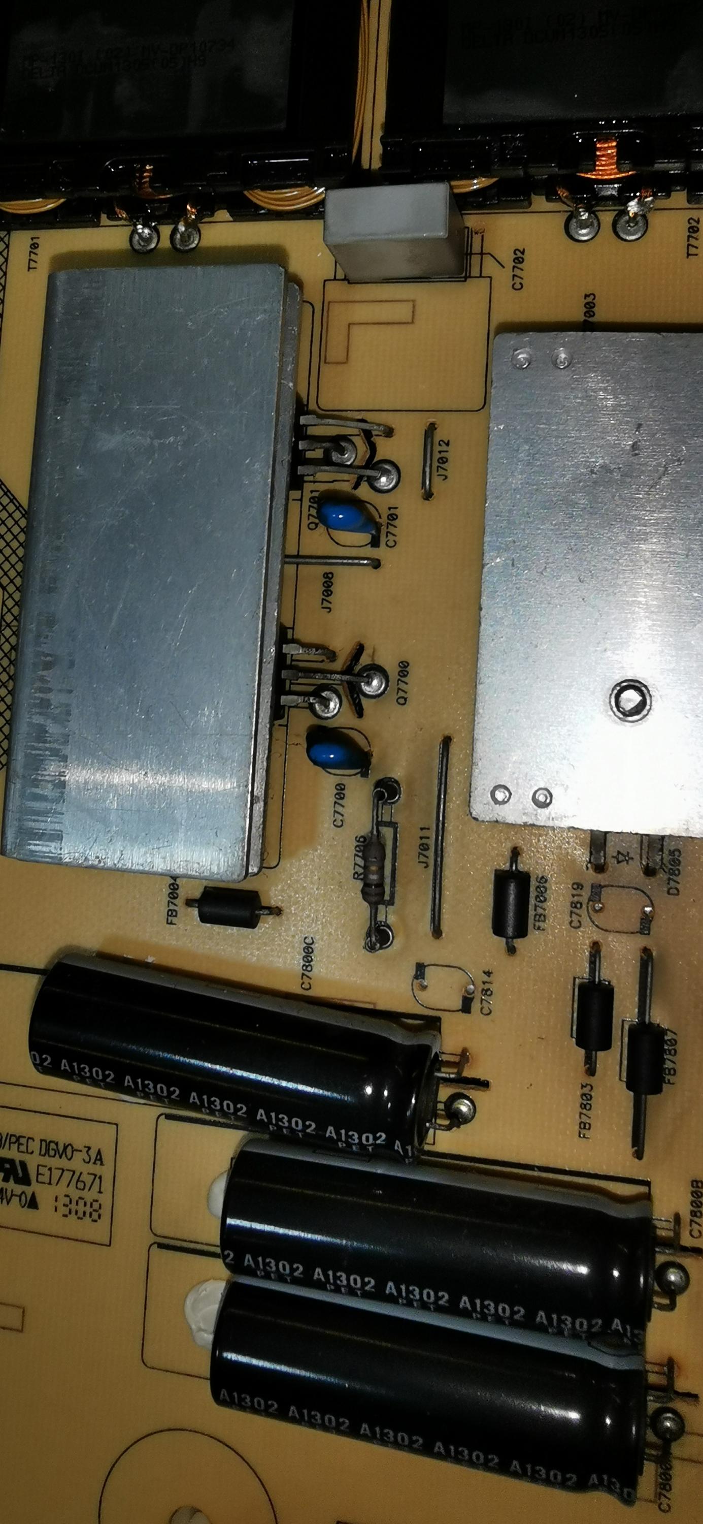

    not sure but OFL seems low, could it be a voltage regulator on mainboard?
    • beetle1303
      • Jul 2019
      • 279
      • Singapore
      Re: Sharp LED TV flashing green 2x per second - LC-70LE735X, DPS-222BP, RUNTKA857WJQZ
      The OFL value is jumped from PD-15 (4.96V) with a ~800ohm resistor, not connected to MB.

          T7701 and T7702 have been known to be a problem on these models, maybe check them closely.

            maybe try heating those looks like 6 electrolytic caps there by the connector on powerboard with a hairdryer, turn on and see if it does anything different, can you trace the ofl from connector to one of those caps, maybe one of them isn't up to par, what voltages are you getting on them with powerboard jumped?
              I am not sure how accurately I checked. With DMM in Ohm mode, both input and output side measures 1-2 ohms only. Both T7701 & T7702 the same.
              When powered-up with jumped PD cable, the reads 0V on input pin-pair, and 0V on output pin-pairs.
                I have earlier measures the capacitance of these caps, and all are on-par with the stated values. But I dont have the meter for ESR values.
                On powered-up with jumped pins, all these caps measured between 5-13+V, looks quite normal to me.
                What might not be normal is the T7901 - similar to T7701 & T7702, it measures mostly 0V on the input and output pin-pairs.
                What is the correct way to measure transformer in put and output voltages?

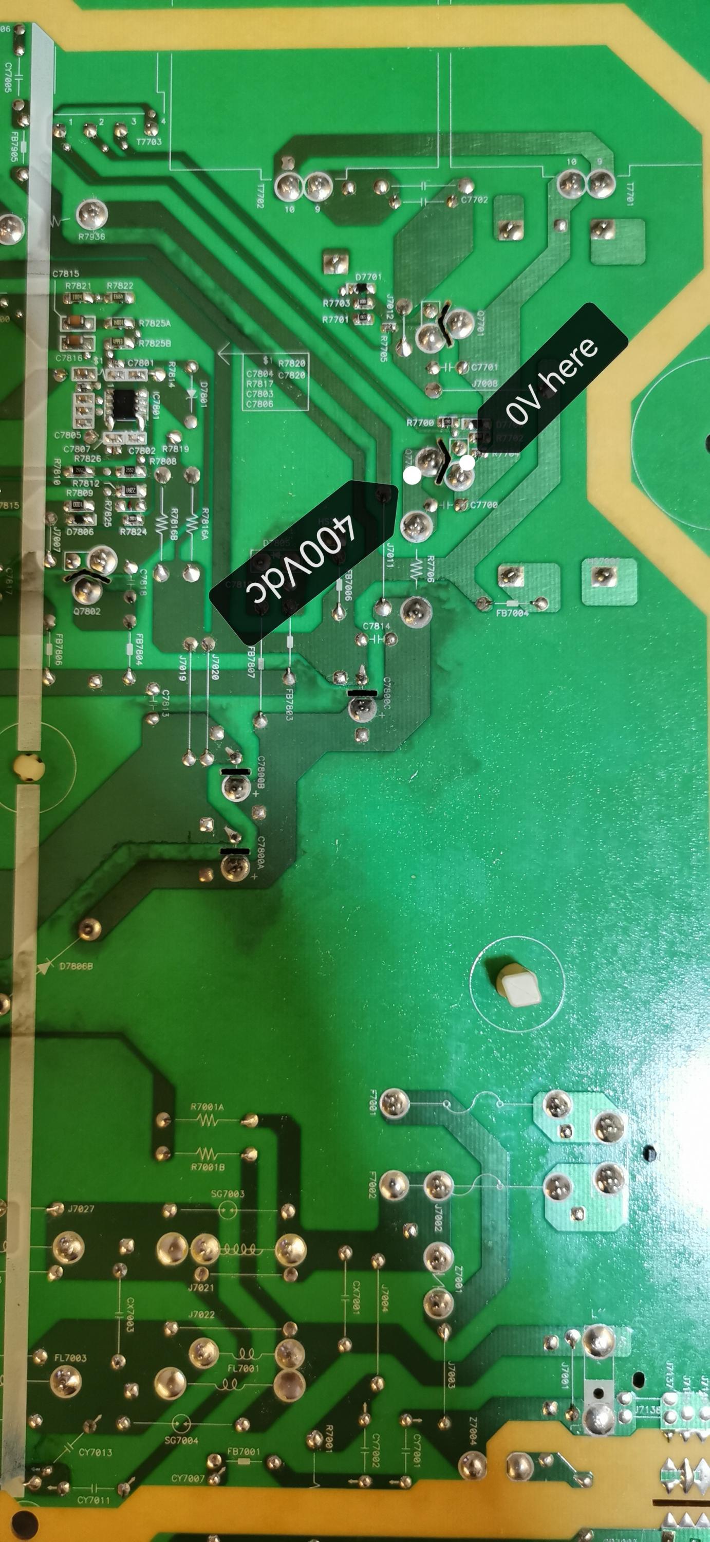

                  you should be getting voltage on some of those, on hot side you use the negative of one of the big filter caps as ground, so neg. probe on that and pos. probe on what you're checking.

                    #29
                    if you still have no voltage when powered, maybe trace it to where it stops, which seems to be right after the big caps somewhere in that area.

                        #31
                        I am not getting any voltages on those 2 transformers. And you're right, after tracing the 400Vdc from the big caps to the component Q7700, and 0v output to the transformer.
                        I tested this transistor:
                        1) Red probe on middle pin:
                        Black probe on either pin - Open
                        2) Black probe on middle pin:
                        Red probe on left pin: 528
                        Red probe on right pin: 732
                        Does it sounds bad or OK?

                            #33
                            wondering why the backlights didn't come on when powerboard is jumped, sure seems like they should.

                              #34

                                #35
                                There is no power supply to those 2 transformers, because Q7700 is either faulty or not triggered?

                                  #36
                                  test q7700 again, put black probe on neg. of big cap and red probe on each leg of that fet.

                                        #39
                                        what happened? beer break?
                                        Black probe on big cap negative, red on middle pin of Q7700 - 402VDC
                                        Black probe on big cap negative, red on either pin of Q7700 - 0VDC
                                        Repeated a few times..
                                        How does this Q7700 works?
