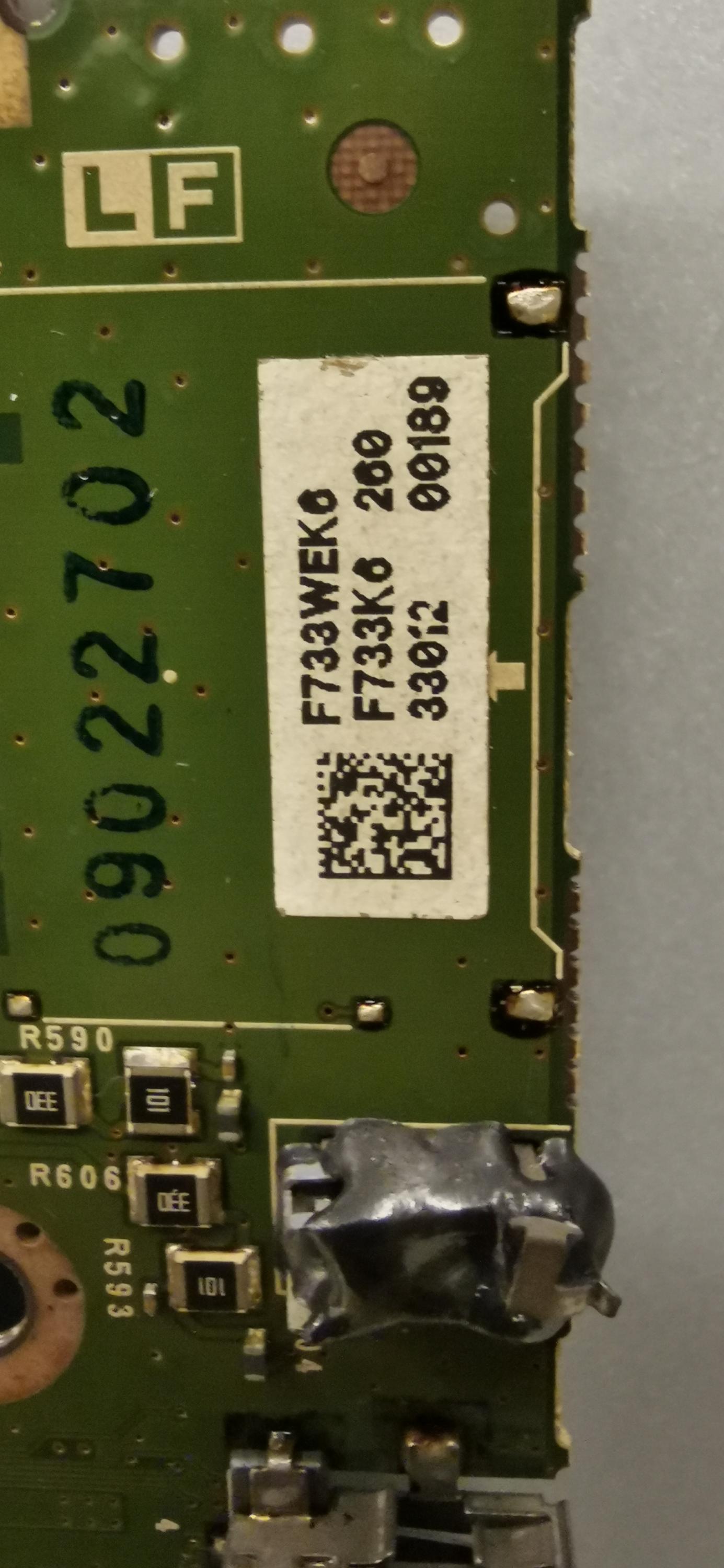

                                #75
                                Re: Sharp LED TV flashing green 2x per second - LC-70LE735X, DPS-222BP, RUNTKA857WJQZ
                                what are the 5 letter numbers on the white sticker on the original mainboard?
                                  #76
                                  This white sticker?

                                      #78
                                      yes, that must be it, if you can match those f733wek6 or f733k6, you should have a match, as far as other boards working, I don't know.

                                          #80
                                          https://www.bukalapak.com/p/elektron...35x-lc70le735x
                                          This part link provided by Diah looks like identical to my original MB, but it's 10x more expensive the the close-look from China.
                                          I think I will try my luck with this cheap one.
