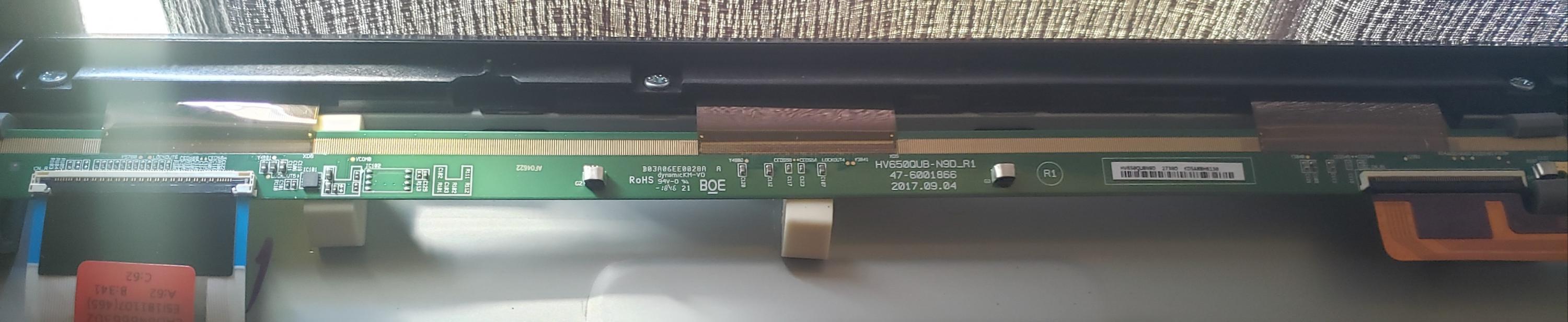

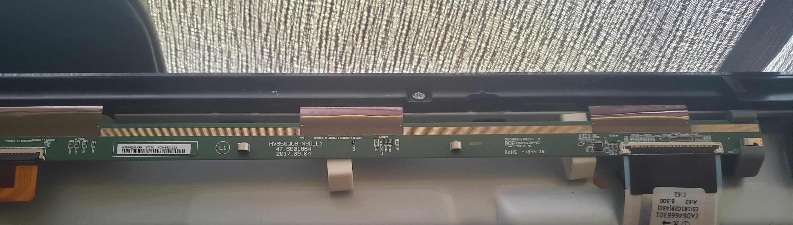

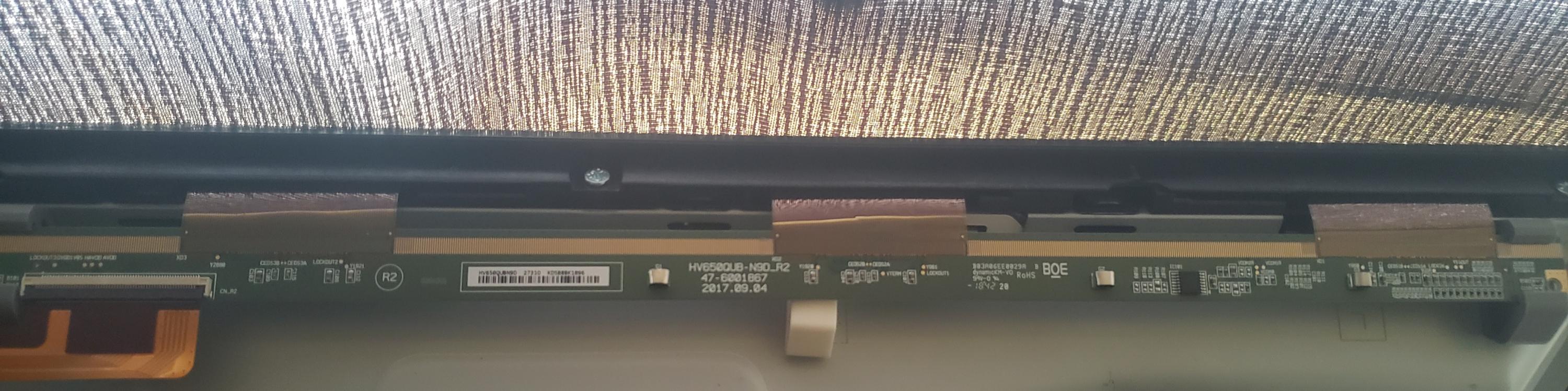

        Re: LG uk6500 LEDs Turn on but no image.
        Originally posted by dskall

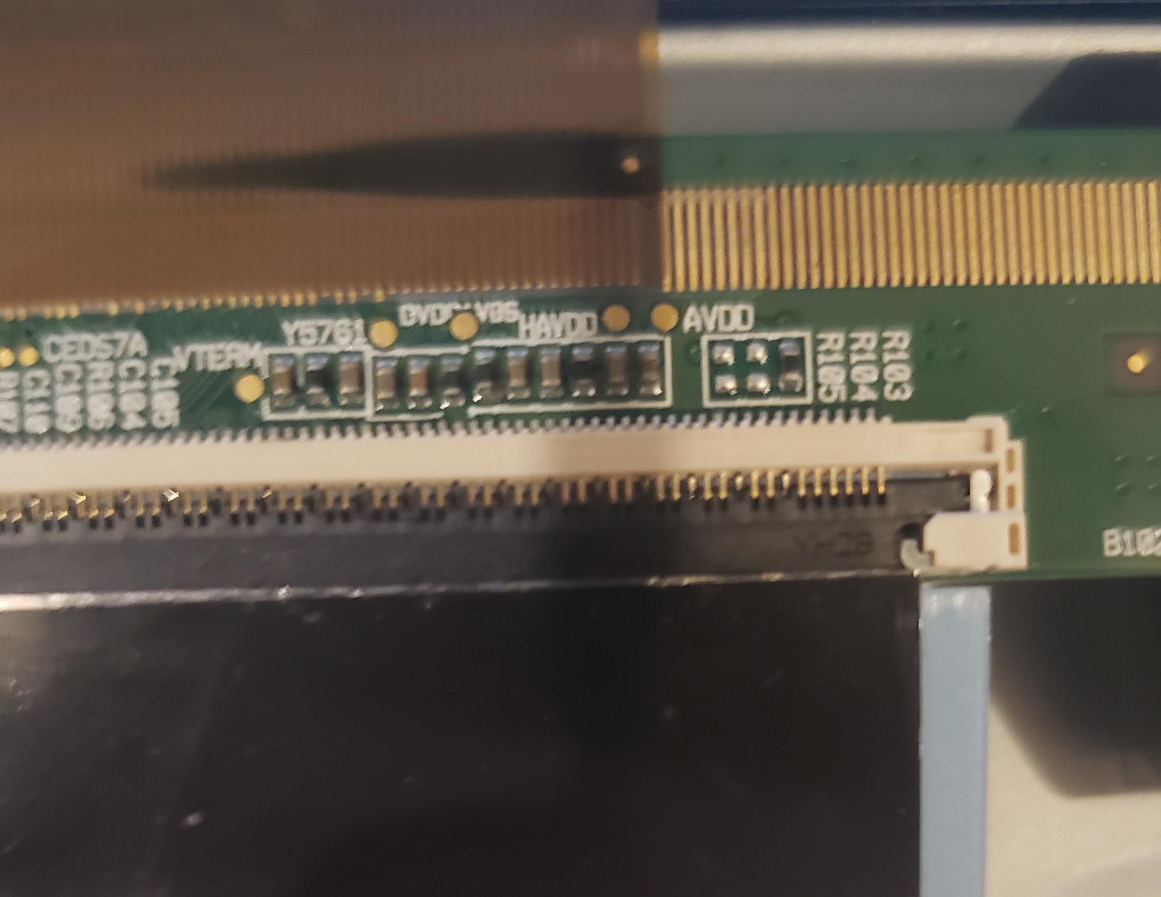

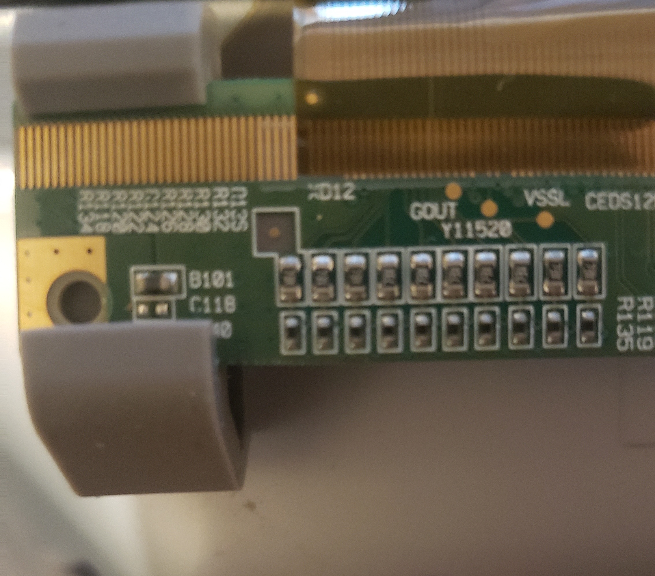

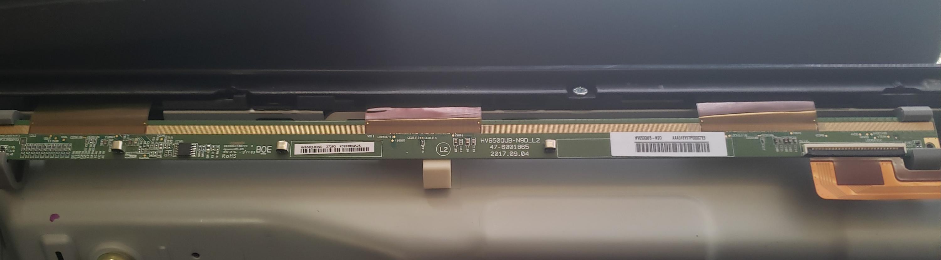

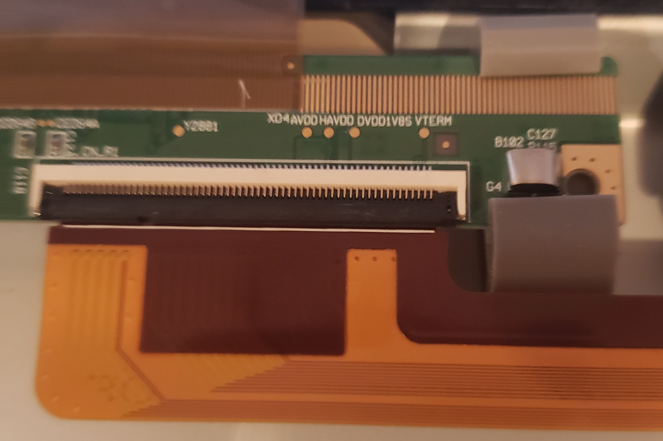

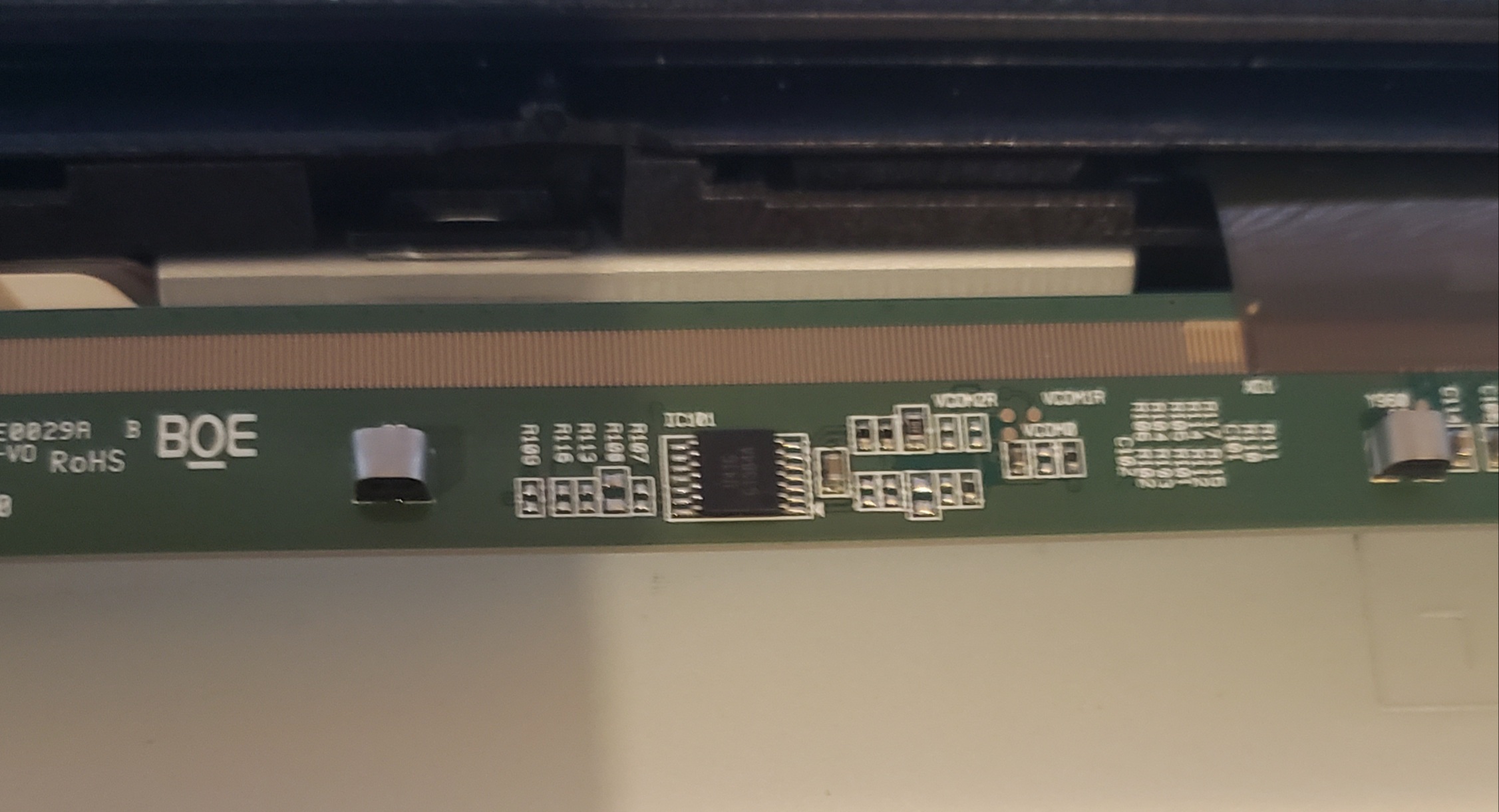

        Still need pictures of the long boards attached to panel.
        Panel boards.

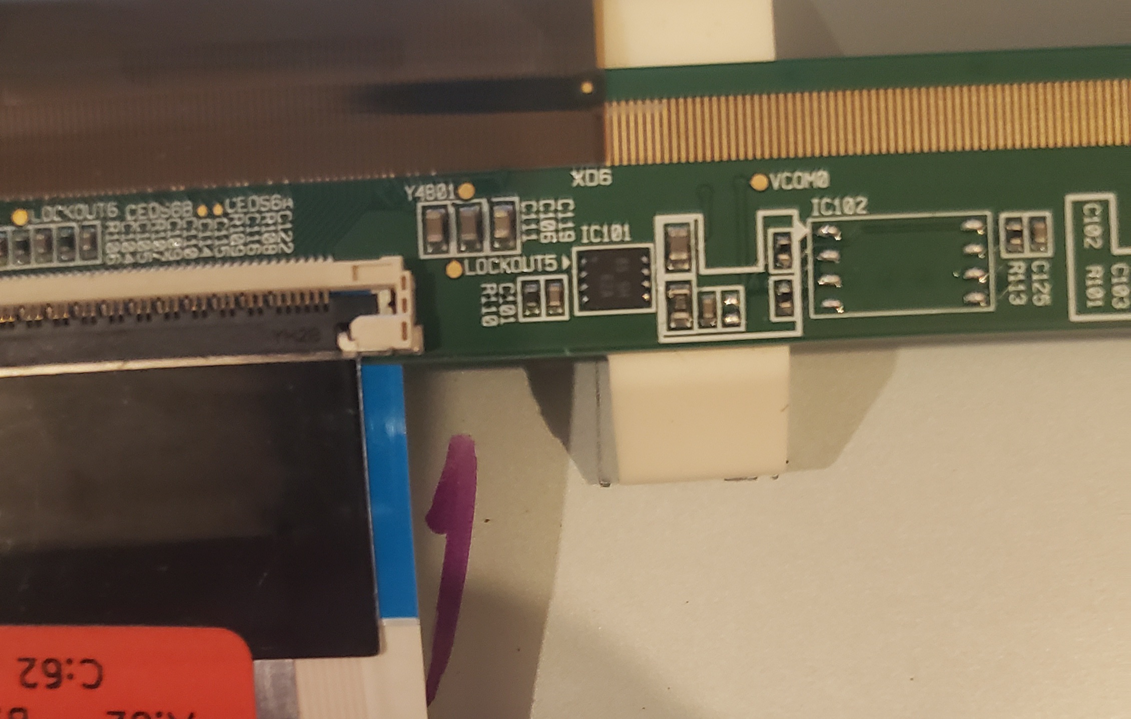

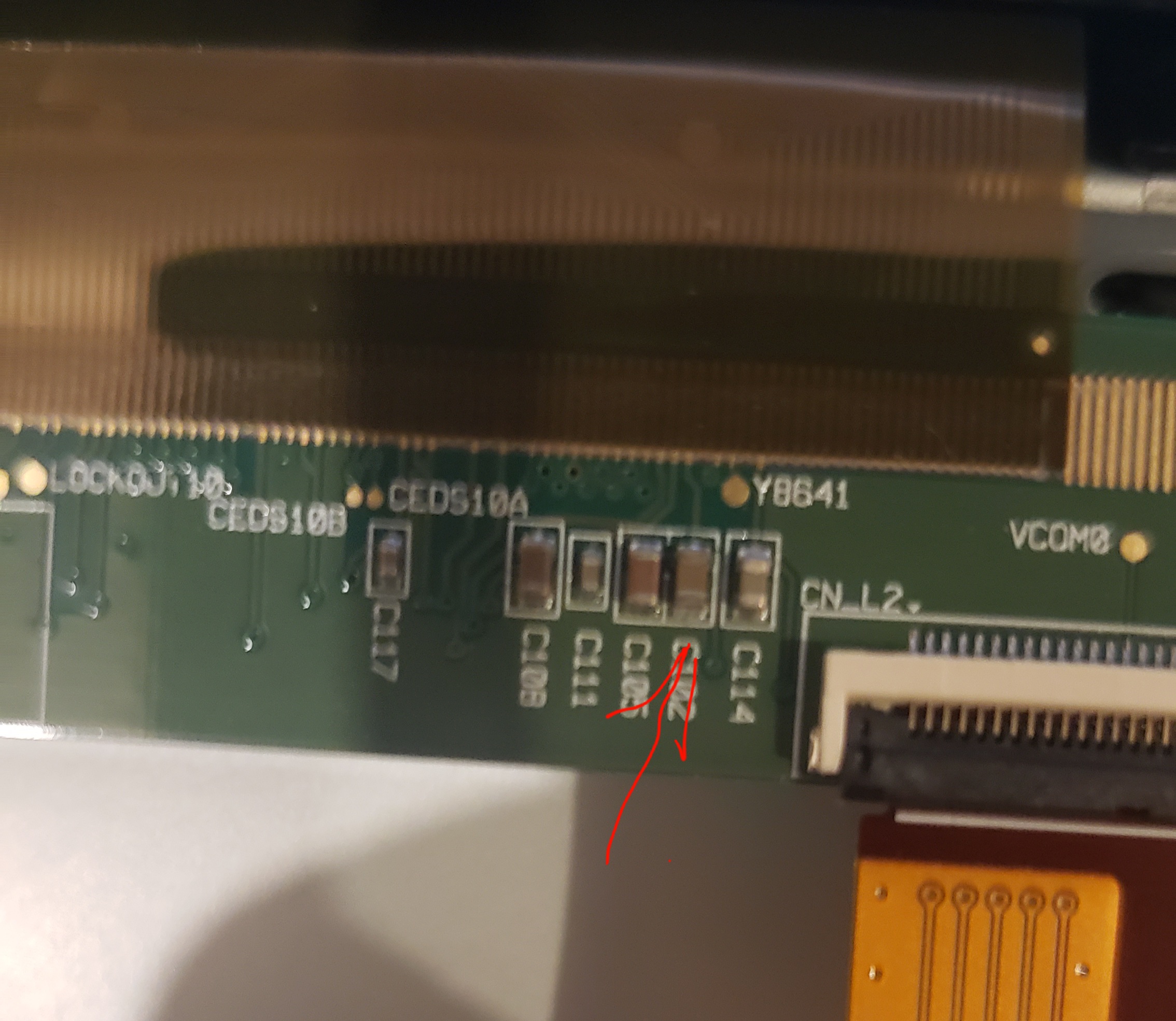

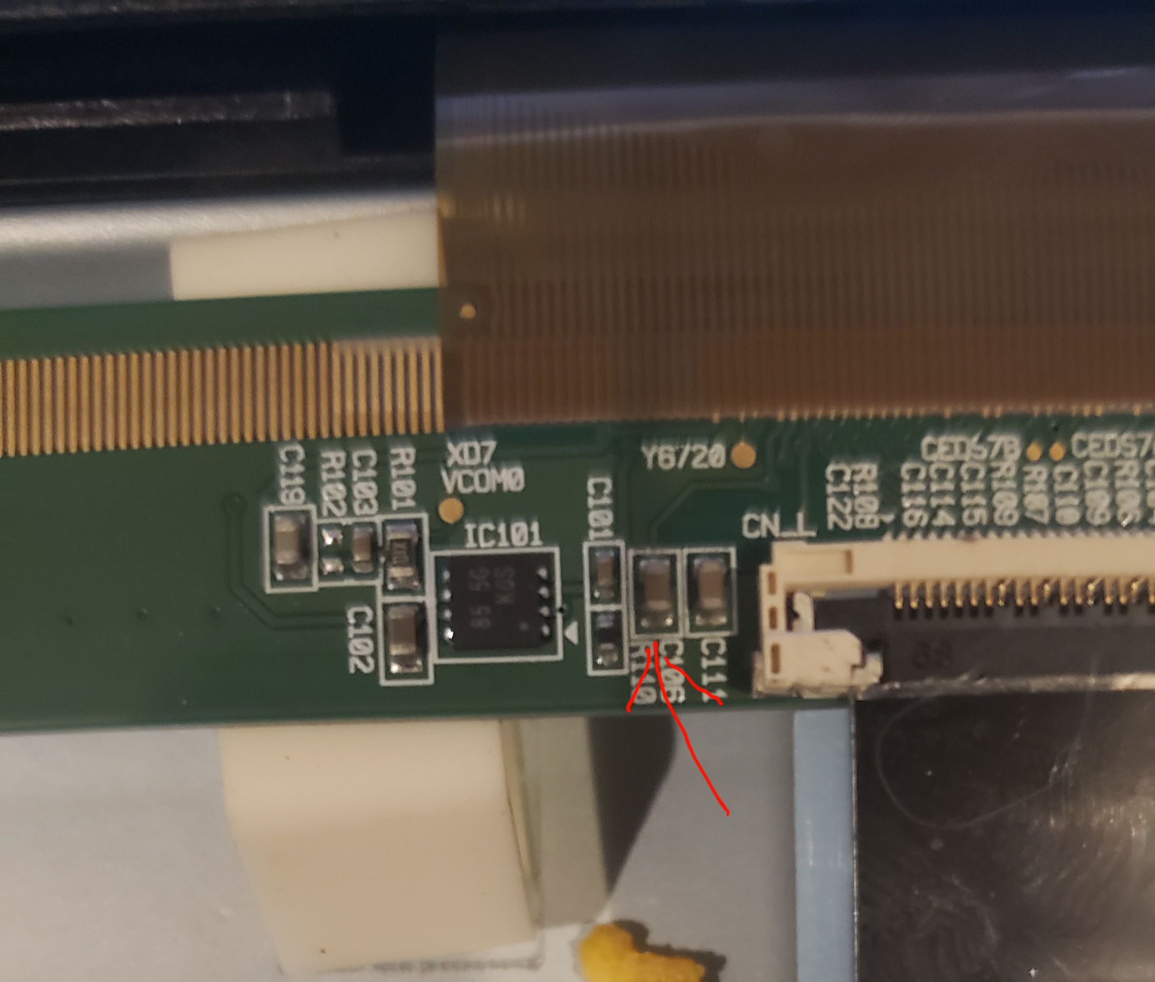

              maybe test the little ceramic capacitors on those boards for shorts or very low ohms.
              C102 and C106 as marked by the red arrows both read shorted in diode mode both directions.I also included some better closeups of what look to be test points on these boards.
                maybe check those two caps in ohm mode or see if one is hotter than the other, or just remove one and retest it and the one still on the board, it's likely that only one is shorted, when removed retest the pads where they connect also, to make sure the short is gone.
                    I removed C106 and measured the pads and both pads shorted both ways same as with capacitor so I assume cap is fine.(after desoldering it it fell to floor and yet to be located).C102 I havent removed yet and will soon .

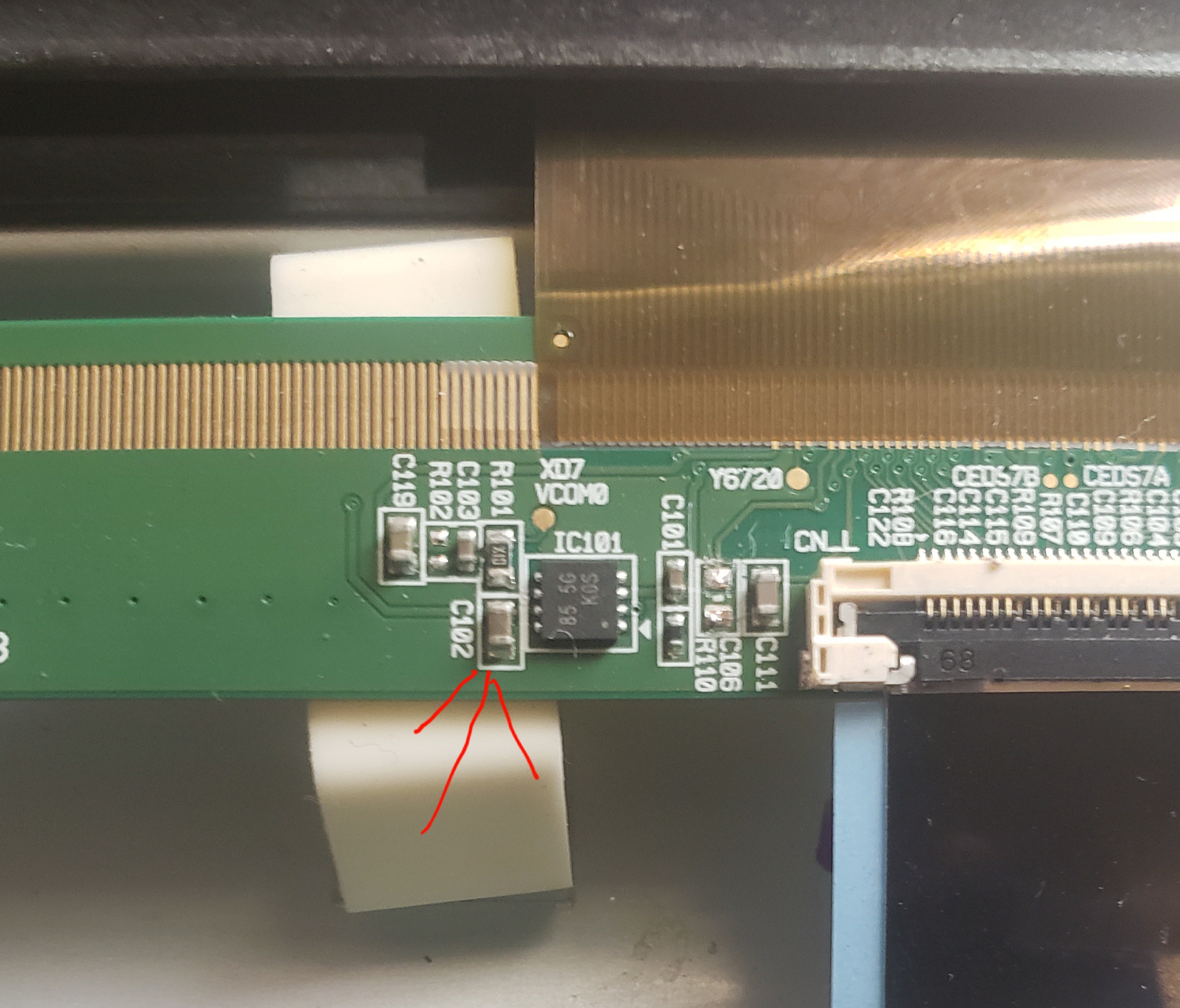

                                  #36
                                  maybe isolate, unplug ribbon cables from tcon to panel driver boards, check and see if you still have those shorts on the panel driver board/s.
                                  I have found that there is a half dozen caps reading short on the L1 and L2 panel boards.When I disconnect L2 from L1 all 3 L2 shorts on 3 caps disappear.Panel boards on right side R1,R2 don't show any caps shorting.L1 panel board shows 3 shorted caps so the problem appears to be in that area..
                                  There is an 8 pin ic on L1 and also R1 that I believe are identical .Pin 6,8 are shorted on L1 panelboard however on R1 panel board pin 6,8 are not shorted.
                                  Trying to find info on that 8 pin ic but no luck yet.It is marked ic101 on both L1 and R1.I will remove this ic to see if it is causing the shorts as well as the capacitors that read shorted until I find which one is causing the problem.

                                    #37
                                    Originally posted by Tv Terminator
                                    Did you install your Main board?
                                    Problem solved .Now have picture.Shorted ceramic cap on panel board L1 C102.

                                      #38
                                      Tv working now .C102 was shorted. I removed it and now have picture back.Many thanks for your assistance and guidance in cracking this one.Thanks to everyone else who also contributed to solving this problem.Every piece of advice certainly helps.
