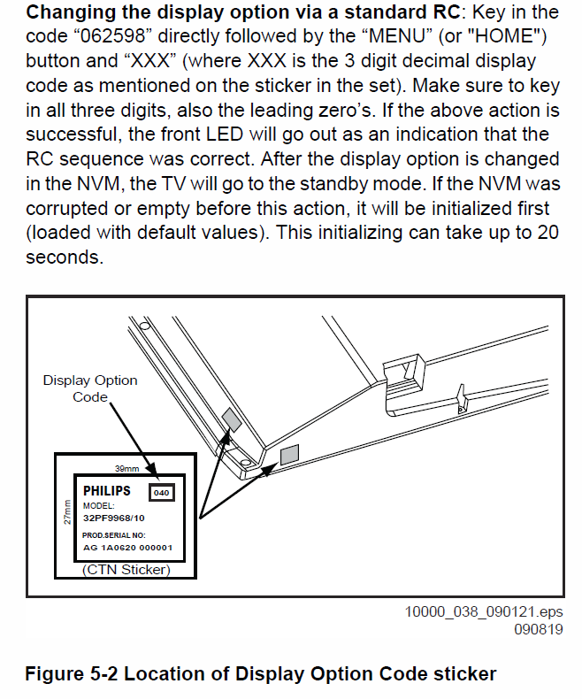

                          I went and bought a main board (same part number Mainboard 3104 303 54946 B), but coming from a working 47PFL6678K/12 with a cracked screen.
                          So after installing the tv responds to every remote control input but the screen stays black throughout, although there is an increase in brightness coming from the backlighting after pressing the smart button.
                          I am also able to power the tv off with the remote, and am getting no LED blinking after powering on.
                          Is this main board not plug and play interchangeable between these models? Am I supposed to load model specific software or smth?

                            Re: Philips 60PFL8708S/12 On Infinite Boot Loop No Logo, Only Backlight
                            Name your panel code using the remote.
                              #34
                              I did it and it went to standbymode right after I punched in the last panel code digit. But now when I attempt to turn the tv on I am stuck in a boot loop with a blinking LED .. (it goes first a short flash LED on as it is powering on the display, then follows a code; 1 blink ---pause--- 2 blinks and a restart some 5 seconds after.

                                  #36
                                  Did you enter the correct code? Download the service manual, I posted it in post 10 and see the error codes and how to see the SDM error code.
                                    #37
                                    47PFL6678K & 60PFL8708S MB als HW are same... but the TV info are different which the panel code of the 60 will not match model No of the replacement MB.
                                    if SDM didn't come on and displaying on screen. then you have only way to put yours old MB SPI on the new one and run firmware downgrade or upgrade to have the TV fixed.
