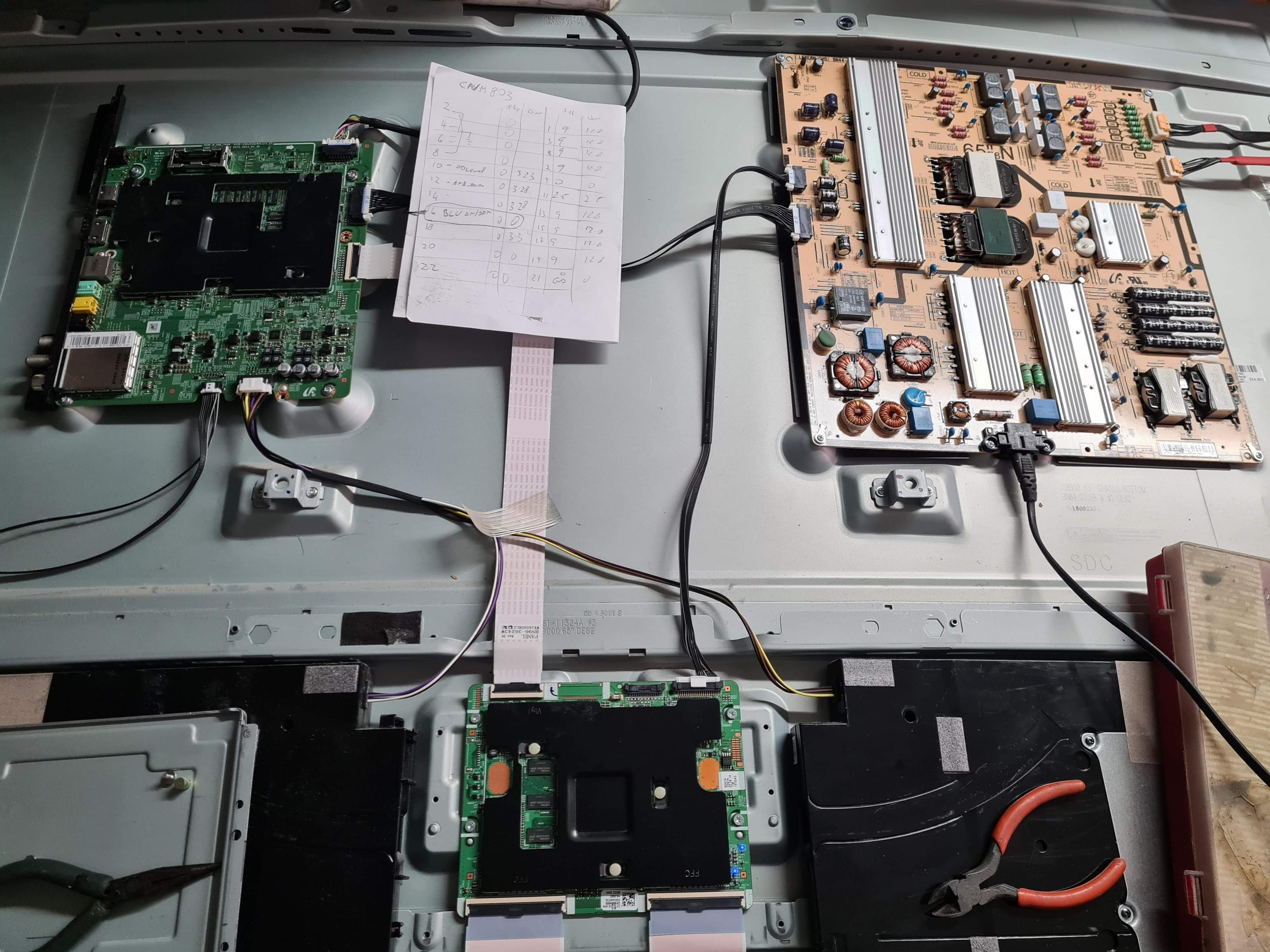

    Have this curved TV for repair. I have noticed 5 blinks then goes to standby and cycle repeats. Seems responds to remote commands but backlights not lit
    What I have done so far:
    • Disconnected power supply from Main Board and TCON. (this model has a connector lead to TCON as well) -> Backlight lit on but have noticed that LEDS are purplish.
    • Tried ALL 16 sets of LEDs (8 LED sets per connector) with my LED tester and all Lit up although again purplish not that intense.
    • Disconnected Panel LVDS Connectors but same error code.
    Am not sure if this model detects the low emittance of the LEDs and goes to error state.
    Any hints on this model?

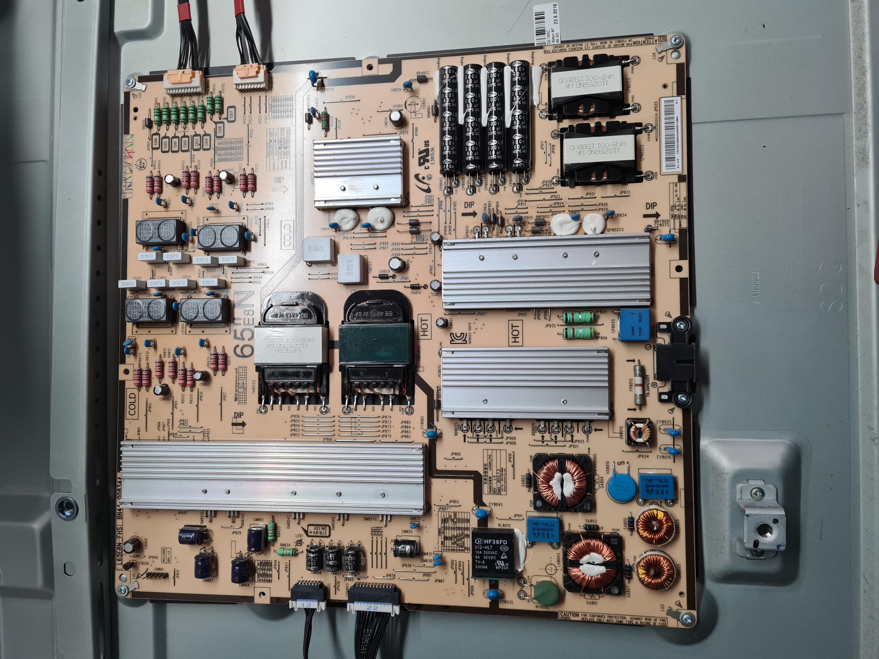

    Check all the voltages on the connector from the PSU to main board and see if there is something missing. While purple LEDS aren’t the best, at least they did turn on with the main board disconnected and stayed on. Right now I think you are barking at the wrong tree. post the PIN number, name and the voltage measured with tv On and Off.

      Did you see if the TV powers up with only one side connected at a time between the tcon and panel?
      • alltvrepairs
        • Jan 2014
        • 256
        • Malta
        Re: Samsung UE65JS8500 UE65JS8500LX 5 blinks
        Yes any or both no difference.

          Main board is faulty. Please upoload the picture of the board, I need to see where eeprom and eMMC IC/ NAND are located, also check voltages on line voltage regulators directly after switch on- one of them could be dropping. Chcek if 12V to screen is present
            UPDATE: FULL MODEL UE65JS8500TXZT VERSION: 01

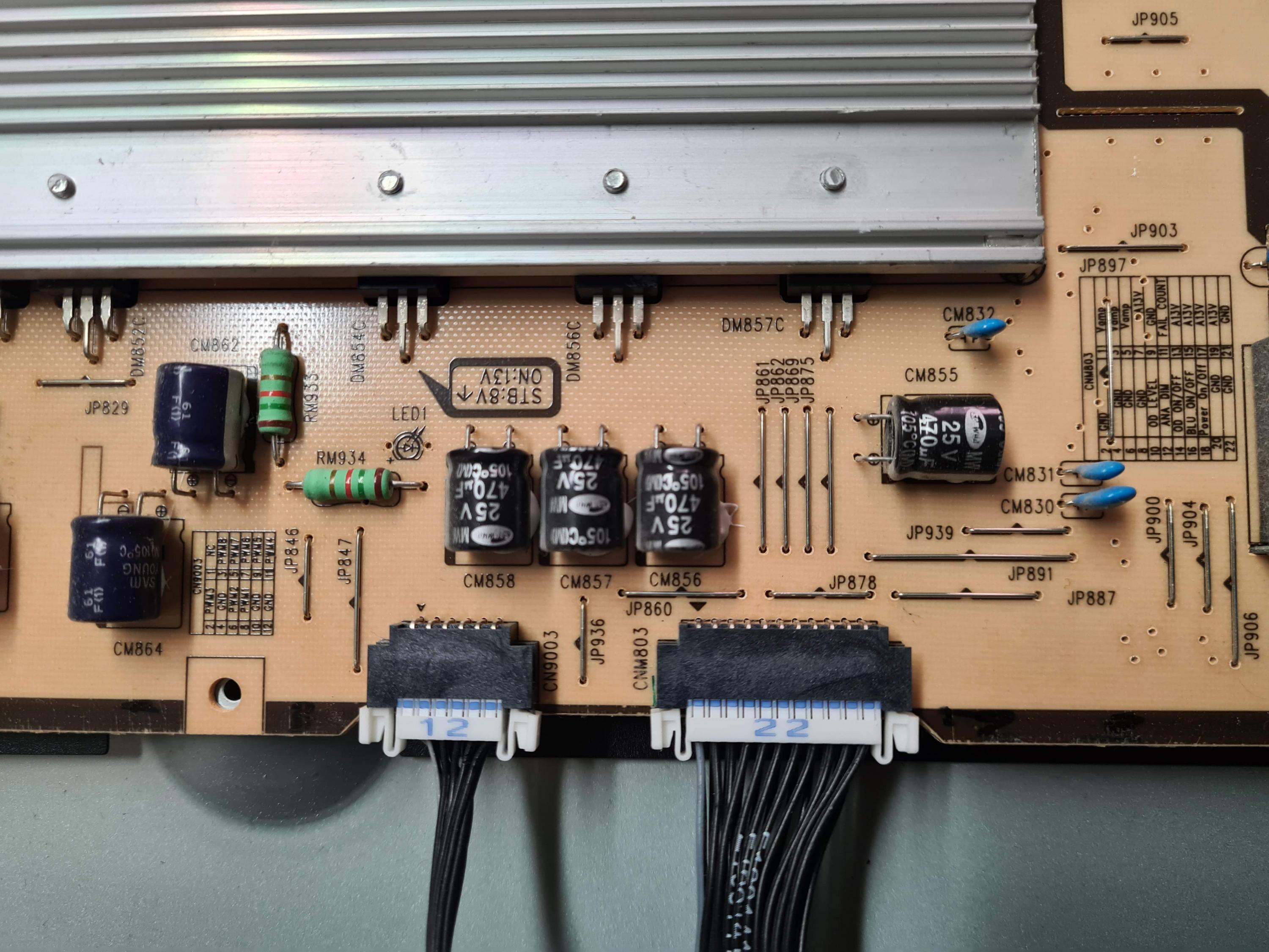

            These are the voltages from ps at standby and On
            CNM803
            ------------STBY ON
            2 GND -0 0
            4 GND -0 0
            6 GND -0 0
            8 GND -0 0
            10 OD LEVEL- 0 3.3
            12 ANA DIM- 0 3.3
            14 OD ON/OFF- 0 3.3
            16 BLU_ON/OFF- 0 0
            18 POWER ON/OFF- 0 3.3
            20 GND- 0 0
            22 GND- 0 0
            1 VAMP- 9 12.8
            3 VAMP- 9 12.8
            5 VAMP- 9 12.8
            7 A13V- 9 12.8
            9 GND- 0 0
            11 FAIL_COUNT- 2.5 2.5
            13 A13V- 9 12.8
            15 A13V- 9 12.8
            17 A13V- 9 12.8
            19 A13V- 9 12.8
            21 GND- 0 0

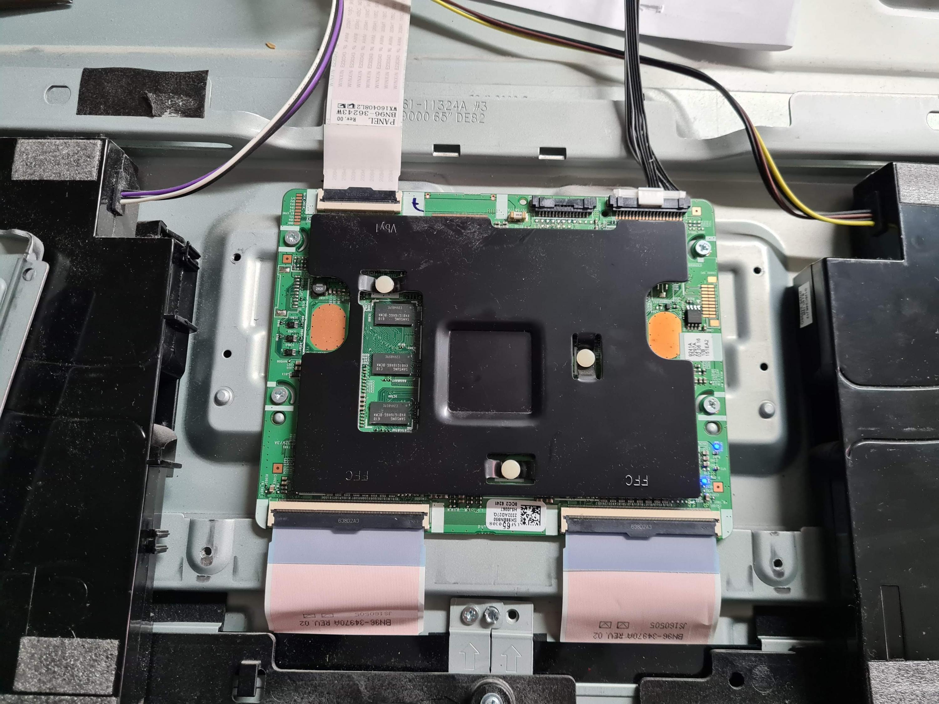

            The BLU_ON/OFF signal (pin 16) is ,kept TTL_Low from main board. I have disconnected this pin 16 from main board side. There is 3.3v coming from power supply now on this pin. But backlights still not switched on. If I remove CN9003 (power supply to TCON) backlights on but still same fault.
            CN9003 has the PWM signals from TCON to Backlight circuit in power supply.
            TCON supply 12v is actually being supplied from main board. 2 blue LEDs on TCON are lit when ON
            Now its a chicken and egg problem Is it the TCON not sending signals to supply or main board faulty or detecting another fault??
            Probably I can only get help from any Samsung expert that have had experience on the JS series.

                Purple leds and the fail count, seems to be bad led backlights.

                              • . How to distinguish if the problem is caused by Main Board or T CON.
                              • - No Video
                              • If the problem is No Video but BLU is on and Indication LED is blinking repeatedly and faster than nomal booting, replace the T-CON board.
                              • - Distorted Picture
                              Check the inner patterns.
                              If I apply this logic to my case, my BLU signal is 0v so more inclined to a main board.

                                        Hi, So I will take the offer these are 3 tests that can help me and possibly others with problems in this chassis.
                                        1) If you disconnect the TCON from the main board what happens? Backlight is ON (Y/N)? Does it give any error (Y/N)? Sound OK on HDMI (Y/N)
                                        2) If you just take out both panel to tcon ribbons , Backlight is ON (Y/N)? Does it give any error? (Y/N) (Y/N)
                                        3) If everything in place except the LED connectors. Backlight is ON (Y/N)? Does it give any error (N) ? Sound OK on HDMI (Y/N)
