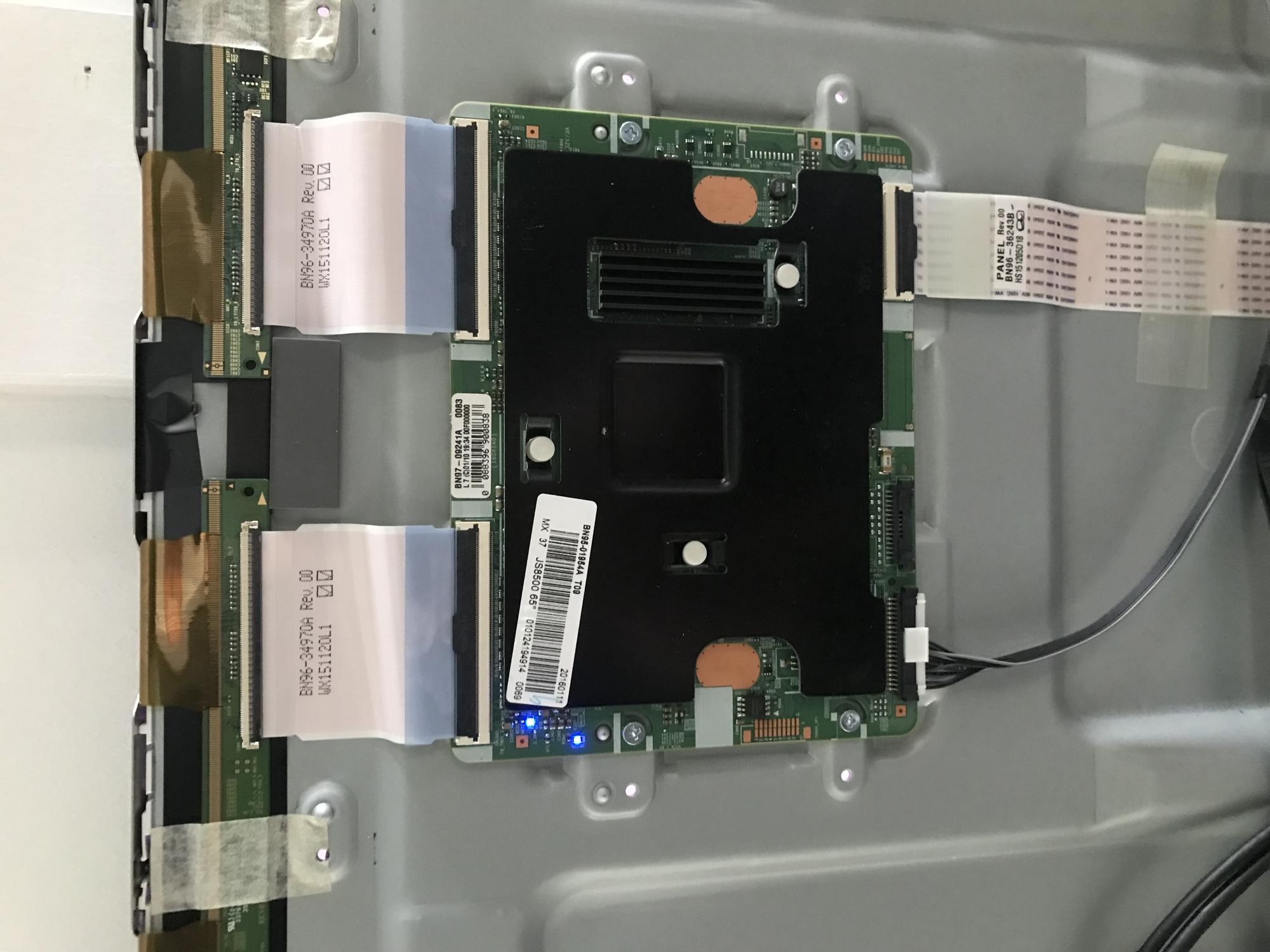

Hi, So I will take the offerthese are 3 tests that can help me and possibly others with problems in this chassis.
1) If you disconnect the TCON from the main board what happens? Backlight is ON (Y/N)? Does it give any error (Y/N)? Sound OK on HDMI (Y/N)
2) If you just take out both panel to tcon ribbons , Backlight is ON (Y/N)? Does it give any error? (Y/N) (Y/N)
3) If everything in place except the LED connectors. Backlight is ON (Y/N)? Does it give any error (N) ? Sound OK on HDMI (Y/N)
2) backlight turns on and stays on/ also there is a blue light on the tcon that lights up. See attached pic
3) not sure I understand. If you unplug the led connector the backlights won't work. There's no power.
But I do get 2 blue led lights on tcon when everything works correctly.
See 2nd picComment
Re: Samsung UE65JS8500 UE65JS8500LX 5 blinks
1) no backlight. Didn’t hear any sound so I’m assuming it doesn’t fully turn on.
3) not sure I understand. If you unplug the led connector the backlights won’t work. There’s no power.
See 2nd pic
Point 3 is interesting as in my case I have the 2 blue LEDs on. But in my case the standby LED blinks 5 times then pause a few seconds and goes to standby and repeats the cycle.
Help me out identify which part should I buy firstTCON-Mainboard-BAcklights . I am mostly inclined to the Mainboard issue

the blinking you see its boot sequences of the eeprom. but no response from main IC so it go to STBY and try to start the boot script again.
Main IC didn't response 1- BGA, 2 Toasted , 3 Audio circuit shorted. 4- T-con send back turn off because fault at panel buffer boards. or damage ( broken )Comment
4- T-con send back turn off because fault at panel buffer boards. or damage ( broken ) --Less likely panel is giving this fault as Storyteller12 kindly removed ribbons to panel and set switched ON with backlights. I have disconnected ribbons as well and same fault.
After I update the software, I will apply some flux and hot air to the BGA just in case of a dry pin as a temporary solution.Comment
Main IC didn't response 1- BGA, 2 Toasted --Most Likely,
between you said some things about purplish LED BL, Samsung LEDs BL are with zener build in LED tester will pass them okay even zener open or sorted.Comment

yours eeprom are fine and booting... why you want to play with it and its not the issue... remove load.. disconnect the rail of audio section and see it it come on. first
