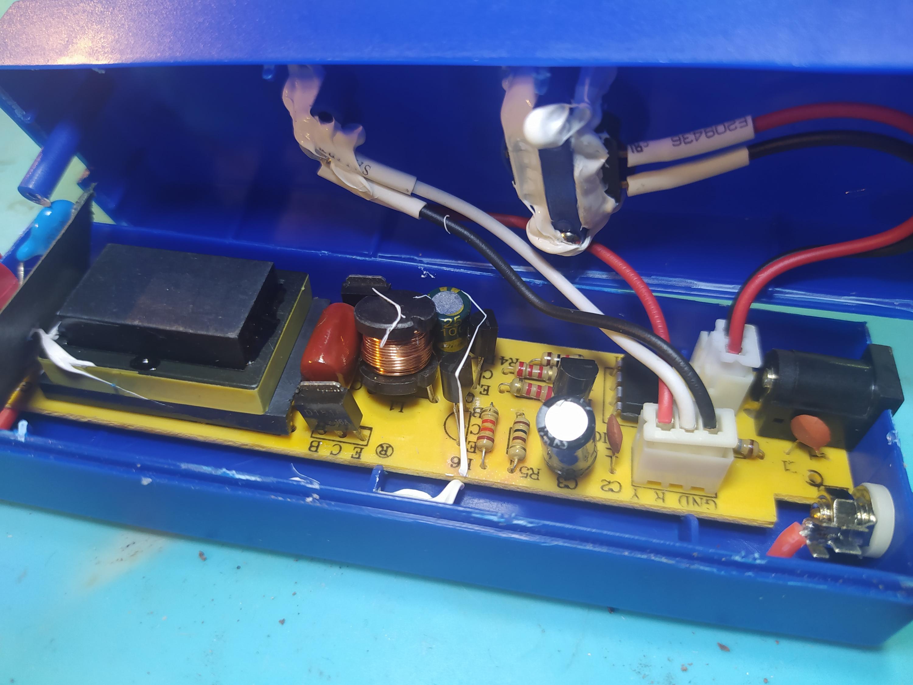

        I have one of these, want to see inside one ? Notice the loose nut on the back of the connector, a sure sign of quality QC, it's tight now. I did try and identify the 8 pin chip but there are no markings or sanding marks.
        If you're in a rush you're welcome to borrow or buy mine. I'll seal it back up with plastic weld so it will be better than new.

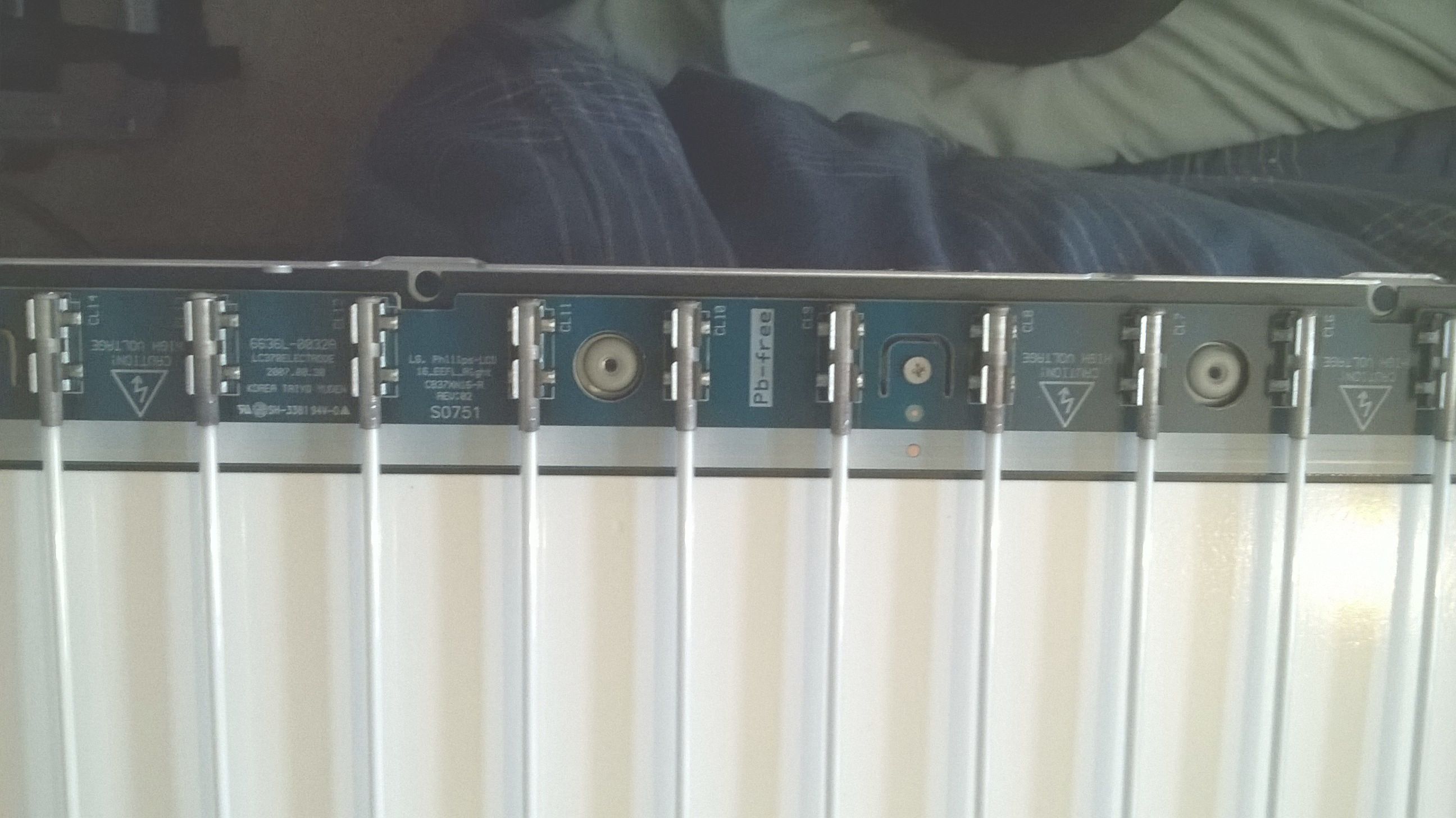

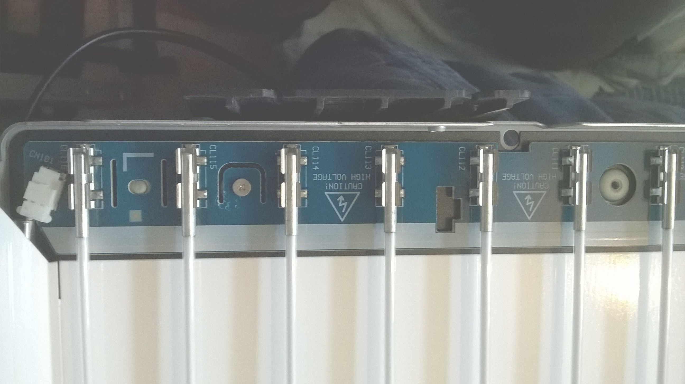

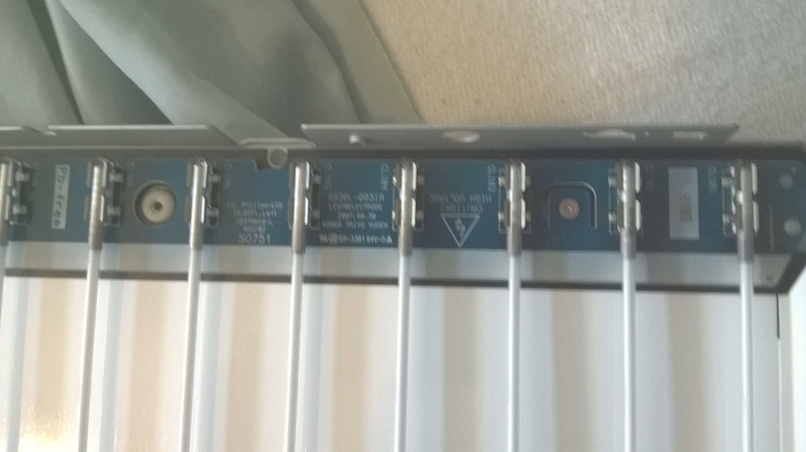

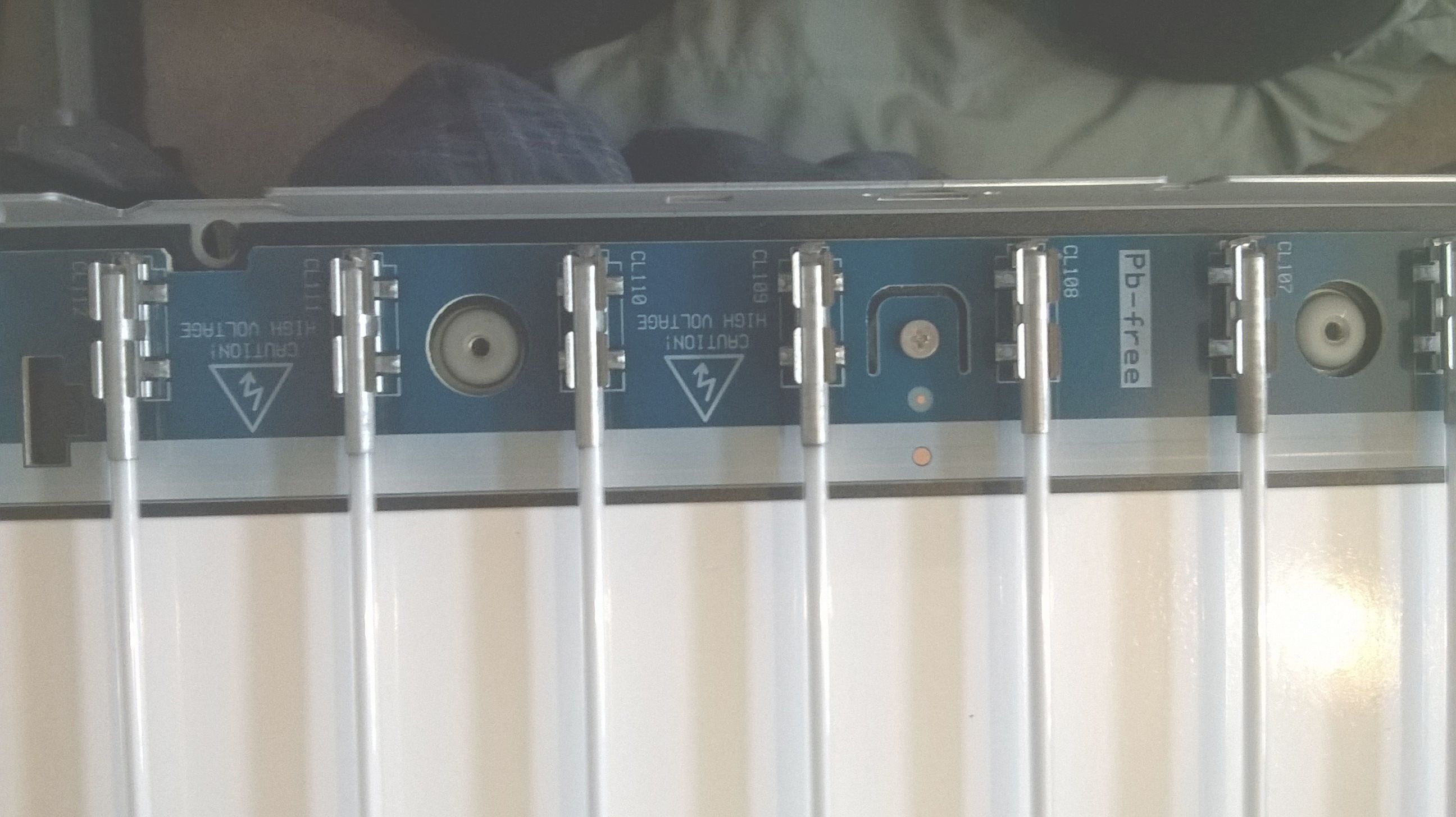

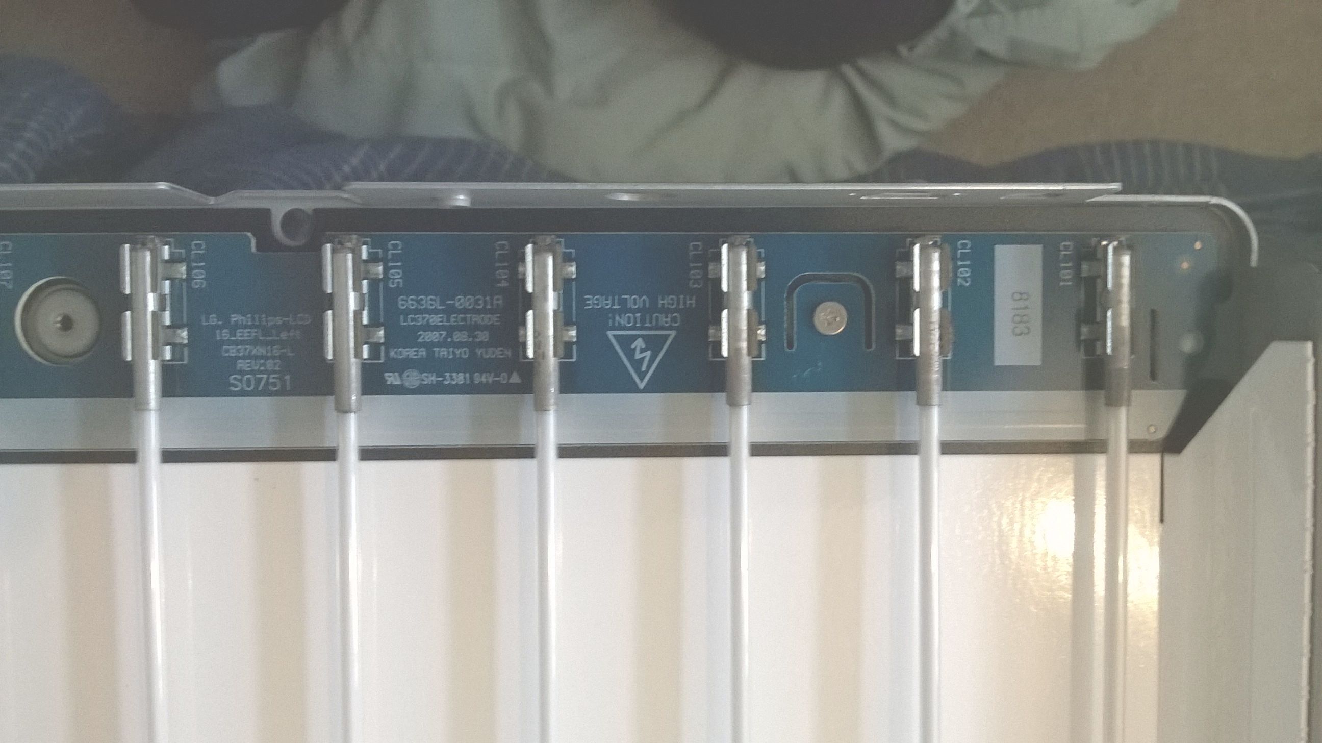

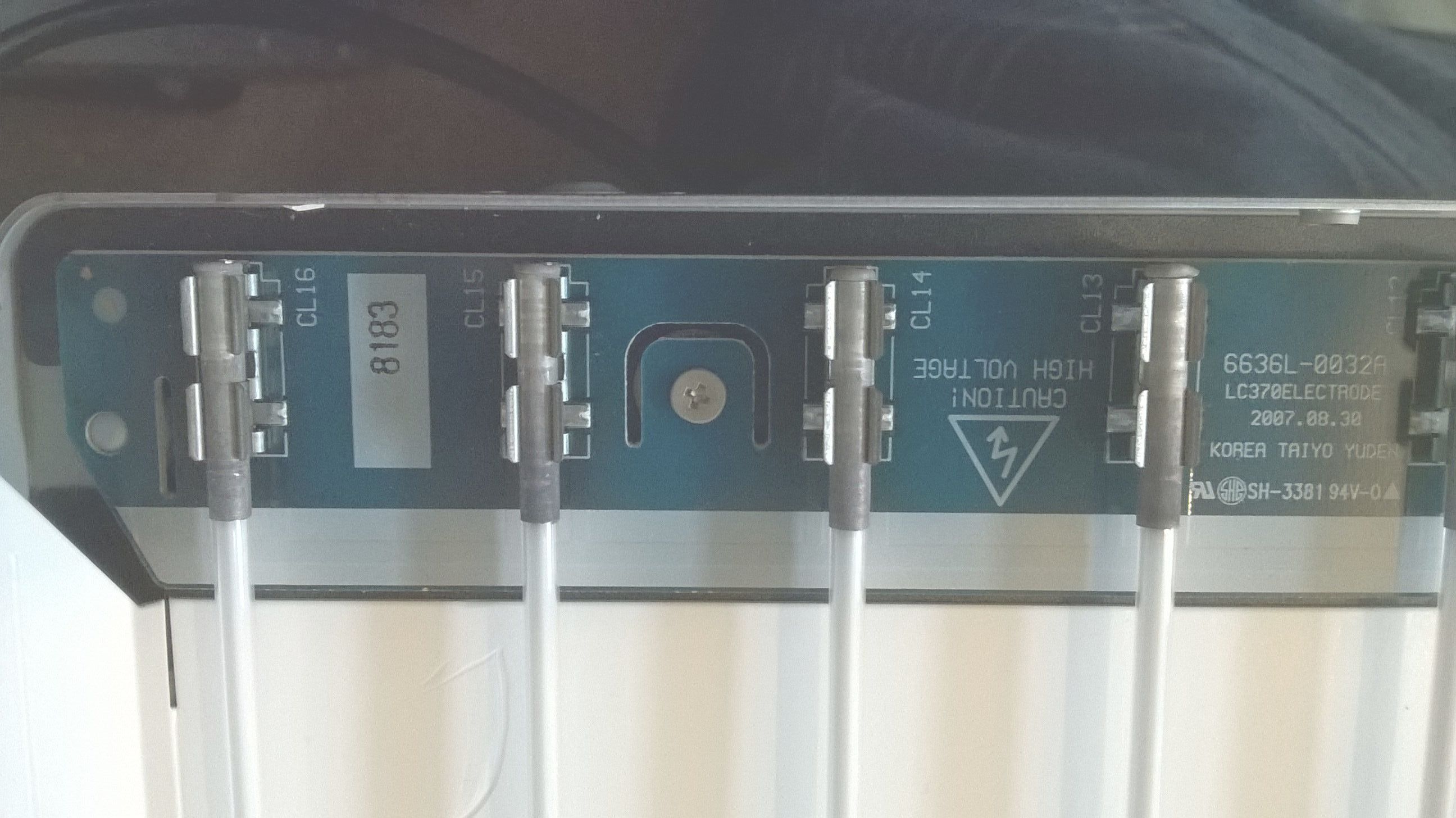

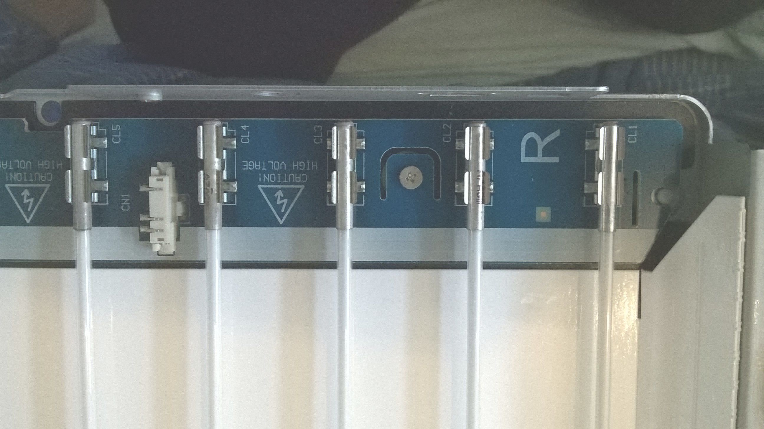

          They all look alright to me without testing them. CN1 has continuity on the two pins next to each other at the bottom and with all the CCFL's on this side and also with the connector plug that goes to the inverter board.
          And on the other side CN101 has continuity with all the CCFL's on this side and with the connector plug that goes to the inverter board.

              My CCFL Tester arrived today so I tested all the lamps individually and they all test good with a nice white light.
