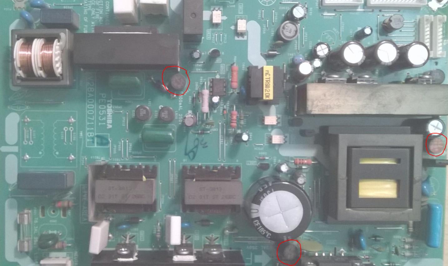

              Re: TOSHIBA 37CV505D TV turns on and then off
              Just checked a couple on a slave, read 8 on 20k, I think your ok on that.
              • nomoresonys
                • Jan 2013
                • 12271
                • U.S.
                In post #12, careful high voltage, if it's around 400 v, powered on then your ffc is working correctly, about 160 when tv not powered on, measured in vdc mode, one probe on each leg of cap.

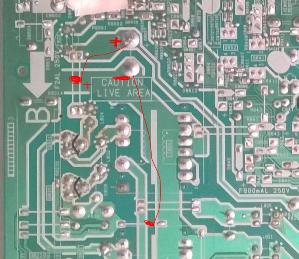

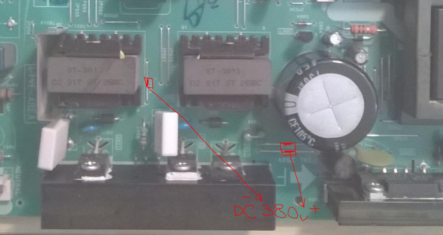

                                Originally posted by Ukdigger
                                no not yet, any ideas
                                No sorry im still learning myself we need someone who understands schematics and look at the 12v section and see when it should be active etc
                                • lotas
                                  • Jan 2016
                                  • 4745
                                  • Russia
                                  #36
                                  not sure how to test the PFC in the power supply either
                                  PFC DC 380v you can check on these jumpers what voltage they have in standby mode and in operating mode.
                                        Thanks Lotas, I thought there must have been an easier way.
                                        • R_J
                                          • Jun 2012
                                          • 9588
                                          #40
                                          Do you have +24v ? if you do, then to get the 12VLCD you need the POWER LCD pin to be enabled by the main board.
                                          Are you getting 24 volts to the inverter?
                                          There is an LED on the inverter board, when you first turn on the tv does the LED light and go out?
