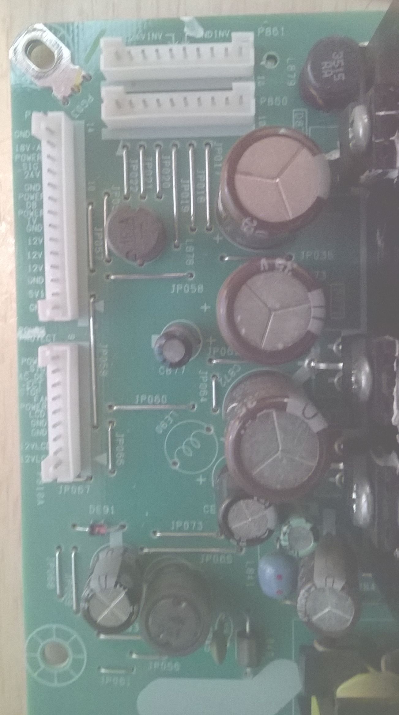

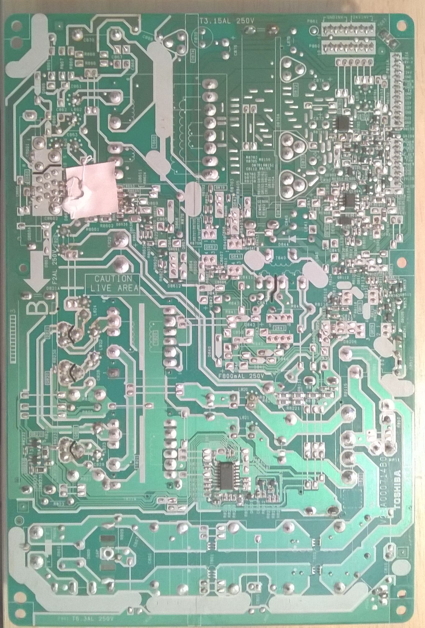

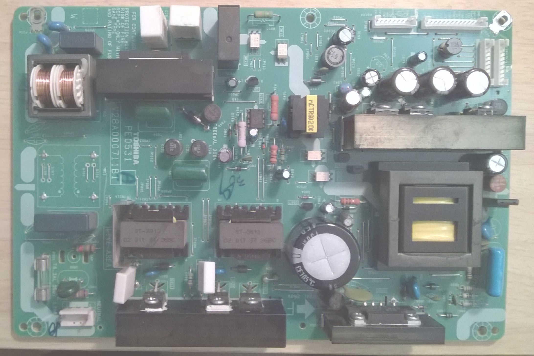

    POWER SUPPLY PE0531 V28A000711B1
    TV turns on with no backlight and then off after about 10 seconds
    All caps test good with ESR meter, no signs of any burning, board has been repaired before but not by me. Should I be getting 12v on pin 1 and 2 12vlcd
    Any help would be welcome.

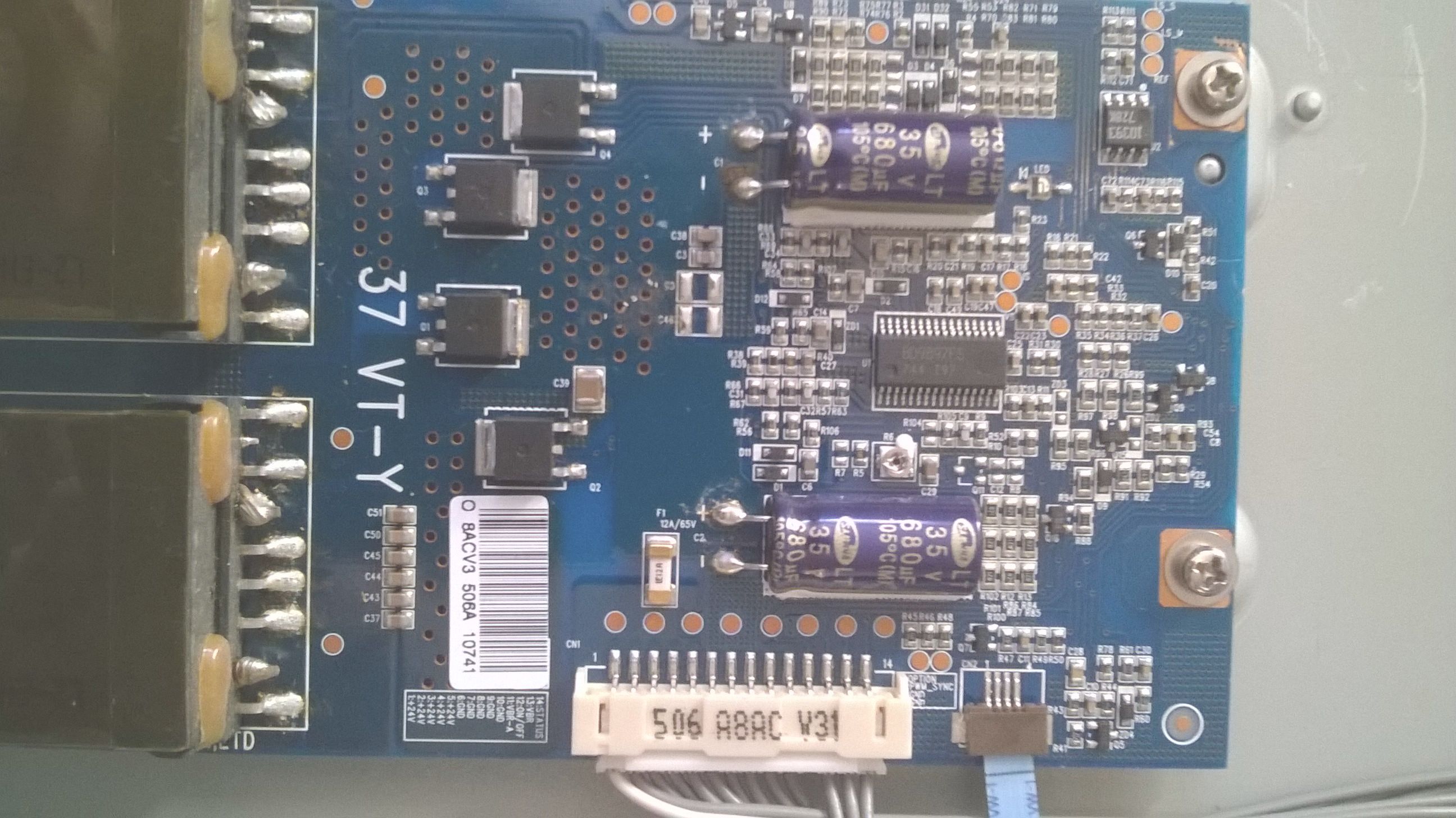

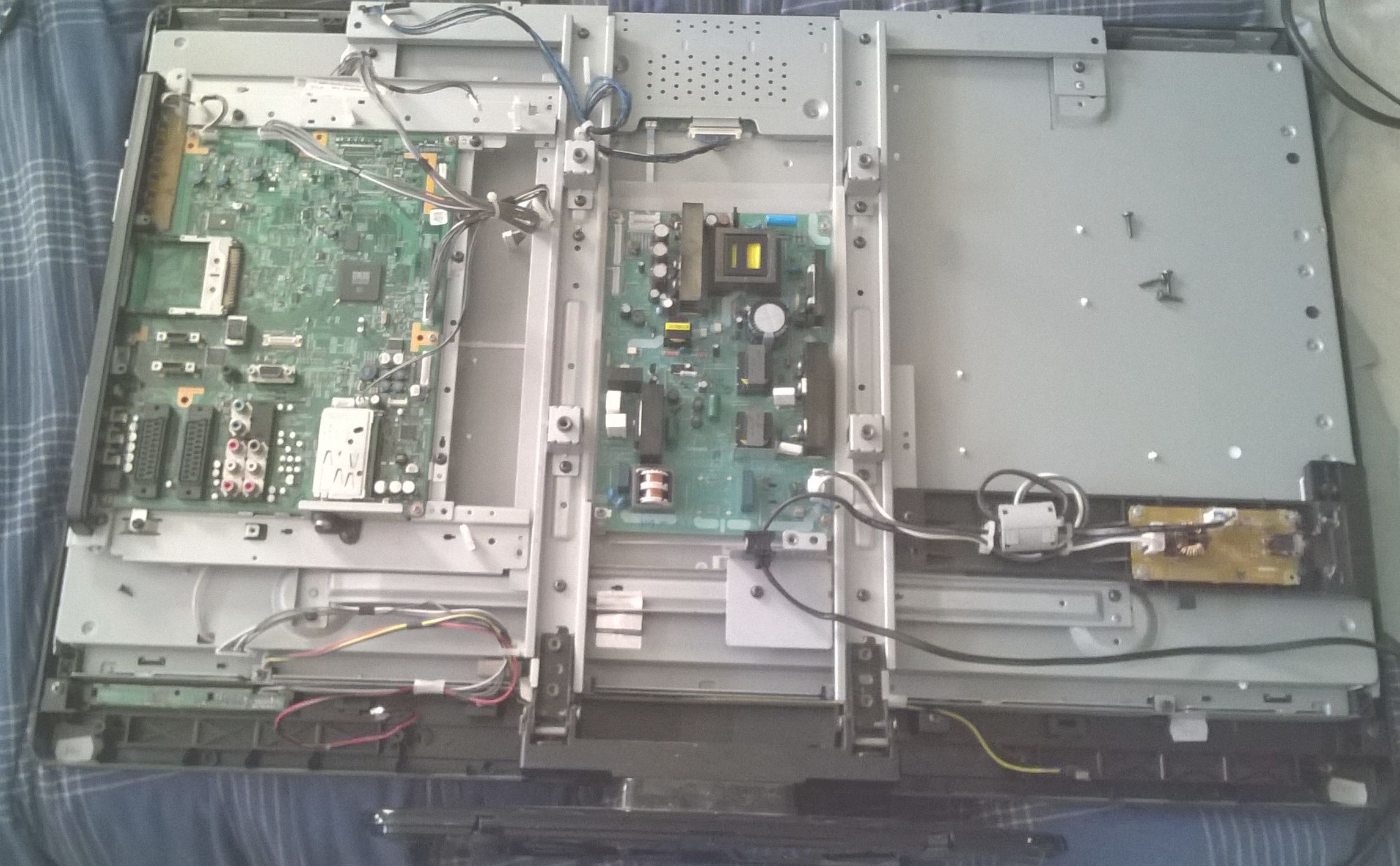

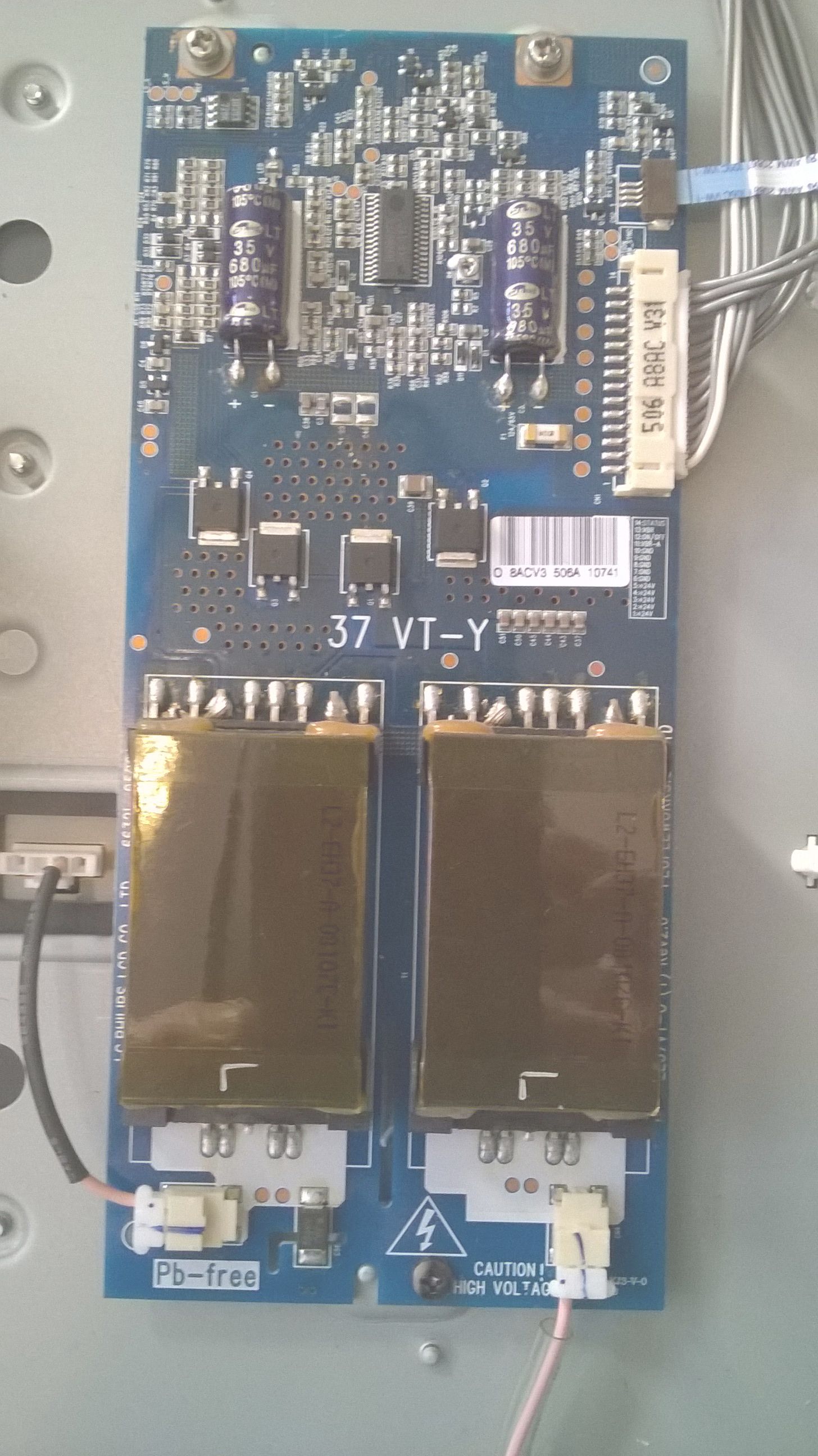

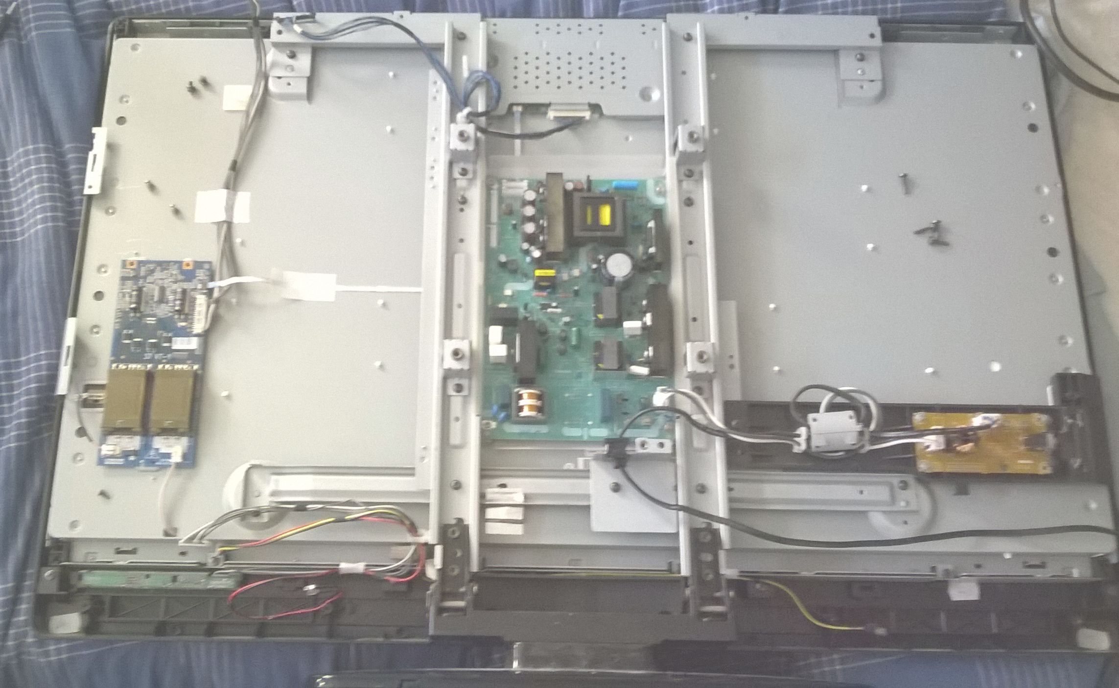

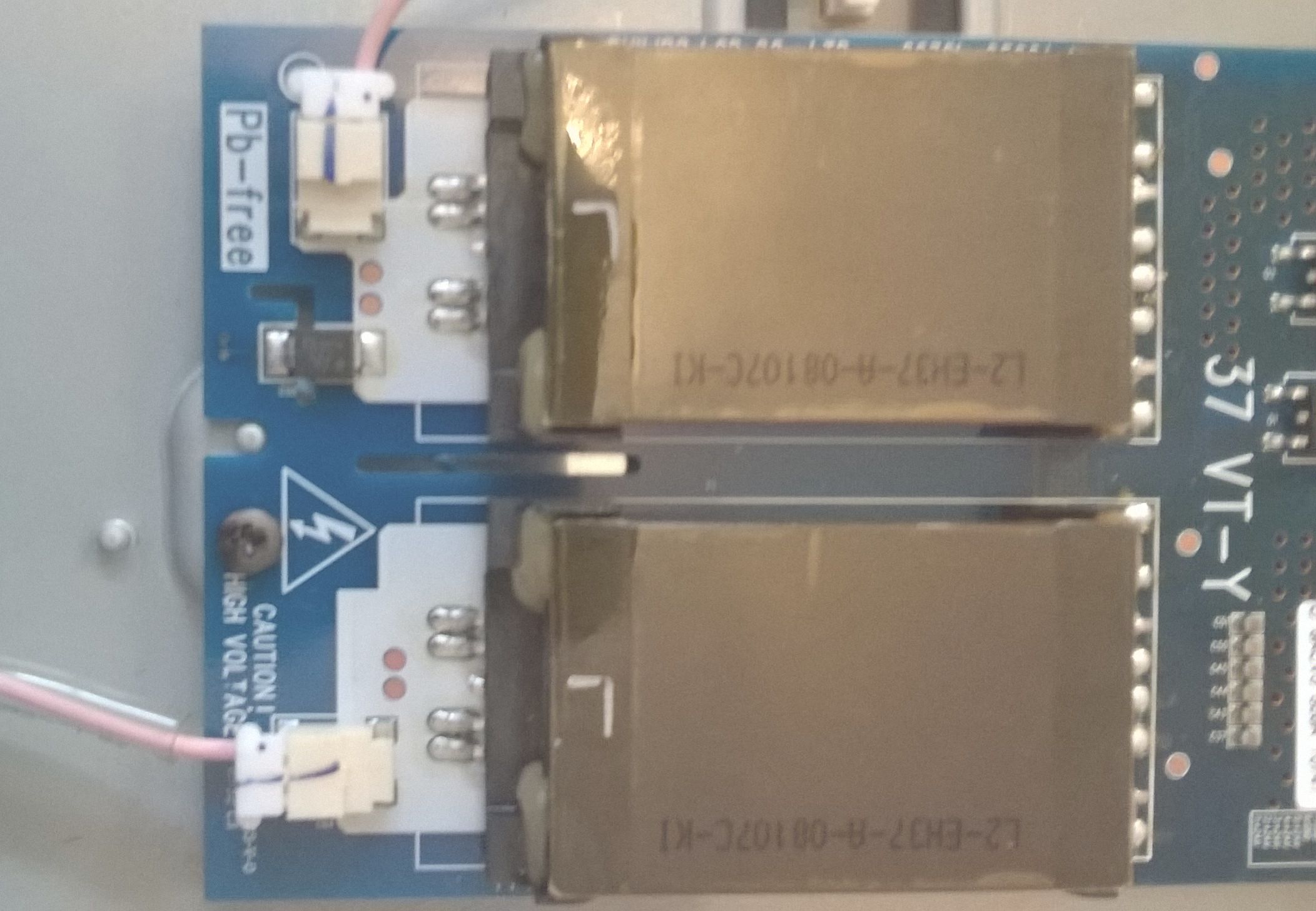

                How bout a picture of the whole back of tv, if there's a cover on the inverter board take it off before the picture, check the fuse on inverter F1.
                • Ukdigger
                  • May 2020
                  • 121
                  • England
                  Re: TOSHIBA 37CV505D TV turns on and then off
                  The fuse F1 is good and the caps esr is 0.0002 and 0.0007 (inverter board)
                    The ribbon cable with the blue end looks really crooked.

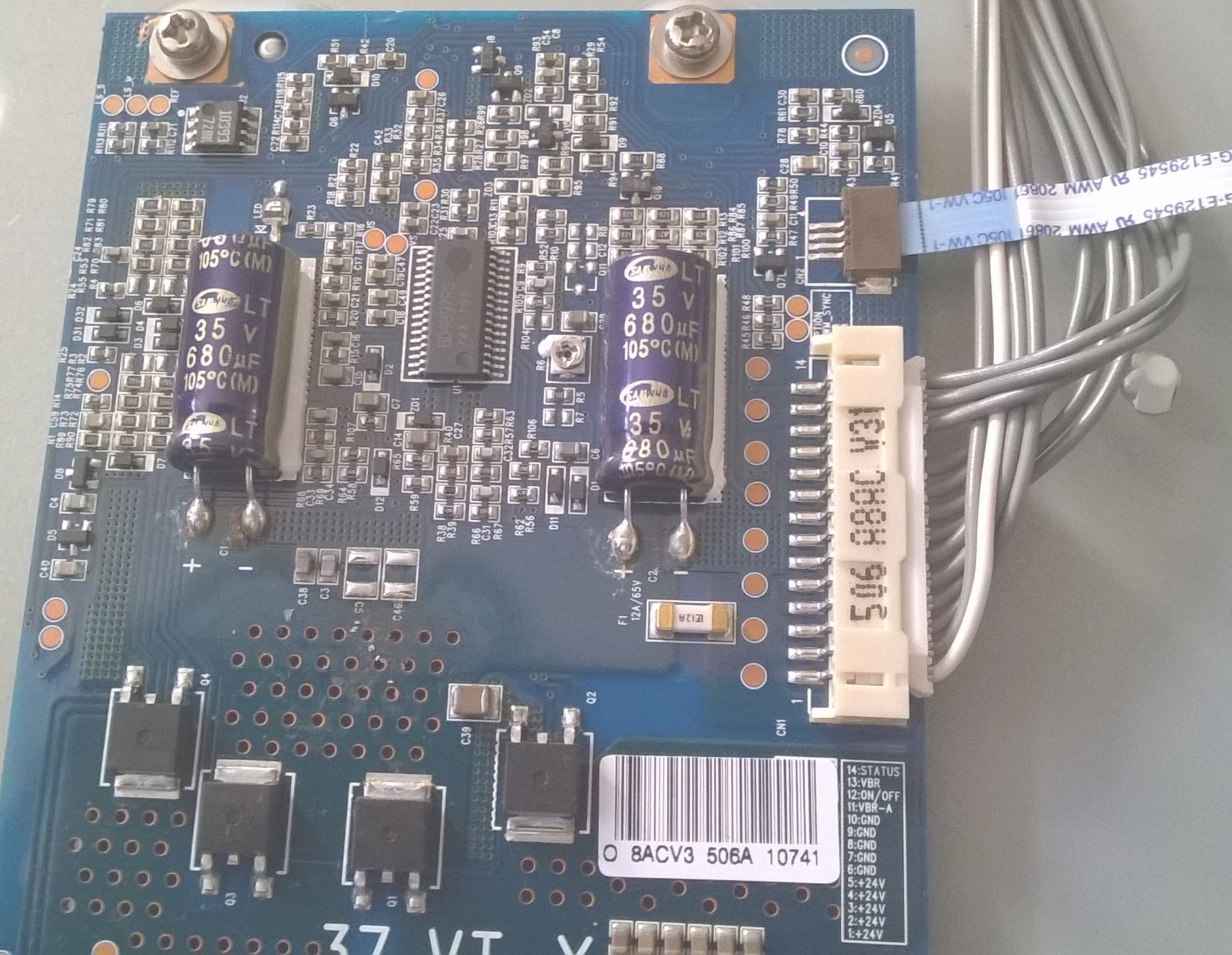

                      do both of the invertor transormers measure the same resistace as they do fail.

                        Check the PFC in the power supply, what voltage you have on a large capacitor, in operating mode it should rise
                        up to DC 380v - 390v.

                            Reseating the crooked cable made no difference.

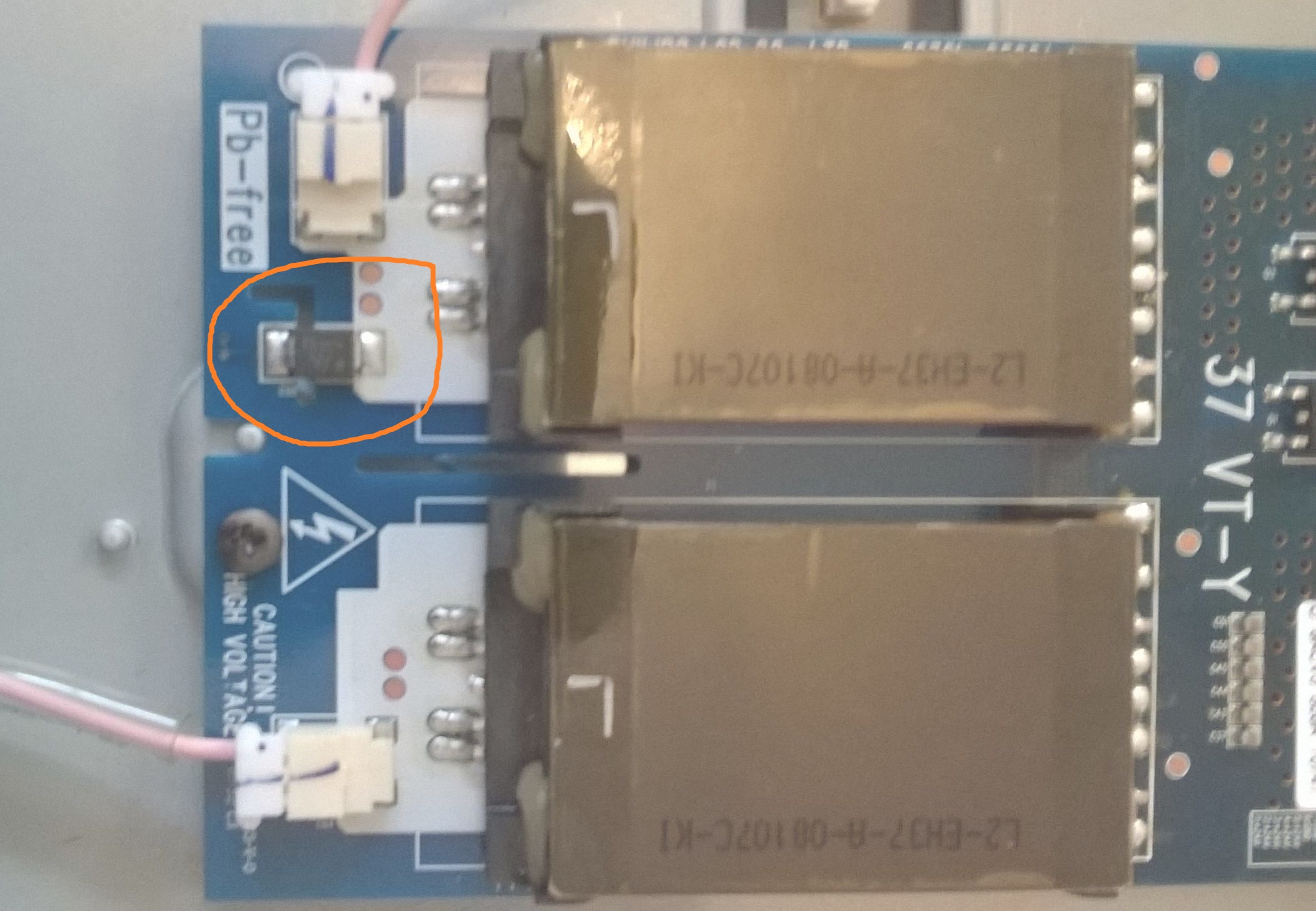

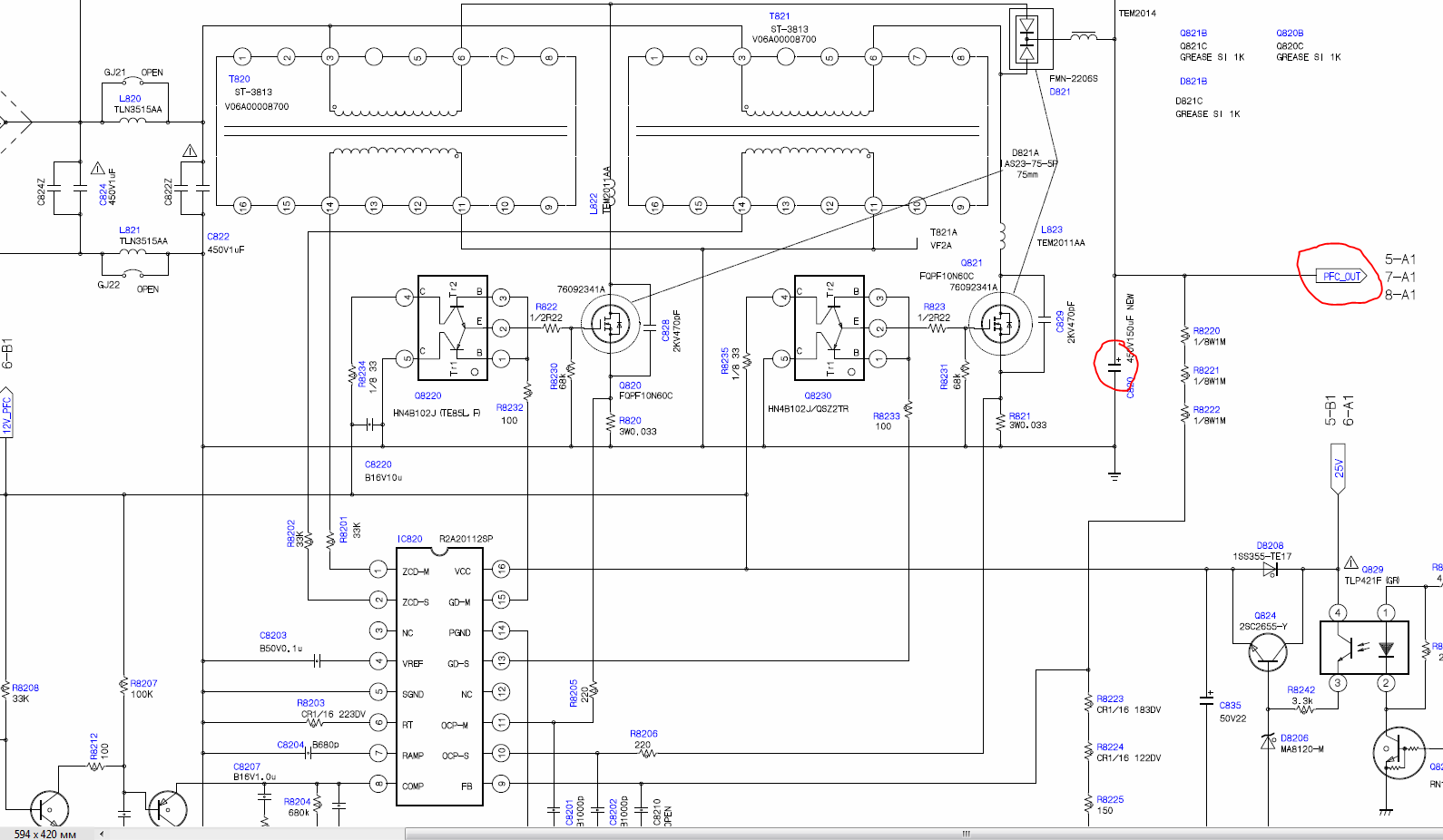

                            Before I go any further, I'm not getting any reading on this cap 4kv 22j 70
                            • nomoresonys
                              • Jan 2013
                              • 12274
                              • U.S.
                              Read it in ohms if you didn't, it is labeled starting with a Cxx?
                              • Ukdigger
                                • May 2020
                                • 121
                                • England
                                I got 10.3 in the 20k scale
                                • nomoresonys
                                  • Jan 2013
                                  • 12274
                                  • U.S.
                                  Don't seem bad, what do you get on 200 ohm setting?
                                  • Ukdigger
                                    • May 2020
                                    • 121
                                    • England
                                    nothing on 200 or 2k
                                    • nomoresonys
                                      • Jan 2013
                                      • 12274
                                      • U.S.
                                      You know, I forgot what they should be, let me see if I have one to measure.

                                        Check the four mosfets on the inverter for shorts.
