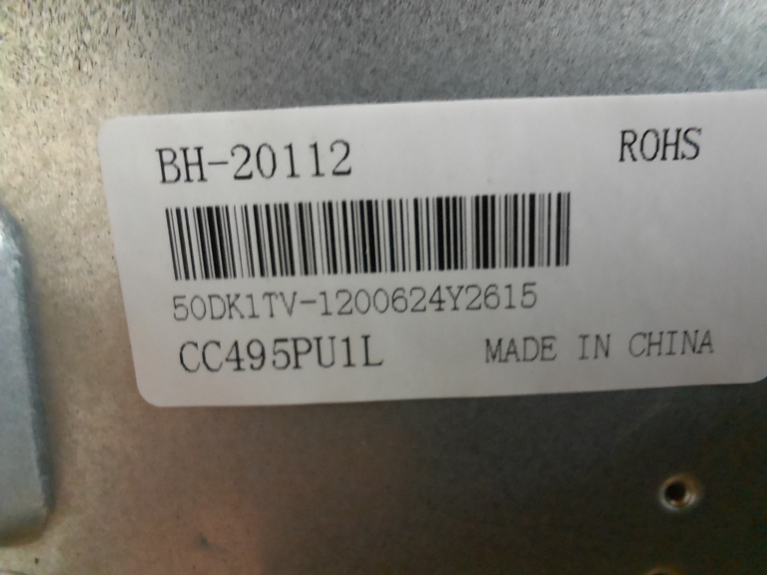

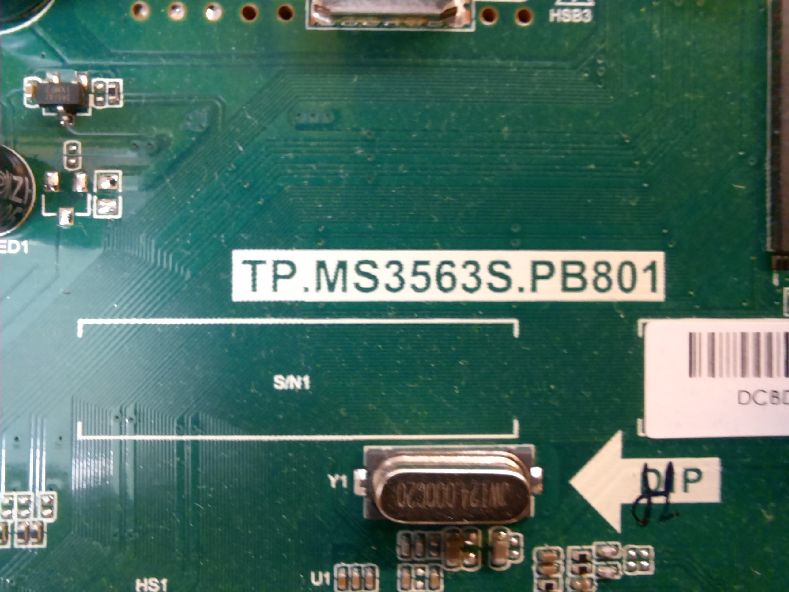

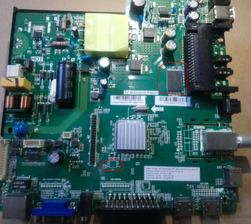

    Hi all
    This set stuck on INITIALISATION display , with no BL , but proved they are ok by powering on tester .
    Have 2 of these sets with same issue .
    See pictures for details .

        Not heard of www.ebay.co.uk ?? There are plenty of mainboards there at reasonable prices. You will unlikely get any firmware for this model as I doubt if Veltech TV's are supported by anyone online and the information is on the nand ic, so you cannot easily read the data unless you have the appropriate kit to read it from a working board.

            If it's good will try to pull data from the NAND FLASH , to see if i can recover faulty one.
            Hoping either my TNM or Dataman programmer can do it .

                chinese use always SPI flash W25Q64 as i remember.. yours issue at the this spi man not NAND. take out one and dunmp it or you are telling here you dont have SPI on boards ?? .
                  Re: VEL50FO01UK , Veltek TV software please
                  This motherboard has Nand without Spi flash.

                        Cheers guys , but everything including screen data stored on the TSOP 48 packaged NAND flash chip , which i suspect is issue on original faulty board .
                        Hi Vince , can post a picture on Monday , but really just getting a solarised picture due to incorrect display settings .
                        If anyone could supply me a good NAND dump matching display you would be my best friend.
