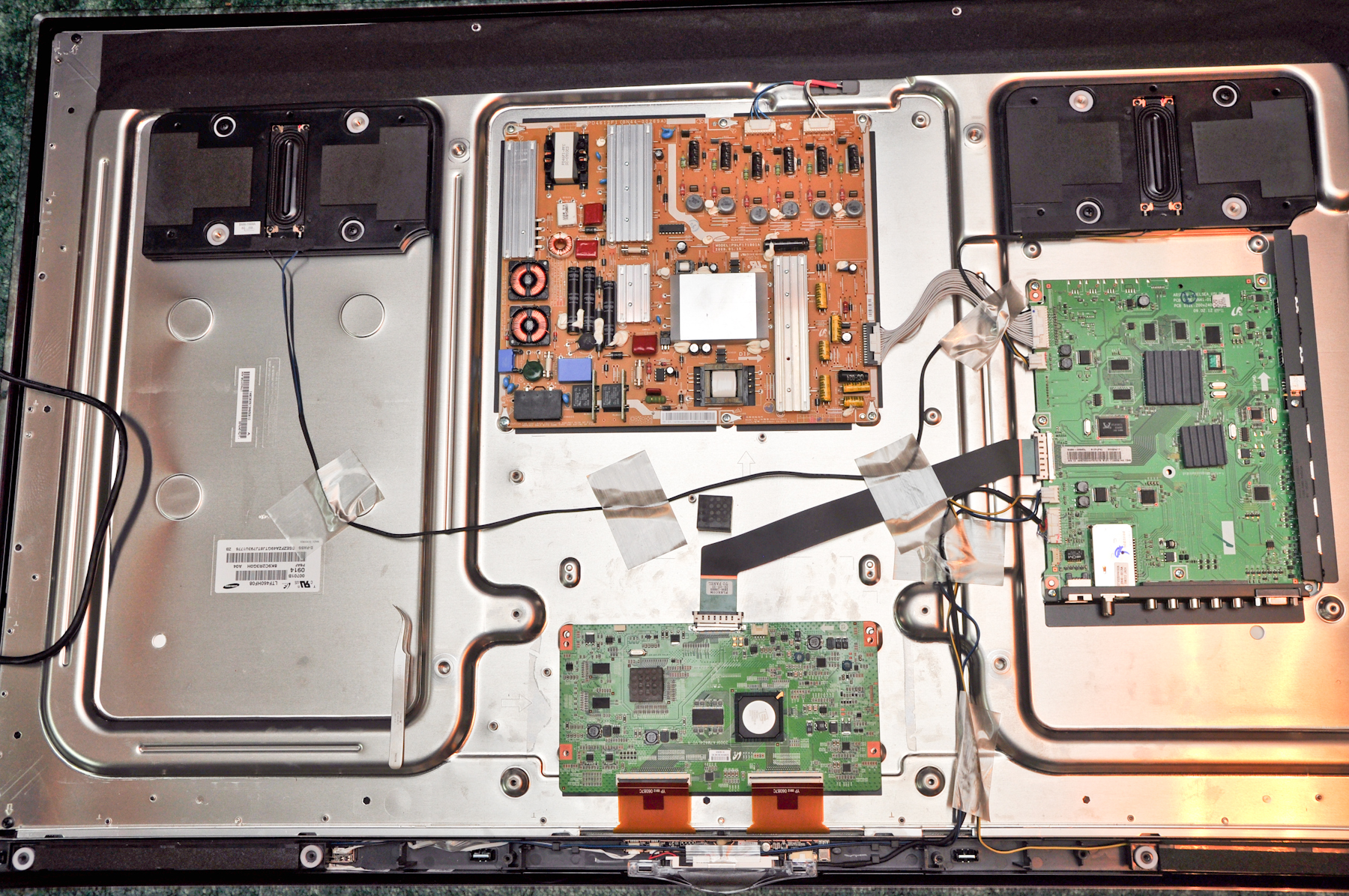

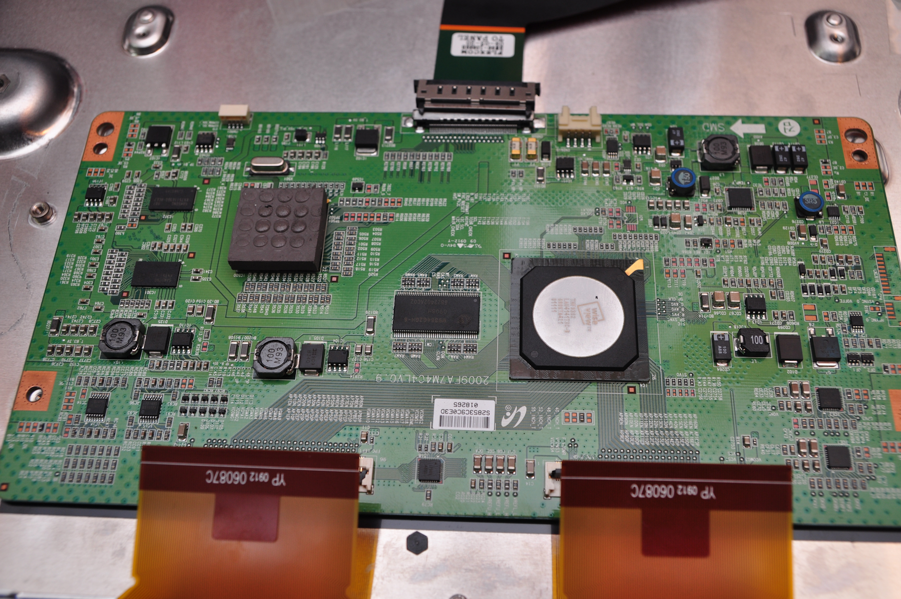

    Hey guys, I have a Samsung UN46B7000 LED Tv. Powers on, audio works but no image. I can see the backlighting on the display but no image comes on. I narrow it down to the T Con board (BN81-02358A). But I just want some advice from you guys before I order the part. And possibly troubleshoot the board itself.

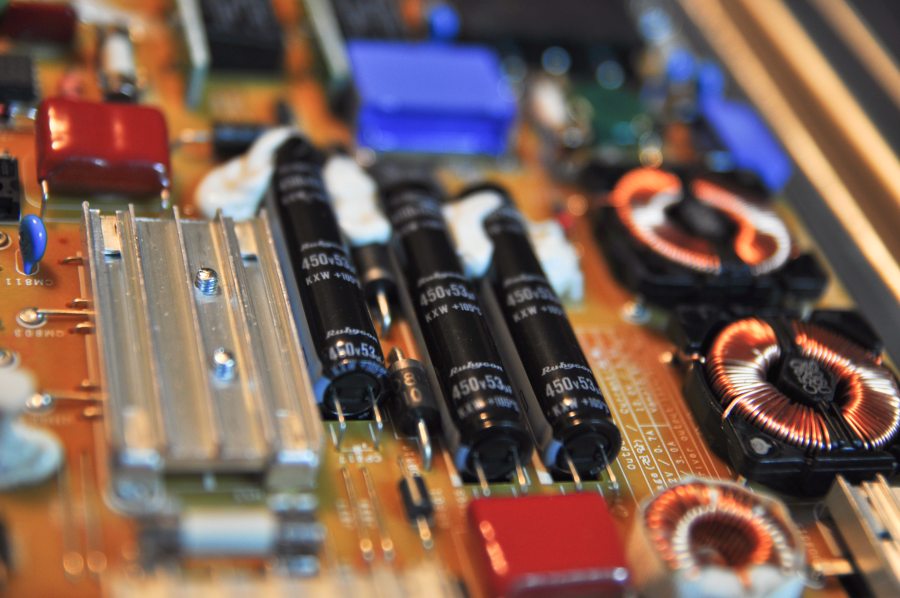

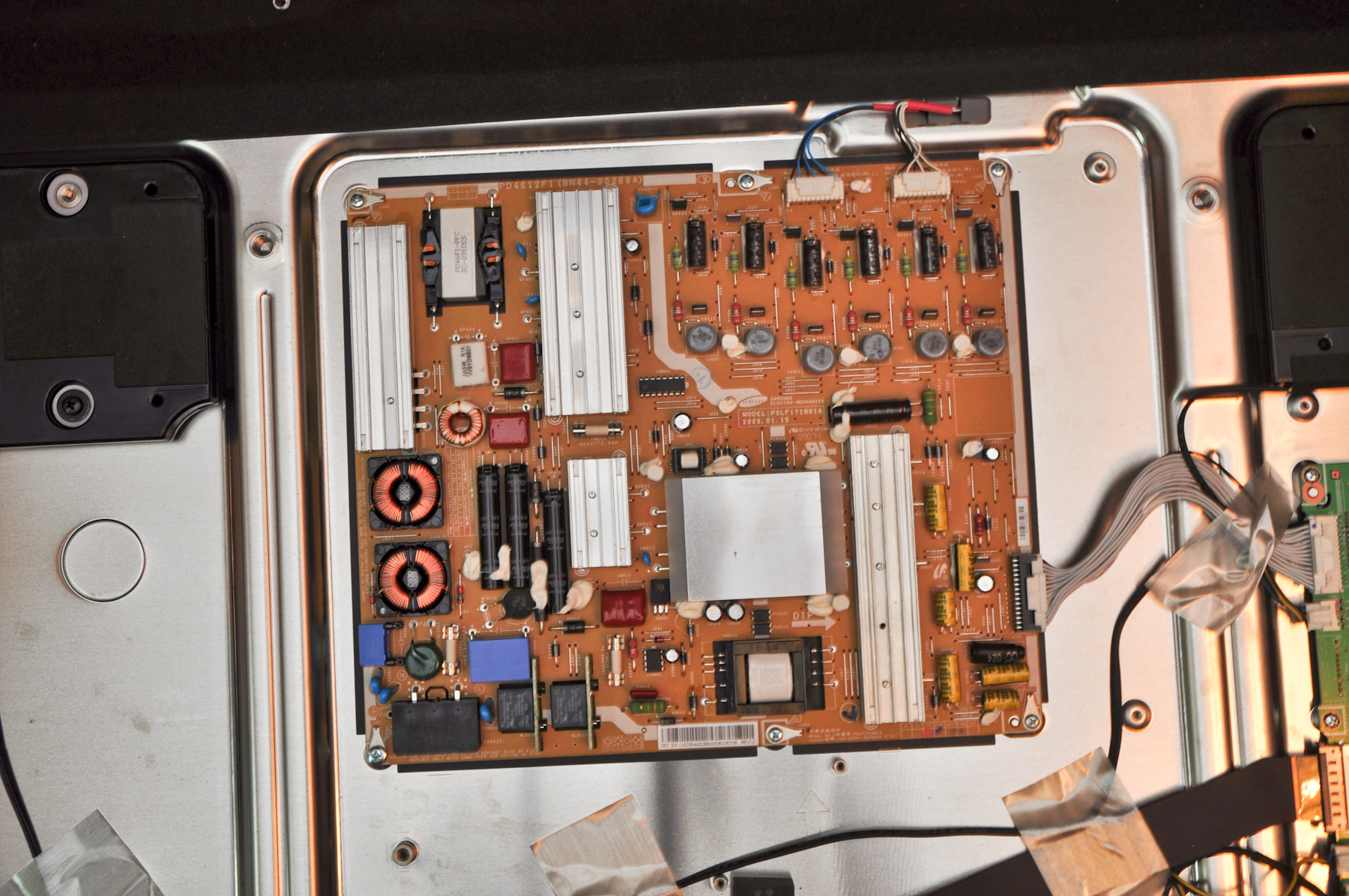

    I'm interested in the unusually long and narrow black electrolytics flat against the board. The manufacturer appears to be Rubycon, but what are the series of these units? Never before have I seen units which are unusually long and narrow.

      I was looking at those also. There are a number of innovations on this set to make it ultra thin. Stupid, in my opinion. But the marketing department has to have something to brag about and justify the high premium for LED backlit TVs.

        The T-Con board is the cheaper of the two on Ebay at $30. However, If you find that it isnt working after that one, the other (pd4612f1) is about $69. I'd be inclined to simply buy both for $100, and then use them to help me find the defective component on the other set. Then sell them on Ebay. Hopefully, you dont get some defective boards from an ebay seller that had the same exact problem.

          those strange caps reminded me of those nippons..
          http://bambooz.pytalhost.net/badcaps/NCC-FTK.jpg
          Brand: Nippon ChemiCon
          Series: FTK
          Capacity: 82uF
          Voltage: 400V
          Temp: 105°C
          Grid: 7.5mm
          RoHS compliant: No
          i could get 10pcs. of those for 8eur (about 10US$) incl. shipping. stumbled across them in a shop..

            They are Rubycon KXW

                Sorry, earlier I had said that you could get the UN46B7000 t-con board for 30 something but that was the UN46B6000 T-con board. A whole different design than the one you need.
