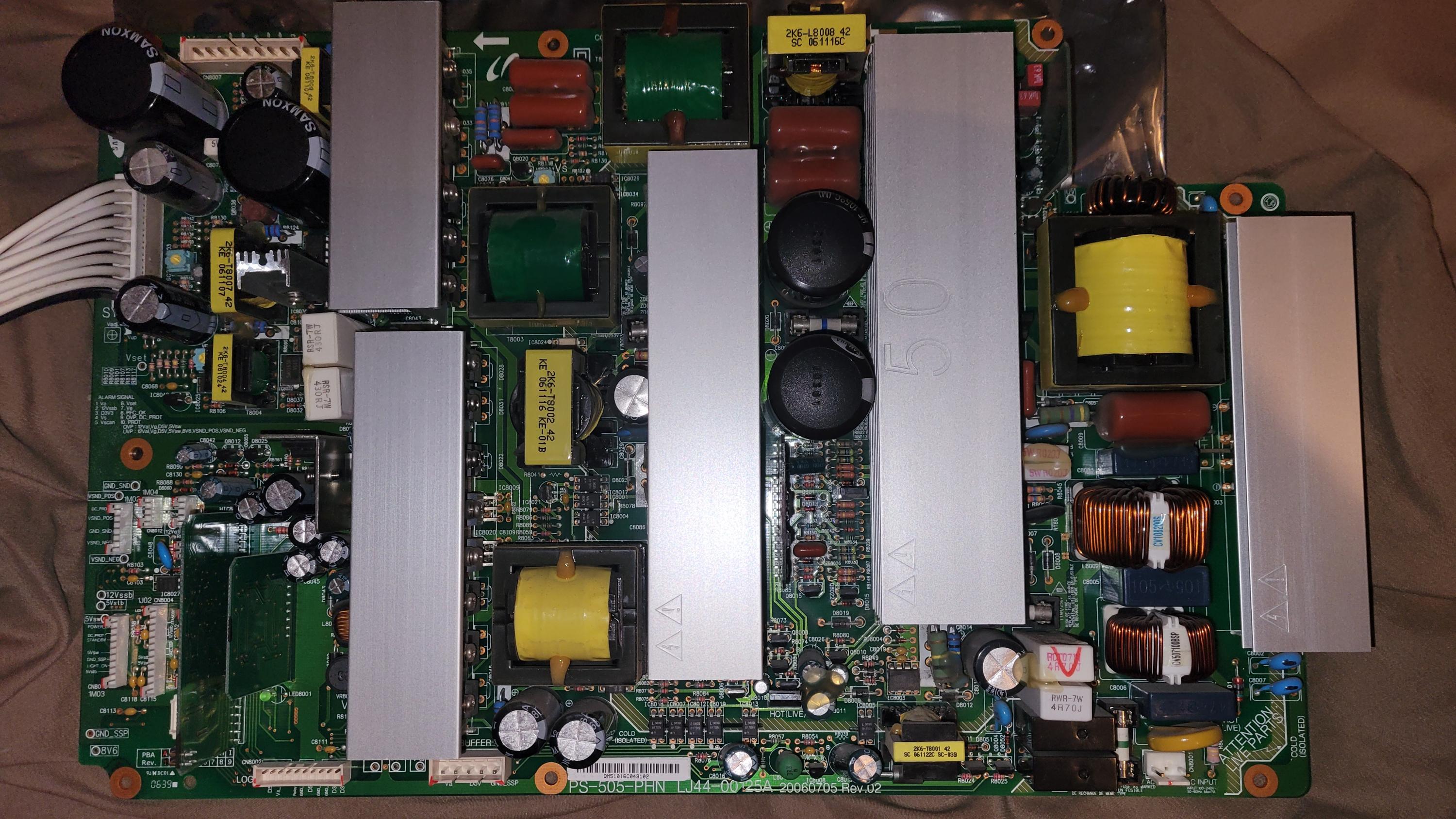

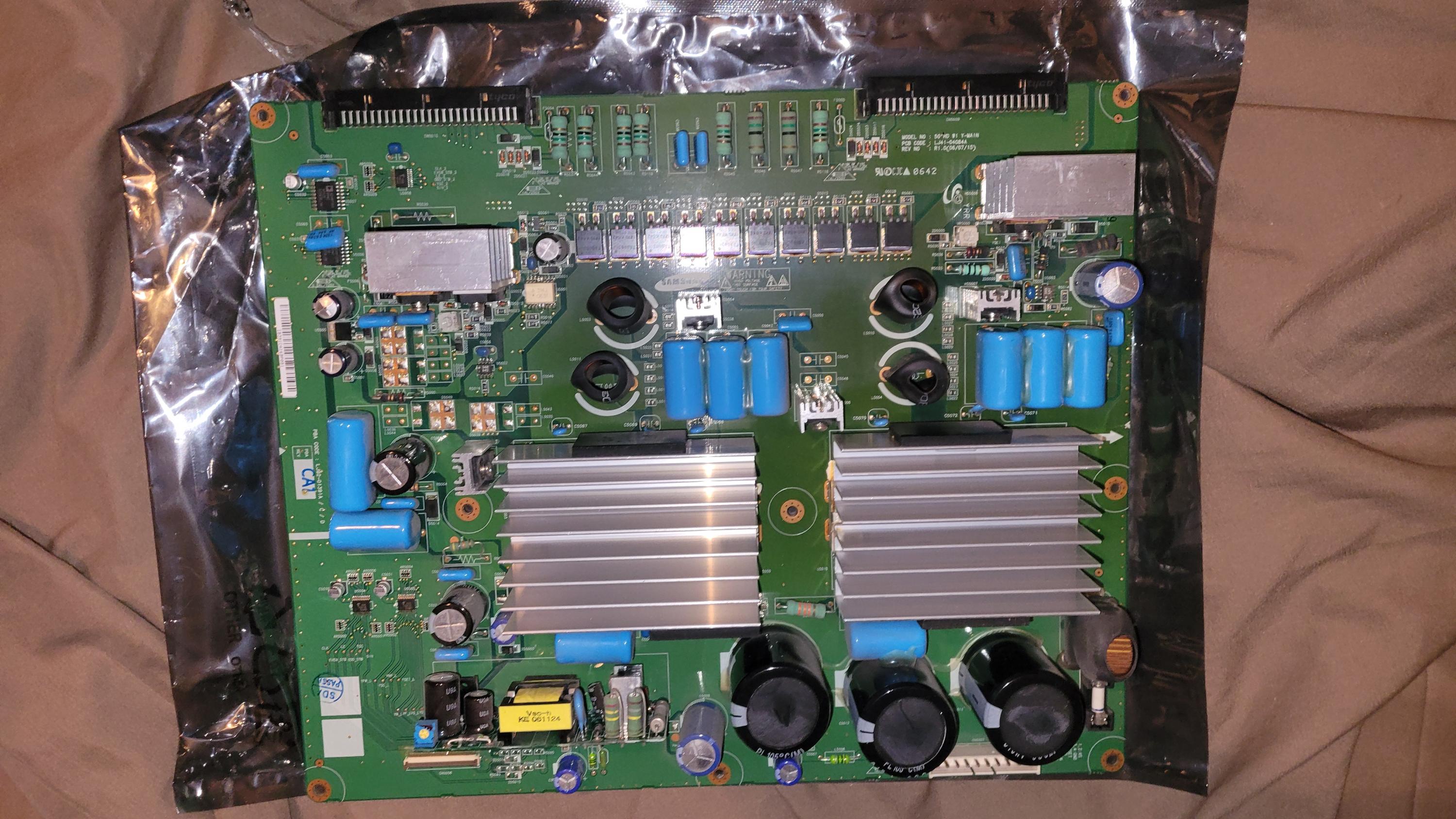

    Here are the boards
    LJ44-00125A Main
    LK41-04084A Y

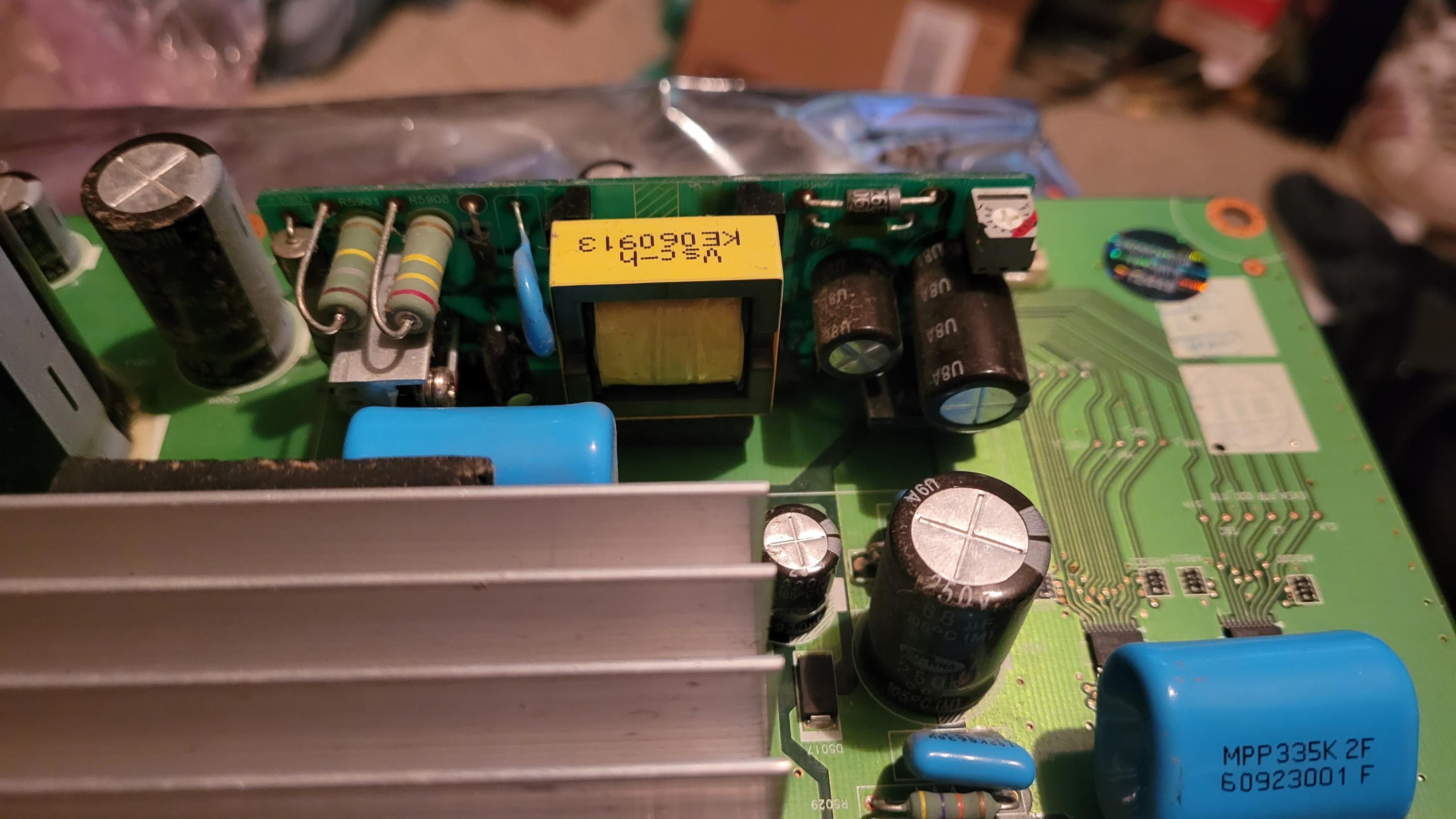

    It takes an hour to get to screen (audio stays on during this time). Customer said used to take 30m and got longer.
    I notice a few bloated on the Y board and like one on the main.
    Refurbished pictures show those replaced, some at higher uf, but should I replace the main caps? Main and medium? Total recap?

      Re: Phillips 50PF7321D/37 Plasma slow reboot
      Keep in mind I've never been familiar with plasma before, especially any TV this old
      Oh shit one of the bloated ones is under a Fet heatsink on the main. I'm going to have to unscrew all the fets, and unsolder the heatsink?
        Looks like you have a couple more caps bulging out that need replaced.
          Being a plasma and probably at least 10 years old, a total recap might be best policy.
                    Welp I did a near 90% of the Y and power board, and it still does it.
                    It was heavily used for 15+ years, I think the screen has lost it's plasma
                          In that case I would desolder and measure the caps you have not replaced yet on a ESR and capacitance meter.
                          Because if you're anyway going to scrap it there is nothing to loose and you might just find that there is some other bad cap somewhere.
                              Well a way to narrow it down would be to heat the boards one by one to around 50°C or so.
                              If heating one of them shortens the startup time significantly you know you found your culprit.
