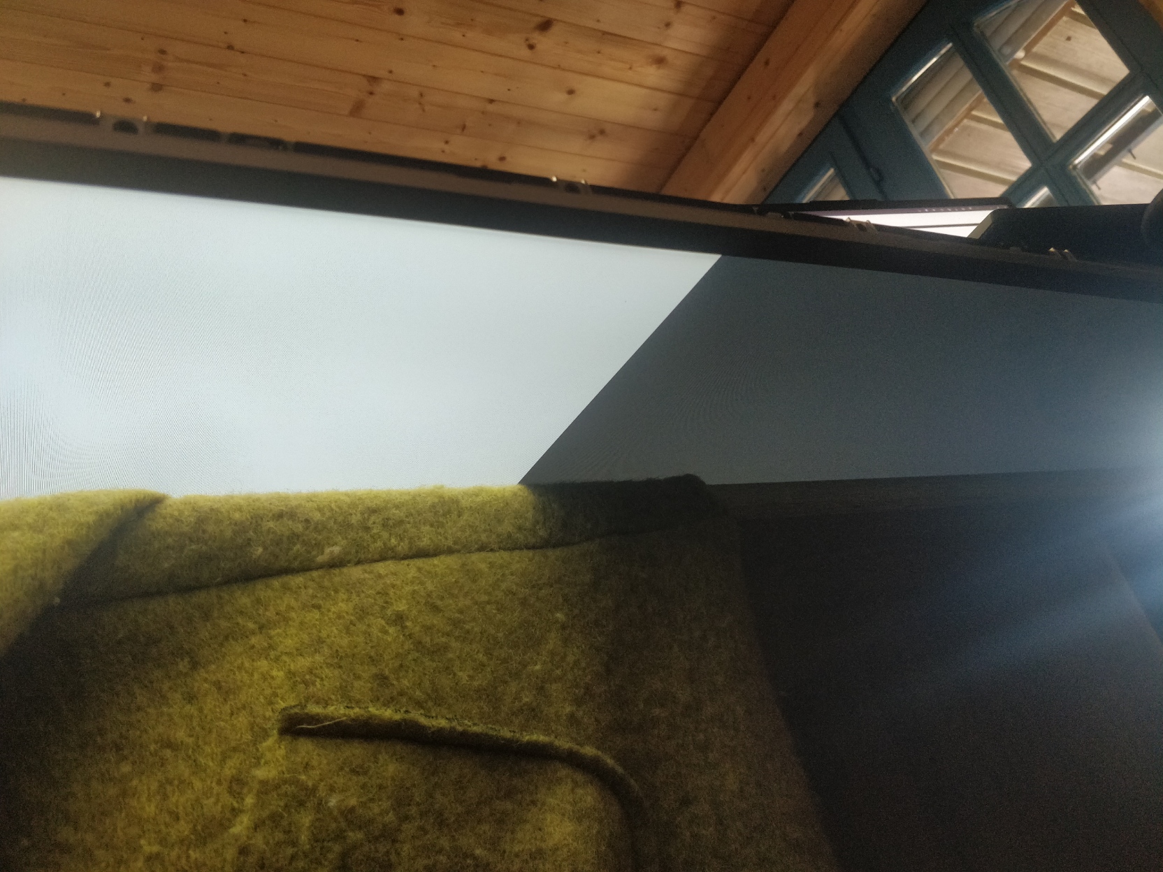

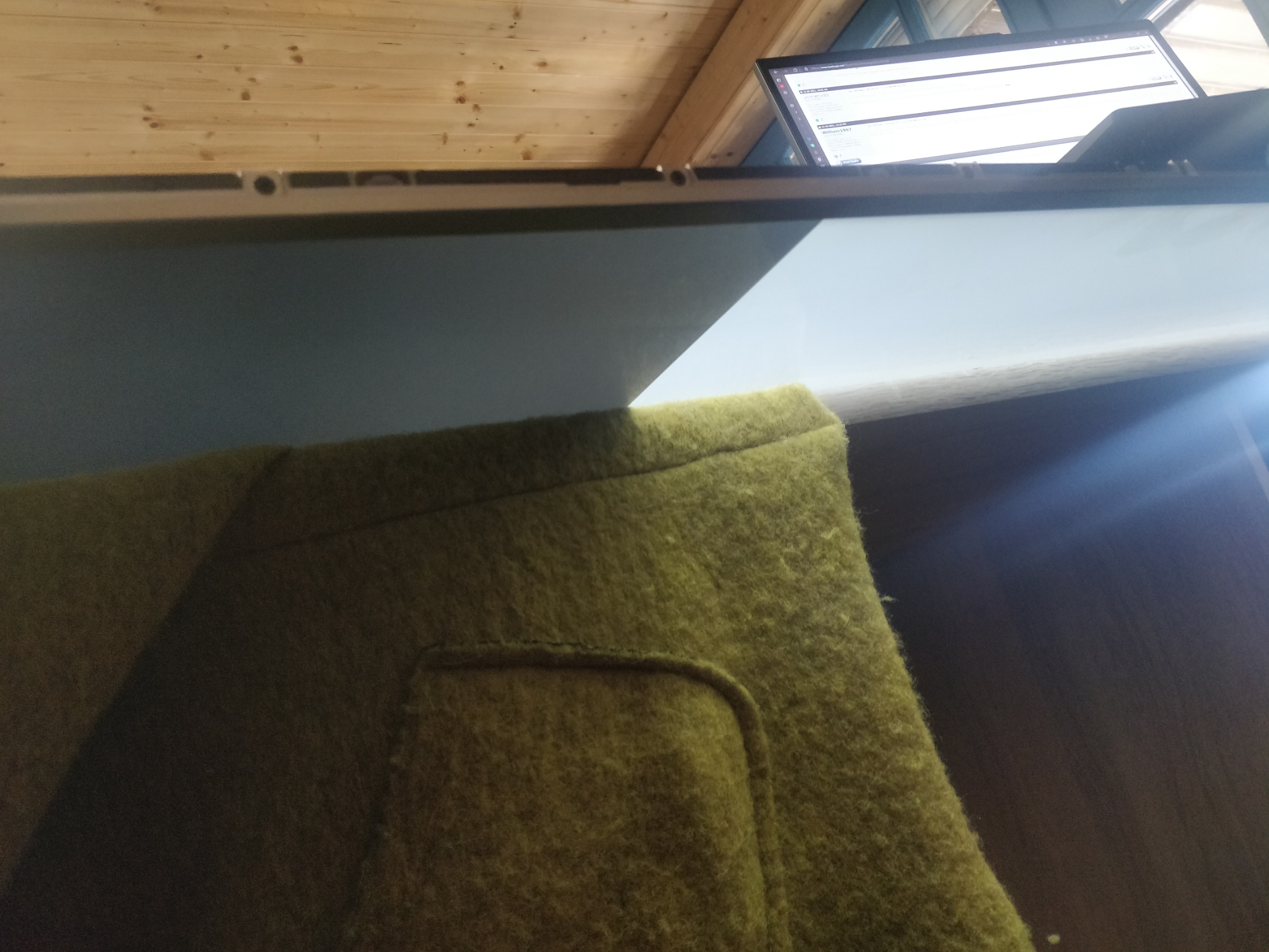

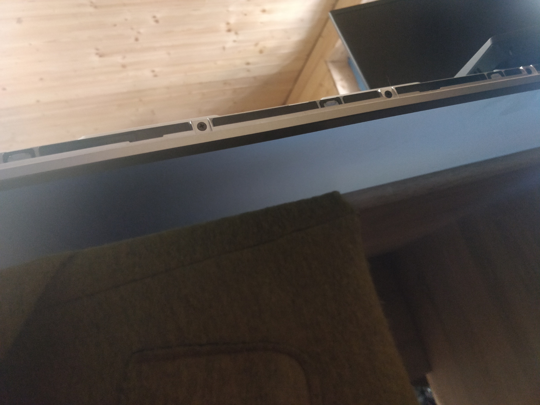

              Disconnect one of the flat cables between the t-con and display and see what happens, after that do the same with the other cable, don't forget to disconnect the power cable when you disconnect any of the cables. Make pictures and upload them here.

                Re: Phillips 55PUS6561/12 EEPROM Bin file
                Sorry for the late reply but I was away during the weekend.
                Left flat cable disconnected:
                Right flat cable disconnected:
                Both disconnected
                Thanks for your help!
