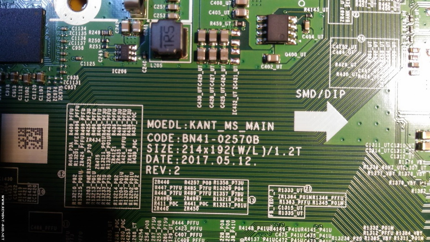

    Most likely, the firmware of the standby mode IC1604 25Q40 flew off, as always in the "MU" series. Do you have main BN41-02570B?
    From post 1 i think his main is a BN94-12295K

      Re: Samsung 65 Dead NO power NO standby light won't turn on
      I mean textolite.
        Originally posted by lotas
        I mean textolite.

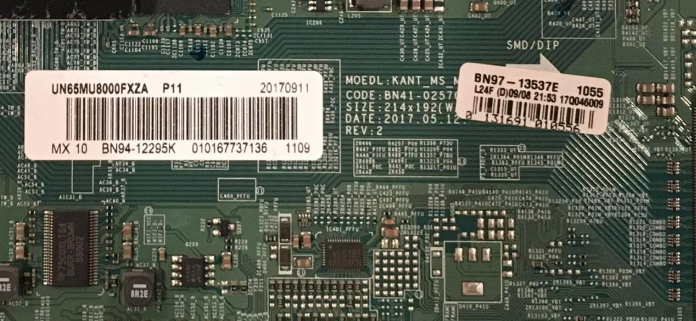

        sorry i get what you meant now post 7 has a picture pity white sticker over that number but from the first few didgits you can see your probably rite.
          Yes, this is it, now it remains to read the data from the IC1604 programmer and put the dump here, I will check it.

            Re: Samsung UN65MU8000FXZA Dead NO power NO standby light won't turn on
            Thanks for replying.
            Those are the exact numbers on my board posted in your image from post #22.

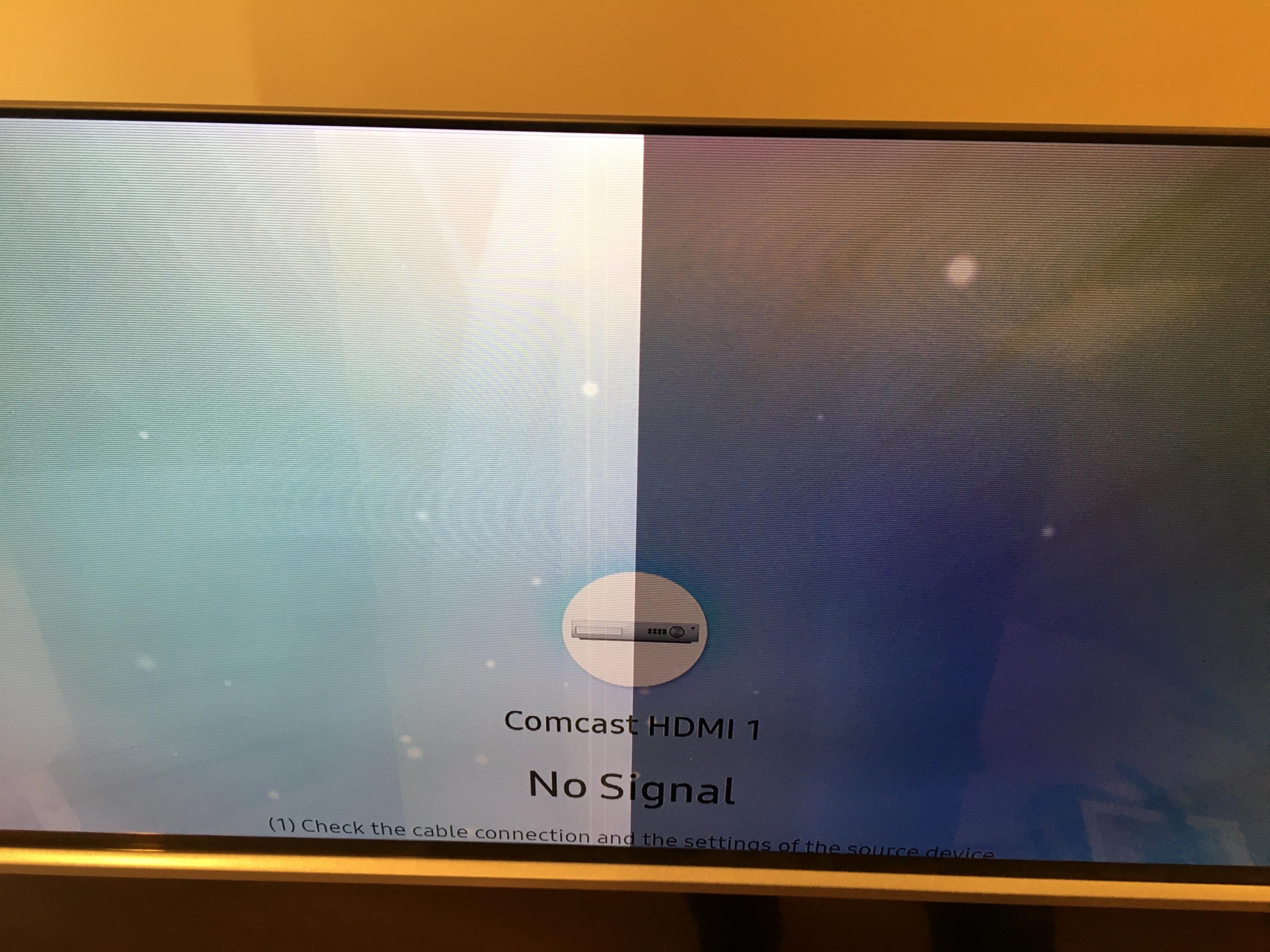

                            Well, almost good news.
                            I got a used mainboard. Installed it. Power is on and picture is up BUT half the screen is darker on one side (some faint lines going from top to bottom on left side of screen when screen is black)
                            Also, the remote only turns the TV on and off. No other functions. I tried taking out batteries and holding power button to reset but it didn't work

                                        #39
                                        Picture is still darker on one half of the screen.
                                        Vertical lines (greenish yellow) on dark half.
                                        tiny horizontal black lines on brighter half of screen
                                        updated Firmware to 1300.3

                                          #40
                                          Thanks again
                                          I'll try and answer multiple questions from above here:
                                          Yeah, sometimes I'm dumb. Just had to pair the remote with the TV.
                                          The TV was working PERFECT before the power outage.
                                          I bought the EXACT same board that was in the TV.
                                          I reset when I got the screen up. Half the screen is still darker. Attached photo below.
                                          The backlights seem to be working good. They appear to be the same brightness when viewed from the rear of the TV with back off.
                                          Is part of the used board I got bad?
                                          Internet says bad T-con board causes split screen but I don't think this TV has a t-con board or it's part of the MB
                                          thanks again
