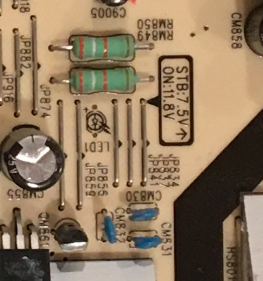

            I did find a "pin" in the middle of the power board that says "stndby" 7.5 ON 11
            Not sure what this is called - a pin? it looks almost like a staple that's about an inch long. How do I test this? set meter to VDC, Ground the black meter probe to the body of the TV and touch the red probe to the staple/pin (it's in the middle of the board and doesn't have a cable or anything near it.

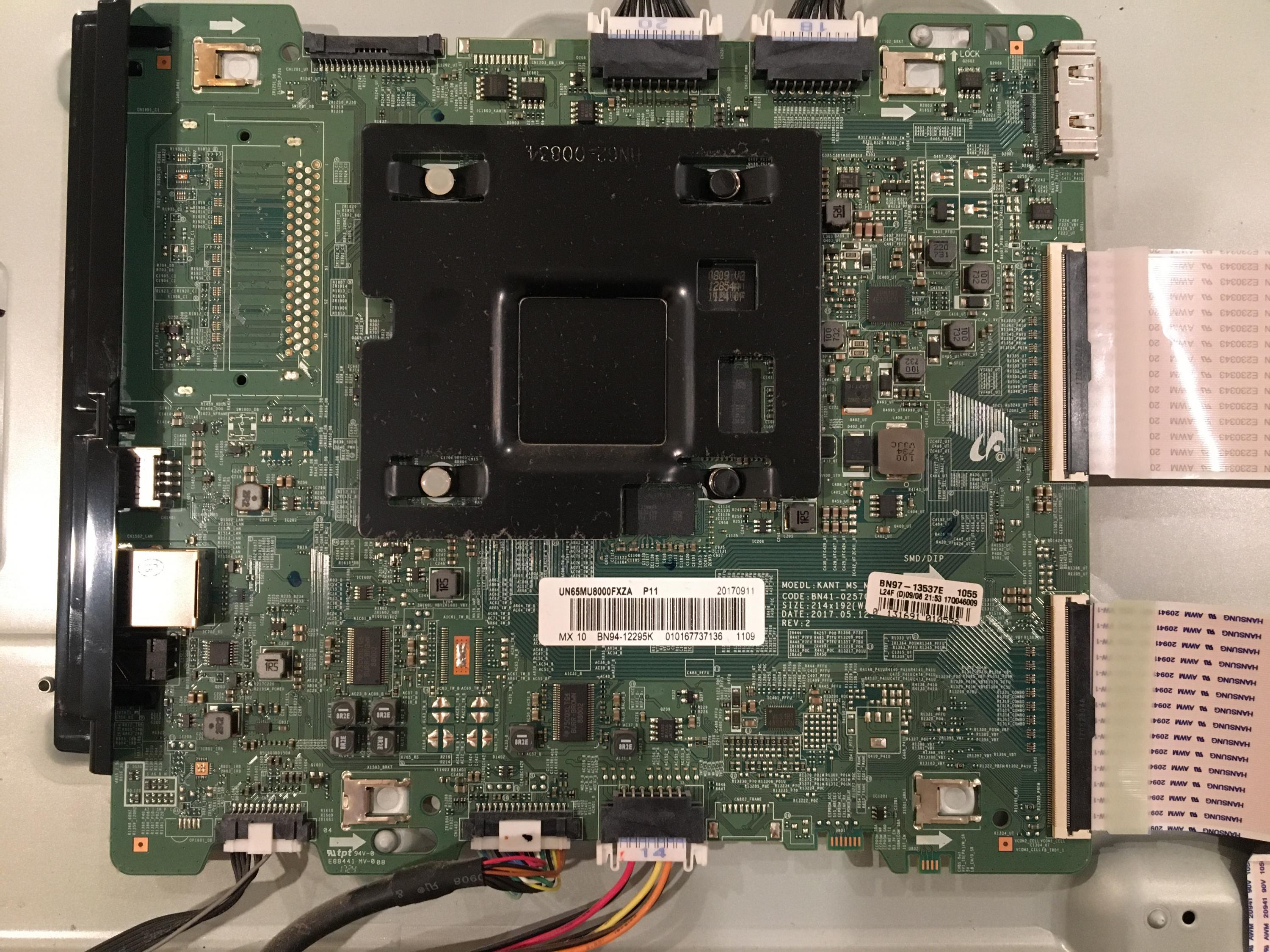

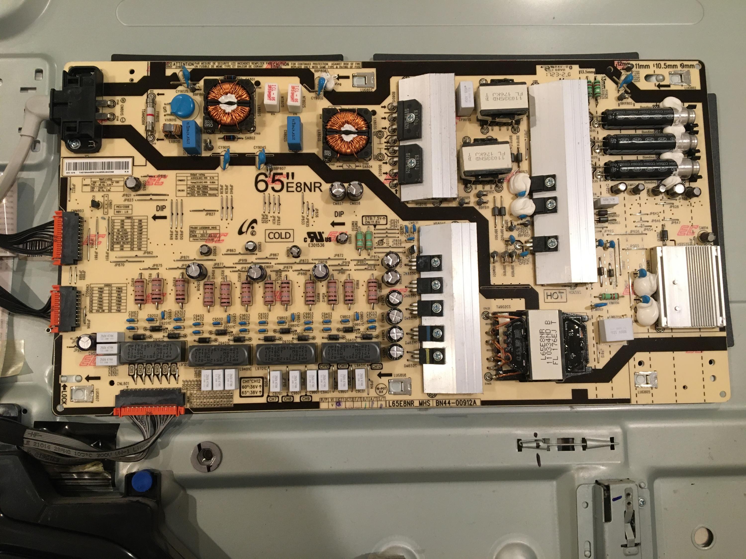

              Need some pictures of connectors and boards.
              • rgla
                • Nov 2021
                • 23
                Re: Samsung 65 Dead NO power NO standby light won't turn on
                Here are the images.
                Thanks for the help.
                  You can measure the voltage on that link and see if it is at 7.V volts when in standby and 11.8V when out of standby. Meter set to dc voltage and can use the chassis as ground.

                    Thanks for the follow up help. Here are the voltages I got on the standby link (jumper?) (HOT side of board)
                    The TV was not ON. It was just plugged in. It won't turn on so I'm not sure how to assess the info from the board:
                    According to the board it should be 7.5 standby and 11.8 on.
                    With the main board connected the voltage was 9v
                    Withe the main board DISCONNECTED the voltage was 12.85
                    somewhat similar to what I was getting at the cable connection pins.
                    Still not sure if the power on/off connection cable pin is supposed to be 96 and then down to 4.5
                      That does not appear to be hot side. All voltages on that side taken from cold side ground as on pads for screw holes.
                          Sorry. You are correct. This is on the COLD side.
                          I put the black probe in a screw hole on the chassis of the tv.
                          Does any of that matter for the reading?
                            Hot side ground and cold side ground are 2 different things. Your voltage readings are odd. As in 96v doesn't seem valid. Are your batteries good in your voltmeter?
                                Are those voltages with old mainboard or new? Are you sure pin 16 was not .96vdc.
                                • rgla
                                  • Nov 2021
                                  • 23
                                  Old mainboard. I don't have the new one yet. Hard to find and even harder to find someone who wants to look into the problem with the board and fix it.
                                    Seems you have a bad mainboard.
                                        Most likely, the firmware of the standby mode IC1604 25Q40 flew off, as always in the "MU" series. Do you have main BN41-02570B?
