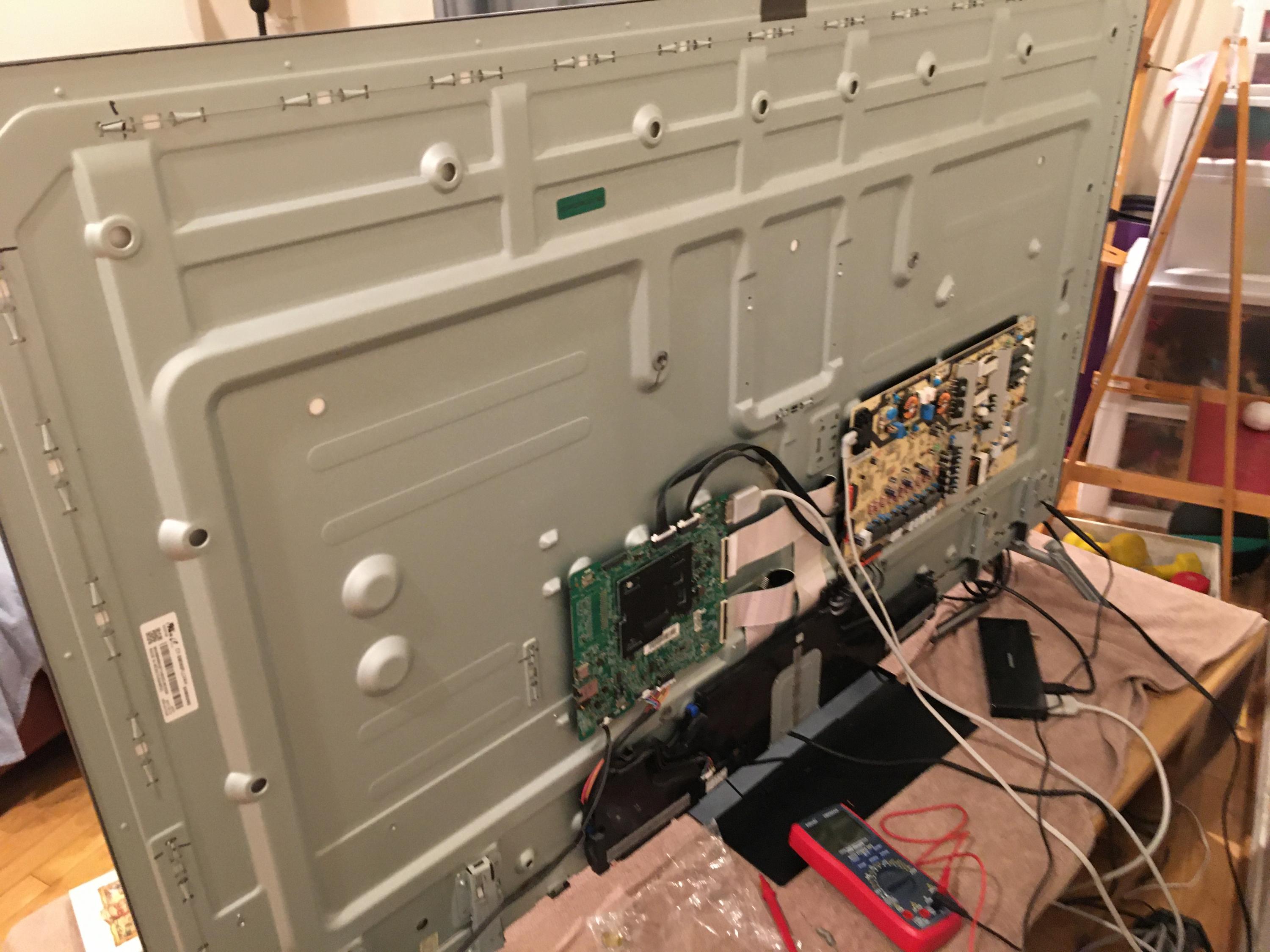

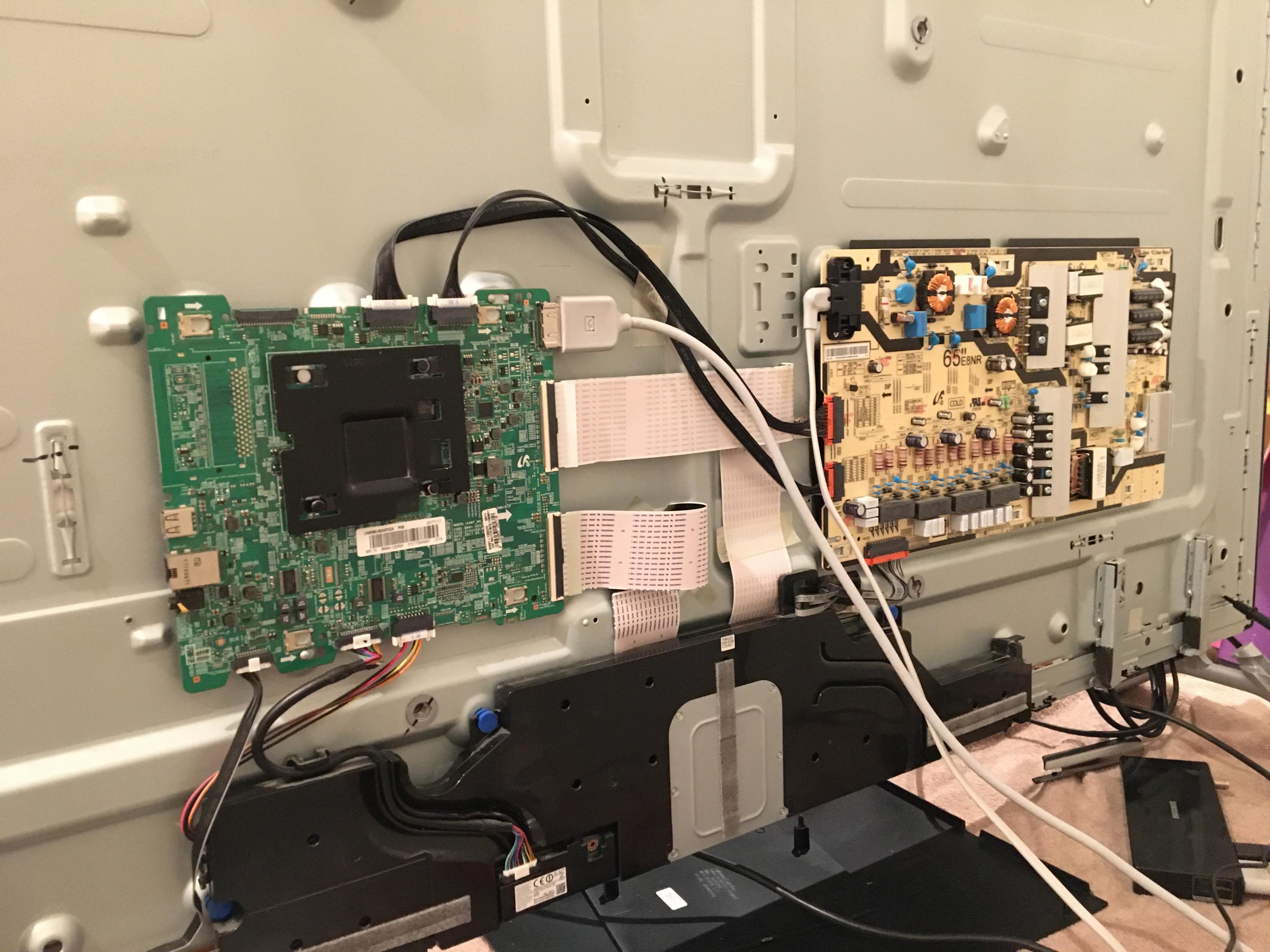

    Need pictures of whole back of tv and boards.
    • rgla
      • Nov 2021
      • 23
      #42

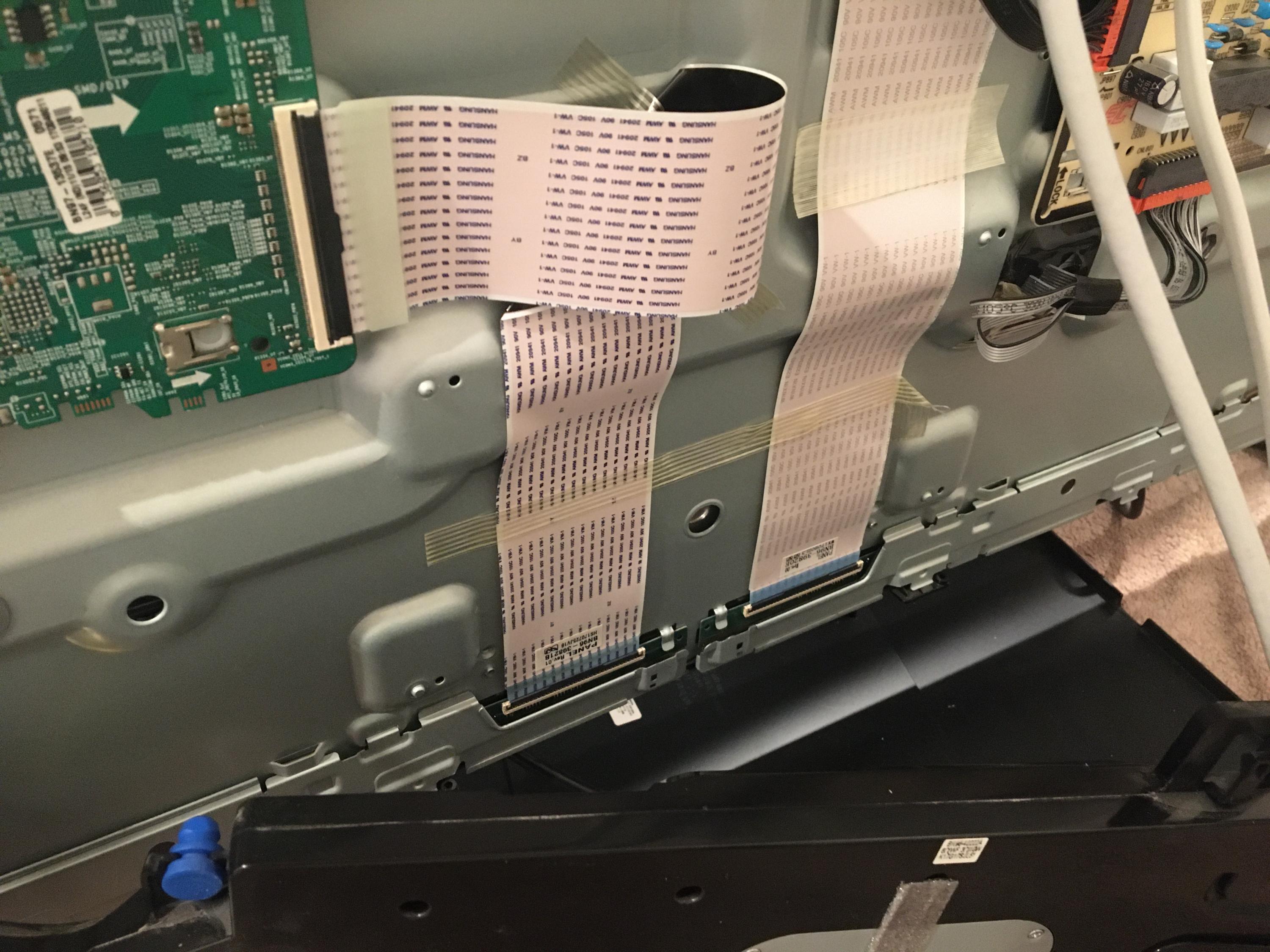

      Re: Samsung UN65MU8000FXZA Dead NO power NO standby light won't turn on
      Here are photos of the TV with the back panel removed
      Close ups of the boards are in POST #8

        #43
        Probably has a t-con beneath the stand.

          #44
          there is a small 1 inch x 3 inch circuit board that the flat ribbon cable goes into at the bottom of the TV. Does this function as the T-con? I think the Tcon is part of the main board on these.

            #45
            Without good pictures. I don't know. Your asking about a board that is covered up.

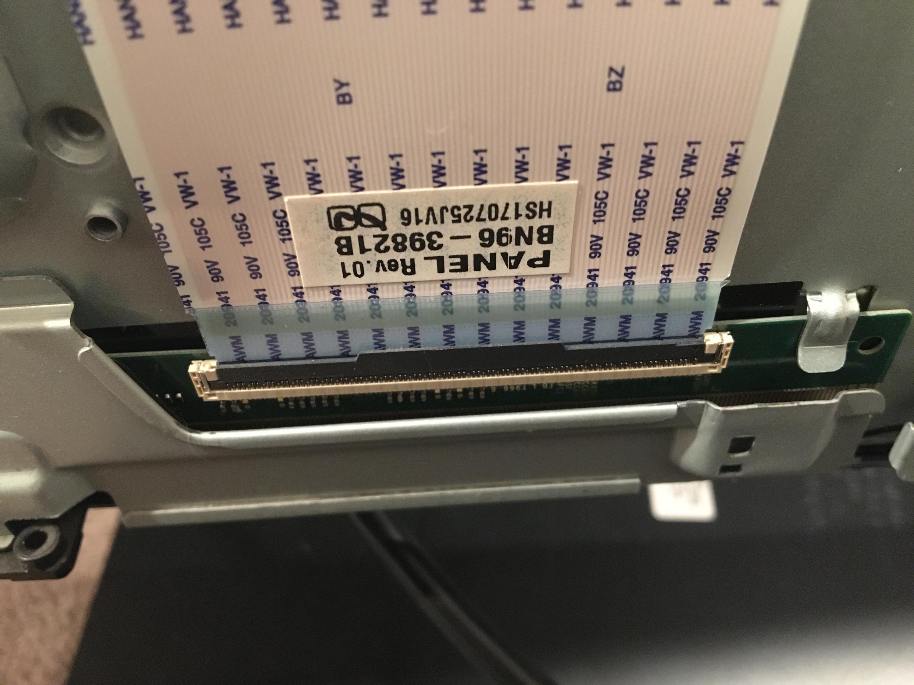

              #46
              Here are some close up shots of the small circuit boards that the flat cables run into near the bottom of the tv. The flat cables run from the MB to these 2 separate small boards.

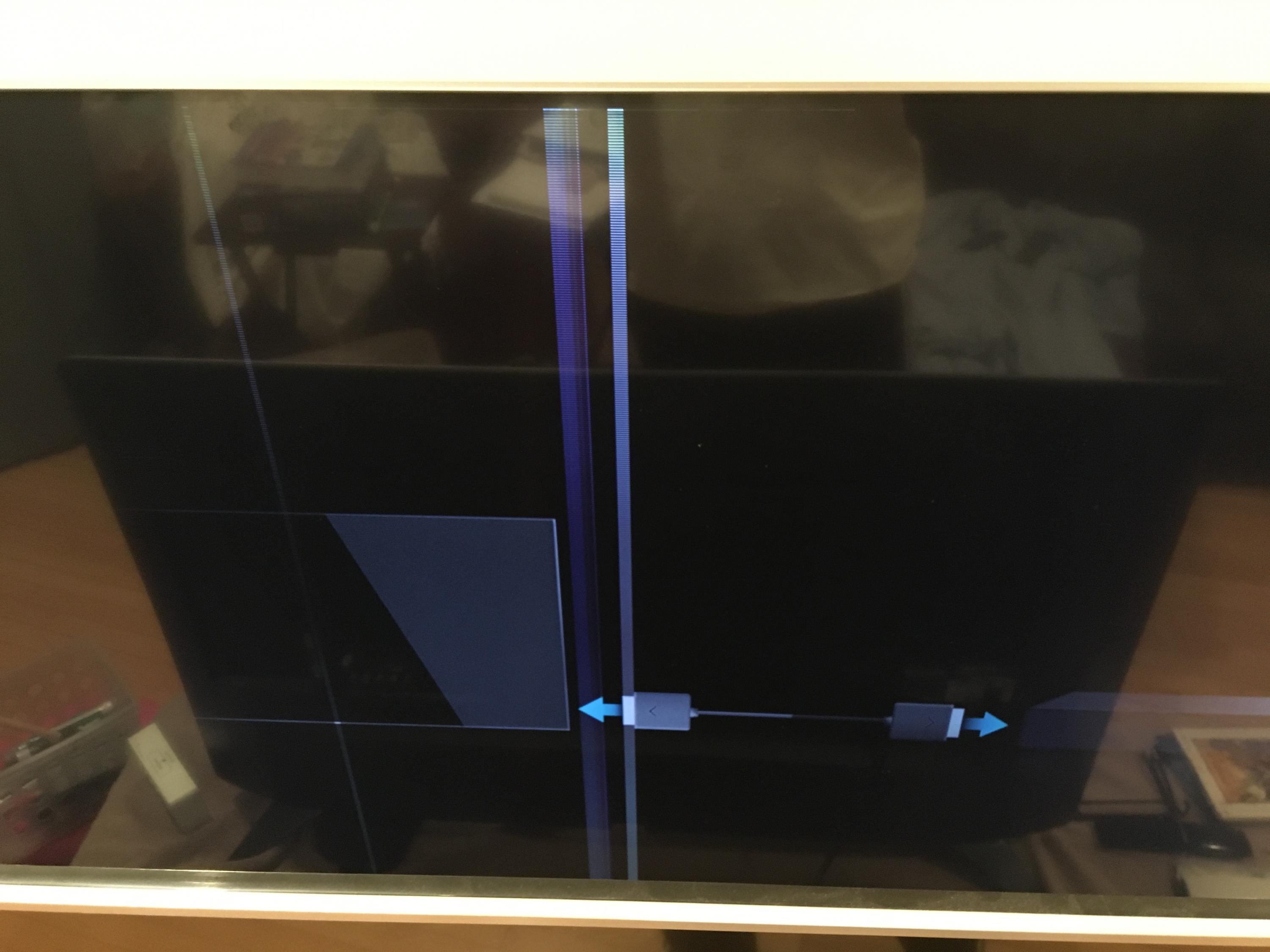

              I cleaned the ends of the ribbon cables with alcohol to see if that would get rid of the yellowish vertical lines and the half dark screen.

                • usa
                #47
                This is like a strip show. Just get a little at a time. I suspect that the t-con is built into the 2 strips behind the metal shielding.

                  #48

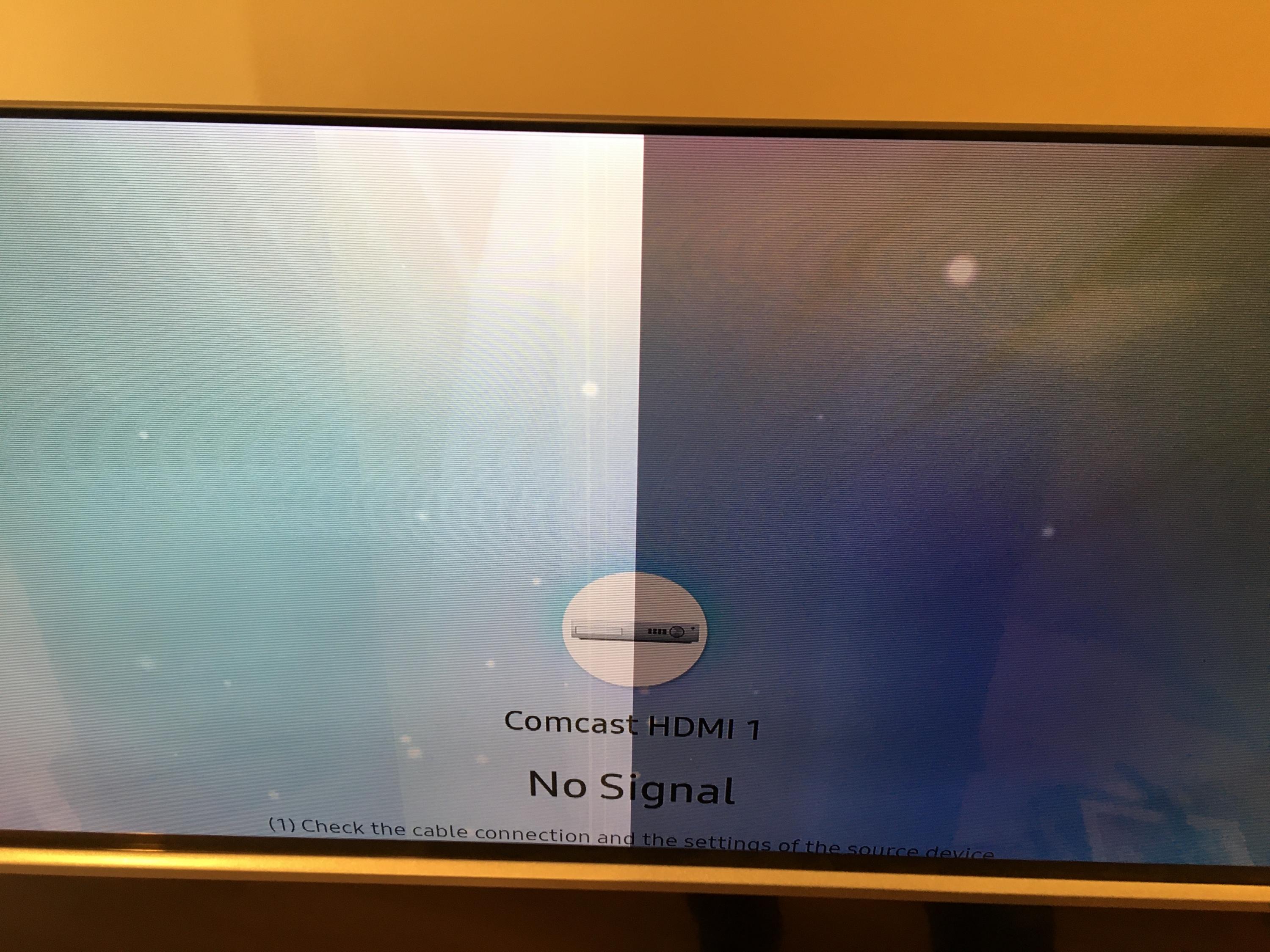

                  I would suspect that those might be T-con but someone else said that T-con is part of the MB on these TVs.
                  Either way, i haven't seen those 2 small circuit boards on any parts list so I'm not sure how to proceed.
                  Could the half and half screen be from the MB, the flat ribbon cables or those 2 tiny boards? There isn't much left beside a panel but all the backlights seem to work fine

                    #49
                    T-CON is on main, check the cable is not damaged, the contact moldings are not displaced, it is better to look under a magnifying glass, whether the cable itself is well inserted and carefully examine the nearby components near the bottom connector of the capacitors, whether they are knocked down, compare with another board with two parties.

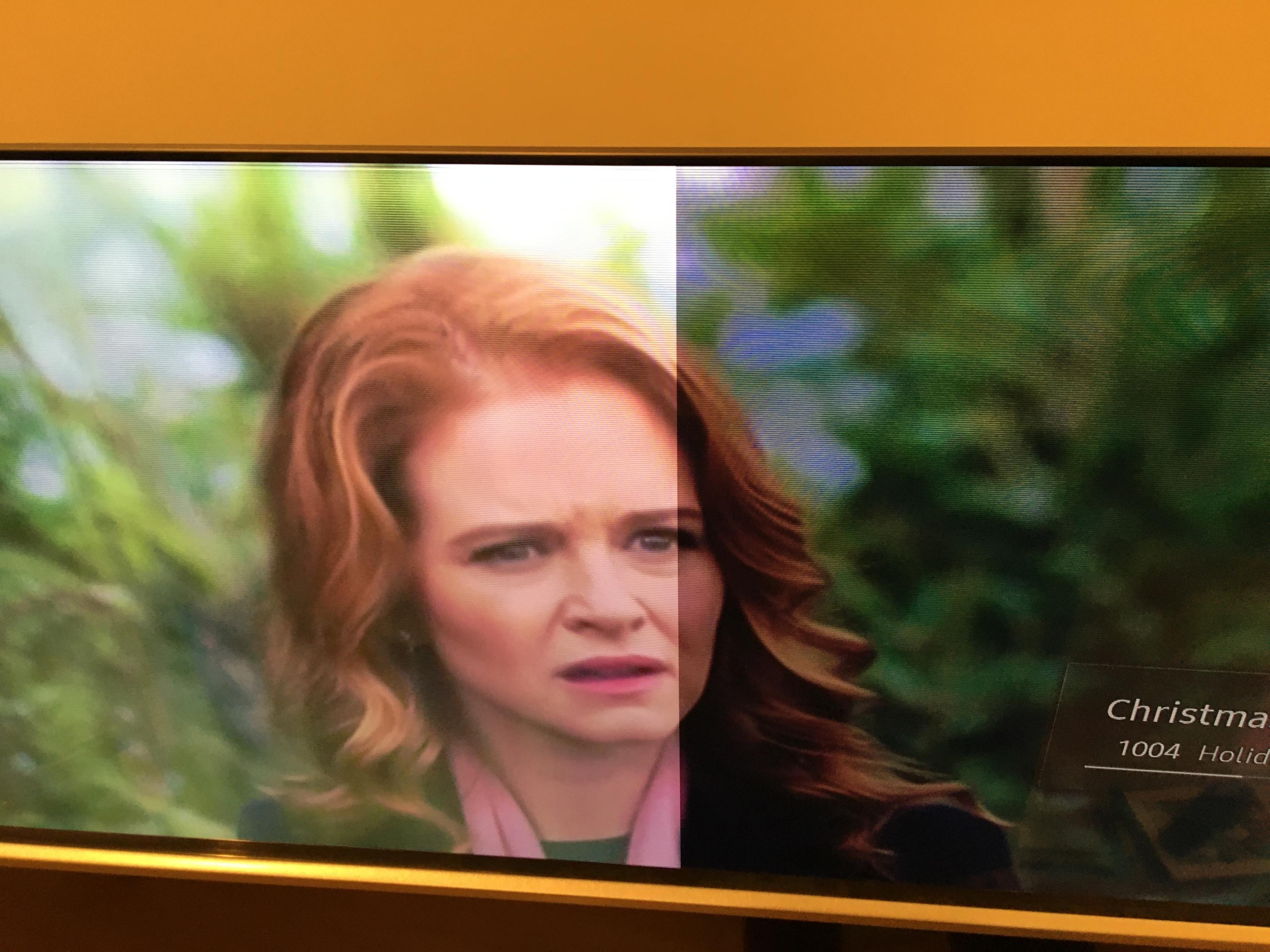

                          #52
                          I finally got another replacement MB. Problem Solved.
                          So the first MB was DOA. The second powered up but had a bad T-con section on the board. Third time's a charm.
                          I might take the original board in to see what went wrong. But thank you for all your help.
