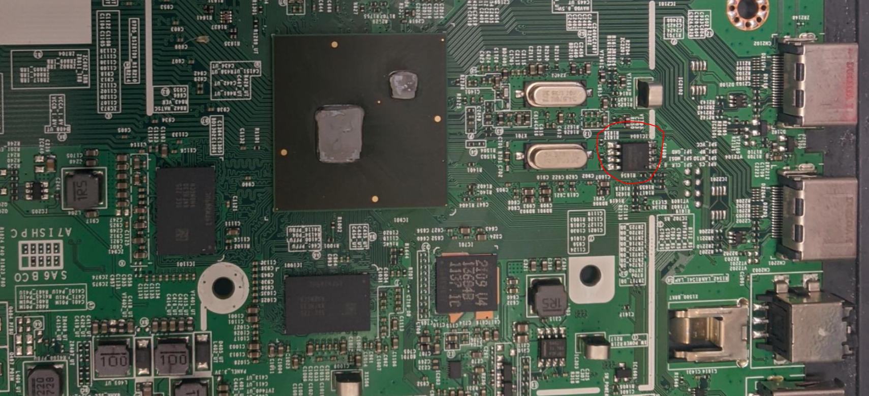

                      i have removed the main board i can only see ic1603 Winbond 25Q80DVSIG 1737... is this the right chip to copy?

                        Hi, the chip spi flash is under the IC1604 (25Q40CL) heatsink.

                            chip
                            • lotas
                              • Jan 2016
                              • 4499
                              • Russia
                              Re: Samsung ue49mu6120
                              Originally posted by Marty-Club
                              chip
                              chip read.OK

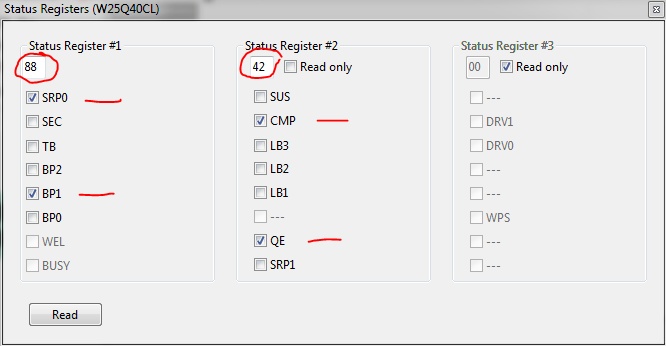

                                  Yes, write this corrected dump to the same chip, use this instruction when writing.
                                  https://www.badcaps.net/forum/showpo...3&postcount=29

                                    Hi i have got to the stage Seger edition check mark s7 s3 s14 s9 not on the register

                                      Hello, why do you have an empty dump (FF FF FF ...), you should have this.

                                        Hi I'm still getting the same on the status register no s7 etc
                                        The program you added fixed chip 7zip or winrar
