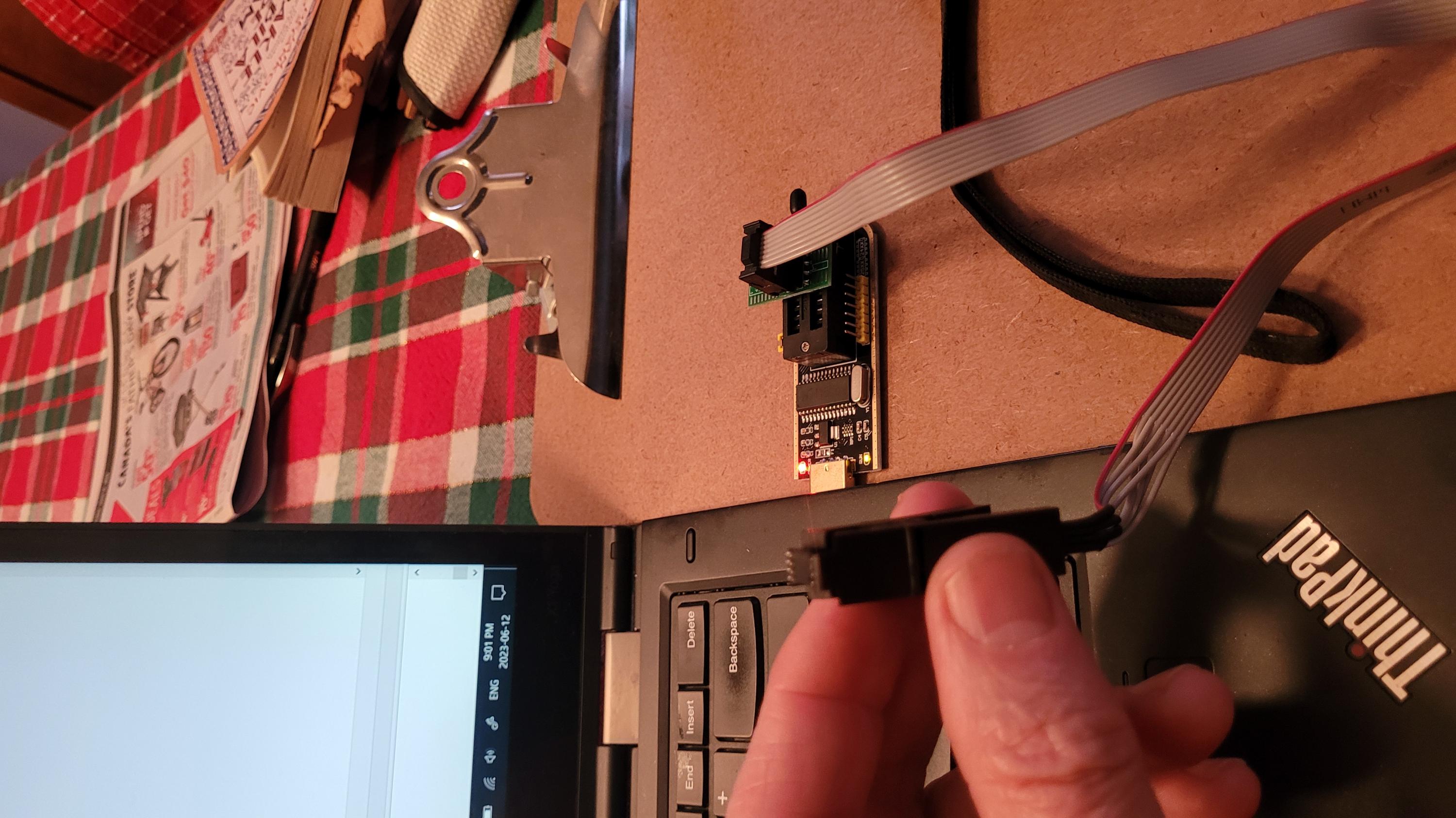

                          Hi Lotas,
                          Begging for a help. Sony tv with curved LCD, mode: UN49MU7600FXZC, BN41-02568 mainboard . Chip: IC1604 Winbond 25Q40CLSIP, no power, no stand by, power supply get back screen lighting when motherboard disconected.
                          Tried to connect and read the IC with the clip on cable, without removing the IC, it didn't work . . . empty reading. Hopefully it didn't get damaged. The chip must be removed and attached to SH341A socket?
                          Have hot air station for chip removal. Any good advice, before I proceed?

                            #273
                            Re: Samsung ue49mu6120
                            Originally posted by cickos
                            Hi Lotas,
                            Rather, it is not Sony, but Samsung, but you need to remove it and read the data (dump).

                              #274
                              Thanks for your prompted response. Yes, it is Samsung btw. I did take off the IC without problem and have attached to the CH341 adapter using clamp on the cable (picture attached). AsProgrammer is active, get the red and yellow light (while reading), however the reading is empty like without the IC (picture attached)?
                              Do I make it wrong, can you please review the attached picture.

                                #275
                                If the dump is damaged, there will be one FF up to x1000 at the beginning.

                                    #277
                                    It could be dump damage or the IC wasn't read.
                                    When I press the question mark button the IC is not recognized. I am not sure did i place the IC properly in the right section.
                                    Should it be placed in 25 or 24 section?
                                      Post here what you thought with 25Q40 (dump).
                                      Hi Lotas,
                                      Finally the AsProgramer identify the W25Q40CL, however the IC is empty. Did I delete it while experimenting with the software.
                                      So, I don't have native dump. Would you please give me some just to try, I have nothing to loose.
                                      Board is BN41-02568B, TV: UN49MU7600FXZS.
                                      THX in advance . . .
