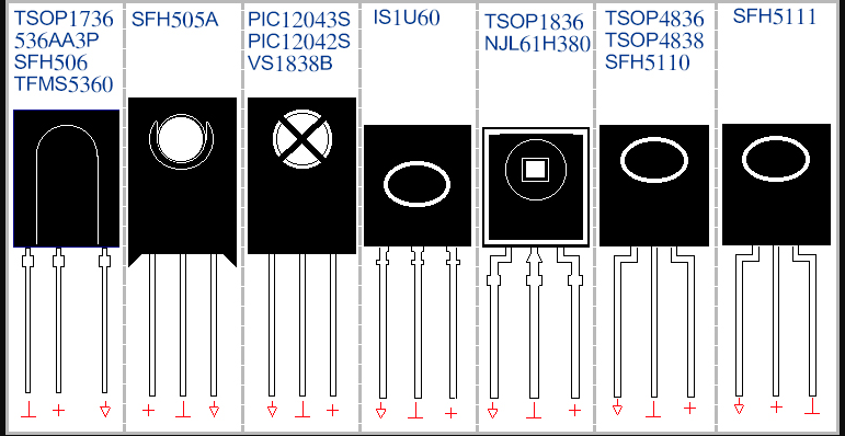

              I tried to go for motherboard replacement, but accidentaly got wrong revision of the board (Rev 2.1 instead of Rev 1.0), so with panel connected it bootloops (even though according to seller it is for same exact TV), but oh well. Whats interesting, i tried turning it on / off with remote also, and it wasnt reacting to remote aswell. (Well, might be that it had different pinout i guess). My current question would be - is there a chance that TV is "bound" to one specific remote model so none of other remotes work?
              And also, is there anything specific about IR receiver for such tv's, or they are pretty much standart ones ?
              • lotas
                • Jan 2016
                • 4531
                • Russia
                Re: Philips 32PFL3008H/12 Remote doesnt work
                IR receiver
