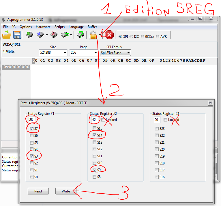

                                        Yes, neoprogrammer is exactly what you need for this.
                                        In the program:
                                        1. Click "Detect Chip" and select W25Q40CL and "Select IC".
                                        2. Click "Unprotect".
                                        3. Click "Clear IC" and "Yes".
                                        4. Click "Open File" and select your corrected dump.
                                        5. Press "Program IC" and "Yes".
                                        6. Click "Verify IC".
                                        7. Press the down arrow to the right of "Unprotect" and select "SREG Edit", put a check mark on SRP0, BP1, CMP, QE and press "Write" and "Yes"
                                        7. Close the program. Ready.​

                                          Thank you for this. My status register #2 is set to 40 (I cant change it or select QE box). The write button is greyed out
