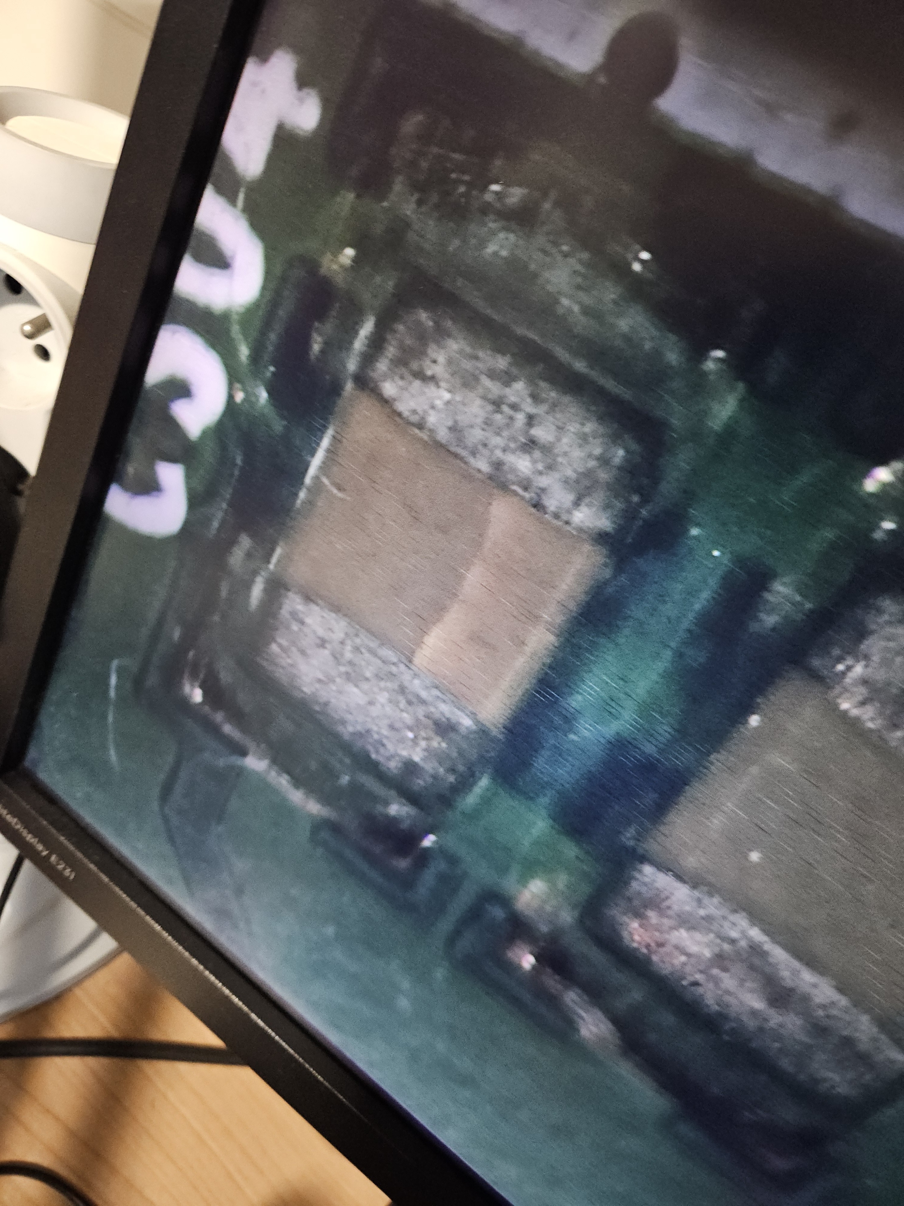

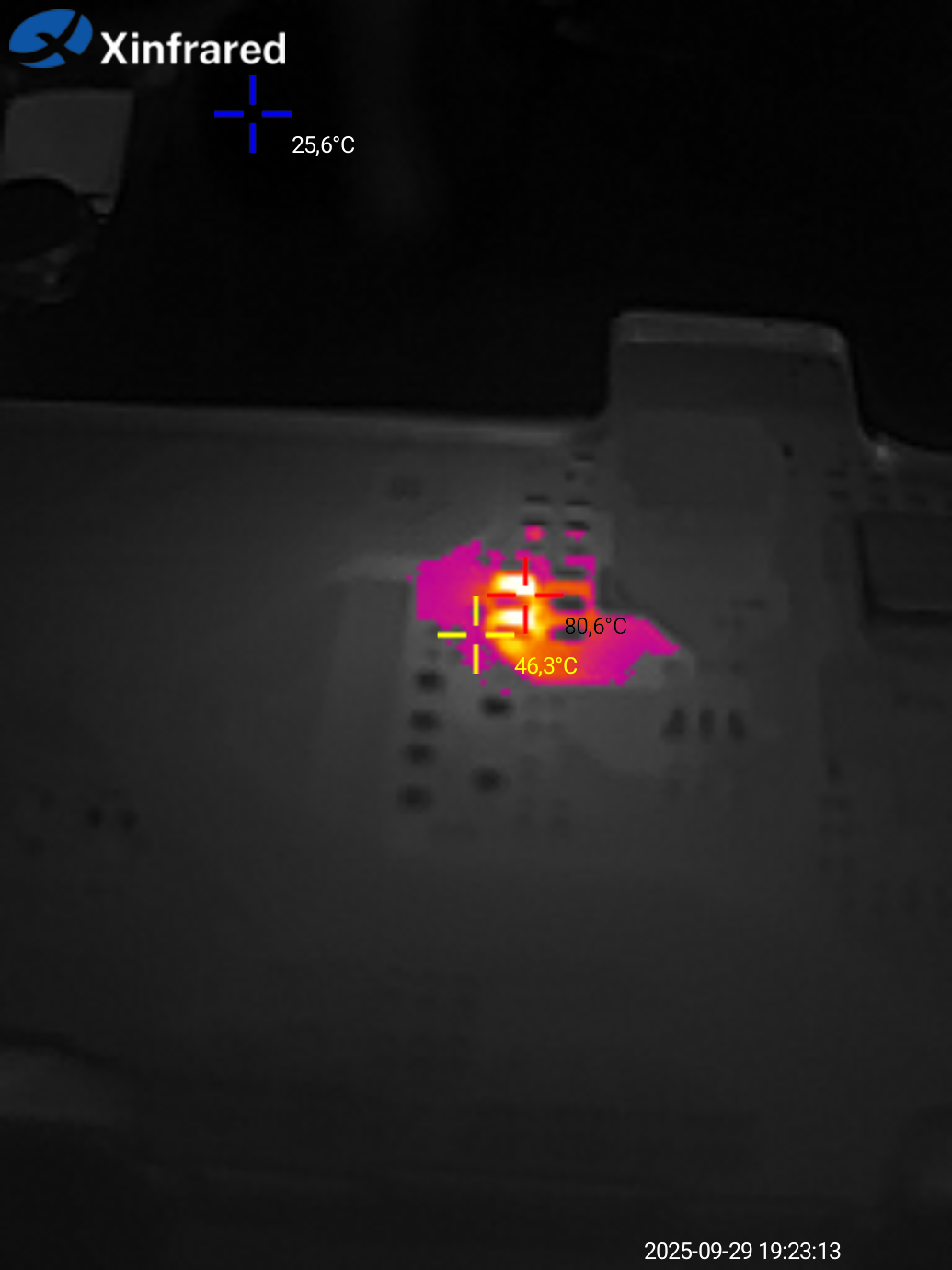

                            Thank you for your help. Today I decided to reconnect the TV again, and something unbelievable happened... it turned out that all the voltages that were previously present had completely disappeared.
                            I started checking and found that fuses F202 and F203 were blown. Then I measured the voltage drops again and, to my surprise, I discovered that the 12V coil was shorted to ground. During a short-circuit test, a cracked capacitor (probably C303) started heating up.
                            I desoldered it, replaced the fuses with 0R resistors, and the TV came back to life. Do you happen to have the schematic for this board?
                            It seems the capacitor must have been intermittently shorting before, which caused the power supply to shut down. Earlier, the voltages on the board looked correct—I measured the drops twice. I also checked with a thermal camera and inspected under a microscope, but found nothing. And today, after just an hour, the TV is finally repaired.
