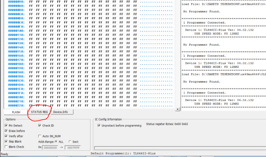

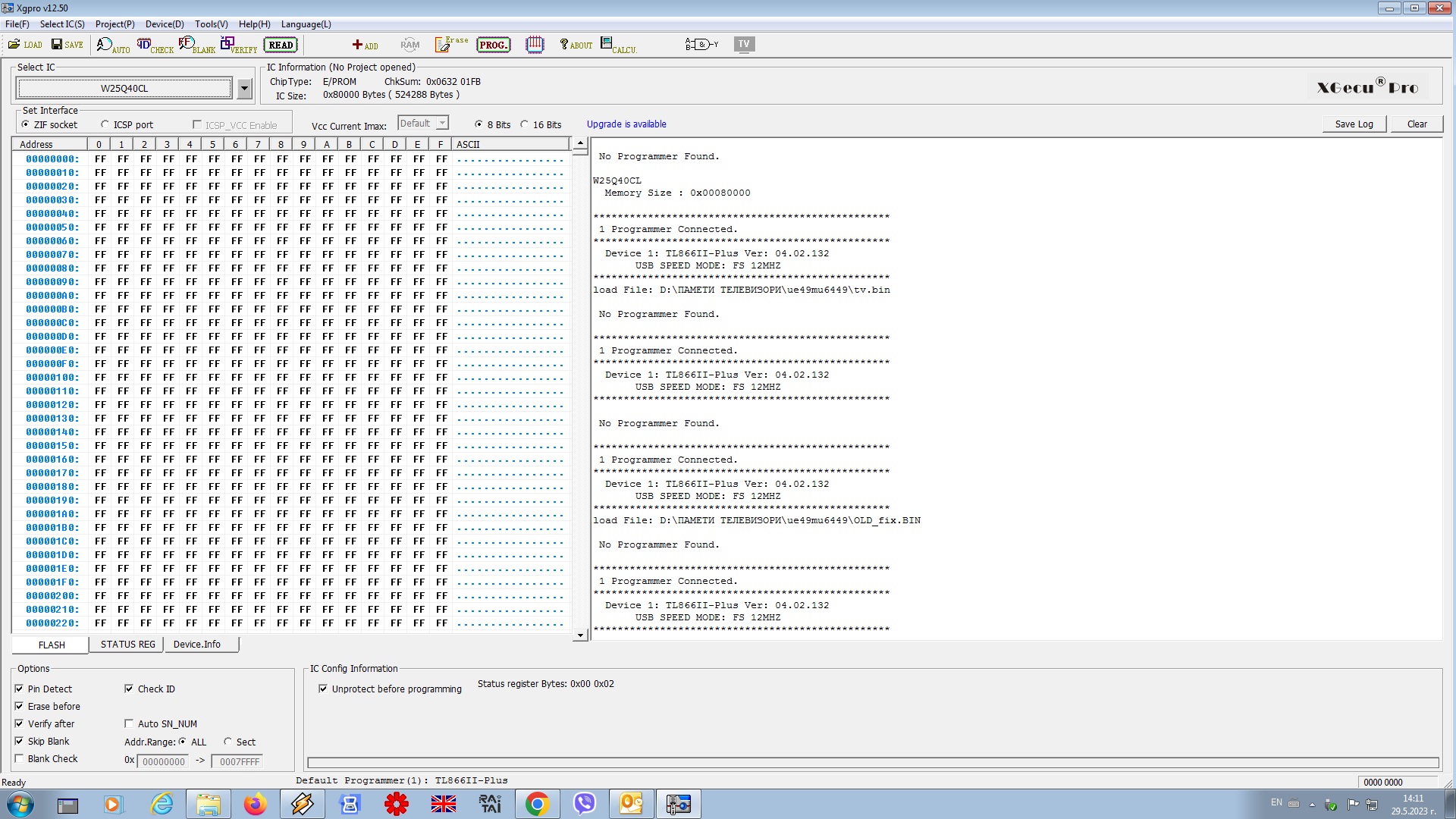

                  Its not work. Its again delete the first data in dump. May be have to try with new WQ40 chip.

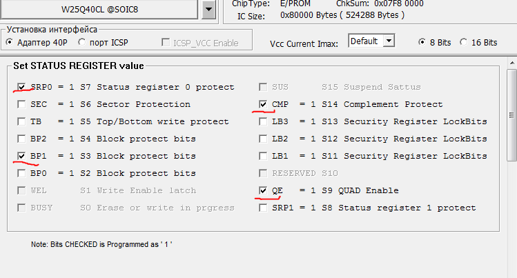

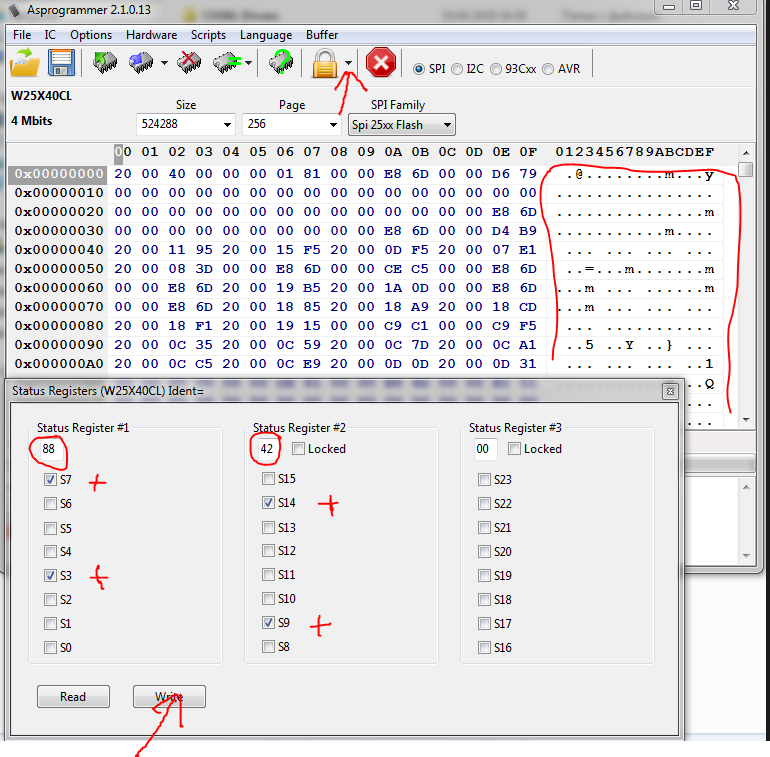

                    #29
                    Re: Samsung un49mu7000f dead no power
                    Because you didn't set and write the status register (0x88, 0x42) after dump was written.

                      #30
                      Yes its now working, thanks a lot!

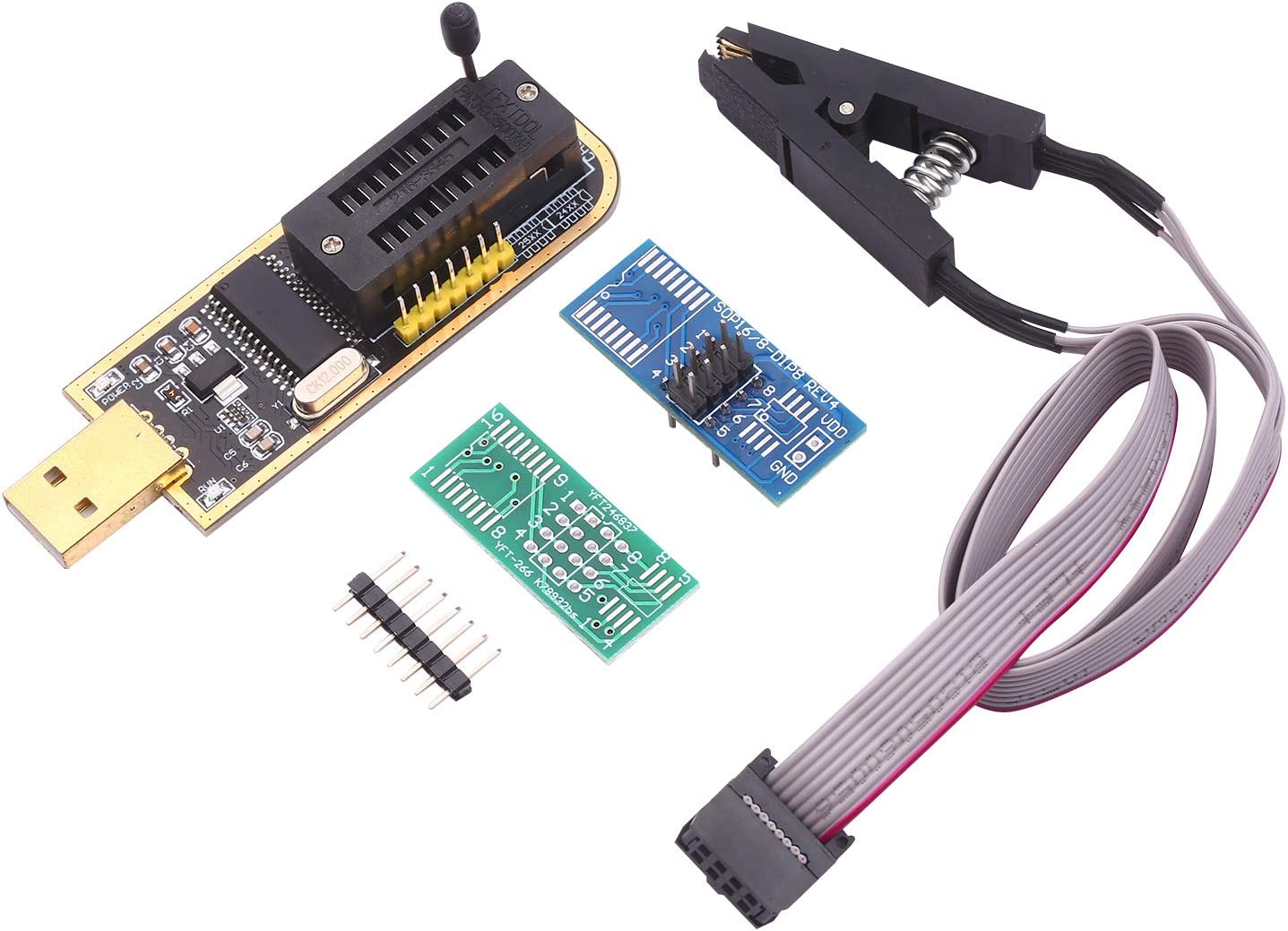

                        With a huge delay, may I have detailed instructions. I have located the Chip on the main board. Should chip get removed? ]How to connect the mainboard 8 pin chip to CH341A hardware? I guess USB goes to Laptop and software?

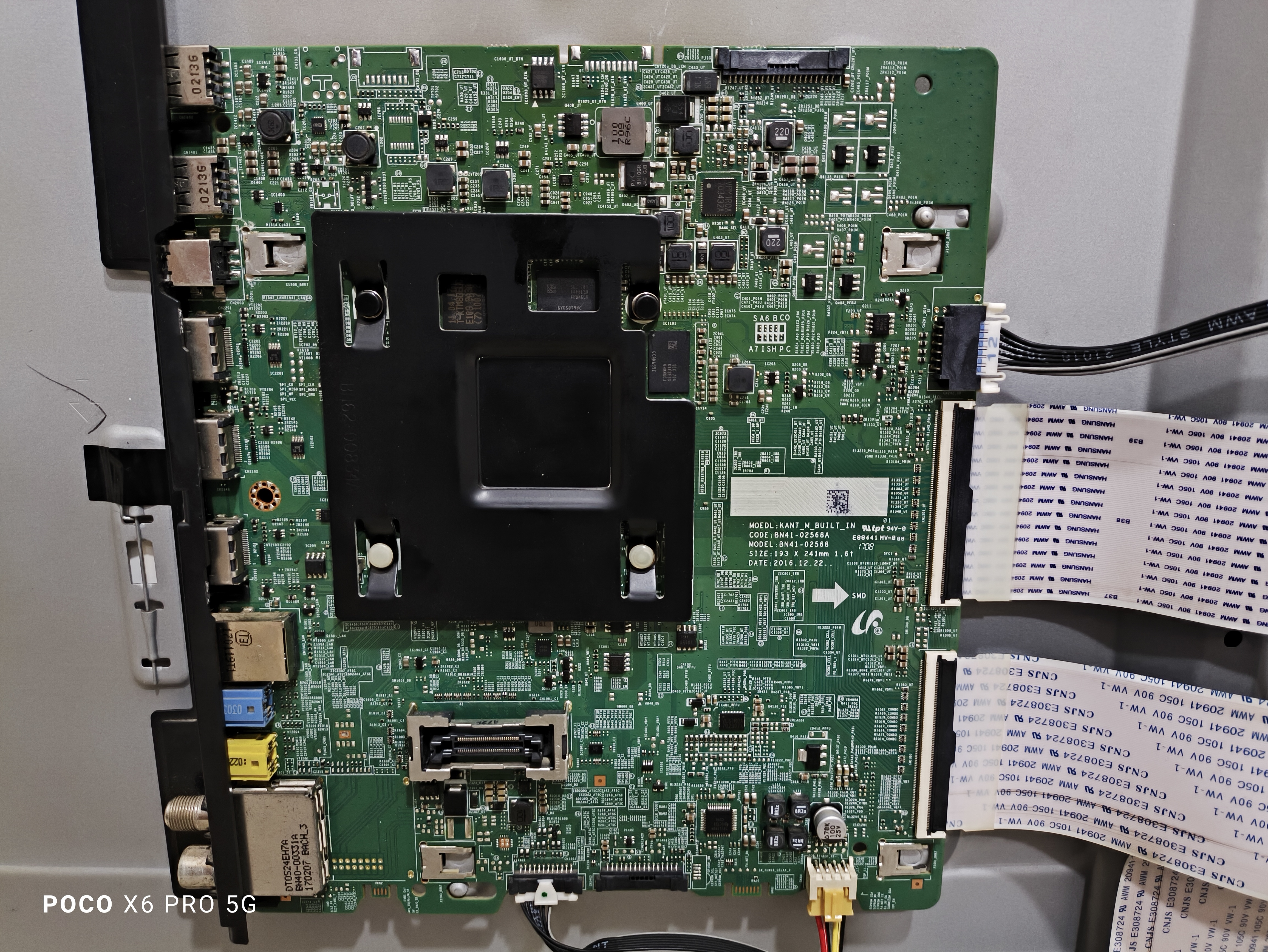

                                      selam arka ışık yanıyor ama logo gelmiyor.. ekran sağlam test edildi. televizyon kumandadan açılıp kapanıyor. sanırım 25Q40 ile alakalı kendi yedeğimi göndersem düzenleyebilir misiniz ?
                                      anakart bn41-02568a bn94-11913Q

                                        Try this one, but the problem may also be in the 25Q80 firmware, which is responsible for the panel and t-con settings. Are the motherboard and panel part of the original kit?

                                          bunu deneyeceğim.. evet panel ve anakart orjinal.. t-con anakart üzerinde. anakart ve panel modelini ekliyorum.
