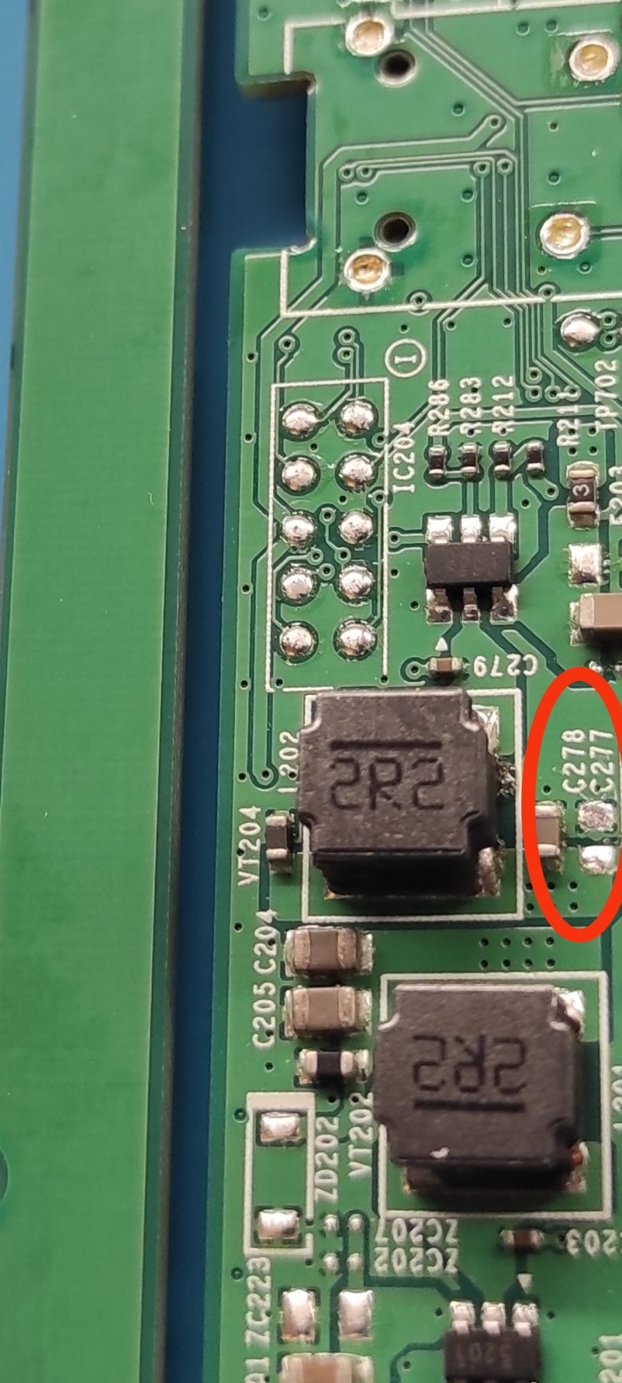

                                  • Diah
                                    • Feb 2013
                                    • 6562
                                    #57
                                    Originally posted by jidping
                                    backlight come on when disconnect MB. A13V read 9V when MB connect. no standby LED. Thanks
                                    you have likely short cap on MB check around the VCC 3.3V C277

                                      #58
                                      Click image for larger version Name:	samsung_u.jpg Views:	0 Size:	260.2 KB ID:	3503296
                                      Thanks for the advice. I can't find C277. My MB BN41-02568B/BN94-12399A looks different than yours. But I get 3.3V on eeprom IC so 3.3V is good. I will check if there are any shorts. Next will try to get replacement MB.
                                      • Diah
                                        • Feb 2013
                                        • 6562
                                        #59
                                        try to disconnect the wifi/BT module
                                        • jidping
                                          • Oct 2020
                                          • 6
                                          #60
                                          Update. I got a replacement MB for UN49MU7600F and the TV is fixed after replacing the MB. Thanks for all the helps. 😀
