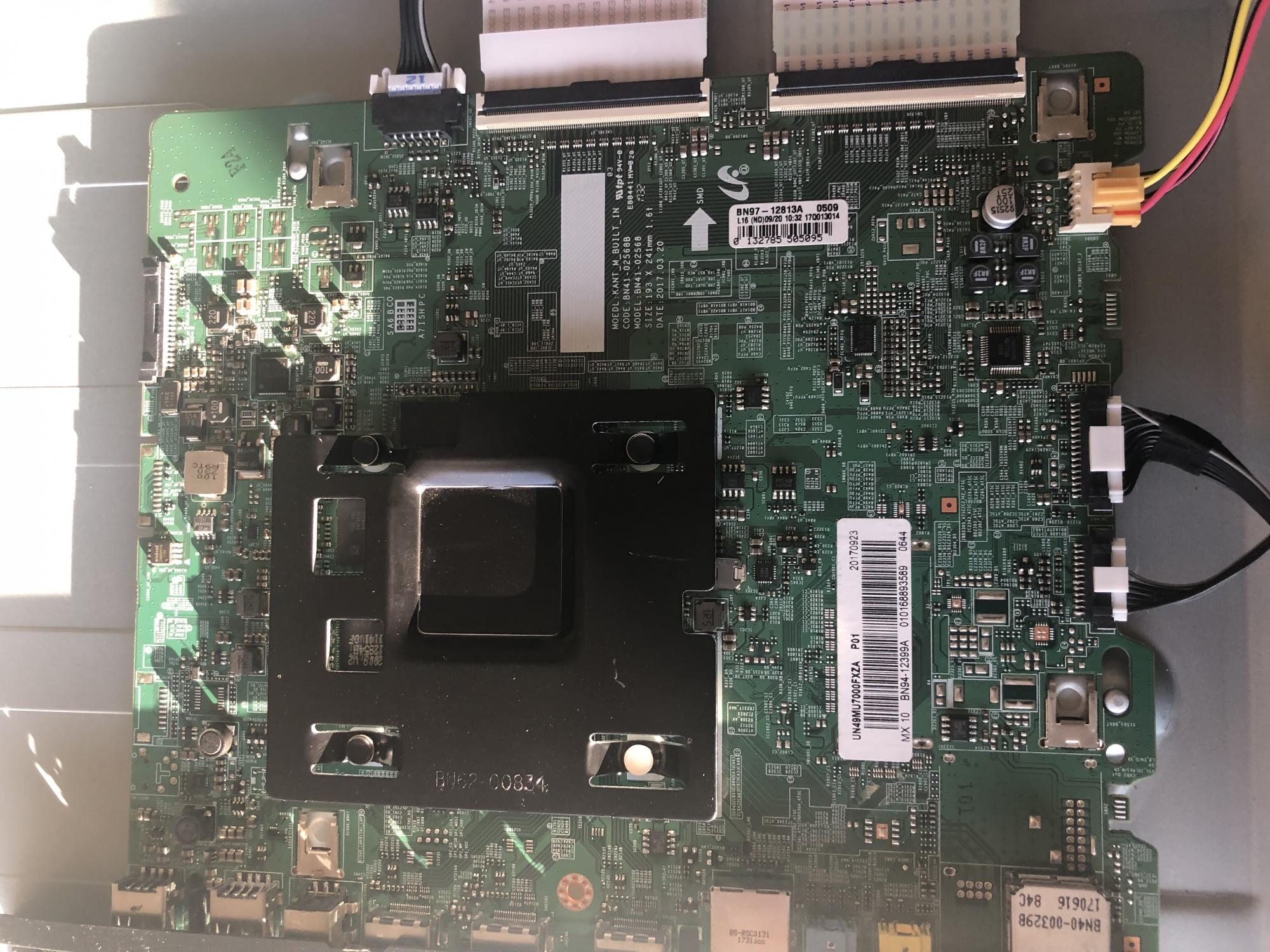

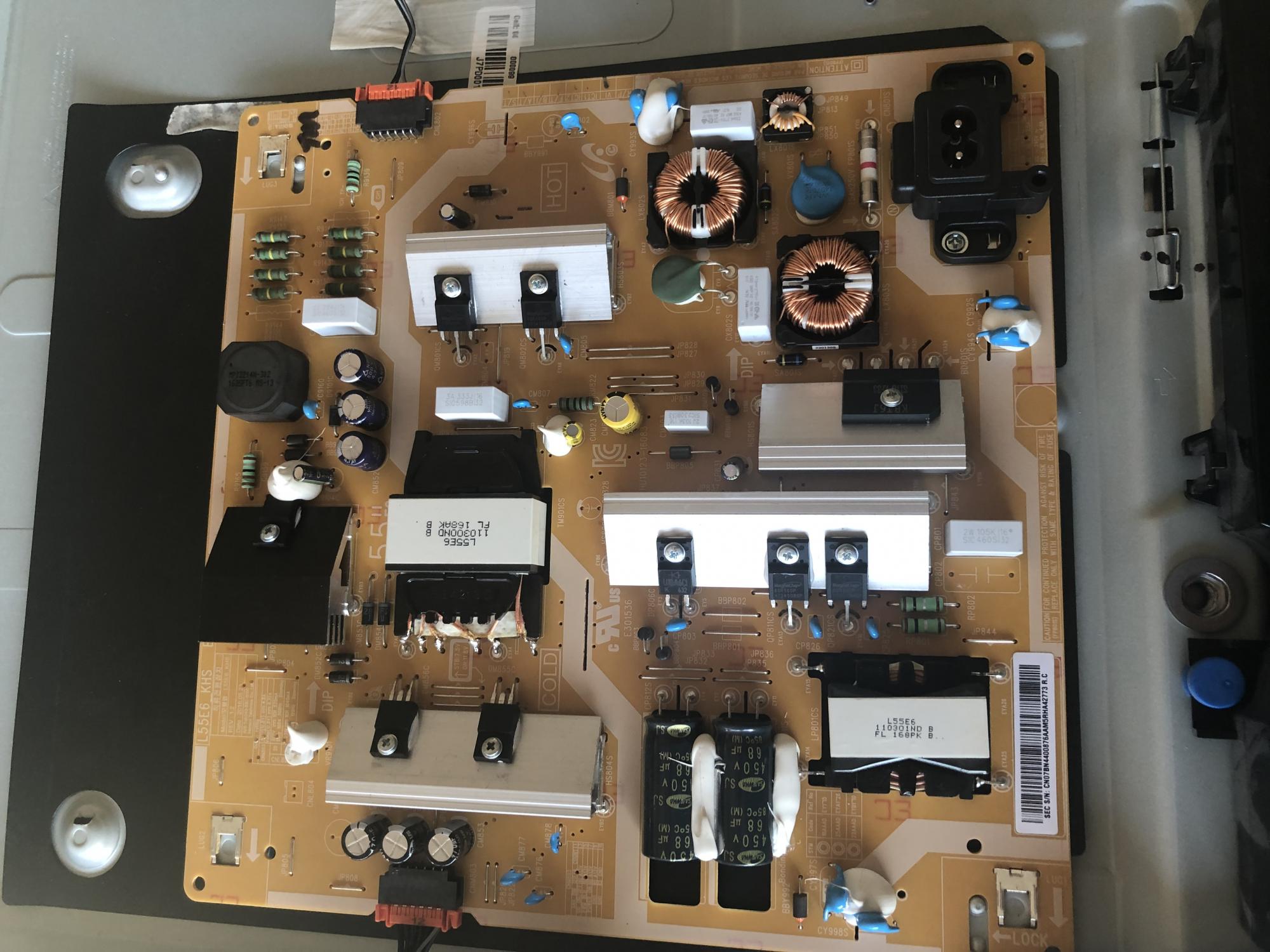

    I'm working on a Samsung UN49MU7000F that has no standby LED indicator.
    No POWER
    The power supply board is part number BN44-00876A
    The main board number is BN94-12399A
    I am stuck.
    I have replaced both pwr supply and main board with no changes.

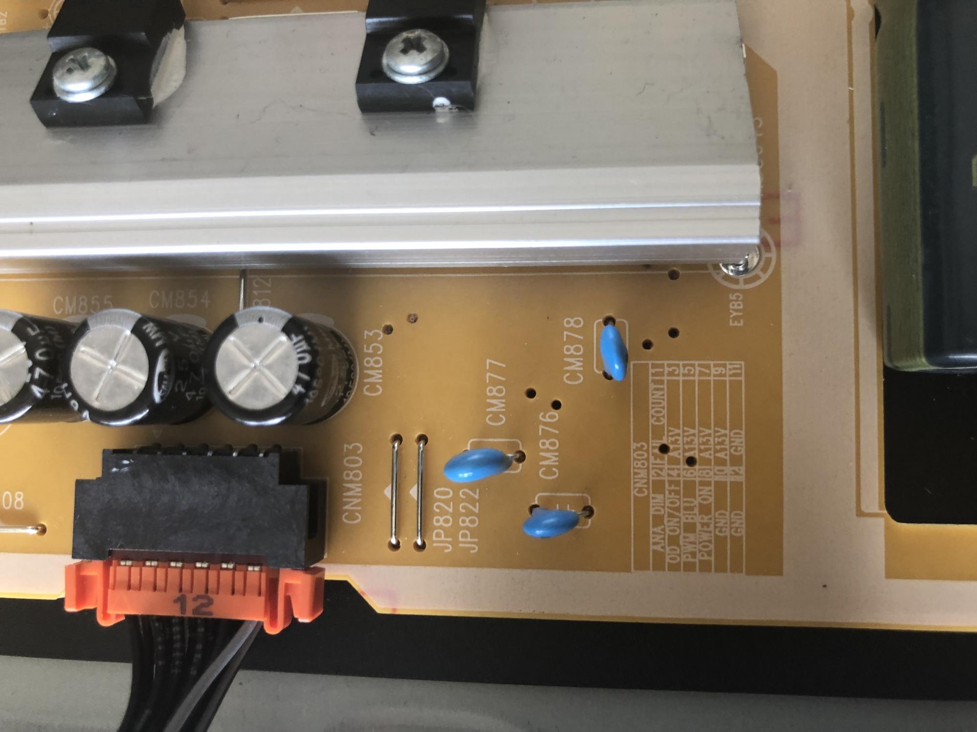

    Here are some of the readings from my multi meter on various locations on my power supply
    MAIN BOARD UNPLUGGED. BACK LIGHTS ON PLUG CNL802 85 volts
    Backlights are all illuminated and in operating range.
    MB PLUG CNM803. - UNPLUGGED
    PIN 1 FAN COUNT - Open
    PIN 2 ANA DIM - Open
    PIN 3 A13V. - 12.89
    PIN 4 OD ON/OFF - 2.163
    PIN 5 A13V. - 12.89
    PIN 6 PWM BLU - 2.106
    PIN 7 A13V - 12.89
    PIN 8 PWR ON - 1.665
    PIN 9 A13V - 12.89
    PIN 10 GND- GND
    PIN 11 GND -GND
    PIN 12 GND-GND
    STB VOLTAGE TEST POINT ON BOARD 12.89. (Should read 7.5 and 11.8)
    With MB PLUGGED IN. NO BACKLIGHTS.

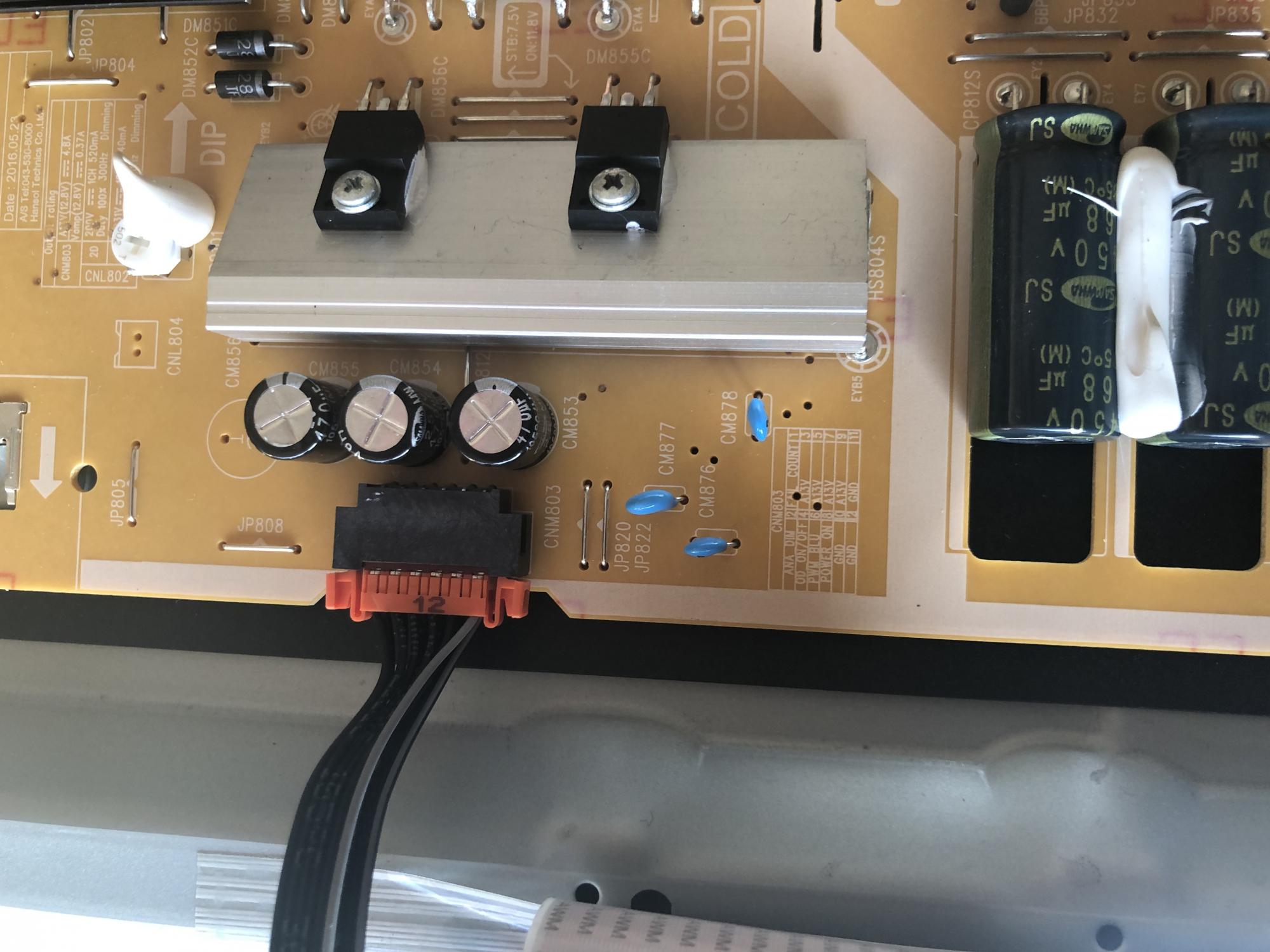

    MB PLUGGED IN CNM803 READINGS
    Pin 1 FAN COUNT open
    Pin 2 ANS DIM open
    Pin 3 A13V 9.03
    Pin 4 OD ON/OFF open
    Pin 5 A13V 9.03
    Pin 6 PWM BLU 34 ohms
    Pin 7 A13V 9.03
    Pin 8 PWR ON open
    Pin 9 A13V 9.03
    Pin 10 GND. gnd
    Pin 11 GND gnd
    Pin 12 GND gnd
    STB VOLTAGE AT TEST POINT 9.03
    I'm just not sure of what voltages should be reading at CNM803.
    Any help would be appreciated!

    Re: Samsung un49mu7000f dead no power
    It’s the main board. If backlights work with mb disconnected that mean power board is good. You must have got a defective mainboard. Even if the panel was bad the standby light would be on when the tv is off.
          Originally posted by bstewara
          I’m a little curious to why I’m not getting the 3 VDC standby voltage.
          I’m just not sure what voltages I’m supposed to be getting on CNM 803 as they aren’t marked on the PS board.
          The voltages and pin numbers for CNM803 are clearly marked on the BN44-00876A power supply board.
          There is no 3.3 volt standby supplied by this power supply, only A13v The main board supplies all the other lower voltages.
          With power removed, disconnect the two cables going to the panel, plug in tv and see if it will turn on (there will be no picture)

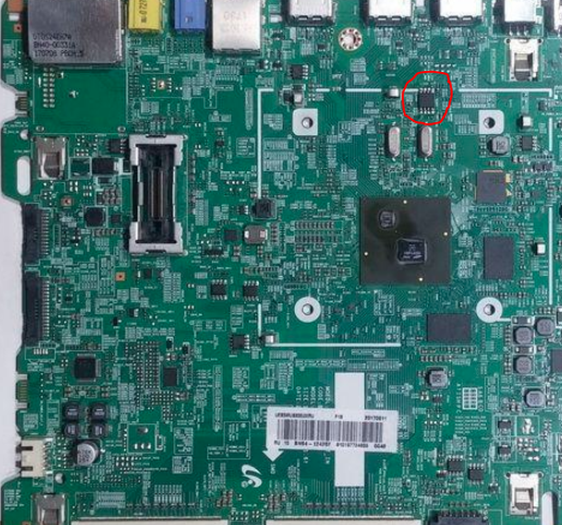

                If you have a programmer, then read the dump from the spi flash ic1604 W25Q40CL and put it here, I will fix it for you and you will write it back and your samsung will work.
                • bstewara
                  • Jun 2019
                  • 40
                  I'm not seeing ic1604
                  However I found ic1603 (25q80dvsig). (1733)
                  Could this be the correct ic for this model?
                  Thanks again

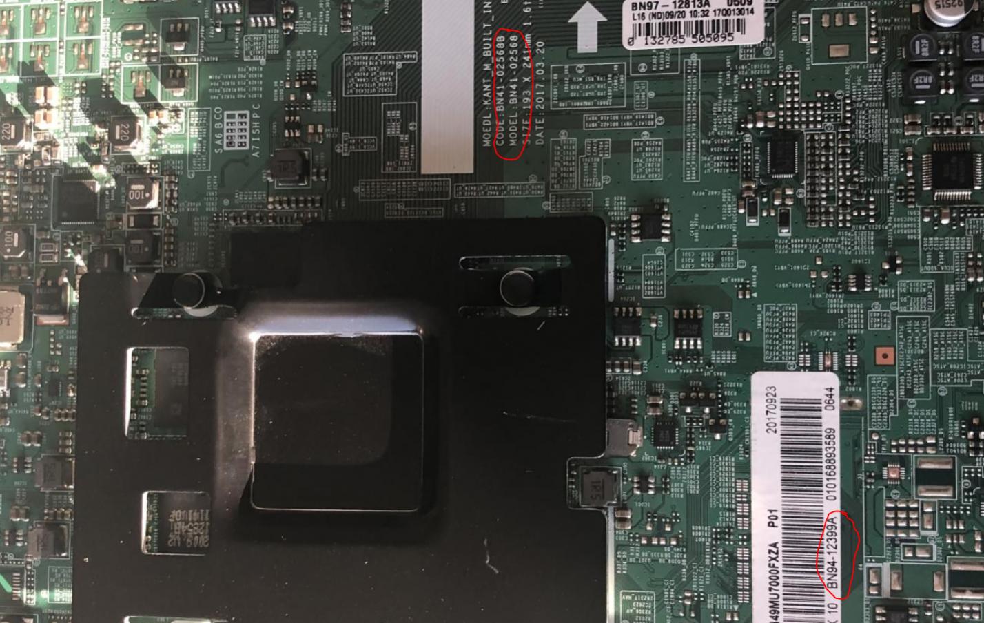

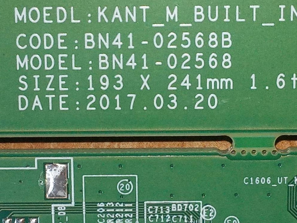

                    Do you have a mainboard BN41-02568B?
                    • lotas
                      • Jan 2016
                      • 4803
                      • Russia
                      BN41-02568B
                      IC901 SDP1601 ver.05 S5WWPT H1730
                      IC701 KLM461FEPD
                      IC1001,1101 K4F8E30 4HBMGCH
                      IC1604 25Q40CLSIP
                      IC1603_UT_KTN 25Q80DVSIG
                        No,
                        I’m sorry my main board is BN94-12399A
                          I did find it!
                          Thanks for the photo.
                          Do you know if this ic can be purchased pre flashed and ready to install?
                          I don’t have a programmer
                          Thank you for all of your help
