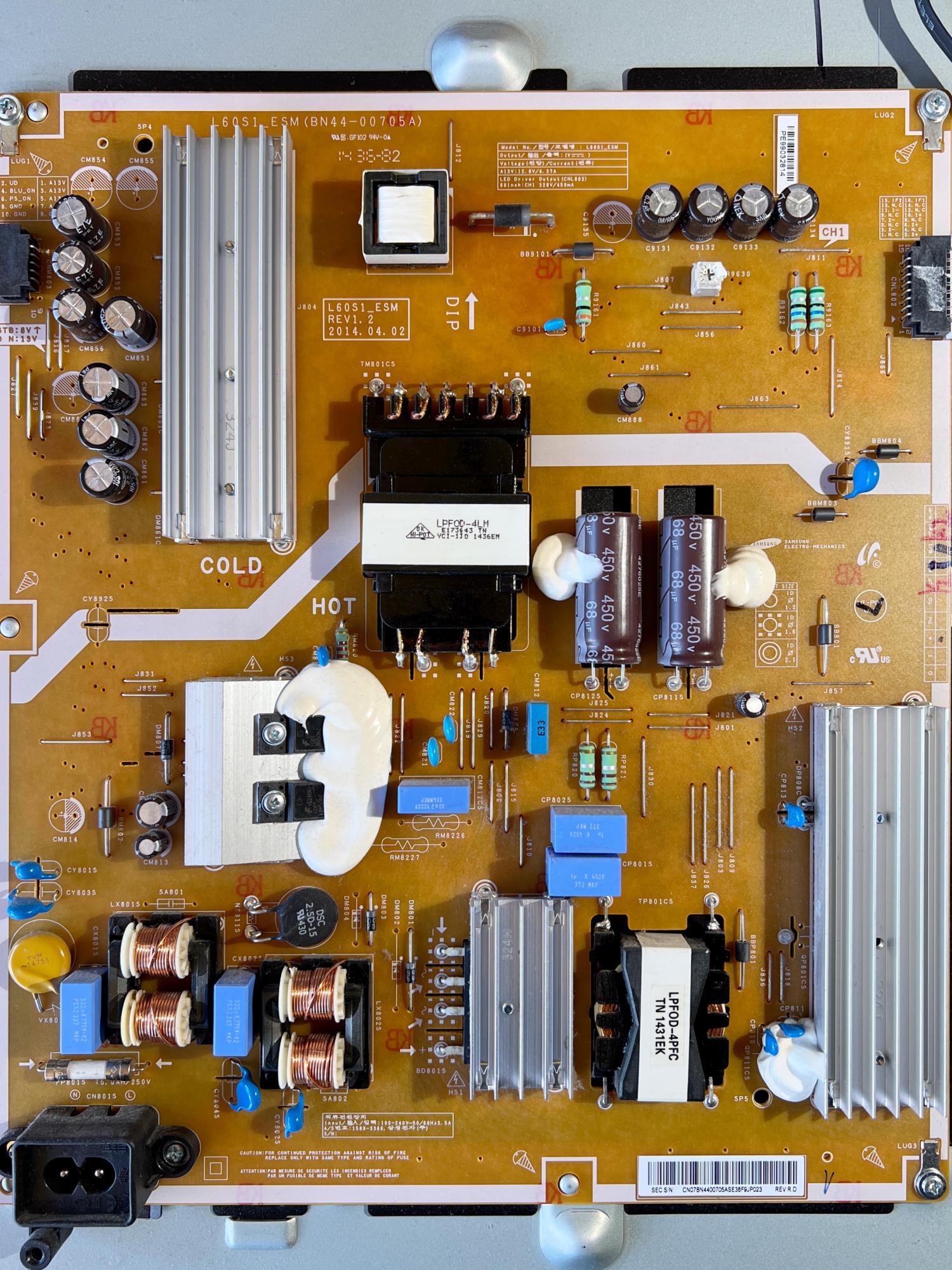

    Hi All, I've had some great successes with repairing several displays with the help of the members here.
    I'm currently troubleshooting a Samsung UN60H6300AF with a backlight issue. Upon powering up, the backlight flashes once for a fraction of a second. I can see the on-screen display with a flashlight.
    I've attached photos of the PSU board, and can provide more photos if needed. I have an auto-ranging DMM and very basic knowledge of circuitry.

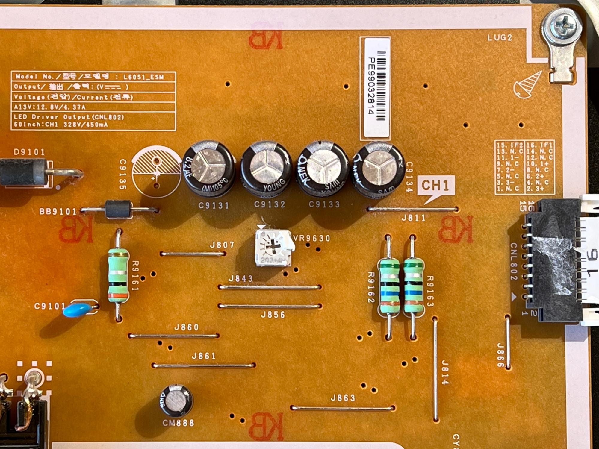

    Can someone recommend the tests used to determine if the problem is either the driver circuit or the LED strips themselves? Should I reference chassis ground when measuring voltages at CNL802? Thank you for any help you can provide!

    Hi, i'm not usual at backlight repairing, keep in mind that this poblem relies 99% in the leds, so if you repair very occasionally so go and open the screen, if you are searching a better test i guess you can build a simple led tester with 1 diode bridge, 1 power resistor, two tester cables and another diode, there are plenty of these projects on YouTube, doing this you will test bl from the PS output cables, if it doesn't light up or the tension read on the bl cables is lower than the one printed on the psb then leds are faulty. This is not much precise if you have only two output cables but if bl (backlight) is Split in 4,6,more cables, by comparing their tensions if them are different so led fault.

      First I would do the flashlight test and see if an image appears thru the dark screen. If you see image, then its faulty backlights. Second test would be to unplug the AC power. Then unplug the cable that connects the power supply to the main board. Replug the AC power. Backlights should come on instantly. If they dont, I would suspect backlights again.

          If you want to repair TVs, you need to buy a backlight tester. LED failure is the most common problem in LED TVs.

            But are we sure that instrument is mandatory for few tv? Lets say if leds are bad, the power supply is ok, so to avoid searching for led driver controller schematic and a protection bypass, one reads the data table printed on board , only bad chinese all in 1 board don't have it, if you read Vmax,Imax, make V/I you found a resistor value to put from led return wire and ground, you can test leds without other devices, i think 1/4w can suffice..
