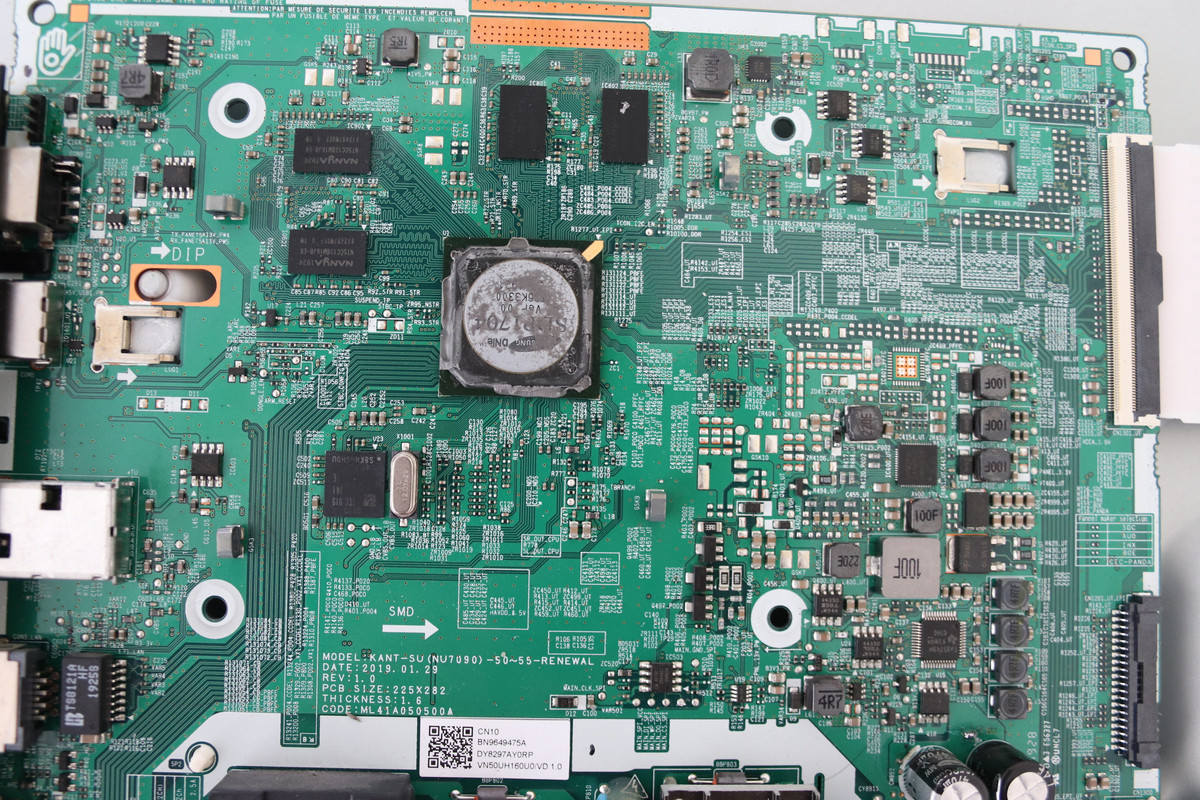

                Re: Samsung un50nu7090 standby light blinks once
                The board does the same thing without the lcd connected. It does the same thing no matter what components I disconnect. I have tried without speakers, without wifi board, without lcd, and even without the power button (I can tell it does the same thing because of a faint power supply hum that pauses each time the motherboard resets).
                Here is a photo without the heatsink.
                https://imgur.com/a/eilMlqB
                  That pic is very low res on my phone, can you post board BN code? or are you able to locate possible microcontroller and flash mems?
                    Sorry, It was taken with low light. It is a bn9649475a board. I don´t have the other information with me right now.
                      There are no good pics in the web, i can't help you without good pic. Or maybe Multiple pic, to see chip markings..
                        Here are some high res photos I took. The links don't provide as much resolution since you can't zoom in, so I will add a link to my google photos. You should be able to read everything on the board.
                        https://photos.app.goo.gl/t9cCiKC4APqPtvV66
                          I see very out of focus the zone where there are those three sop8 chip near the metal clip on top right of first picture, anyway freeze those 3 chips plus ic503 and U23, with freezer spray or butane gas bottle etc.. wait 5 seconds then turn on tv...

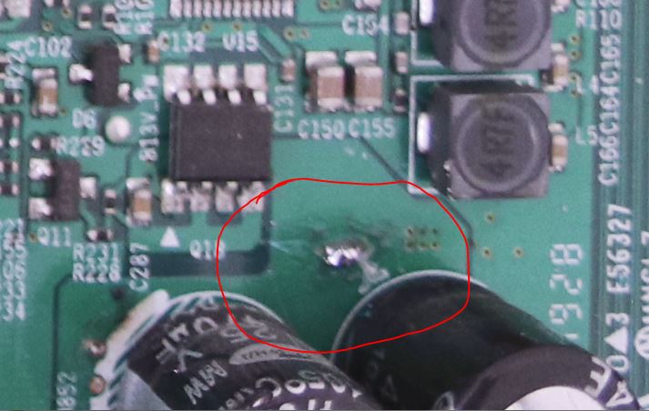

                              • 21029
                              I can see a little solder blob or some damage near the 2 caps,looks like its bubbled up a bit around it from the heat
                                  Thanks, but that was me, I soldered a cable there to connect my oscilloscope probe clip. It is just excess solder on the 12v line.
