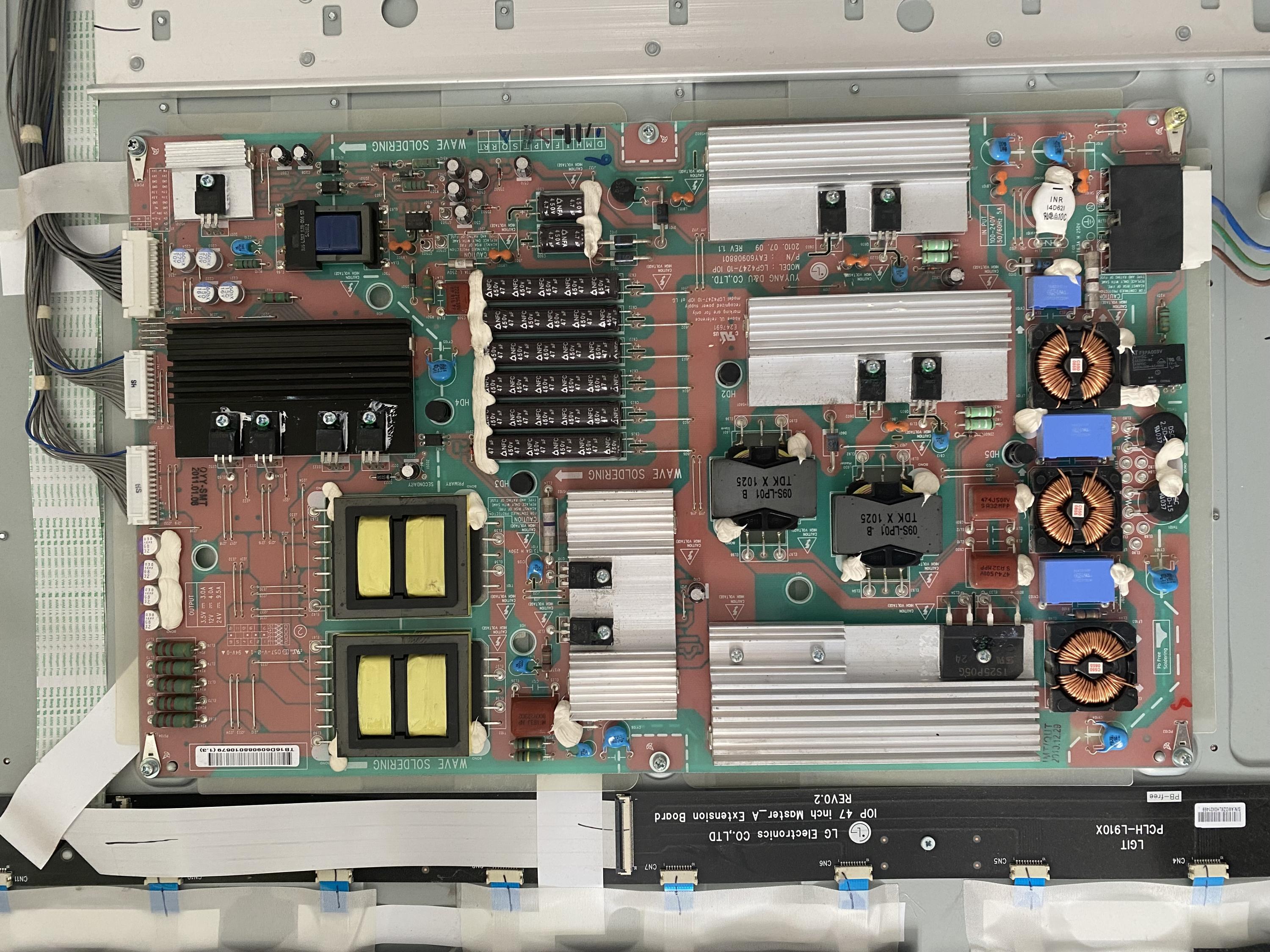

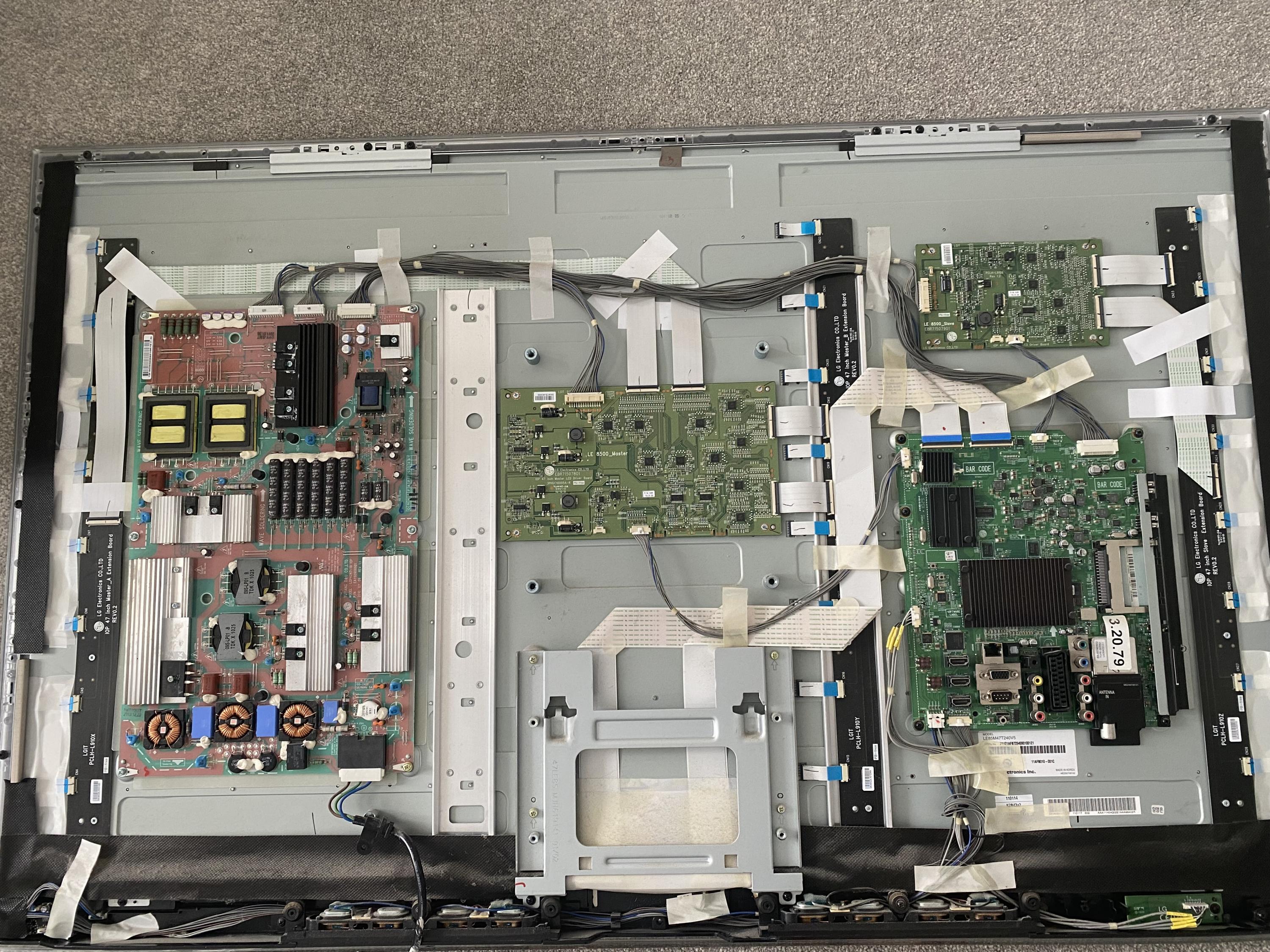

    Hi guys,
    I've just received an 10 years smart LG 47LE8900 from a friend and i can't seem to find out why i don't have any image or sound . It has only stand-by light .
    I have checked all voltages on the power board, I have cleaned all ribbon cables, i have checked all fuses , i have done a visual inspection on all capacitor and they look ok.
    I've attached some pictures with all the boards.
    Give me some idea's what can I do to get it working again.

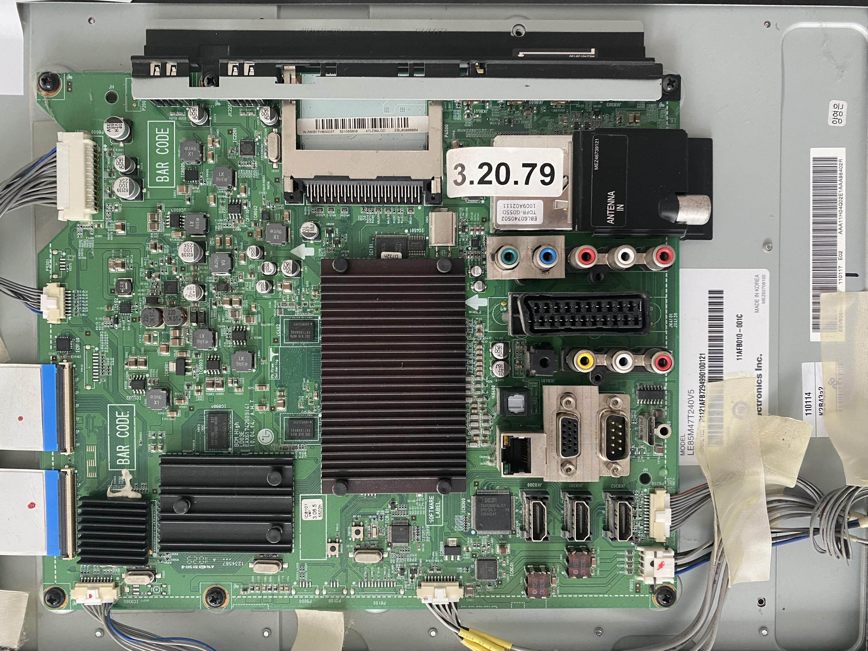

    Re: old LG not turning on
    Very often these LG suffers from bad CPU soldering. You need to try a reballing from a specialized center, this is one of the best models from LG so it will worth some spending, after made it a new bigger heatsink is suggested, or a fan.. it is not truly old for me..
      They usually do start up if the BGA soldering is bad. Disconnect the cable between main board and tcon. Does it power up then?

                    Re: old LG 47LE8900 not turning on
                    LE, LV, LW, and LS series suffers from bad bgas. Lot of ebay repair services if you google your model. To confirm, you can heat up the cpu with a hair dryer before plugging in.
                        I will try to get it heated at around 200 degrees and see if that works. Thank you
                          SOLVED !
                          I have backed the main board at 200 degrees Celsius for about 10 minutes and after i left it cool down I got it back in the tv and i was pleasantly surprised to see that it works (I have done it before with other main board without success ) .
                          Thank you for the support guys!
