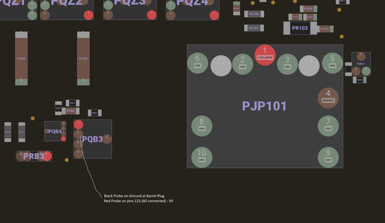

    I am having trouble diagnosing this gaming laptop.
    The laptop does not power on with AC Power only. The battery also does not charge. The laptop turns on when the battery is plugged in, regardless of whether or not the charger is plugged in until the battery dies of course.
    So something is stopping adapter power from getting to the laptop. I checked Adapdet to make sure that the motherboard knows when the adapter is plugged in. That works fine.
    I suspect the first Mosfet isn't turning on but I am unsure how to properly diagnose that 😶.
    I measure 0V across the first mosfet when the laptop is plugged in.
    It's an N channel mosfet and from what I have read online, the way to test it red probe on drain, black probe on source and I should get OL.
    I do get OL, so the mosfet is fine yes?
    I get the same result on the second smaller Mosfet right beside it.

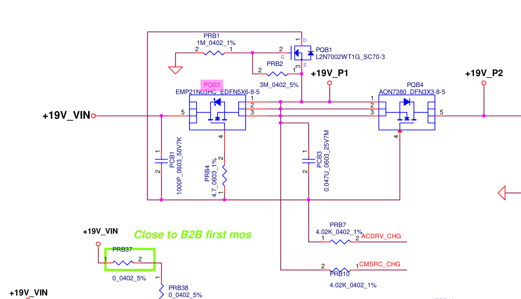

    If I am correct, then it occurs to me that whatever is supposed to turn the first mosfet on isn't triggering.
    I am unsure where to find what turns the mosfet on in the schematics. I think the following screen cap would be relevant but I'm not sure exactly.
    Click image for larger version  Name:	Schem Cap.png Views:	0 Size:	75.5 KB ID:	3225401
    Link to schematics and boardview
    Please let me know if you have any other questions. I am hoping someone is able to point me in the right direction here.

    Hey! The gate voltage will enable or disable the mosfets which is pin #4. Being n-channel the gate voltage must be higher than the voltage on the source / drain pins. So gate voltage should be ~25v to enable. Often, the 2nd dcin mosfet gets kille and takes down the party. See the above sticky by piernov on charger circuits for more details.
    Do check the voltage on pin #4 to ground of this mosfet.

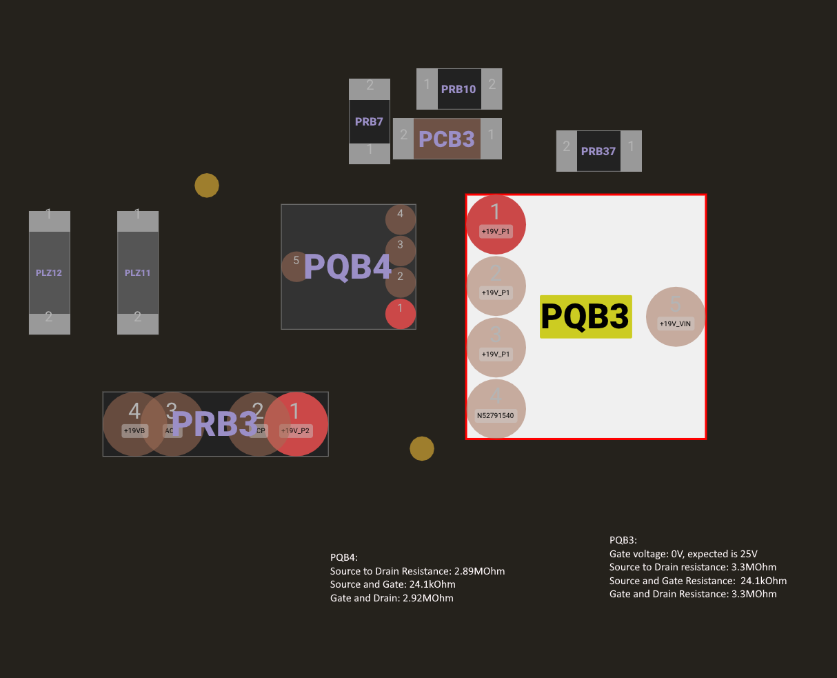

      I have taken the measurements as requested and I am not seeing a short at all. I am noticing there is no voltage present at all at the gate of input mosfet 1.
      The measurements are as follows, and a picture for reference.
      Voltage at PQB3 Gate is 0V.
      Removing the power and measuring resistances now.
      PQB3:
      Source and drain: 3.3MOhm
      Source and Gate: 24.1kOhm
      Gate and Drain: 3.3MOhm
      PQB4:
      Source and Drain: 2.89MOhm
      Gate and Drain 2.92MOhm
Name:	N-Channel Mosfet Measurements.png

        PQB3:
        PQB4:
        In the mosfet world, the source-gate resistance is very low. Next, check the resistance to ground of the drain pin group (5-6-7-8) of PQB4 which is the main power rail. Post the measurement.
        With your hot air tool, carefully flux and remove PQB4 off the board. After this mosfet is removed, check the source to gate resistance again on PQB3 and the PQB4 PCB pads (with the removed PQB4 mosfet). After the removed mosfet is cooled down and on your work bench, measure its resistance again. Still have the very low resistance across the source & gate pins? If yes, this mosfet is defective and must be replaced.

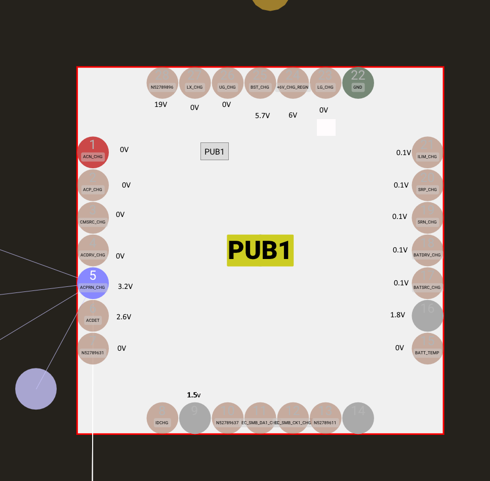

                    There is still not a voltage at PQB3 Gate, so perhaps something is wrong with the charging chip as Sephir0th suggested.
                    I have done some measurements around the BQ chip, but I don't really know too much about what I should be looking for, or which measurements matter. The only one I really understand is ACDET which has a voltage of 2.6v when plugged into power, and that makes it to ACDET. I measured the voltages here, and all of this is without the battery plugged in.
                    Click image for larger version  Name:	BQChip.png Views:	0 Size:	89.1 KB ID:	3231837
                    PS: Here is a link to the datasheet for the BQ Chip: Link

                      Regarding your Measurements both DC-IN Mosfets are not internal shorted. ACDET, REGN, VCC and even ACOK (weird!) are present. So there is no obvious reason, that the DC-IN Mosfets don't get ACDRV signal.
                      Check internal resistance of PRB4 and Resistance to GND of charging controller pin 4. if they both measure okay, best advise in my opinion is to replace the charging controller.

                          PRB4 Resistance: 4.8 Ohm
                          PRB7 Resistance: 4 KOhm
                          Resistance to GND of charging controller pin 4 is 1.9MOhm which I am assuming is fine.
                          I had already ordered the BQ chip to replace on this guy just in case, so I have replaced it but it still doesn't charge, nor is there a voltage on the Gate for PQB3.

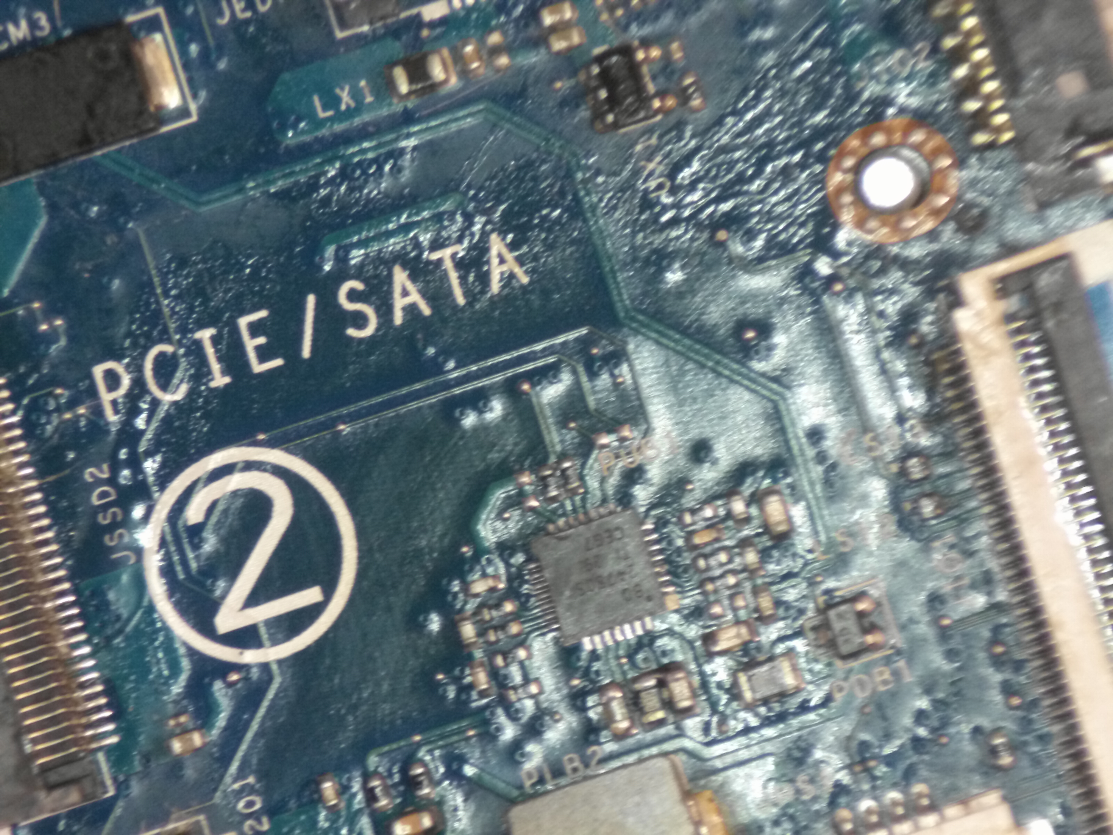

                                        Alright, so I have reflowed the charger IC and it is still doing the same thing.
                                        I know it's not the best picture, as pressing the capture button without shaking the microscope is difficult. But I am confident it is on there properly.
                                        Could it be anything else, or is this still the most likely culprit.
