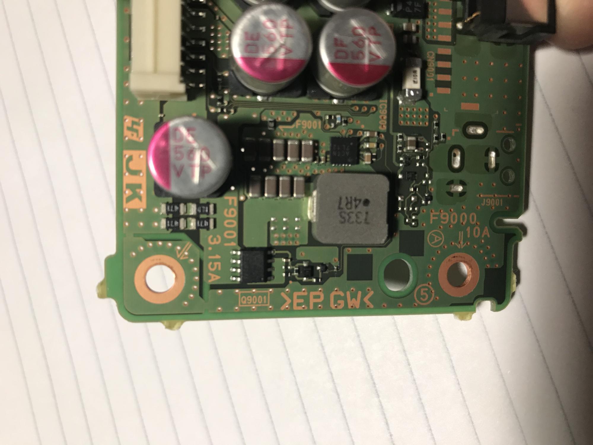

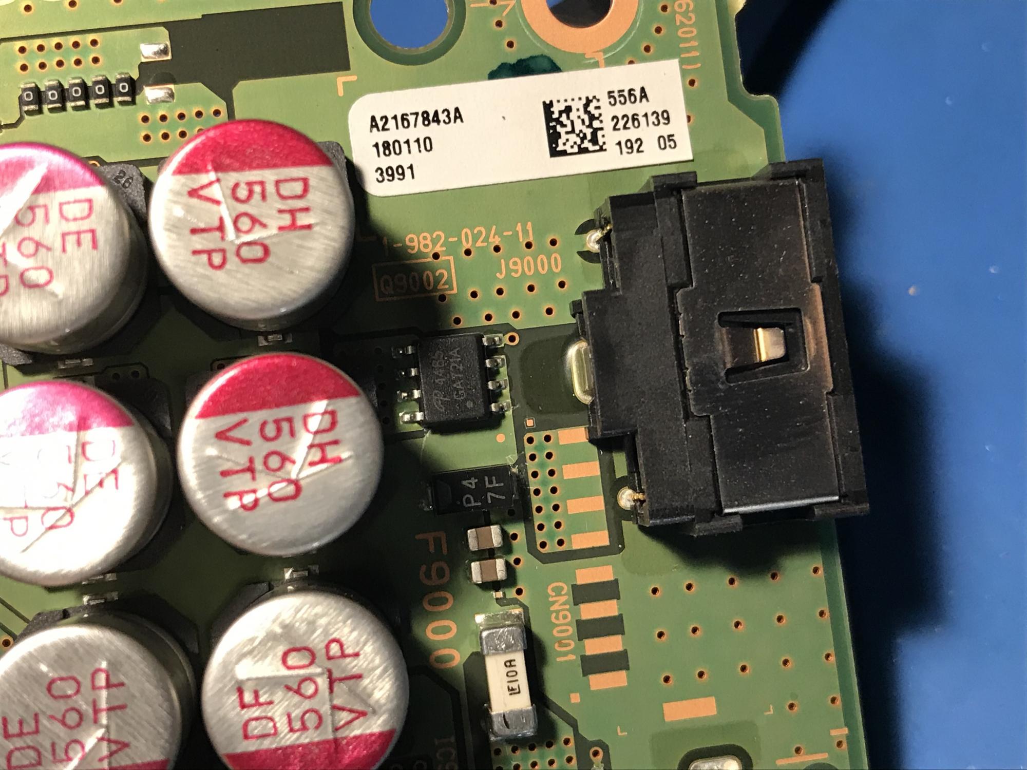

    I have a Sony Bravia XBR-65X900e that I am trying to fix for a co-worker; manufactured January 2018. It does nothing at all (no picture), so I will try to explain what I have. I will try to start with the power board and upload pics as I go. My ultimate goal is to figure out which board needs replaced, but also improve my troubleshooting at component level. I did just buy the Kent Liew PDFs and will be using them to try to learn from.
    The board Part Numbers: (Will attach pics soon)
    Power Board: A2167843A
    Main Board: A2170473A 1-982-022-21
    Led Driver Board: A2166064B

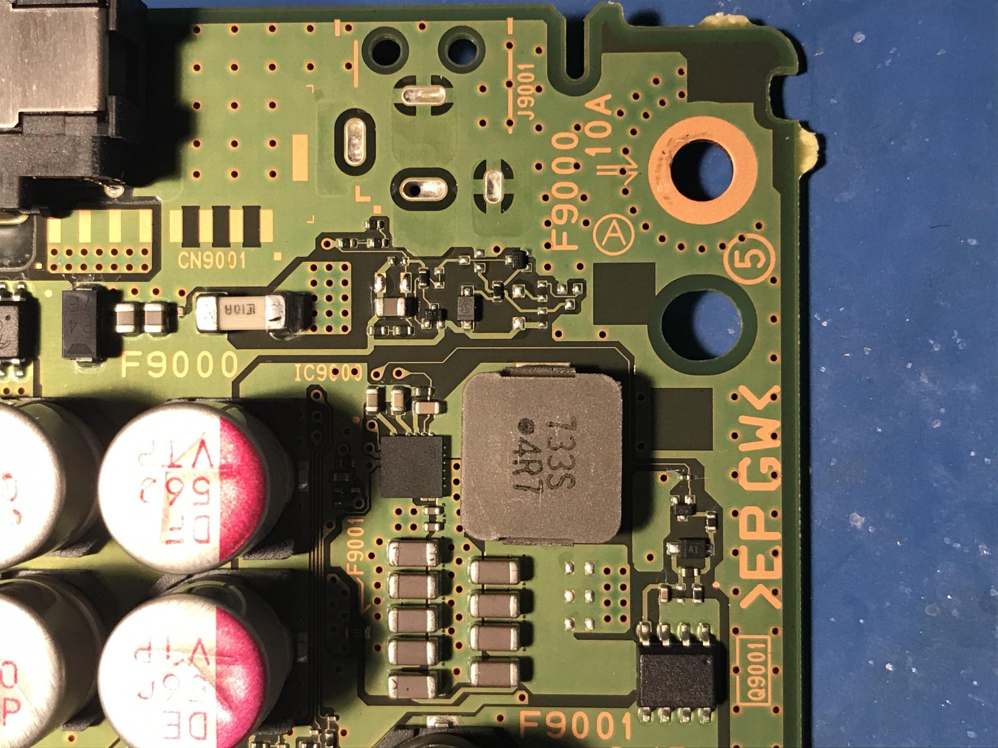

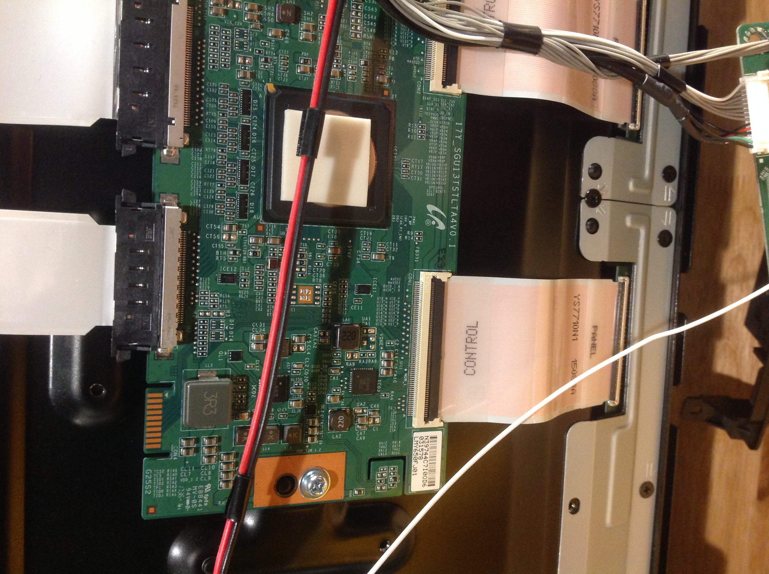

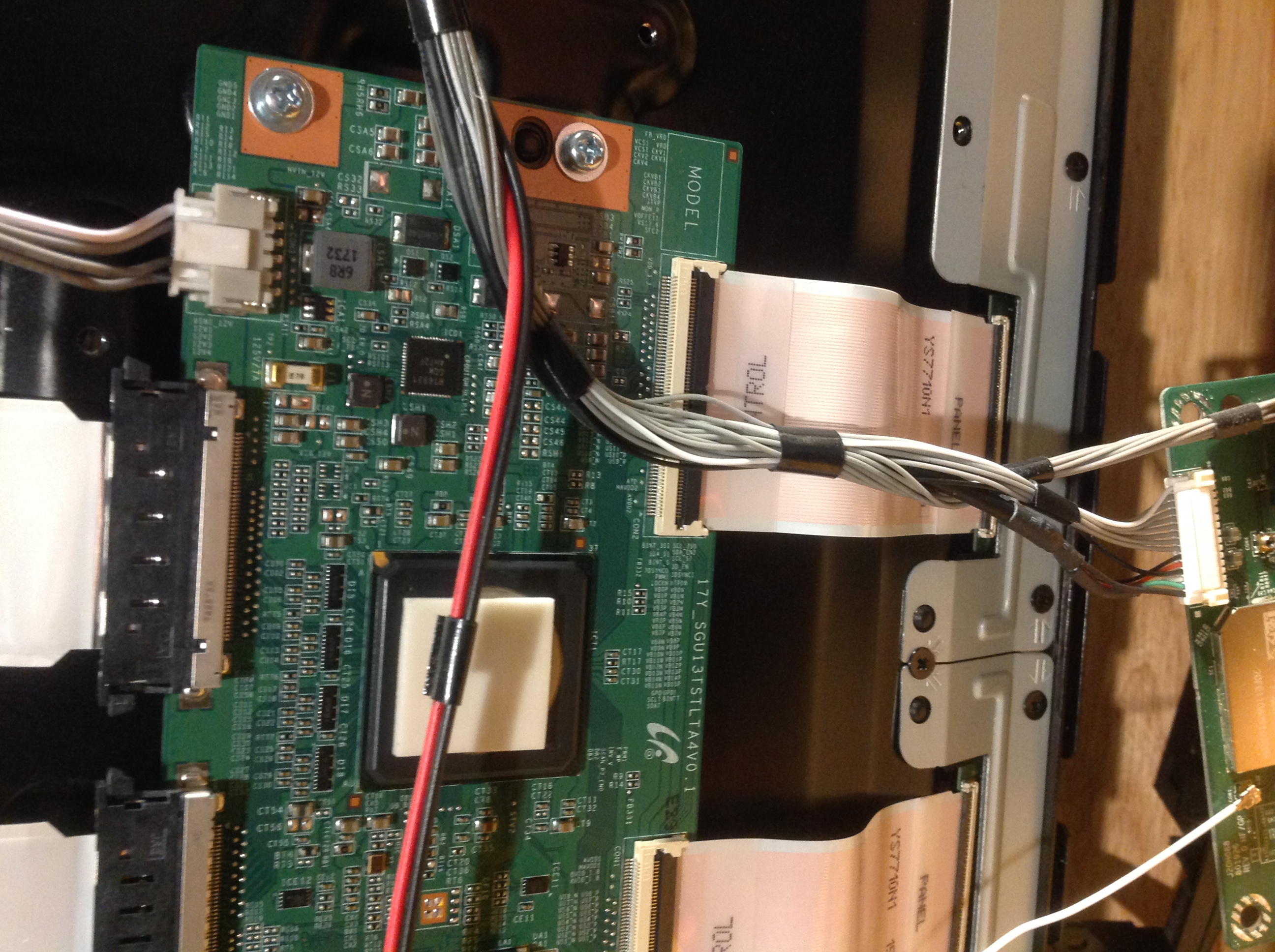

    This has a separate power supply that supplies 24Vdc. I do have 24Vdc on the power supply main fuse, as well as on the inverter board at various locations, and I also have 24Vdc on several places on the main board. Several of these locations I measured on the fuses and and several other measurements were on components. The T-Con board did not have any voltage going to the fuse (0V), and I checked the continuity of the T-Con wires back to the first power board. All of the fuses on all boards tested good, none were open.
    I will attach pics of that board to start and see if anyone can help me with a few of the components, and possibly help me figure out what they are and how to check them.

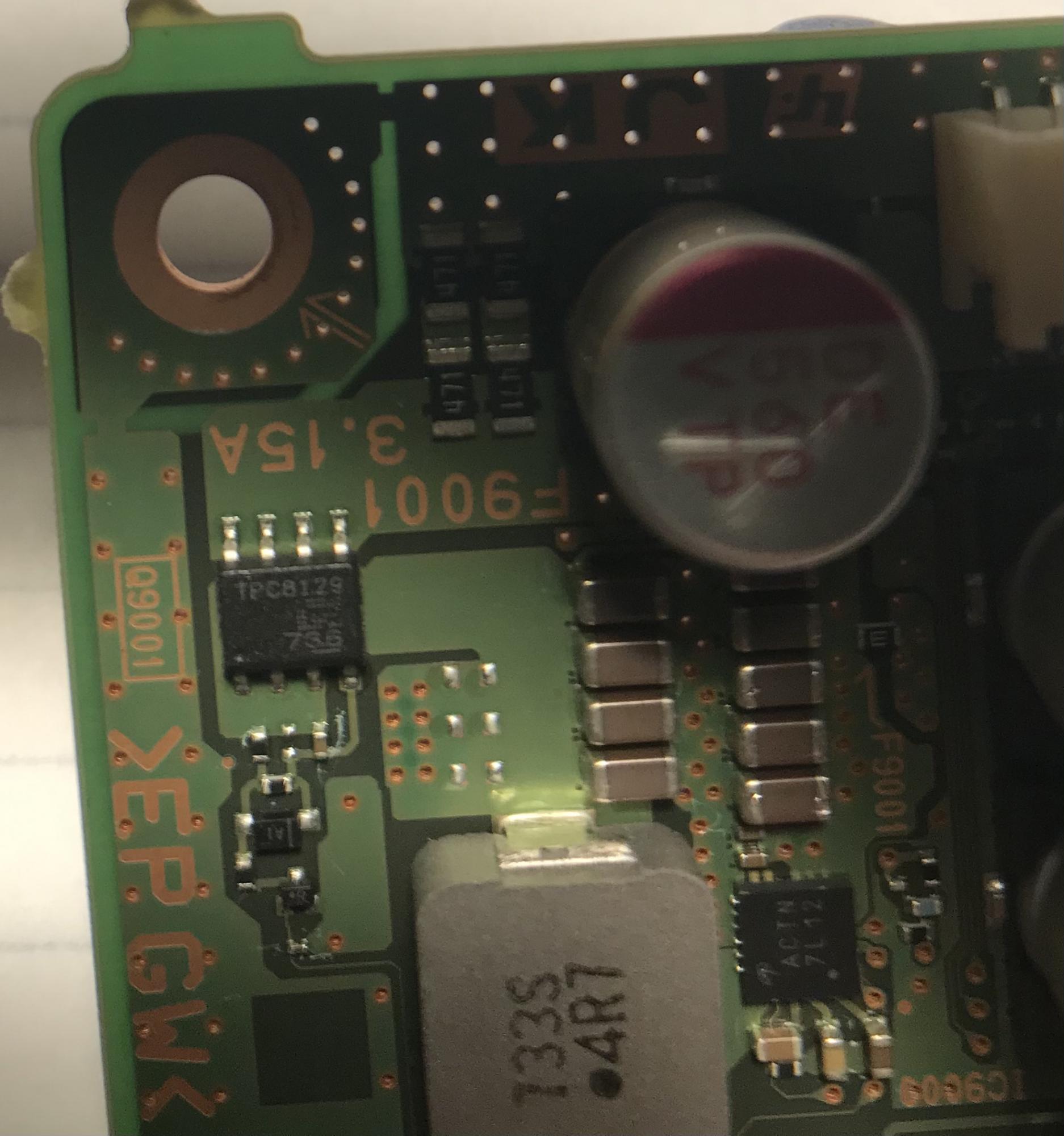

    Power Board Part # A2167843A ; 1-982-024-11
    Fuse F9000 tested Good
    Fuse F9001 tested Good
    MLCC Caps tested 100k ohms +

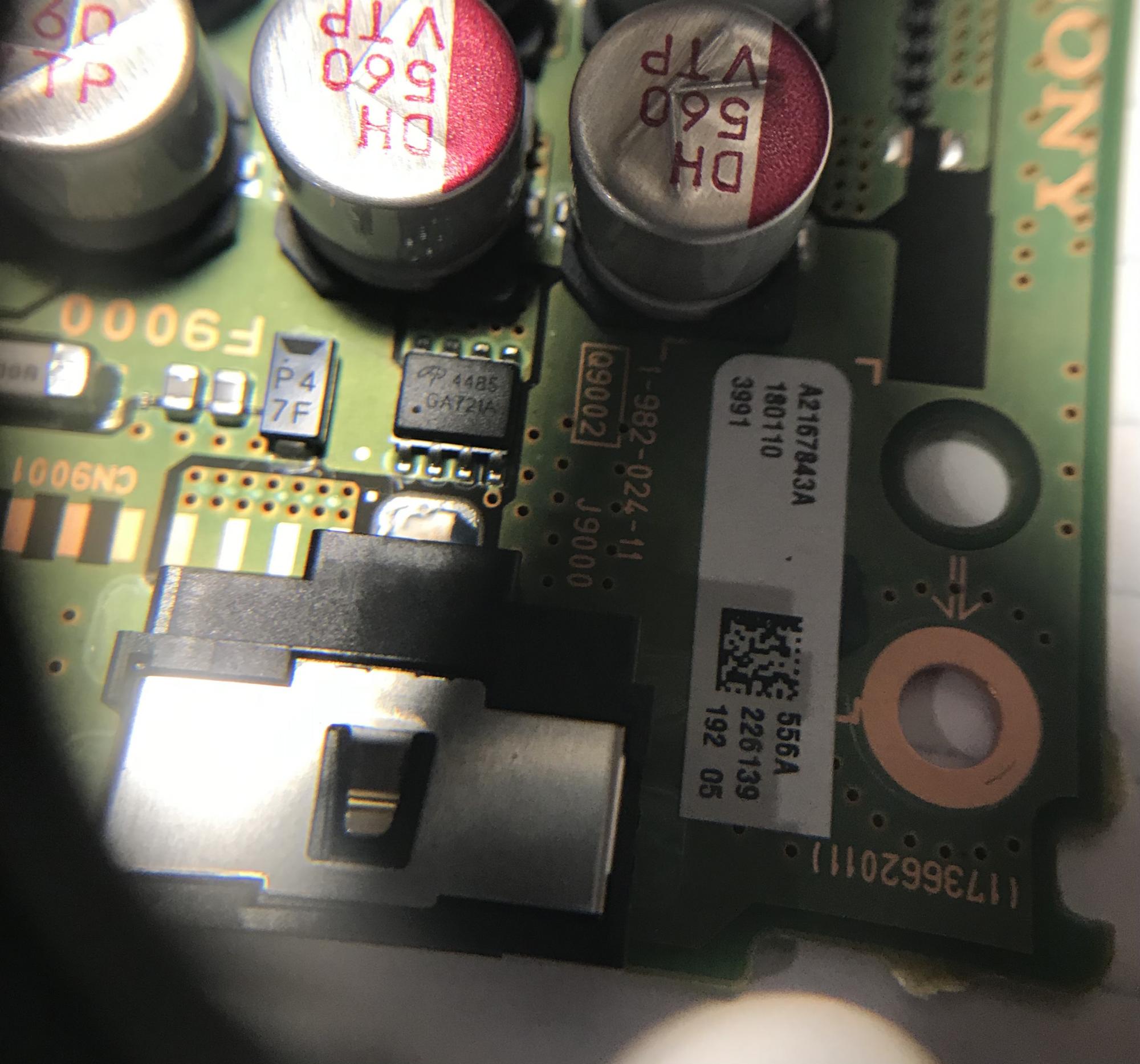

    Chips I am trying to figure out:
    Q9002
    I assume P is the manufacture: 4485 is on the first line/GA721 is on the next
    (What looked like a P, I believe is AO brand an A circled by an O (alpha and omega) 4485 / GA721A
    Q9001 TPC8129 / 736
    IC9000 ACTN / 7L12
    There are also a few parts:
    One labelled NB (Transistor?); A1 (Diode?)
    Appreciate any guidance on this, or any questions... I will post more as I get time.

      After some research considering if NB is part # CFY35-23 10GHz GaAsfet
      Part labelled 31: possibly MMBD1492 surface mount silicon switching diode
      TPC8129 MOSFET Silicon p-channel

        T-Con pics - will replace blurry second pic when I get a chance

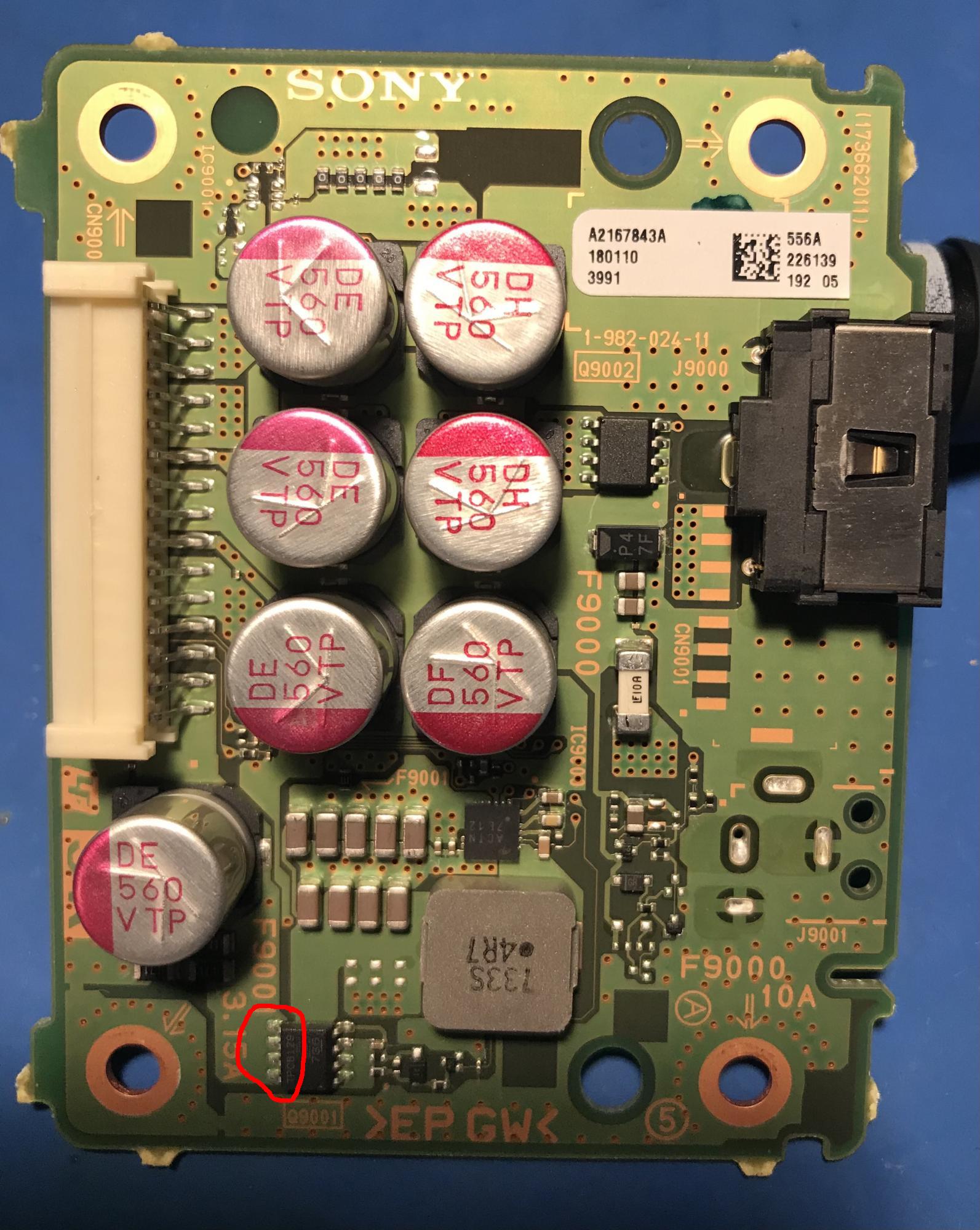

            It has been a while so I don't remeber 100% correctly but once I had a problem with that power board. Do you get any voltage on these pins I marked with red? If memory serves me correct here should be 12V, but take that with grain of salt because I could be wrong...
            • Hink85
              • May 2019
              • 22
              Re: Sony XBR-65X900e No Picture
              Ya, I don’t have any other voltages on the TV - just 24V. I couldn’t find anything telling me where I should have a standby but my initial thought was I had an issue with the main board, but after checking the T-con power should be coming from the TPC8129 chip on the power board, I started to think I had a bad power board.
              The pins circled in red (TPC8129)go to the top 4 wires on the connector which go to the T-Con.

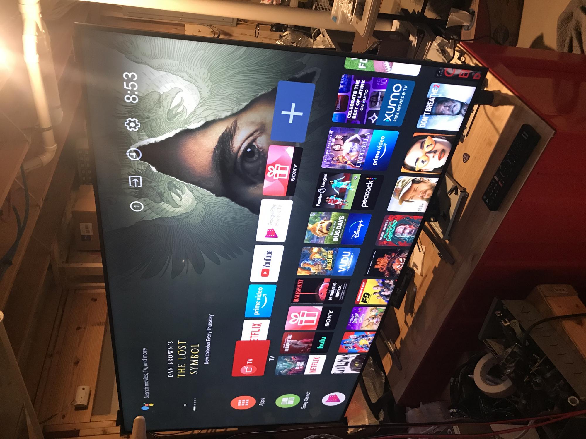

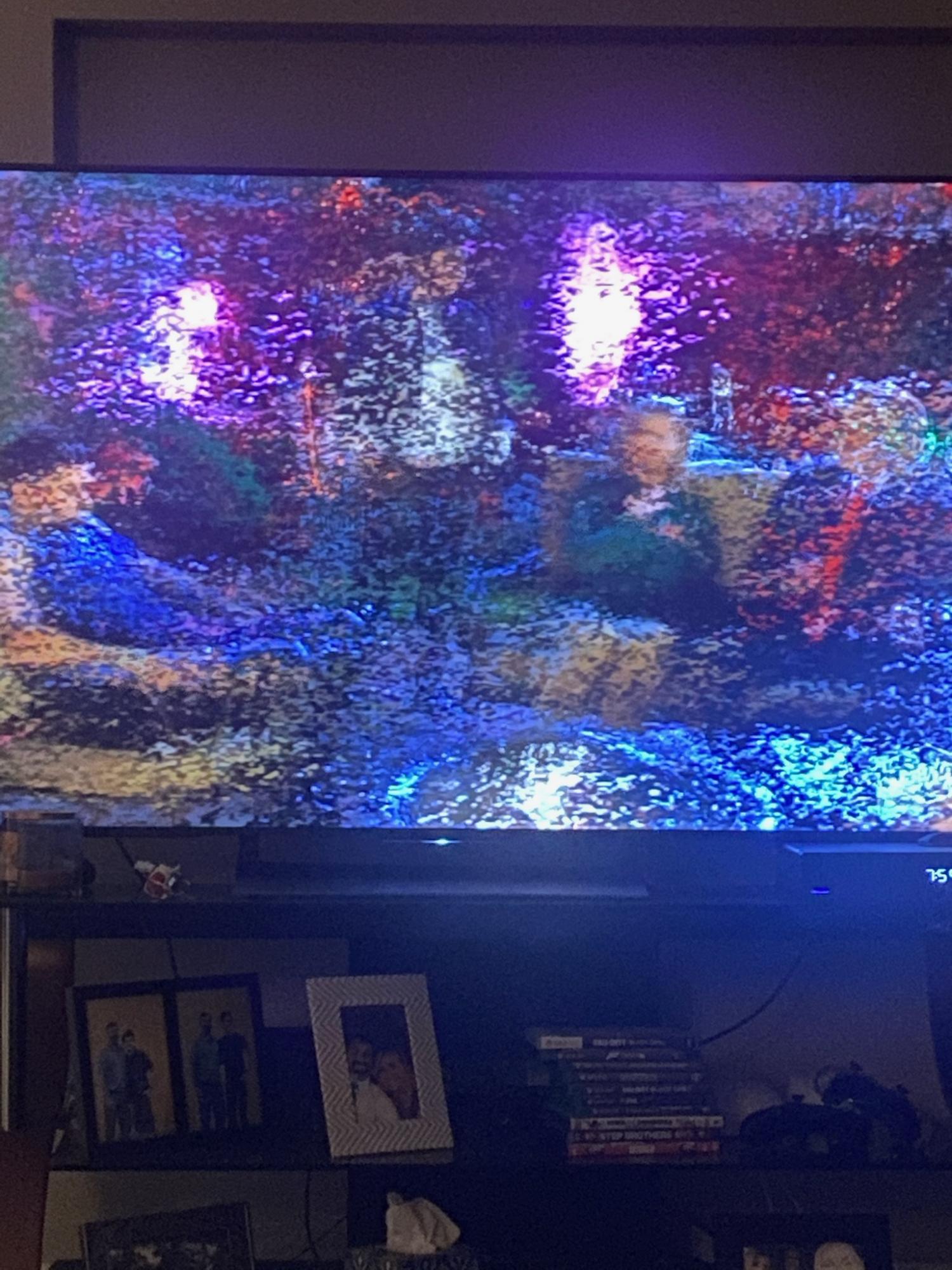

                Update: I installed a new main board from tvparts today and the tv was working well, and I didn't have to update the firmware. However, after returning the tv to the owner, after an hour or two the tv will occasionally go to a blurry screen. I contacted tvparts today and am in the process of getting a replacement, but would anyone have any indication on causes of a screen to get a blurry picture?
                I attached a pic of the screen after installing a new board and a pic of the screen after it gets blurry after an hour or so. It will clear up after doing a reset and holding the power button 10 seconds but still a pain to have to continually reset the tv.
                • nomoresonys
                  • Jan 2013
                  • 12088
                  • U.S.
                  Two easy things to try, factory reset and firmware update/pair.
