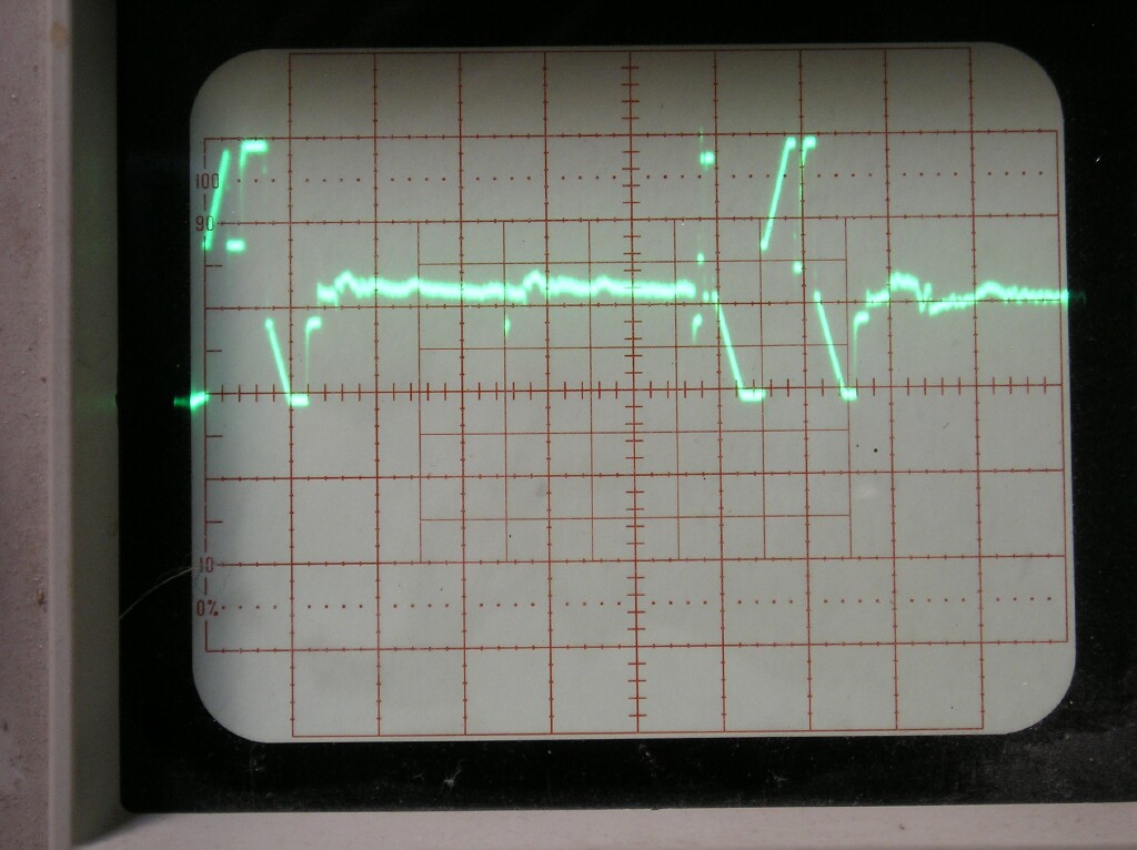

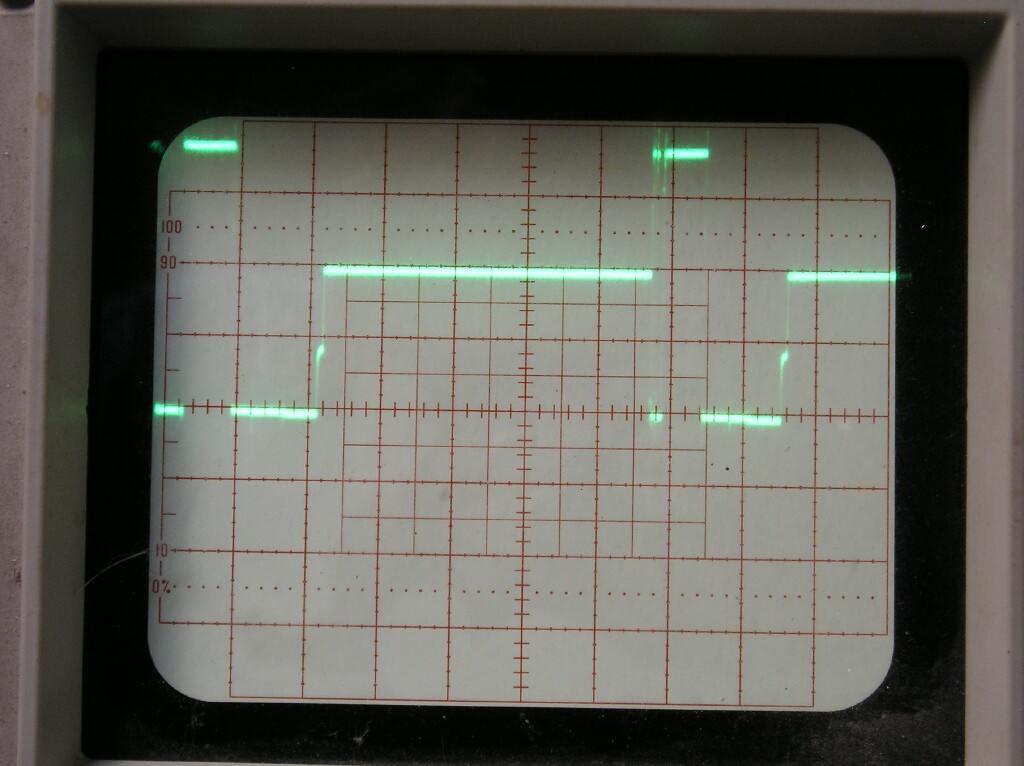

                            Well, here are some scans that show good and bad Z-sus cards. There are a number of orange 'hooks' (actually a loop of wire with a ferrite bead) near the output connectors. These were taken at B28, which is by itself, just above P5, the lower connector. In both cases, the signal was the opening sequence to 'The Lion King', but there was no visible change to the waveform as the video changed. I can't speak for other failure, but this one seems very clear-cut.
                            If possible, I will try to get waveforms on the input from the control card and the output to the Z-sus before buttoning this up. The chance of getting something similar on the input to the Y-Sus is remote, since I'd have to pull the main TV panel to get to the connector.

                              Re: 42" vizio/lg plasma sound no picture
                              The 2nd waveform is similar to my y sus output. This looks like heat sinked ipm failure? I am waiting on a y sus board to see if light comes on (d15) and should get a picture. Back in my younger days I could spend days logging scope waveforms. It is really hard getting waveforms from the control board. I hope to pick them up on the y sus board. I don`t know if ipm bad brings down the input signals from control board. On amplifiers I would remove the mosfets or outputs and scope to confirm waveform input. I would look in my ecg book to fine the ic and get all of my specs. I really miss that here.
                                Well, I've got sorta good news. I spent too many hours hunched over the tv, but I've managed to photograph all the drive waveforms from the control card to the Y-sus and Z-sus cards. I've made good notes, but I'm going to Disneyland with my Grandkids this weekend and I probably won't get a chance to put them up until Monday.
