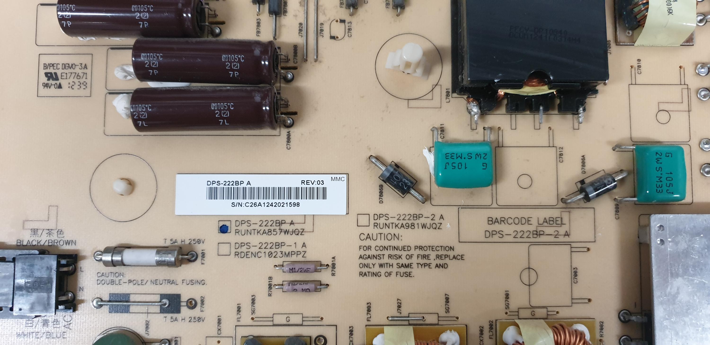

    Hey champions.
    I picked up a 70" sharp lcd some time ago. Ive been trying to nut out why it won't turn on. I've gone through these forums countless times. And its doing my head in haha.
    Psu is the delta DPS 222 BP
    whoever had it before me has replaced the SB2100 diode on D7951 with a 1N5822 diode. Which i believe is for my 5v stand by.
    I didn't like that and swapped it with a 1N5404, it felt a closer match to the SB2100 compared to the 1N5822, its the best i had in my spares bin. Let me know if that was a bad idea.
    Anyway all I see with 240v connected is a single red flashing led at front of TV, doesn't seem to be a fast blink. Possibly 1 slow. Continuous. Pressing power. Light gone.
    Checking the led strips. I have a led tester. Im getting 170v on all strings. I believe there is 30 per string. If they are a 6v led. That sounds like they are ok? The deviation on each string is around 2v.
    Ive checked the PD connector. All I get is 5v on pin15 BU5V.
    And the 3 ABC caps for PFC i believe gave 295v
    When I used 5V from BU5V via 1k resistor to each of the following PS_ON, STB,PNL_POW,OFL, DIMMER.
    I got the following. And yes. Main board not connected.

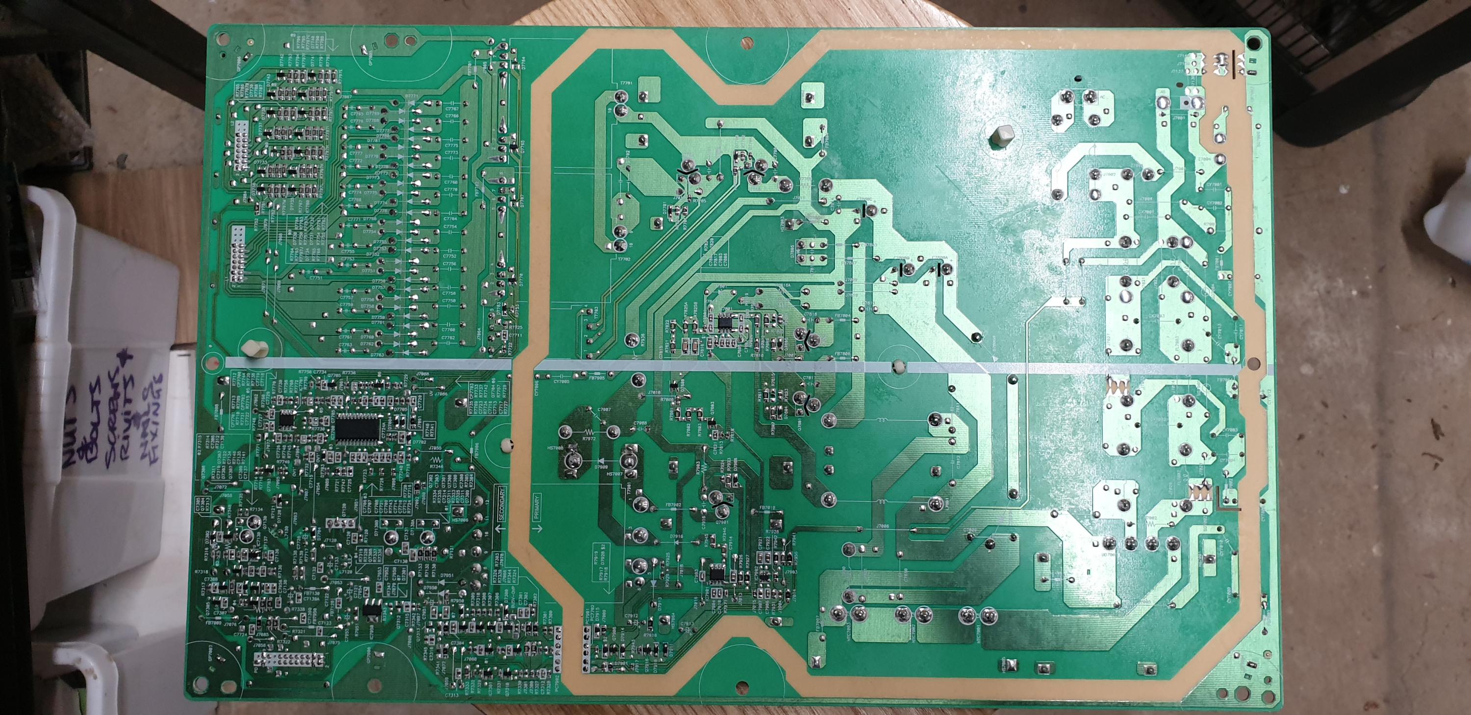

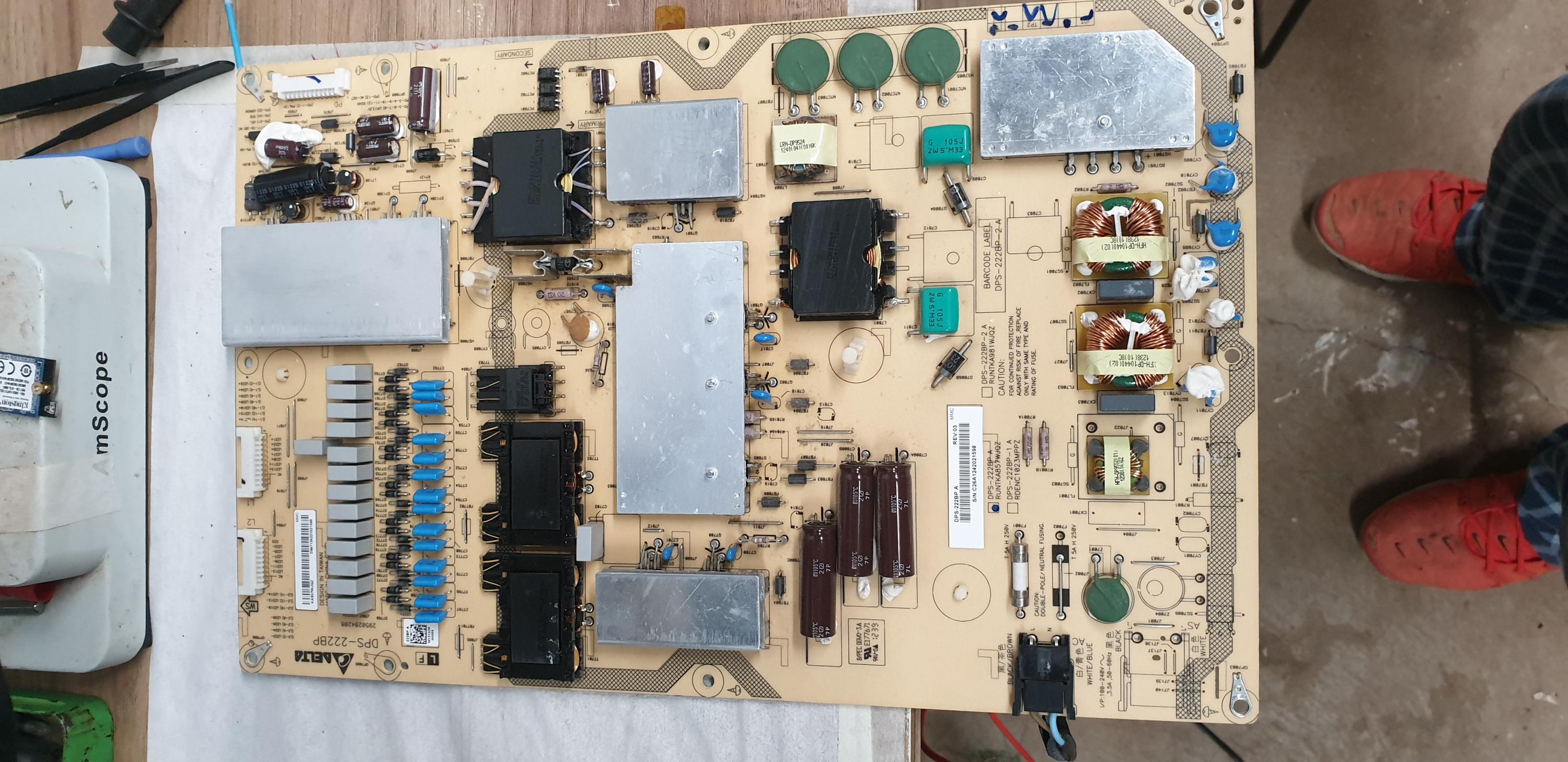

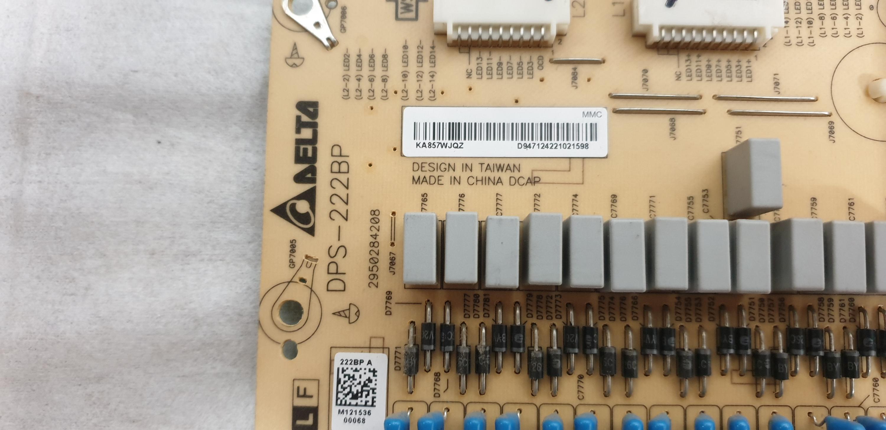

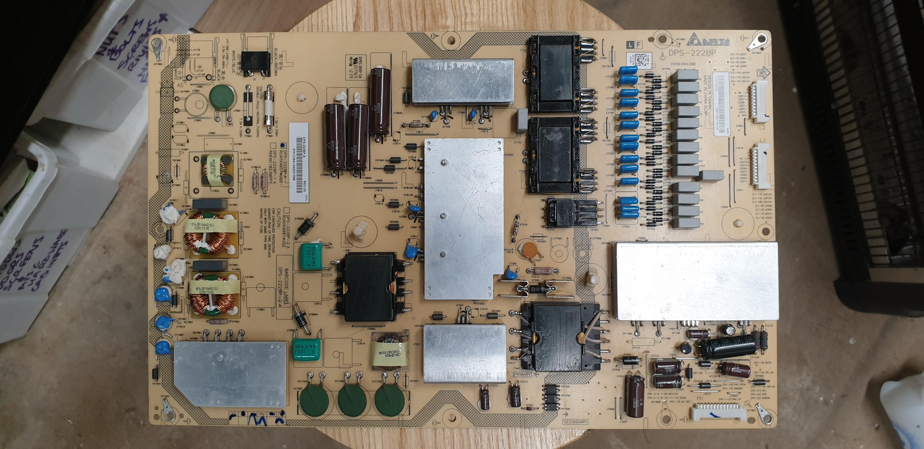

    Attached is pics of PSU

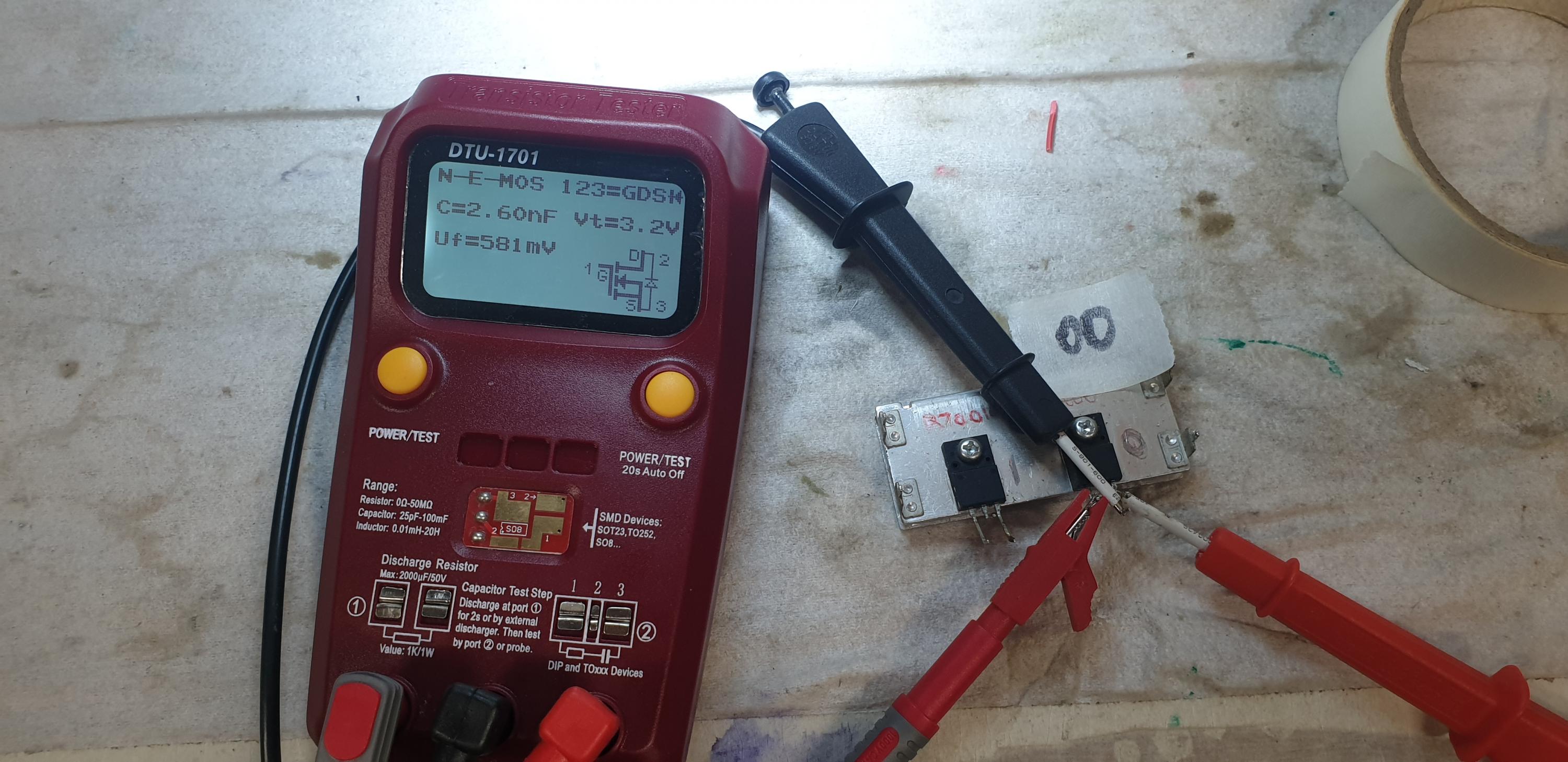

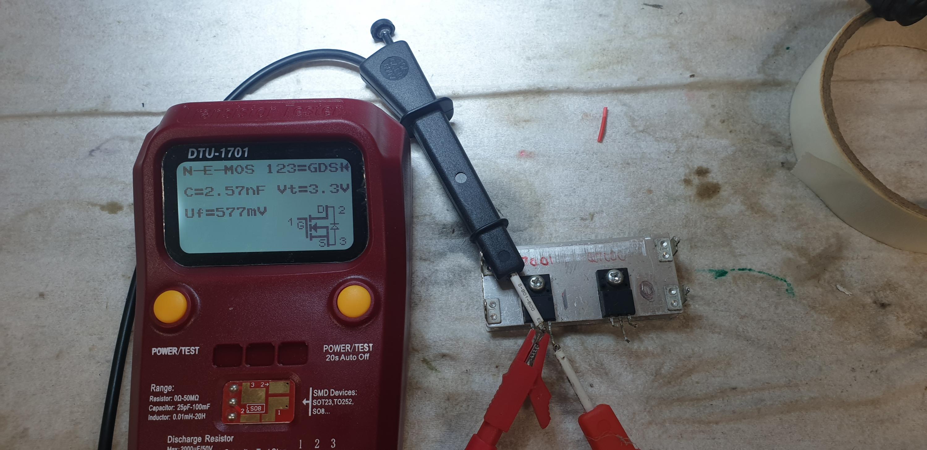

    So,
    to begin with I'm definitely not an expert but.. It seems as if the PSU is working fine and the Tv powers on right? You mentioned that the backlights flash on startup and then immediately go off, I fixed a TV in the past that had the exact same symptom.. It was caused by a faulty MOSFET that was used to power on the backlight so I would suggest that you replace the FET's that run the backlight to start with. On my PSU I had 2 FET's that ran the backlight, I desoldered them and tested both and found that one of them was shorted. On your PSU I think that the 2 FET's are Q7700 and Q7701 at the middle top of the board.
    That should fix the backlight issue but if the TV isn't behaving correctly and the PSU is pumping out correct voltages then it might be a main board fault.
          Checked those with my tester. Came up good as far as I understand fets. I also lifted some traces and checked around the fets. Attached below is my findings. Everything seemed in spec

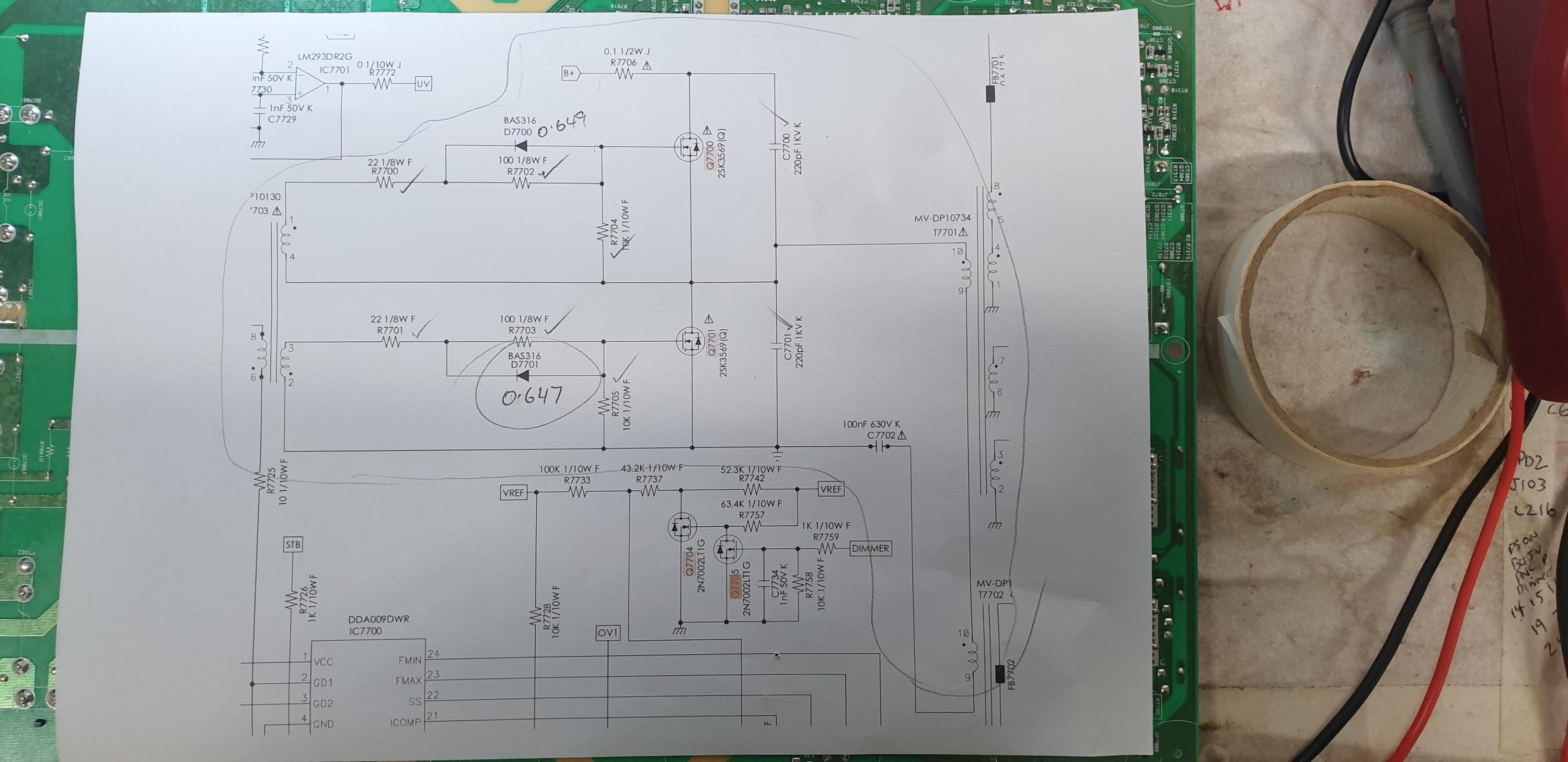

                          Some downloads from ElectroTanya that may help

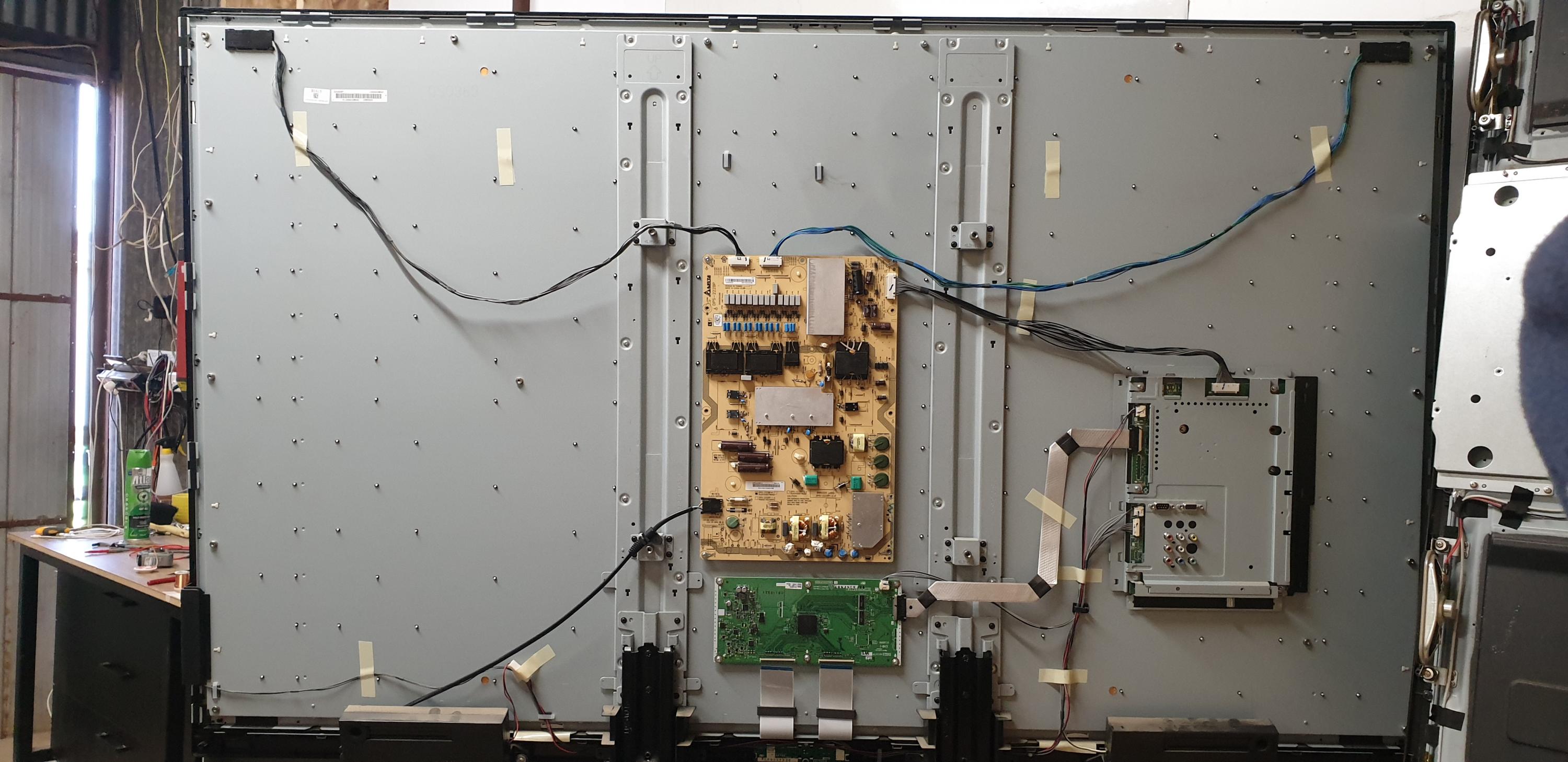

                          Adding a complete picture of the back of the TV with interconnect might also be helpful.
                              yes i have all those files (i think) well at least the PSU SCH and PHOTOS, but not all of it makes sense to me. thats why i am here. yes i will get a photo of the back of unit with everything in place.

                                Code:
                                3.28v PIN22 ERROR, 405v PFC, 150~v Backlight
                                Both TCON Disconnected.
                                Code:
                                Pretty much same result as having both TCON Connected.
                                i searched and read deep into this forum and found this post by BUDM,
                                https://www.badcaps.net/forum/showpo...6&postcount=24
                                sounds like he is confirming a higher voltage on ERROR PIN22 is Normal.
                                1v and under is an error i believe?
                                sounds more and more like LED, but my tester pulls 160v on every string. thats not solid to say they are ok, its just weird its consistent. if a string was out. you would expect to see under 160v. the videos. im not expert. this is why i am here. any other tests i have missed guys?
                                videos give me hope that mainboard and power supply are good until backlight circuit and led's. is my tcon ok?
                                And here's the rear of TV as requested.
                                thanks heaps
