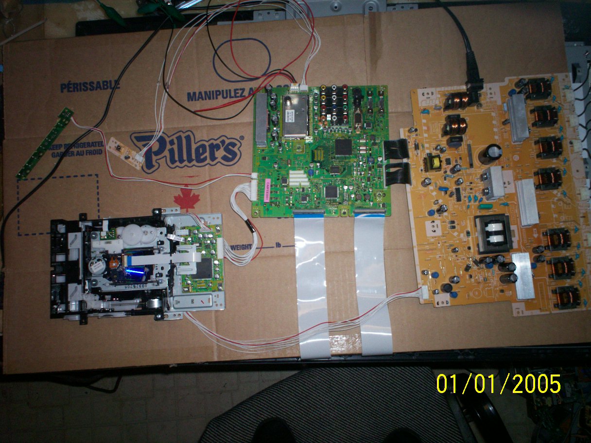

    Good folks at Badcaps,
    symptoms:
    ~ TV power-on dual-color LED shows green after red.
    ~ backlighting winks on and off once an stays off.
    ~ no bulging capa or bad caps using the ESR scope and signal generator method.

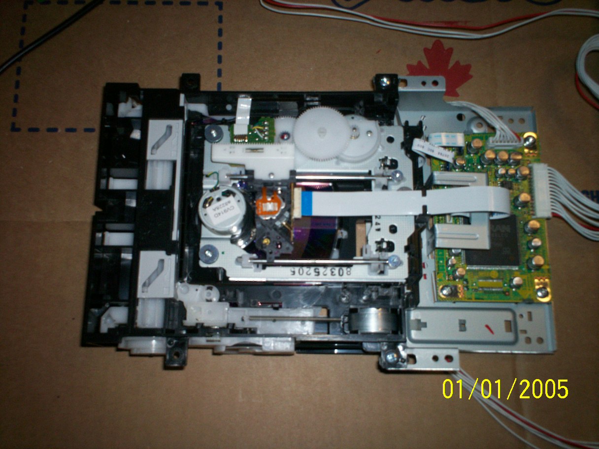

    ~ no sound from external signal sources or internal DVD.
    ~ DVD responds to panel switches: "ON" and "EJECT"
    RCA has not provided the power supply connector voltages for CP3908-1 and CP3909-1. These connectors go to the control board.
    Thank you for any assistance you can provide.

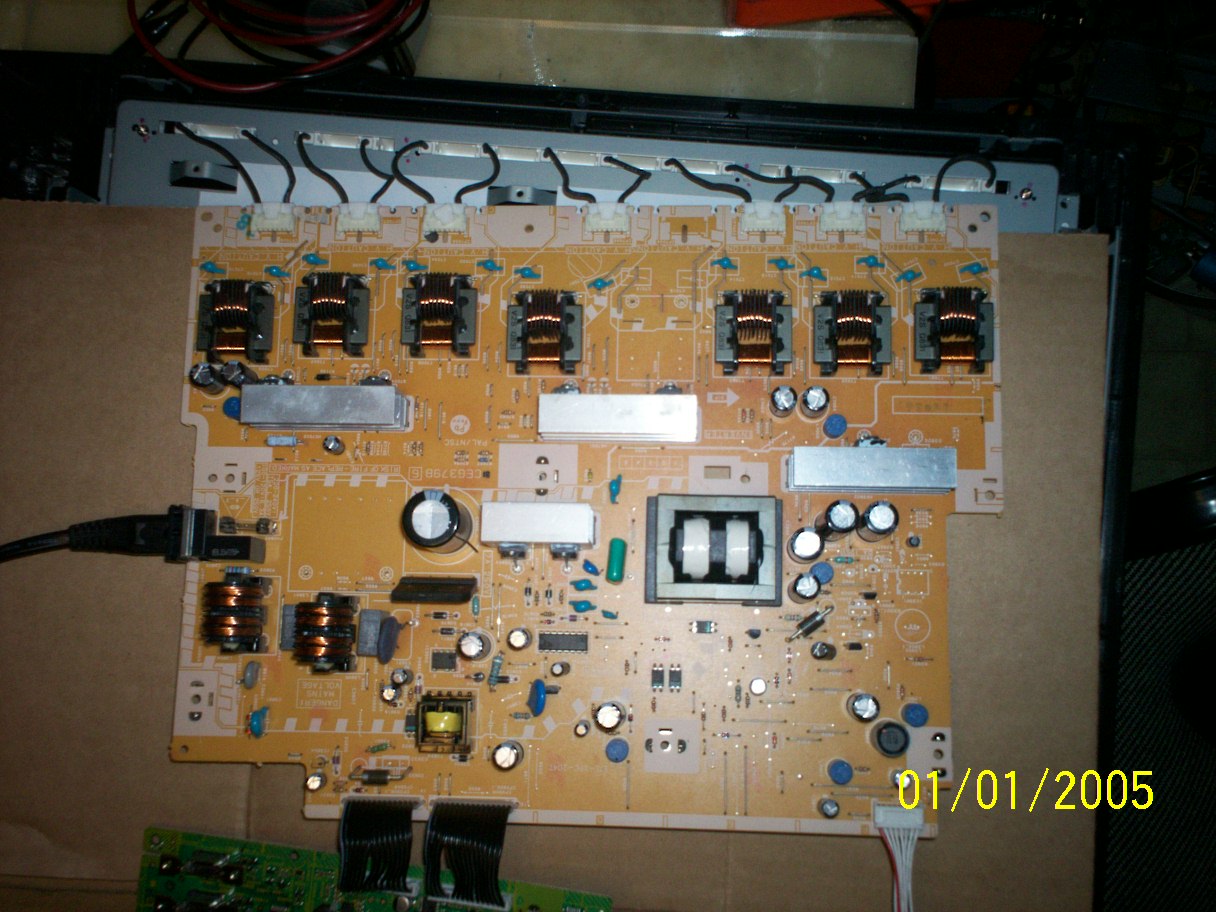

    This is horrible version of "T-CON"-less design. If there's problem with display and is traced to the this, whole mainboard replacement is necessary.
    Make sure there's none SMD fuse blown. Also make sure the backlight is perfectly neutral not pink or missing tube lit or 2 second and out syptom. This bear investigated especially around lamp supply & lamps section.

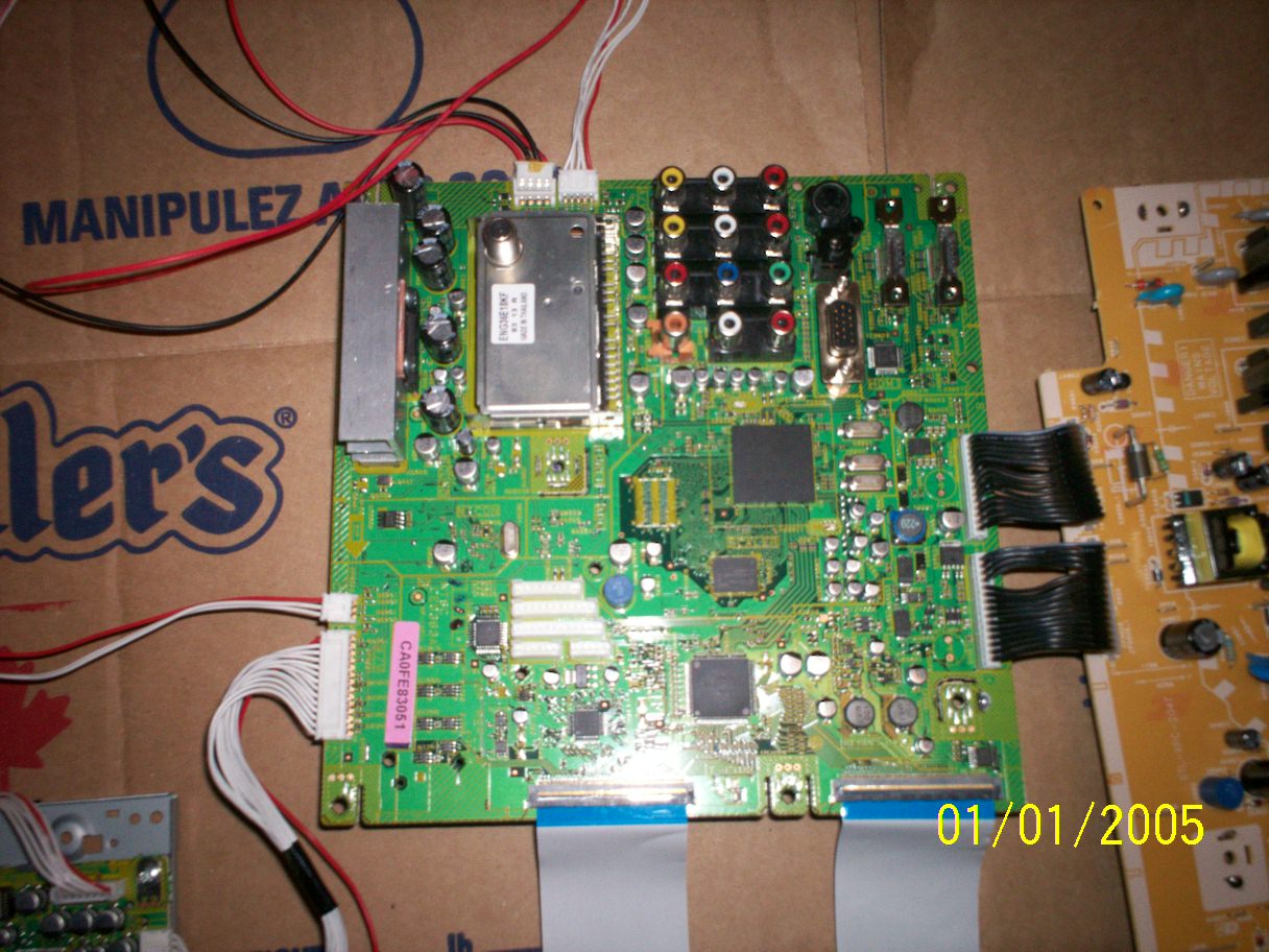

      I have repaired this problem several times. For me so far the repair has been:
      On the main board (the one in the photo with the tuner and ribbon cables that go to the lcd panel itself) there is a surface mount ic. It is a 6 pin op amp - location IC1303. It usually shows signs of overheating and sometimes one or more of the traces connecting to it are burnt. The part number for it is: ec5461ab3-g and you can find them at B&D Enterprises online.
      You need some pretty good soldering skills to replace it though... it's very small, has to be installed in the correct direction, and you may have to repair or jump burnt or broken traces.
      You can find the location of this part by looking at the board about an inch inboard of the left edge of the left (as viewed from your photo) lcd panel ribbon cable connector CP1203

              I just bought one of these sets and found the mains 6.3A fuse and varistor were toast. I replaced both and now get a red LED when I plug in the set. The LED changes to green when I push the power button and the DVD will load/eject. The display momentarily flashes "Please Wait" while the backlights flash on, then they go off and it stays like that.
              I've checked IC1303; it appears intact and normal. So I don't believe that is my problem.
