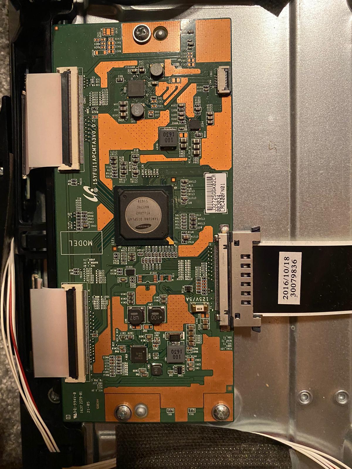

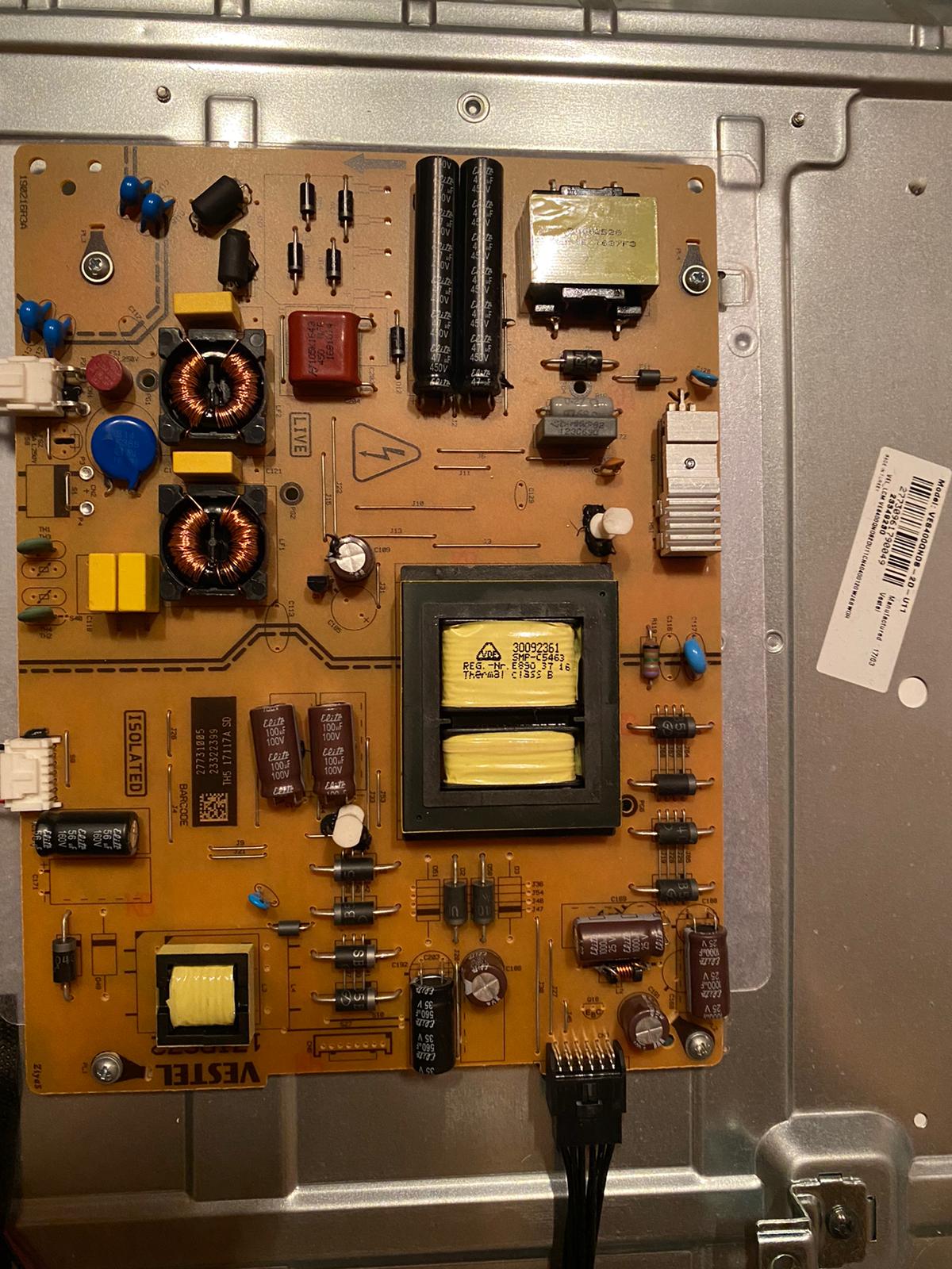

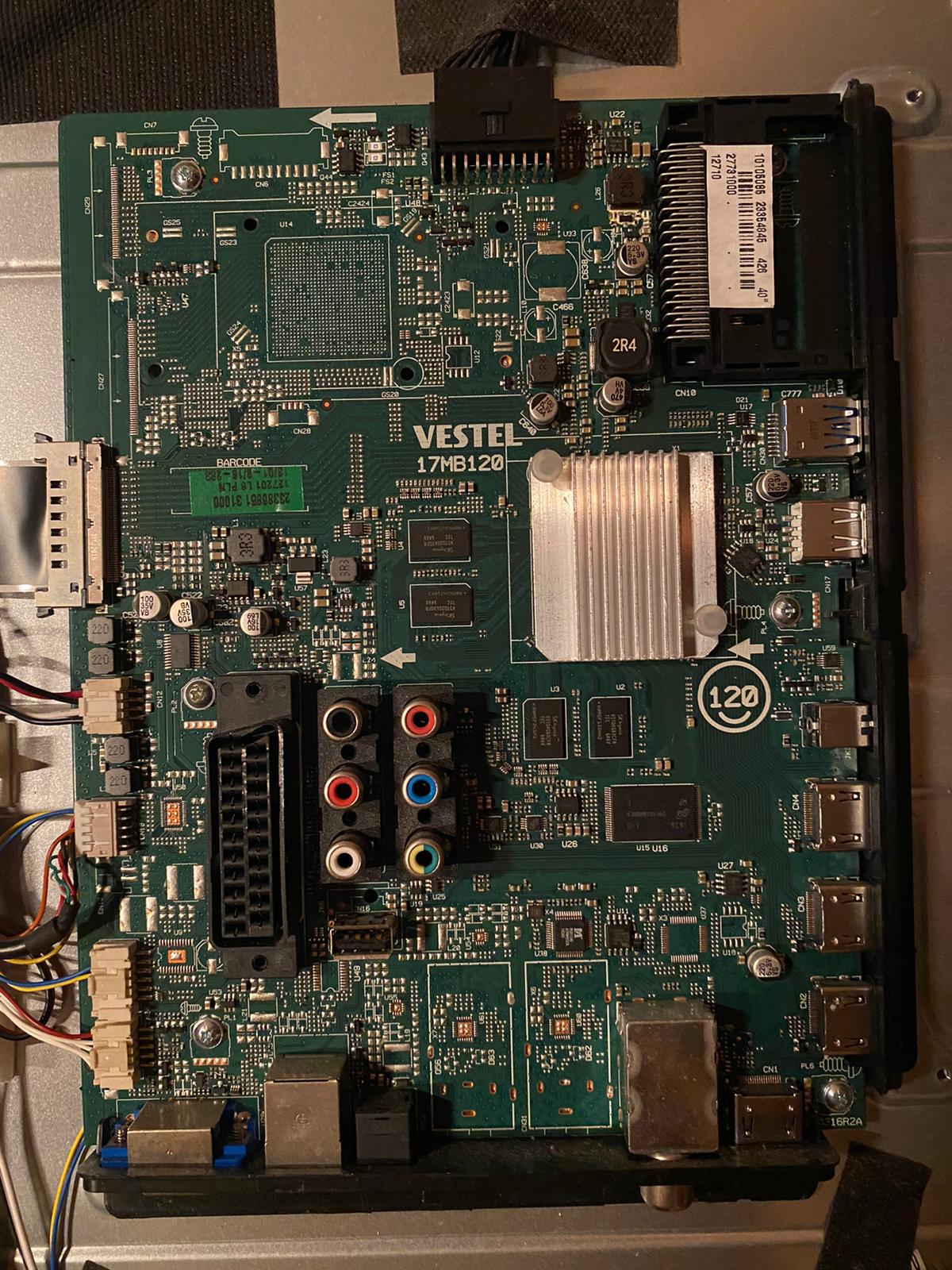

    Hi guys,
    I have a JVC LT-40C860 stuck on logo.
    I have tried all sorts of resets but nothing seems to help.
    I have checked the fuses on the main board and power supply and capacitors everything seems ok.
    From what i was reading on the forum I tend to believe it's a firmware problem.
    Now the question, is anyone who can give me the firmware so that i can put it on a usb drive and see if it solves my problem ?
    Tried contacting JVC but i got no reply.
    I've attached some pictures with the boards in case anyone wants any extra info.
    Thank you,

    Re: JVC LT-40C860 stuck on logo
    Is U13 an MX25L512 EEPROM or equivalent. If so I would freeze it with freezer spray and make cerain it gets really cold (set powered off) and then attempt to reboot the TV. You may have a failing EEPROM
      It is KH25L1606E. I'm just going to buy a spray and I'll give it a go
        I have frozen the EEPROM and it went over the logo but got reseted in a few seconds.
            Try freezing it again and allow the EEPROM to get really cold. Give it several good blasts. Very often the inside of the IC hasn't become cold enough.
                I saved a tv like that. I desoldered the chip off the board and fit it in my eprom reader. Then i sprayed it ice cold and started the read process. During the read i sprayed it again. I got a data image. Saved it, and dumped it into a new blank chip and viola. It worked , tv went out back to customer, fixed.
                  Unfortunately the freezing didn't work for me and i don't think it's worth me buying a eeprom reader. I was looking for a firmware to use with an USB drive but no one seems to have one . I'm thinking on getting another main board.
                      The EEPROM reader/writer is dead cheap and worth having in your tool box.
                            Originally posted by ioanban
                            I have just ordered an EEPROM reader/writer . Thank you
                            Hi guys,
                            I have ordered an eeprom reader/writer but i couldnt get a working driver to be able to access the info on the eeprom so I bought a replacement main board and got it in. Tv is working perfect now.
                            If any of you has a reliable software for win10 that i can use with the eeprom reader/writer please share'it with me !
