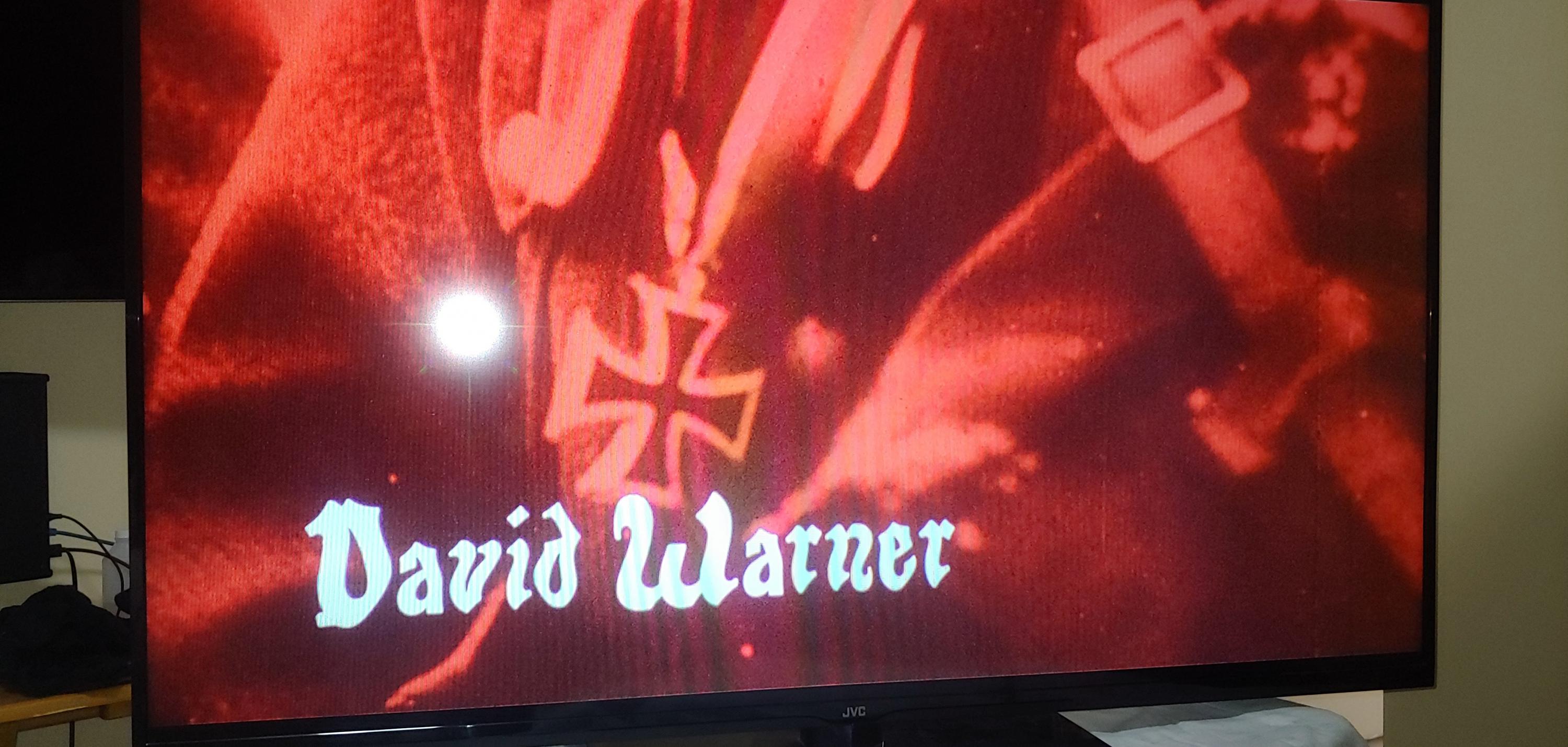

          A little update put in the new motherboard and is working great. This is actually pretty decent set even though it's only 1080p max.
