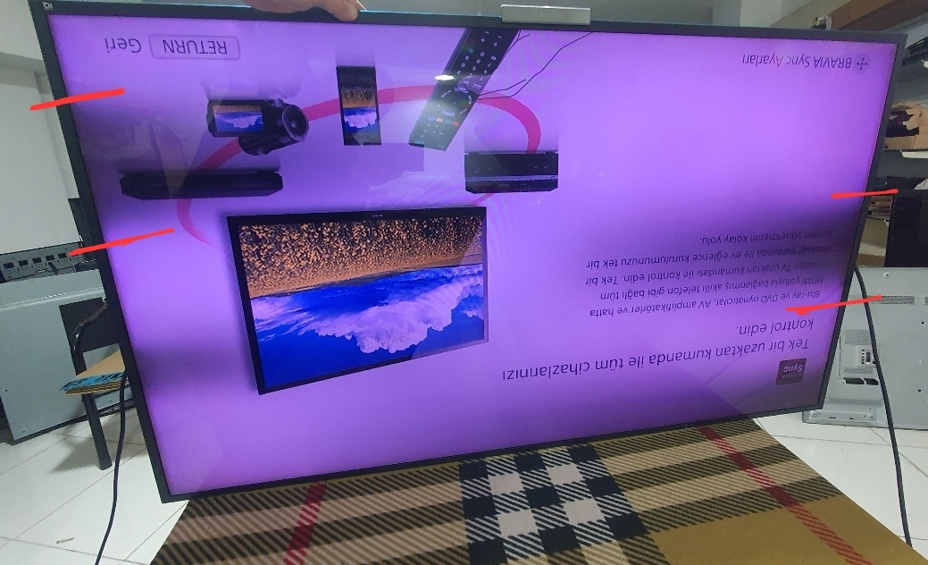

          Re: SONY KDL-55W905A 4 Blinking Red light
          It is tested by isolating 1 to 8 pins with tape on the flex cable between the led driver and us. If the 4 lights do not fail and there are shadow areas on the screen, the leds must be replaced.
            https://www.youtube.com/c/AhmetErolUsta
