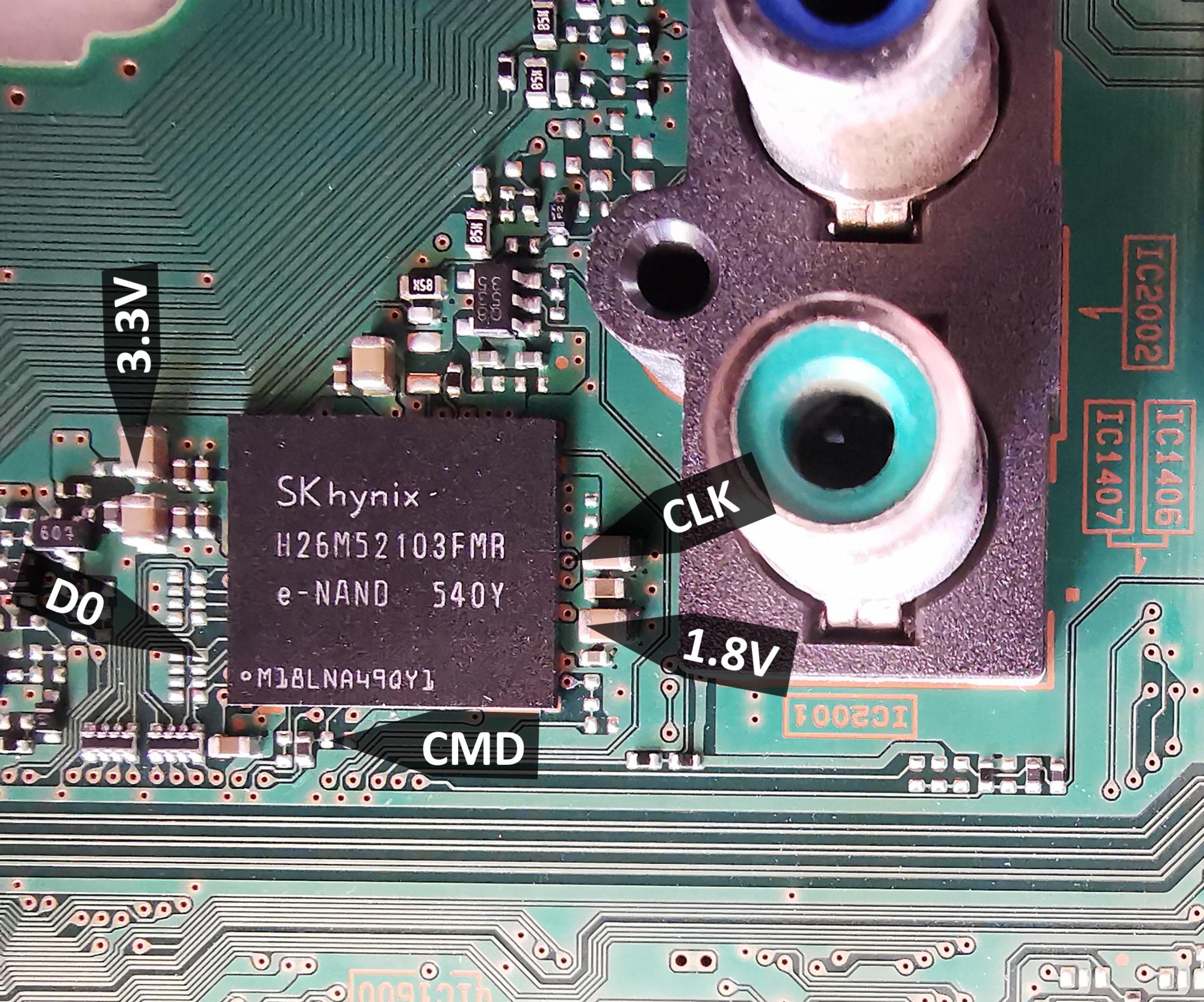

                Re: Emmc RT809H and Sony kd55x8505c SK Hynix H26M52103FMR
                Sony emms pinout

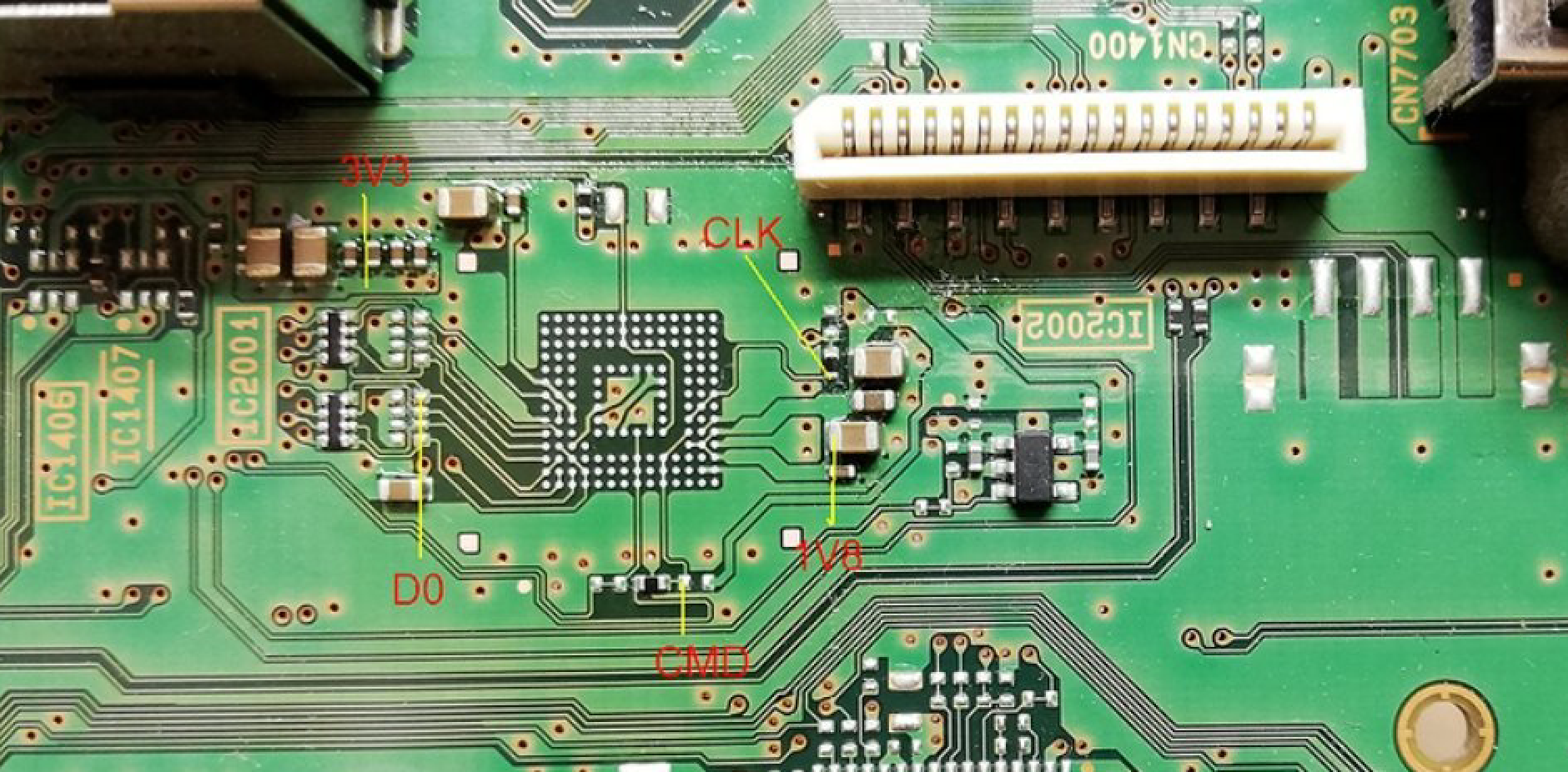

                    Thanks for the replies!
                    1- The layout of the pinout is not the same but I found an image that matches better my board and shows the PCB traces underneath the chip so I was able to make a diagram.
                    https://www.romflasher.co.uk/wp-cont...1/03/WF804.jpg
                    PCB traces
                    2- The link for the MK tools is assuming that we have an UART connection. For this board I don't find any UART connection, so EMMC is the only way to go.
                    I'm trying to read it via a USB card reader since I don't have a RT809H flasher...
