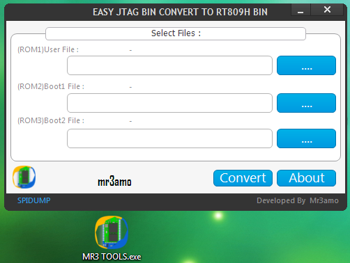

                  I can't say anything about the RT809H, you'll have to rename files for it and probably divide the USER partition (15Gb) into 4 Gb....

                    • chone
                    #29
                    This application divides the large emmc files to use it on the rt809h
