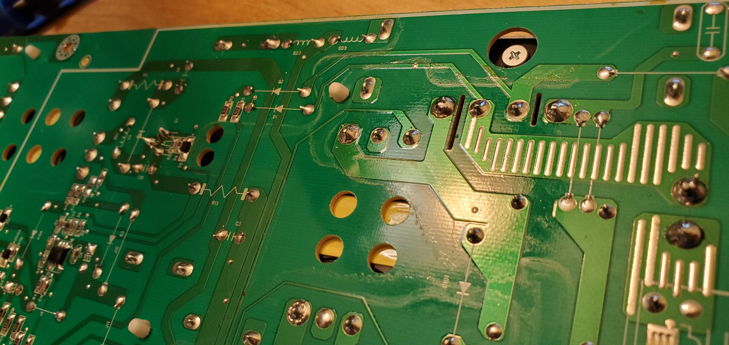

              Re: Vizio E65-E3 Dead after backlight replacement

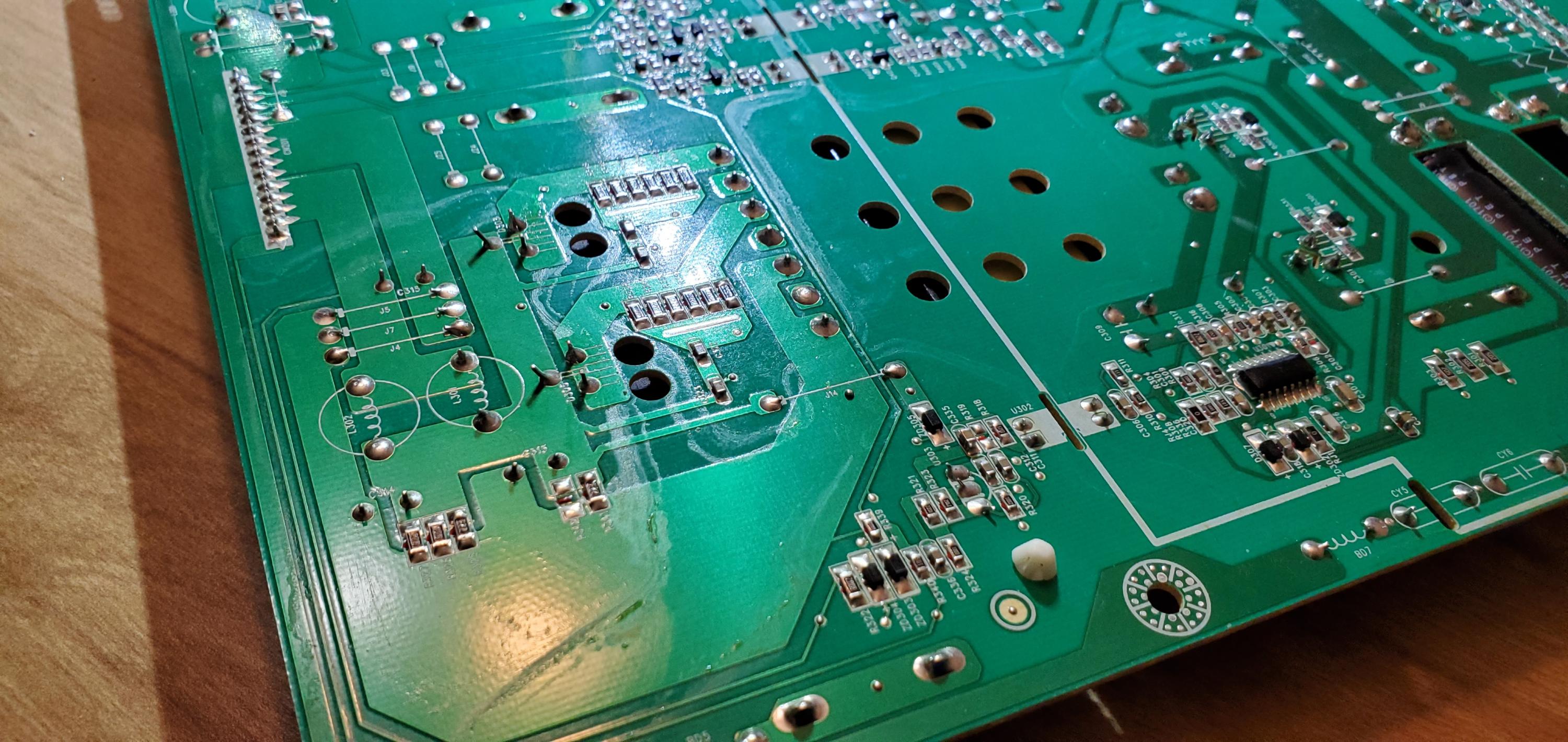

              Re-flow the iffy joint first picture bottom middle of picture, left one of the three there, see the cracks? Might not be a problem just looks a little iffy.
              • a460guy
                • Oct 2013
                • 59
                • it's

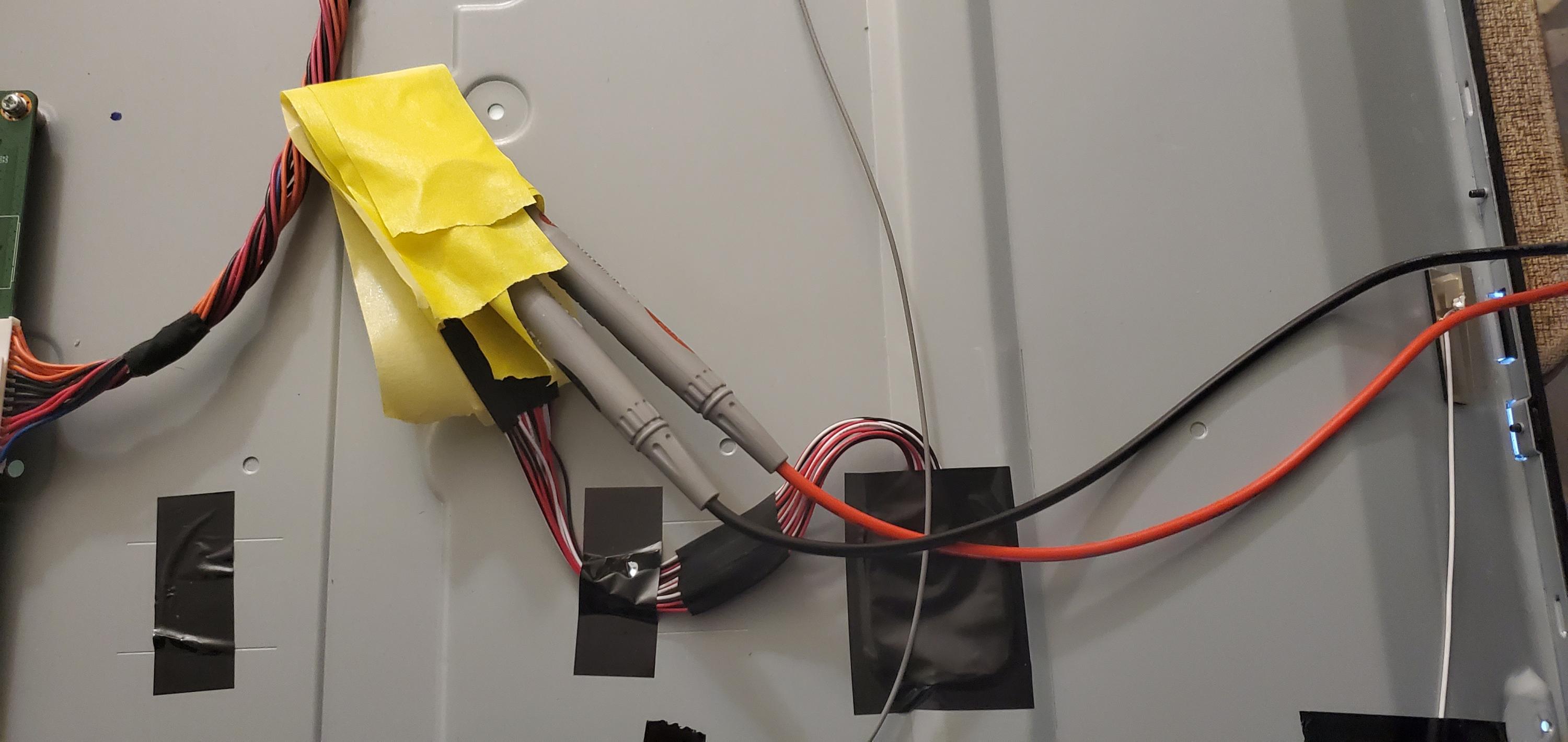

                Reflowed that one and also pulled the mosfets and they checked no short... should i be concerned about that residue stuff that around the board?
                Diah....here are a few pics of what i did to check the leds...where is this diode your talking about? I dont remember seing it on the strips or in the harness.
                  each LED unit had build in ziner diode for currents forward opposite to the lit diode.
                  BTW; you wrote before you found 12 LED didn't work.. this cant be all get defect at once.

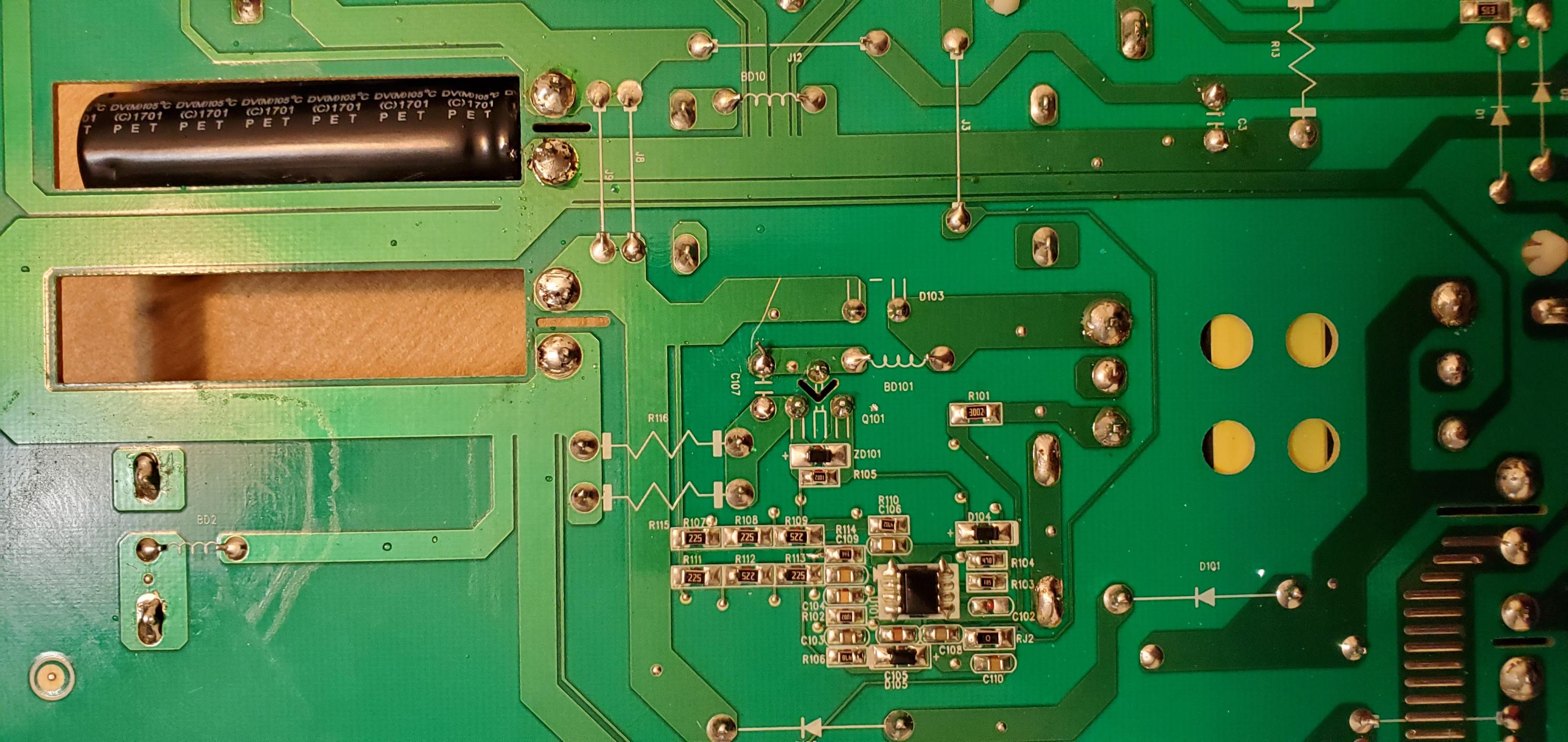

                      Post #3 you say
                      Pin 1 Stby = 0V, Out of standby = 0.001V
                      which is odd since normally the standby voltage goes from 0V to 3V or 3V to 0V

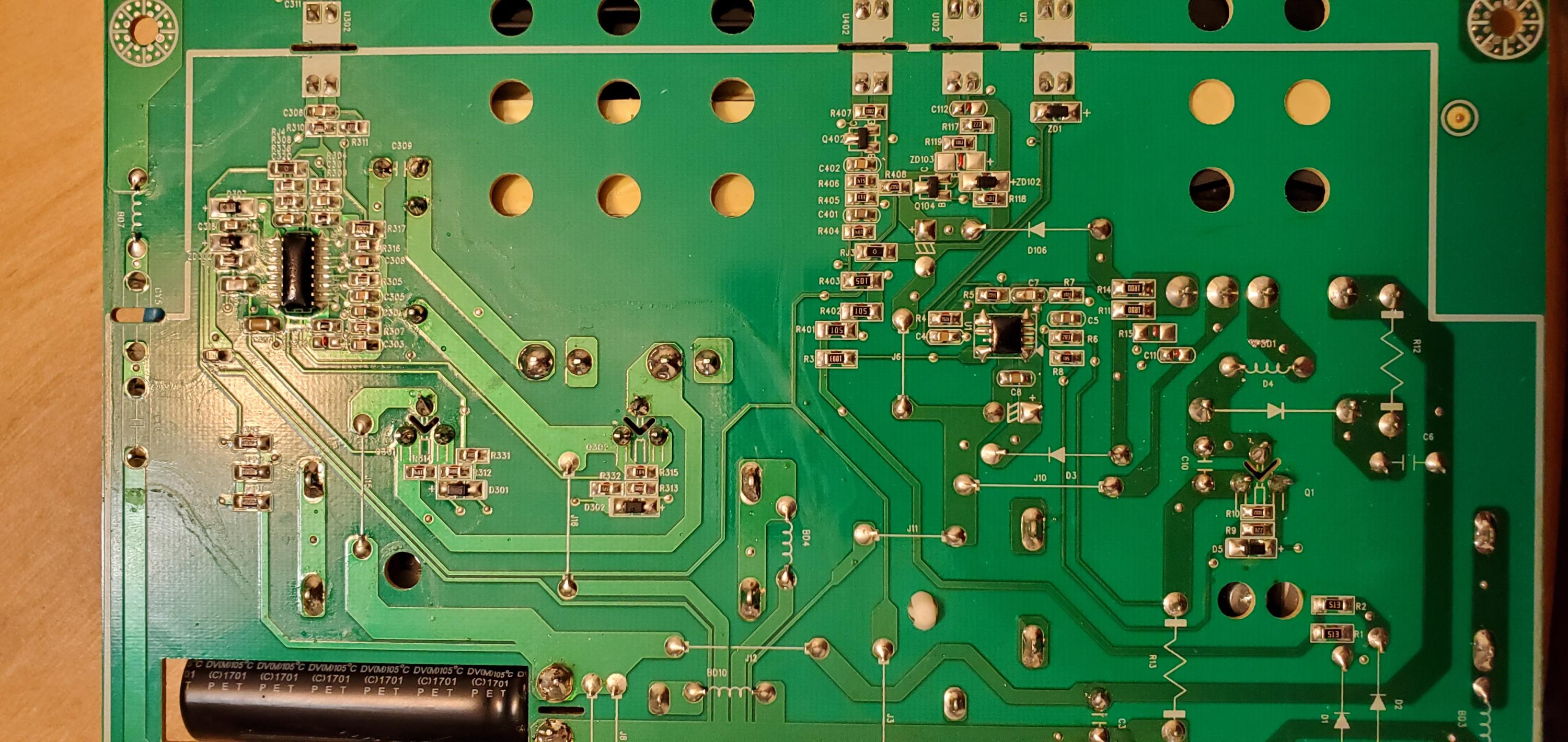

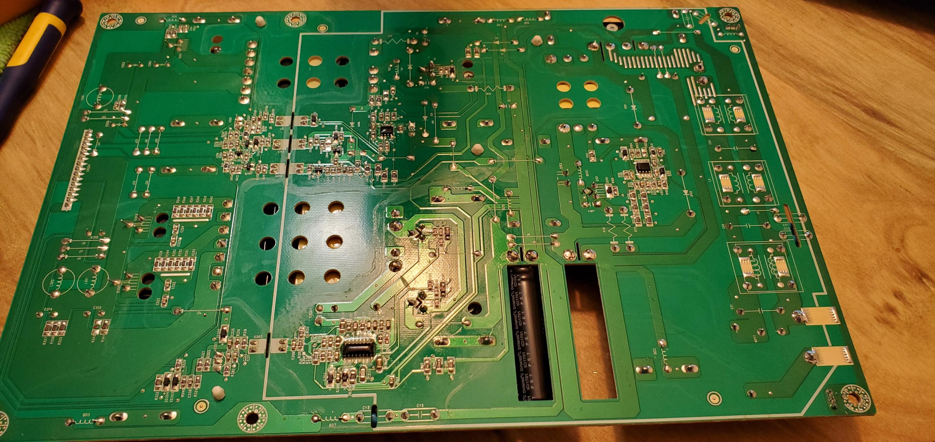

                      Post #11
                      Shows no voltages on the led connector pins.
                      Post #17
                      C2 voltage at standby = 170V and out of standby 164V
                      The voltage should increase I believe to around 380V and not drop
                      I think you are missing the led driver supply and may well be linked to the C2 low voltage.

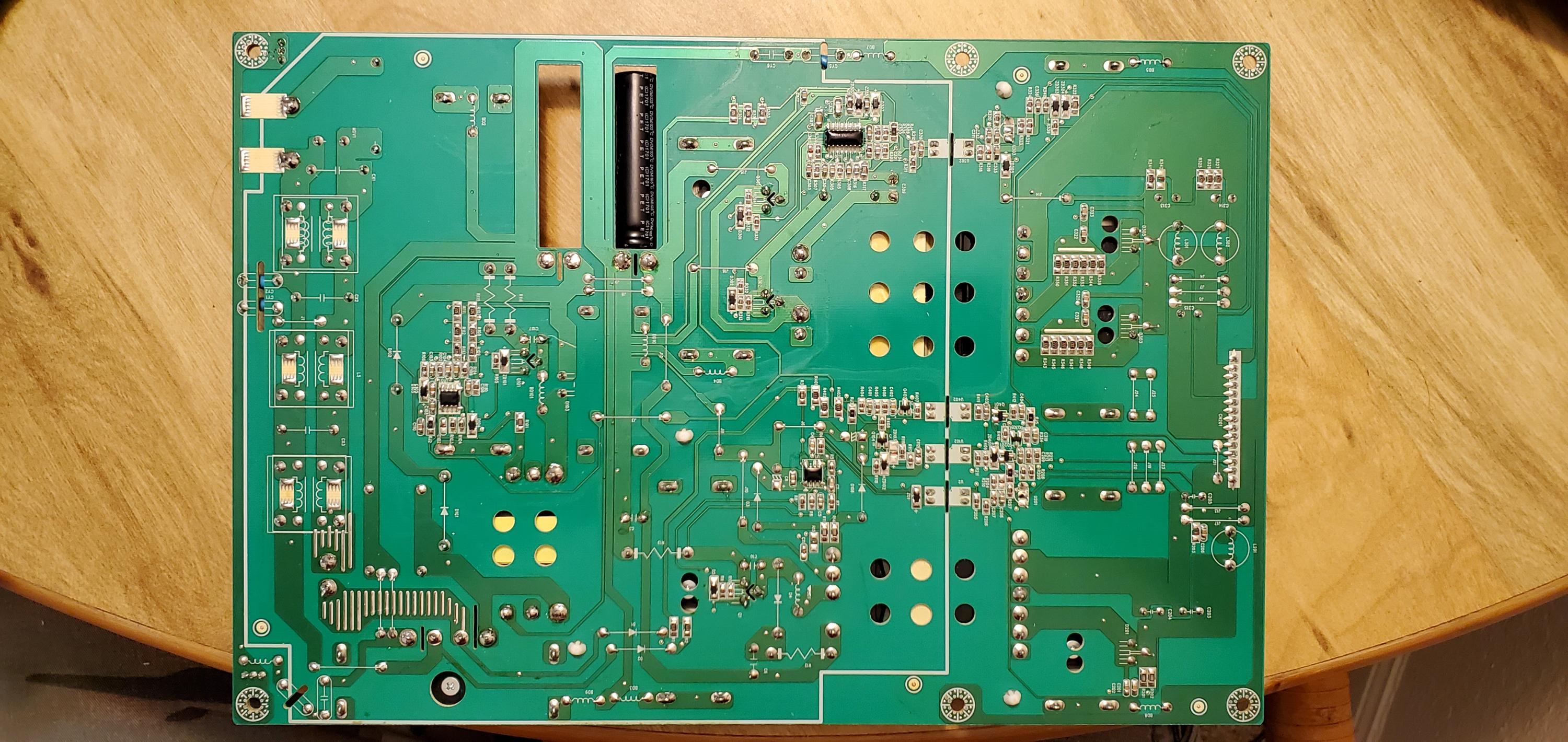

                      What is the led driver IC part number. A photo of the underside of your power supply could prove usefull.

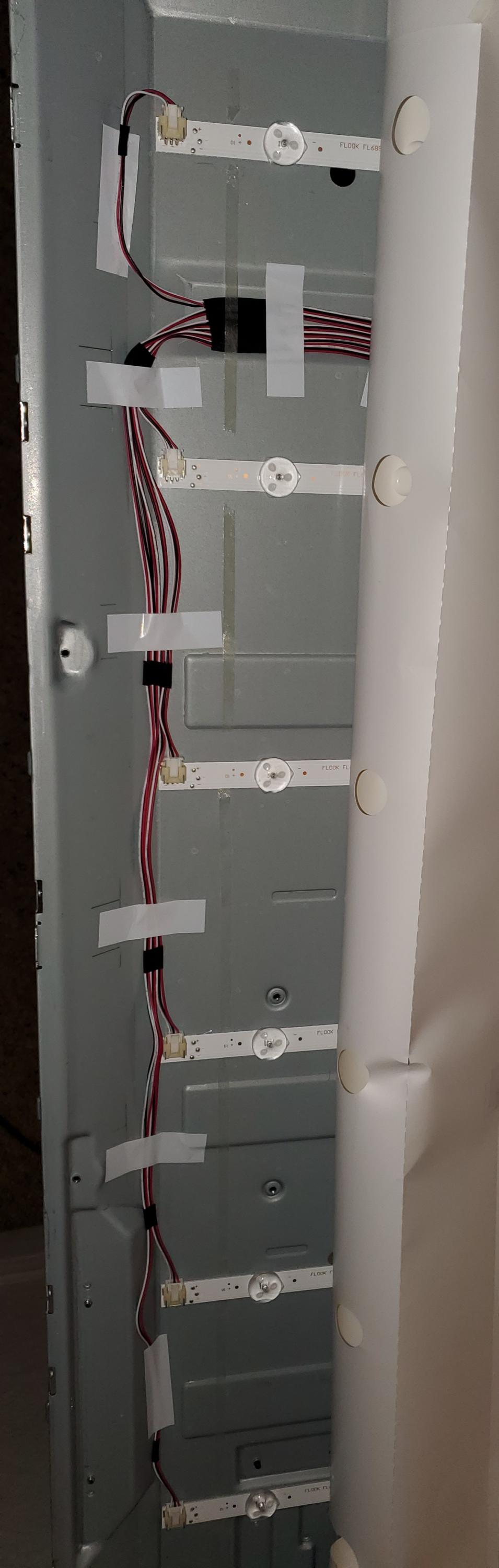

                        #31

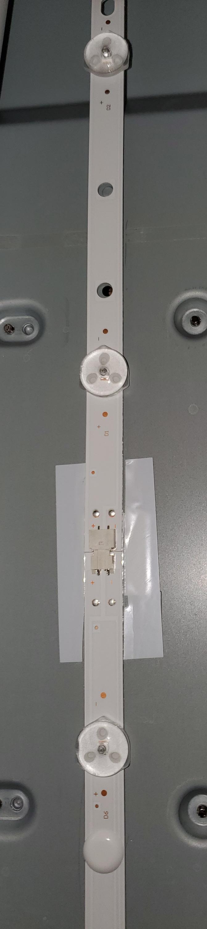

                        Diah...here are acouple pics of the strips
                        • Diah
                          • Feb 2013
                          • 6357
                          #32
                          unplug the socket from the strips and start testing all led by digital meter diode mode.. you have 2 points on the strips close to each LED + - with digital meter the good LED will lid on dim on one side and when you reverse the probe will read ziner diode between 0.54 -0.78
                          go thru all LEDs one by one.
                            I cant make out anything on the chips...here are pics

                              #34
                              They all lit up dim... but all read ol in reverse...is this diode super tiny next to the led? Cuz i dont see it
                              • Diah
                                • Feb 2013
                                • 6357
                                #35
                                the ziner diode are build in you cant see it
                                  from where you bought this strips,,, the LED on them are normal LED not For TV backlight. they are with out ziner diode.. here are your problem friend.
                                  interesting matter now.. but let us go deep with the issue..
                                  each socket you have 3 wires white / black / red.. the red one where its goes on the strips?
                                    red is postive for both strips.....white is negative for 1st strip and black is negative for the 2nd strip
                                      I bought it on Ebay! (Singing Weird-Al song)....lol
                                      if you are sure that yours digital meter diode mode working or beep tone mode too.. then
                                      refund them.. they are absolute jock. TV backlight LEDs are with build in ziner diode.. normal strips for swimming pool or living room romantic view are with out this ziner LOL
