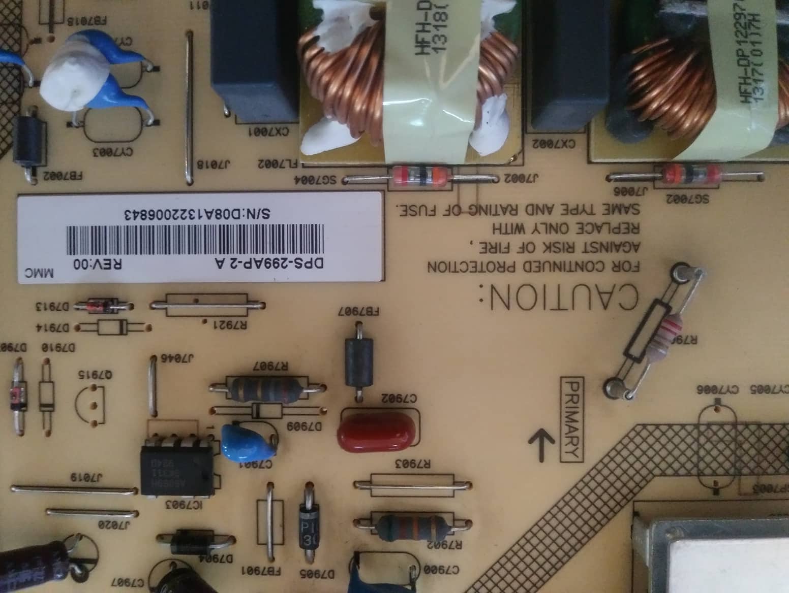

    I got a Sharp aquos lc-80le757u power board problem.
    Old owner change the thermistor by another part ??? and didn't work
    I repair all other problem, but I need this part for finish this board ( part ntc7001 )
    Can someone have a shematic or list part of the board.
    dps-299ap //RUNTKB159WJQZ
    Pic in the attachment
    Thanks a lot

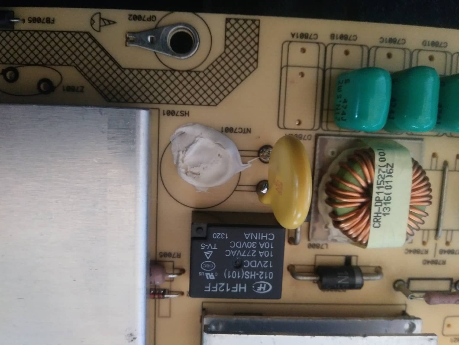

    Re: Sharp aquos lc-80le757u thermistor identify
    It is a SCK056, If the thermistor was bad, the relay contacts are also bad.
    • deltacomet
      • Apr 2016
      • 8
      Relay is ok. I tested outside the board.
      I don't know why the old owner change the thermistor by a ceramic capacitor ???? but I changed one bad ceramic capacitor and a mosfet in the primary section and I continue to checking part...
          I remove the relay from the board and with a bench power supply and multimeter I test a lot of time to know if the contact was ok and not damaged.
            The new thermistor will tell you after operating for a few hours if the contacts are ok or not.
                Thanks, After few day of testing, all work fine. Right thermistor
