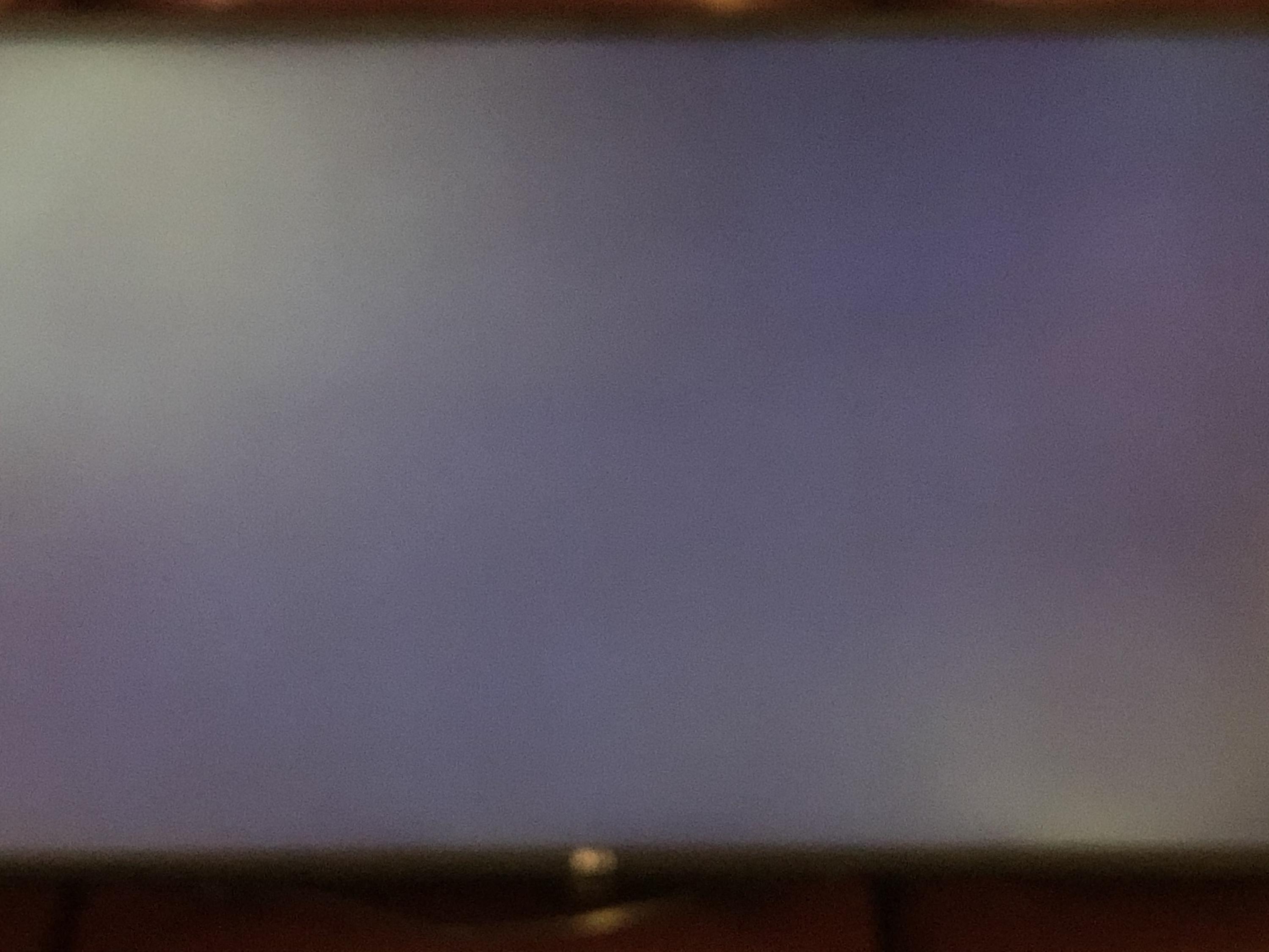

    Suspect bad panel, but looking for advices especially from those familiar with this model.
    TV is turning on, there is backlight and sound.
    The picture is grey.

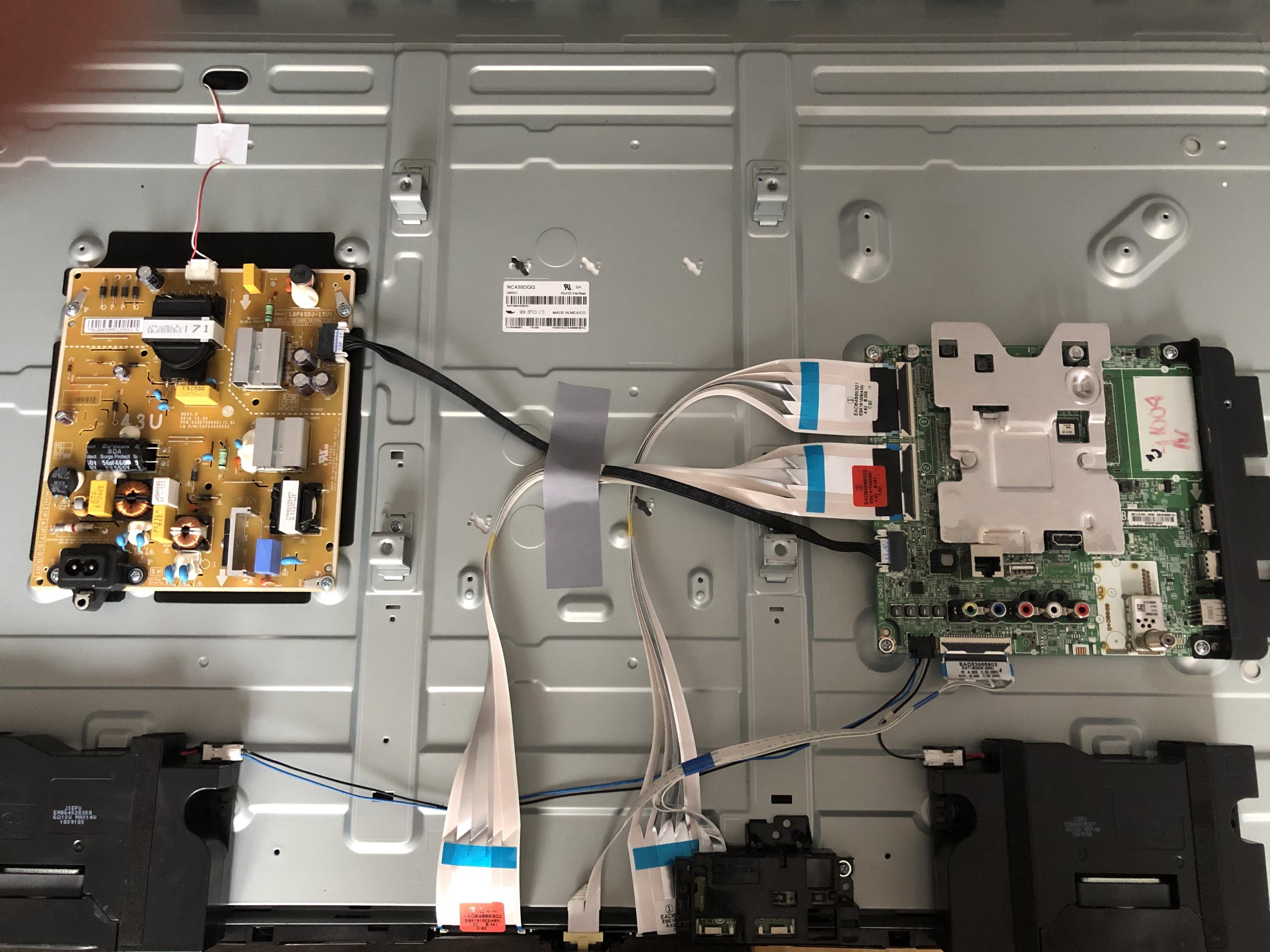

        Re: LG 43UK6090 no image
        Please attach the pictures of the whole backside of the TV showing all the boards and the screen shot of the panel when TV is turned on so we can see what we are dealing with.
          I removed the panel, no cracks at all.
          See attached pictures, one of them shows lines when TV is turning on. After that it goes steady grey.
          Image is always grey no matter what cable to panel is connected.
          But power supply shuts down only if the right side (looking from the front) is connected.

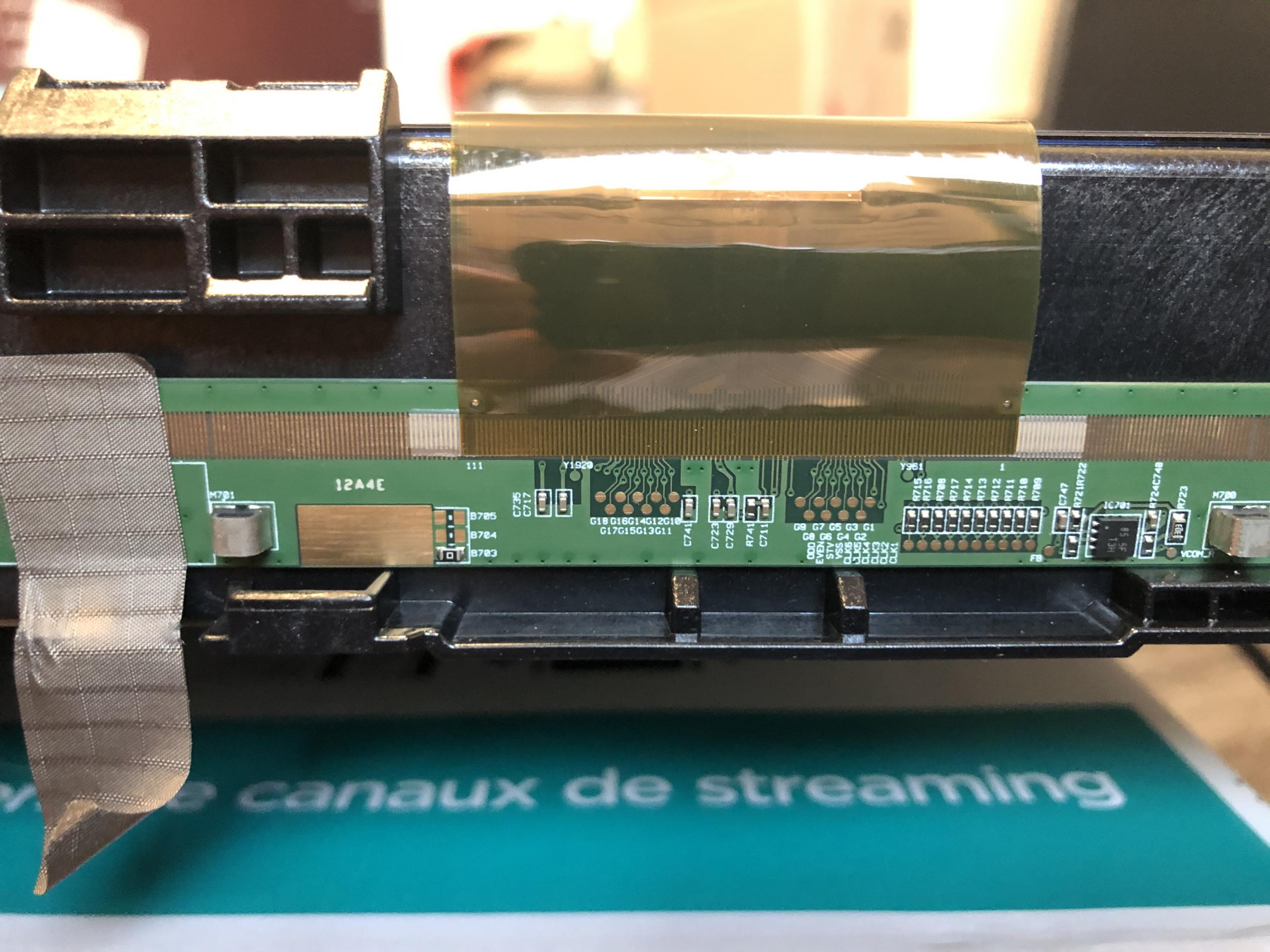

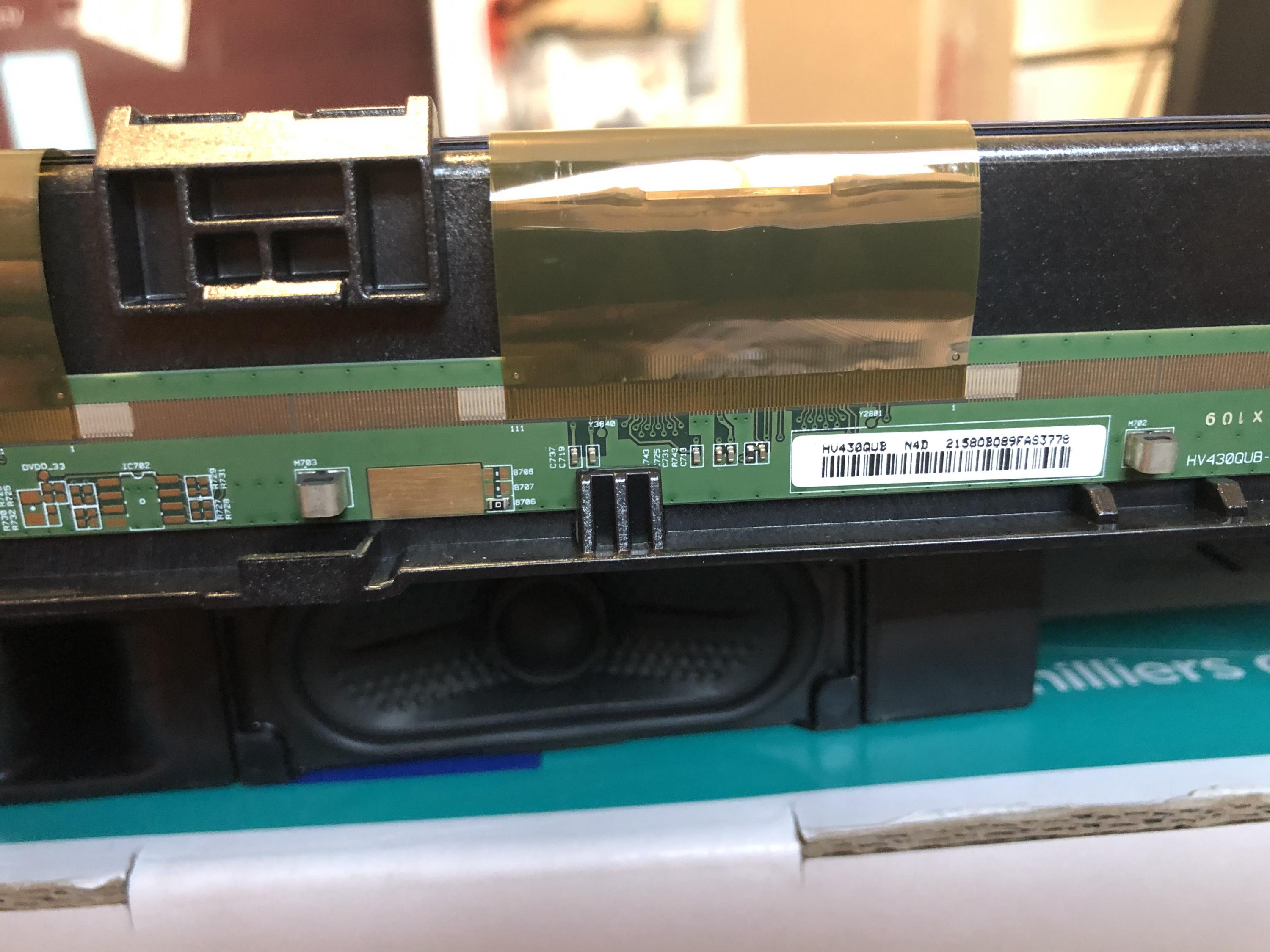

            Can you post photos of the long thin circuit board connected to the lcd panel.
              Here is long board, 6 COFs total
              • alfatv
                • Sep 2020
                • 353
                Just got image out of it with tape method.
                Had to cover about 20 pins or so on the left side of connector.
                Tried to cover less pins, but it either stops working or starts flickering or there are line patterns on the right side.
                Experts, what's going on and what to do next?
