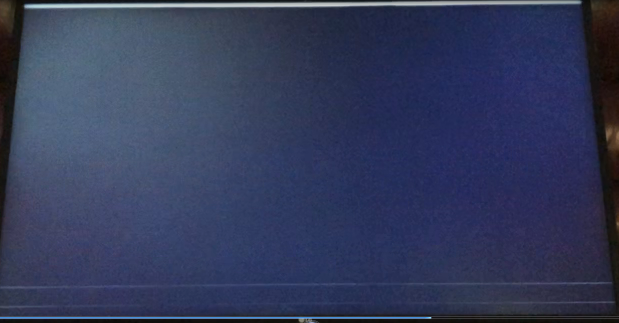

          Re: LG 43UK6090 no image
          I removed the panel, no cracks at all.
          See attached pictures, one of them shows lines when TV is turning on. After that it goes steady grey.
          Image is always grey no matter what cable to panel is connected.
          But power supply shuts down only if the right side (looking from the front) is connected.

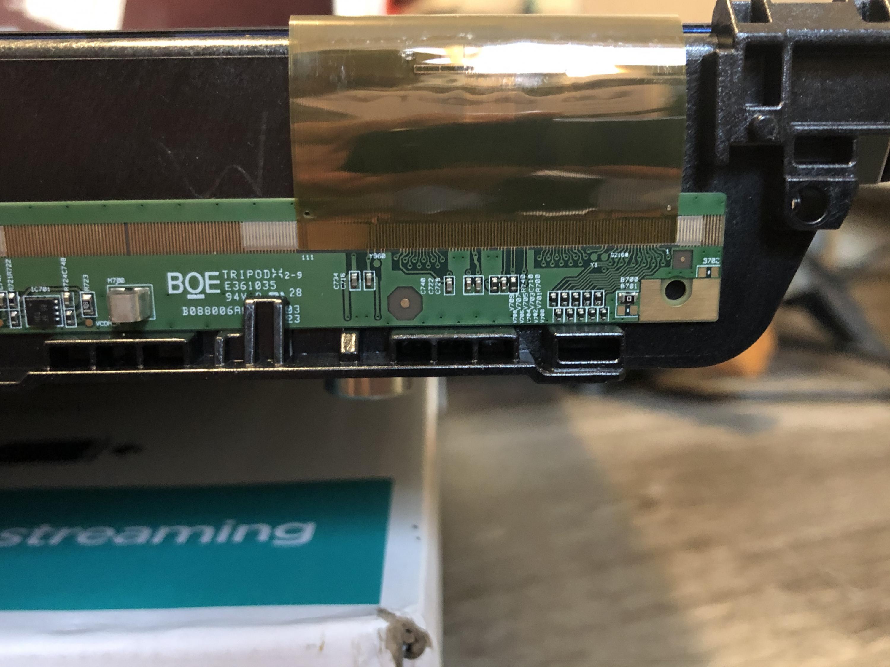

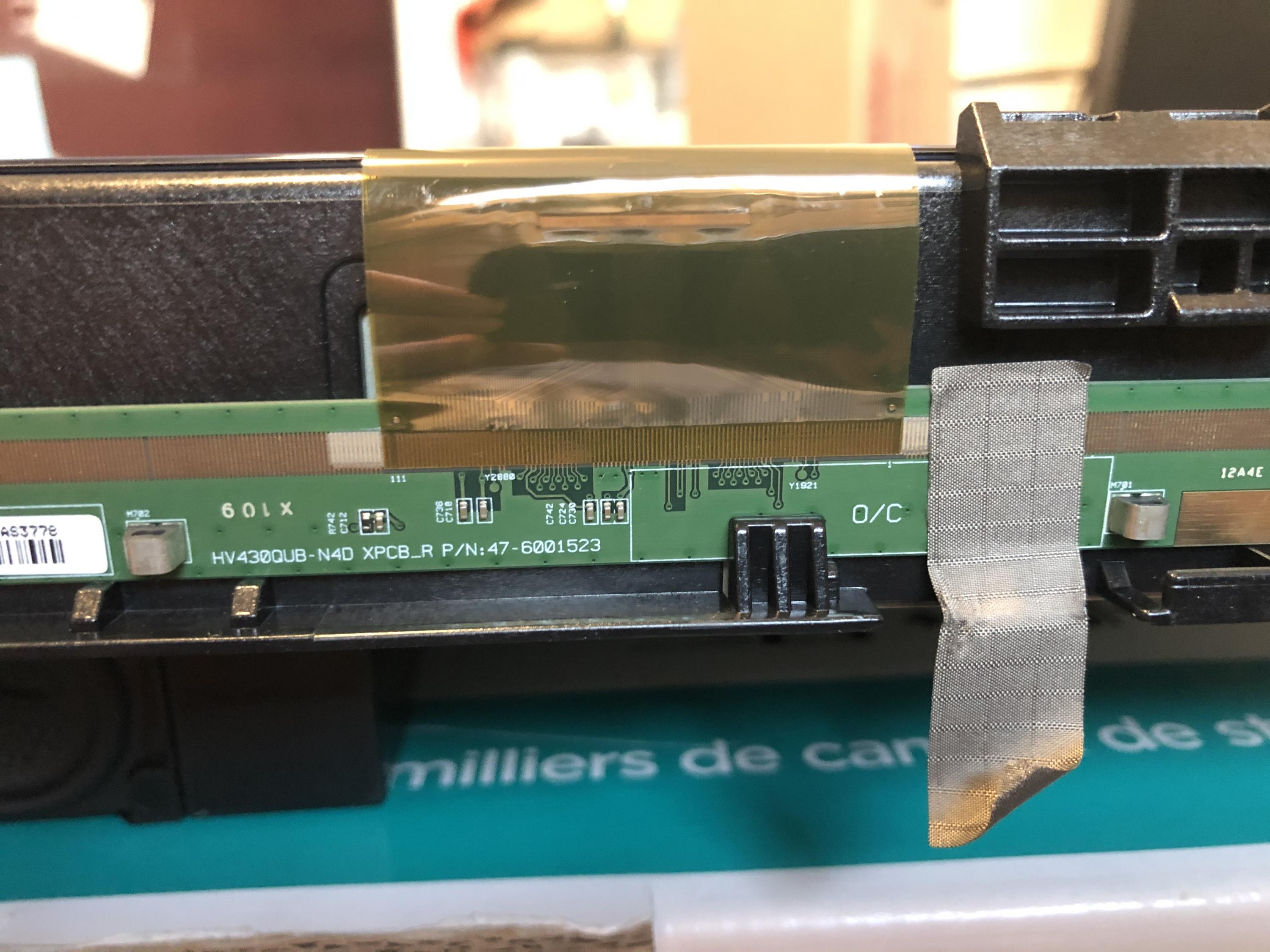

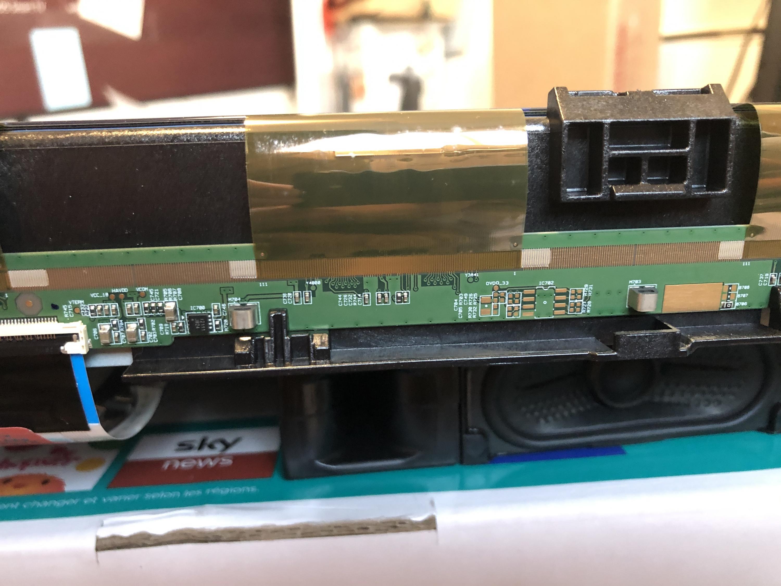

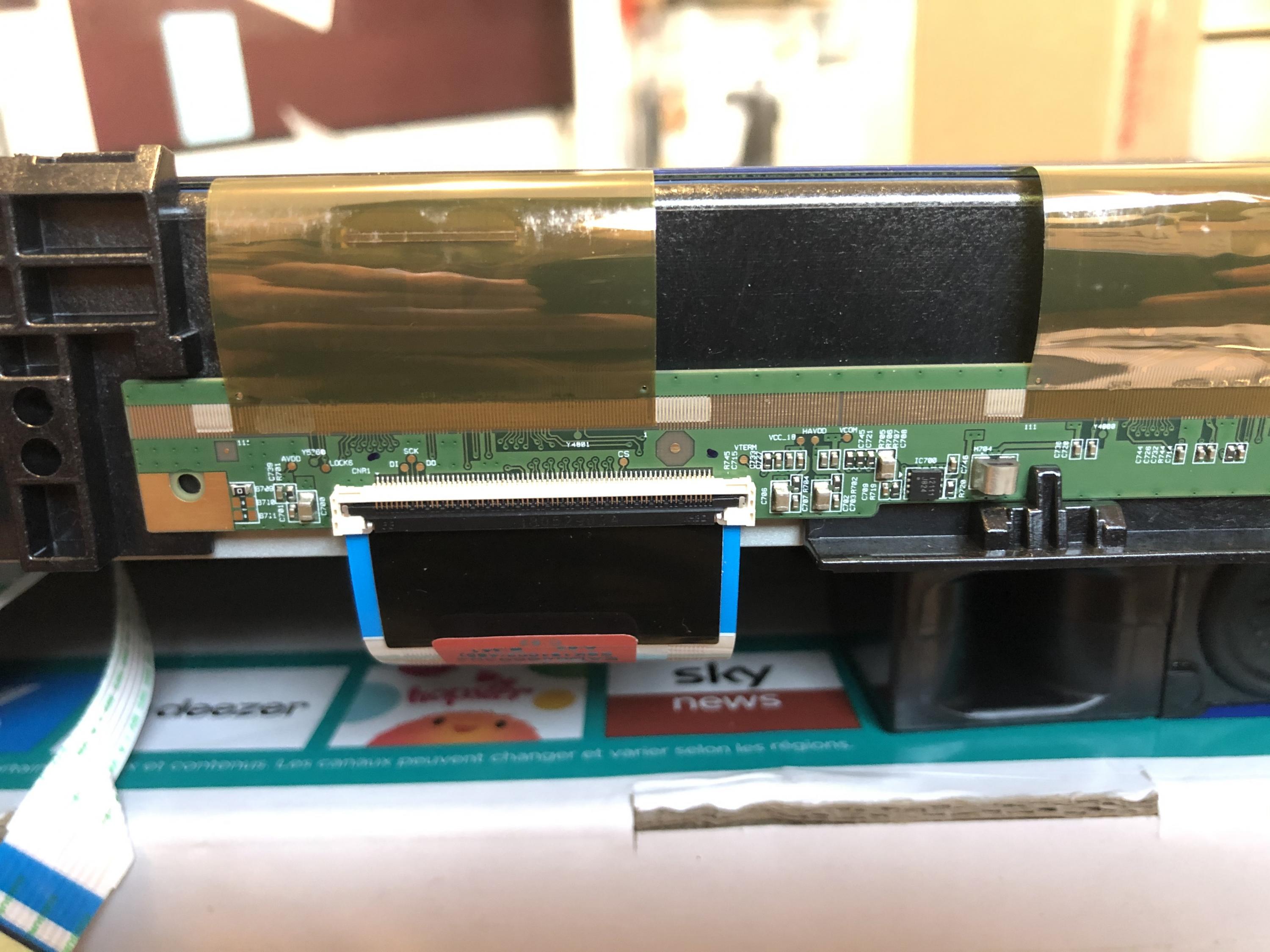

            Can you post photos of the long thin circuit board connected to the lcd panel.
            • alfatv
              • Sep 2020
              • 353
              Here is long board, 6 COFs total
              • alfatv
                • Sep 2020
                • 353
                Just got image out of it with tape method.
                Had to cover about 20 pins or so on the left side of connector.
                Tried to cover less pins, but it either stops working or starts flickering or there are line patterns on the right side.
                Experts, what's going on and what to do next?
