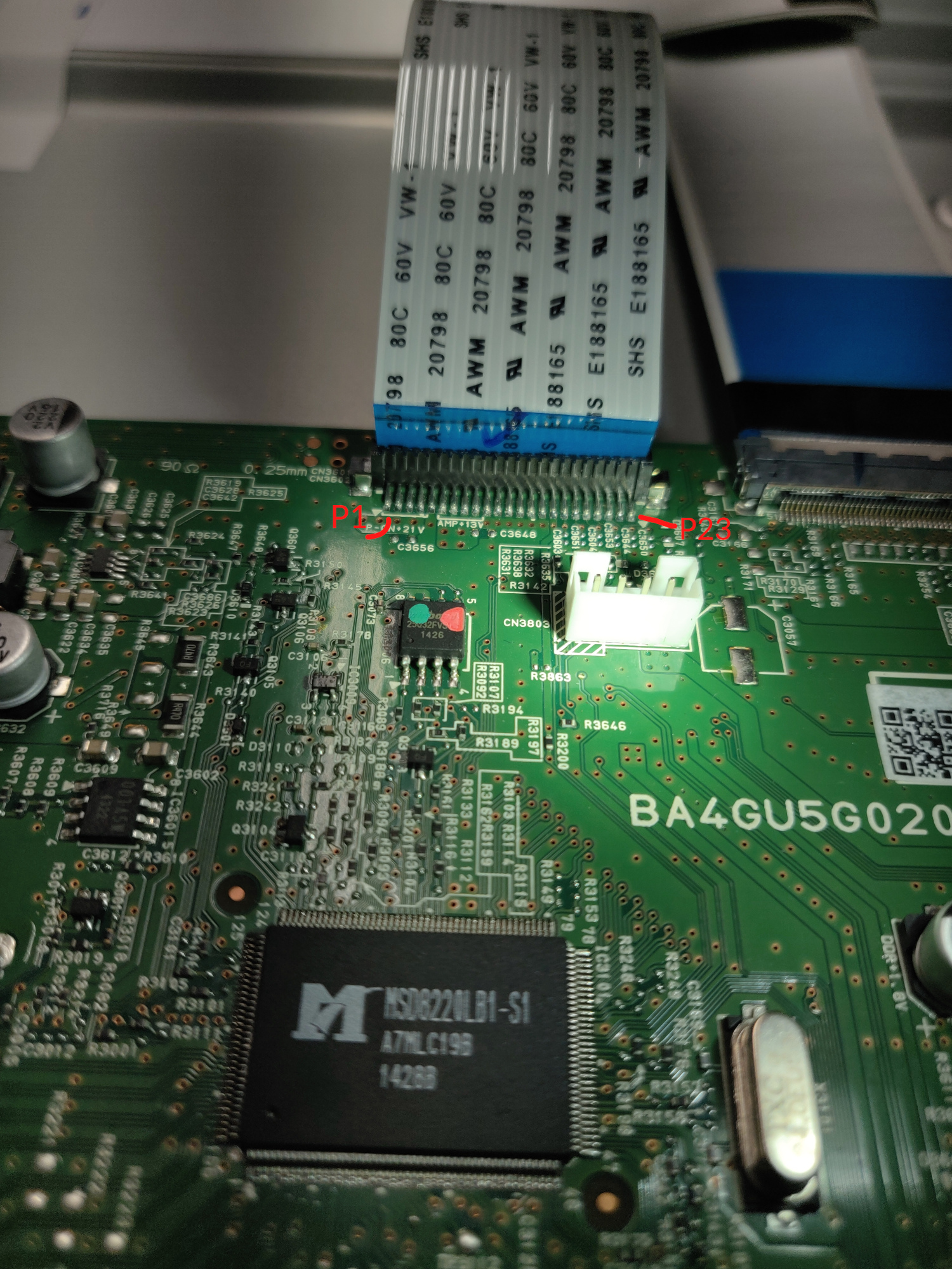

    Test the voltages at the connector on the powerboard with EVERYTHING hooked up, it's the connector that the cable from powerboard to mainboard hooks into, most times there's a legend/map nearby that gives the expected voltages, you measure them with your mutimeter, set meter to 20 vdc then report them, put neg probe on chassis metal ground, pos probe on pin of connector, measure in standby take note, leave probes where they are then power on tv and again take note of voltages, report them here, example pin 1-ps-on-0 volts standby-power on-3.3 volts.

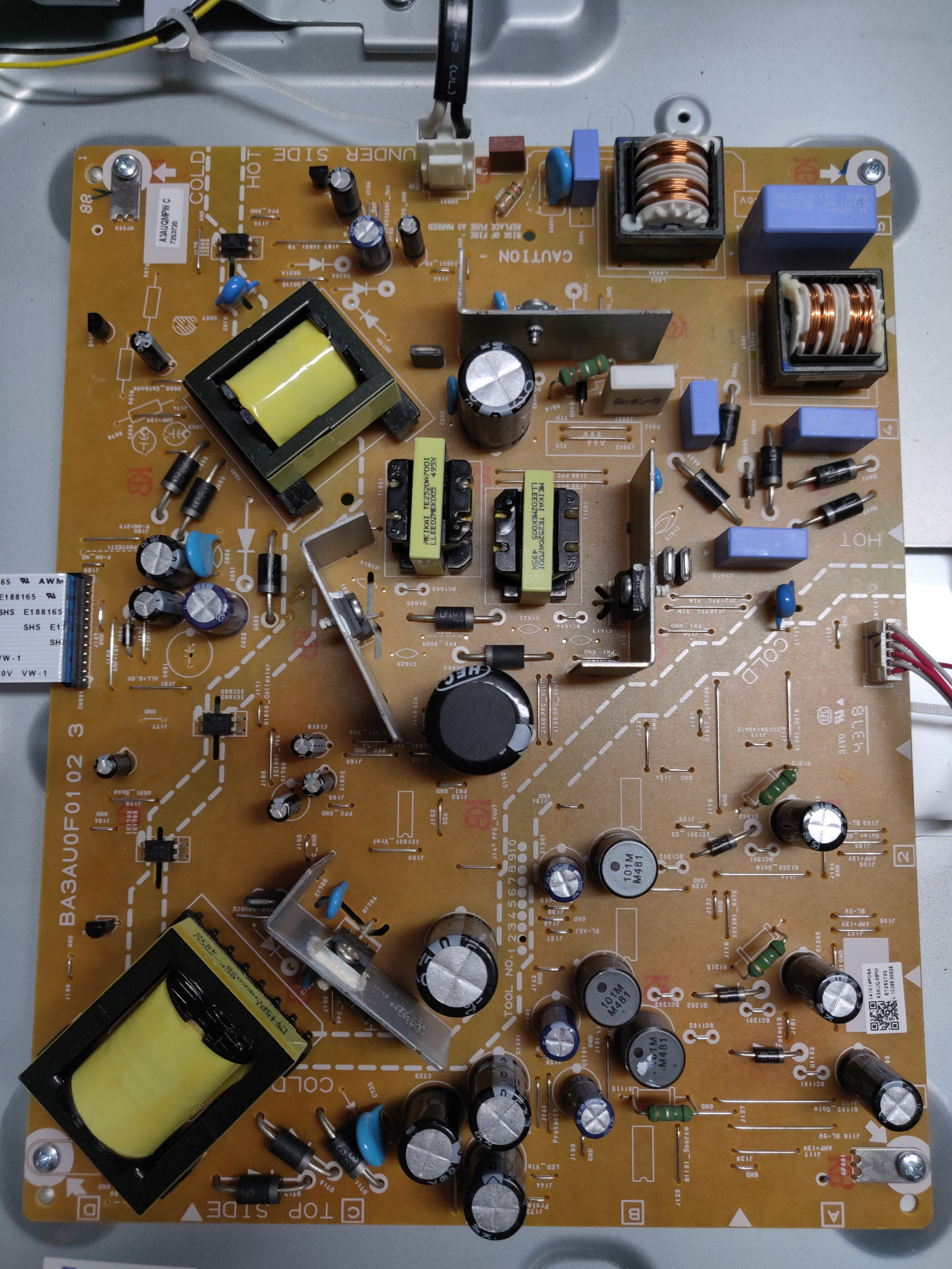

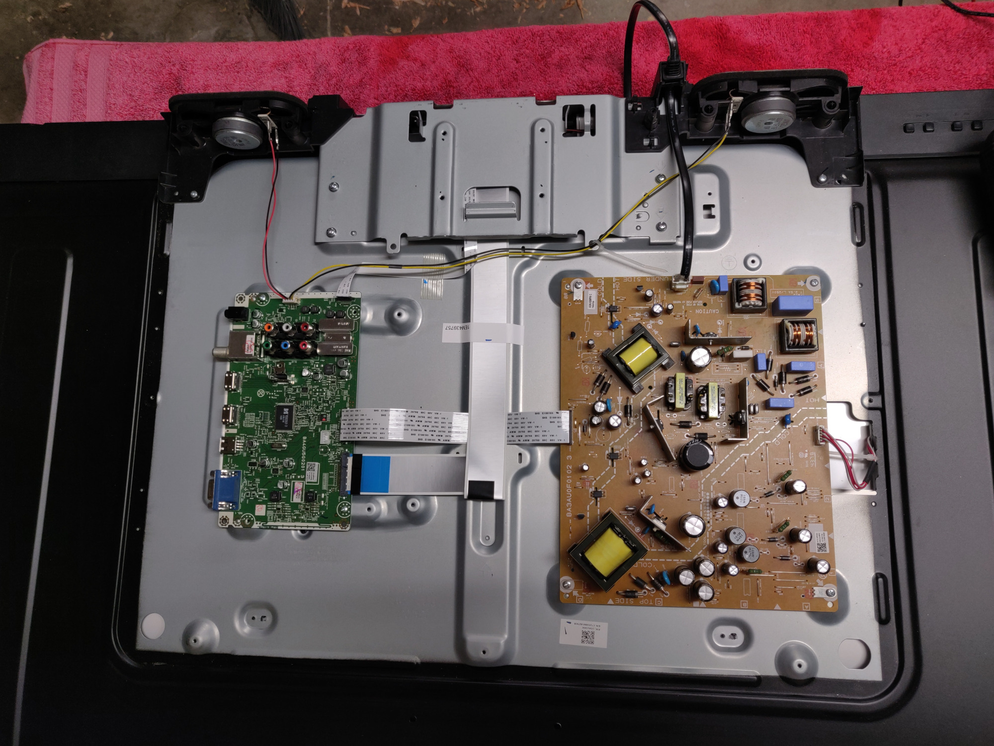

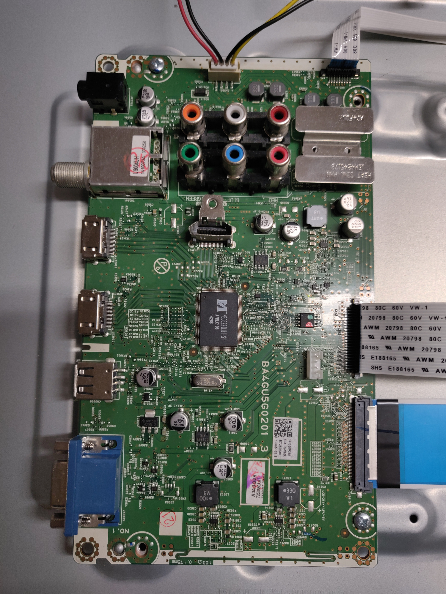

      Can you post some focused straight on pictures of each board and one of the whole back, as to see how everything is connected?

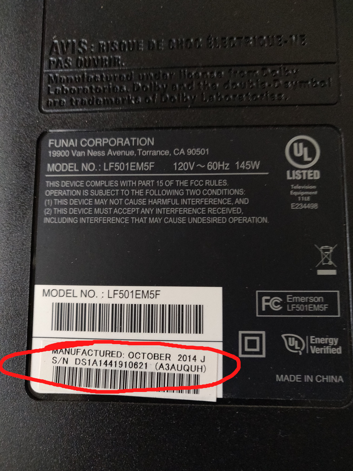

          Is your version DS1? can tell by looking on back cover, should be close to the model number.

            Re: TV Powers on, then Off - Emerson LF501EM5F
            See photos, according to serial number prefix, it may be a DS1.
            Here are the readings I've got, sorry if the layout is poor:
            Stand By Readings
            P1: 14.31V
            P2: 14.31V
            P3: 14.31V
            P4: 14.31V
            P5: 7.93V
            P6: 7.93V
            P7: 7.93V
            P8: 7.93V
            P9: 0mV
            P10: 0mV
            P11: 0mV
            P12: 0mV
            P13: 0mV
            P14: 3.315V
            P15: 0mV
            P16: 0mV
            P17: 3.315V
            P18: 0mV
            P19: 0mV
            P20: 0mV
            P21: 3.315V
            P22: 0mV
            P23: 0mV
            Power-On Readings
            P1: 22.68V
            P2: 22.68V
            P3: 22.68V
            P4: 22.68V
            P5: 13.02V
            P6: 13.02V
            P7: 13.02V
            P8: 13.02V
            P9: 0mV
            P10: 0mV
            P11: 0mV
            P12: 0mV
            P13: 0mV
            P14: 0mV
            P15: 3.314V
            P16: 3.05V
            P17: 3.3V
            P18: 3.0V
            P19: 3.10V
            P20: 3.2V
            P21: 3.314V
            P22: 424.8mV
            P23: 0mV

                It's harder when the pins are not labeled, this board doesn't seem to have a label/legend, try heating with a hairdryer or cooling with freeze-spray or inverted can of air IC3006 on mainboard not powerboard, then plug tv in and see if it starts up or acts any differently.
