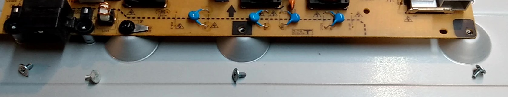

    LG 60" 3d TV LG60LA6200UA Screws and LED Beads
    What size and head type are these circuit board screws?
    On the LED Strip is :
    SH S1 94V-0 N 1329. LG Innotek POLA2.0 60 Rev 0.1 L Type 2012.10.18
    I want to know what LED Beads to use for replacement and where can I read and learn what size and voltage is correct without relying on an ebay seller
    and where to buy them?
    What is POLA2.0, L Type?

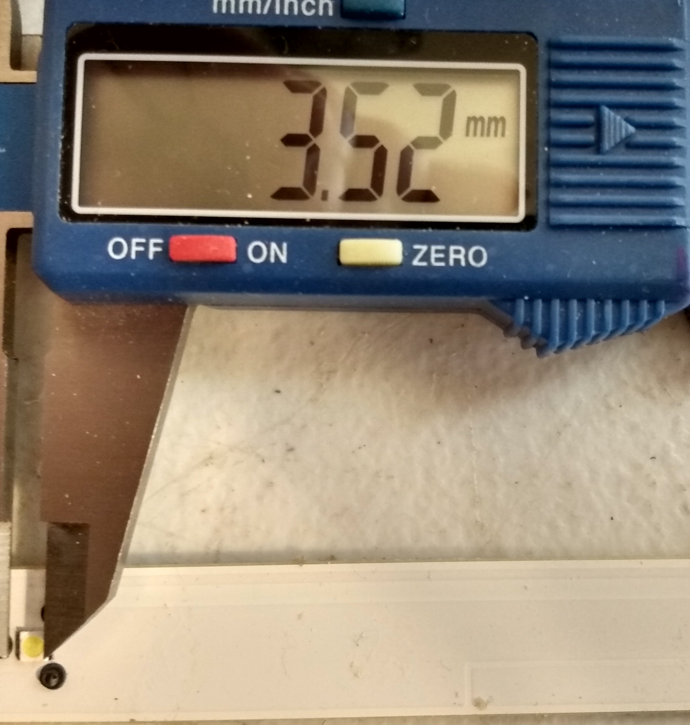

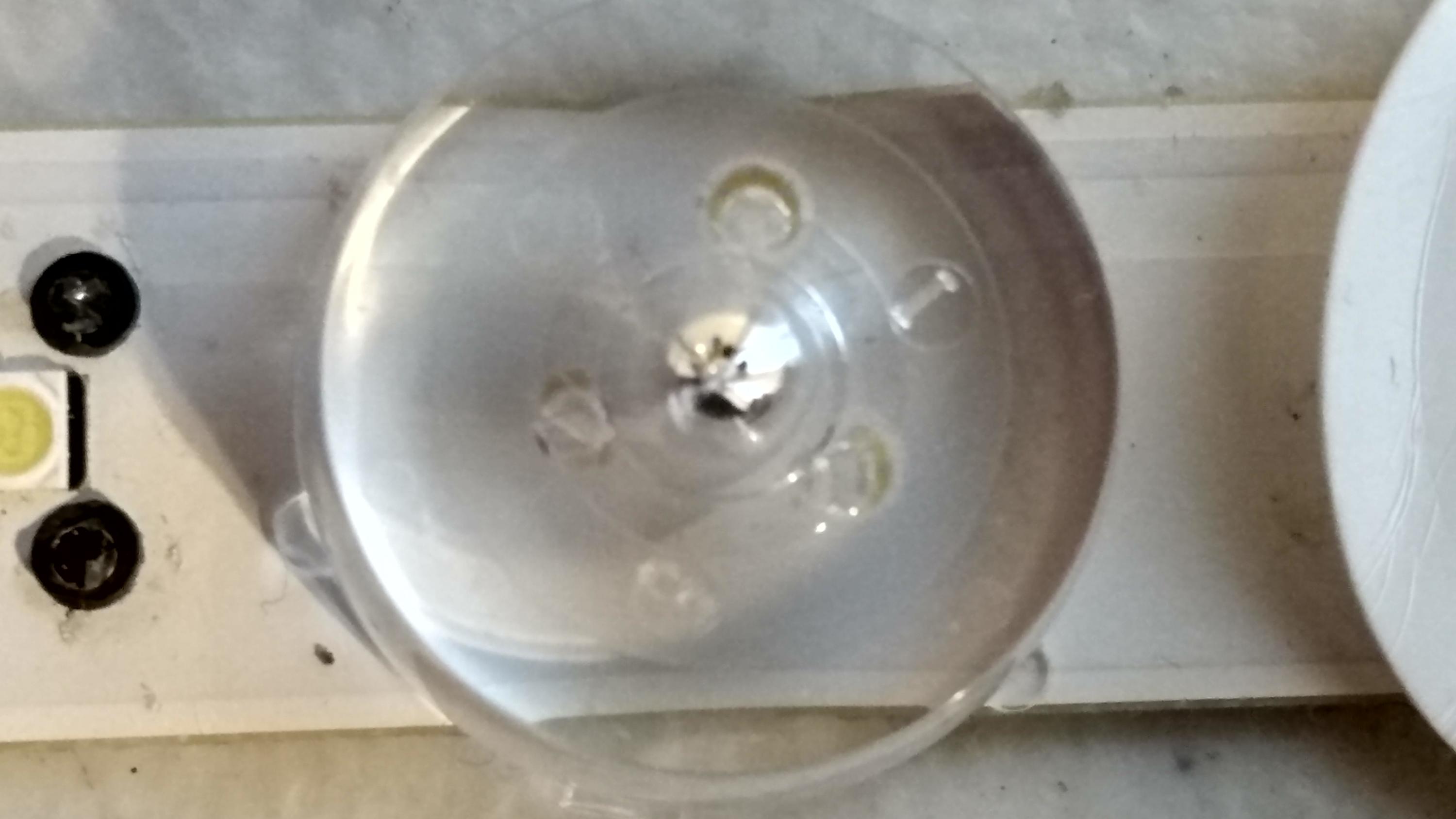

    Most of the clear plastic (I'll call Filter Beads) glued over the LED Beads have fallen off leaving three black dots with clear plastic in them where they broke off. Do New Filter Beads have three feet dots that glue to the black dots or are the black dots part of the clear plastic filter bead? I would think "Distance from the LED Bead matters.

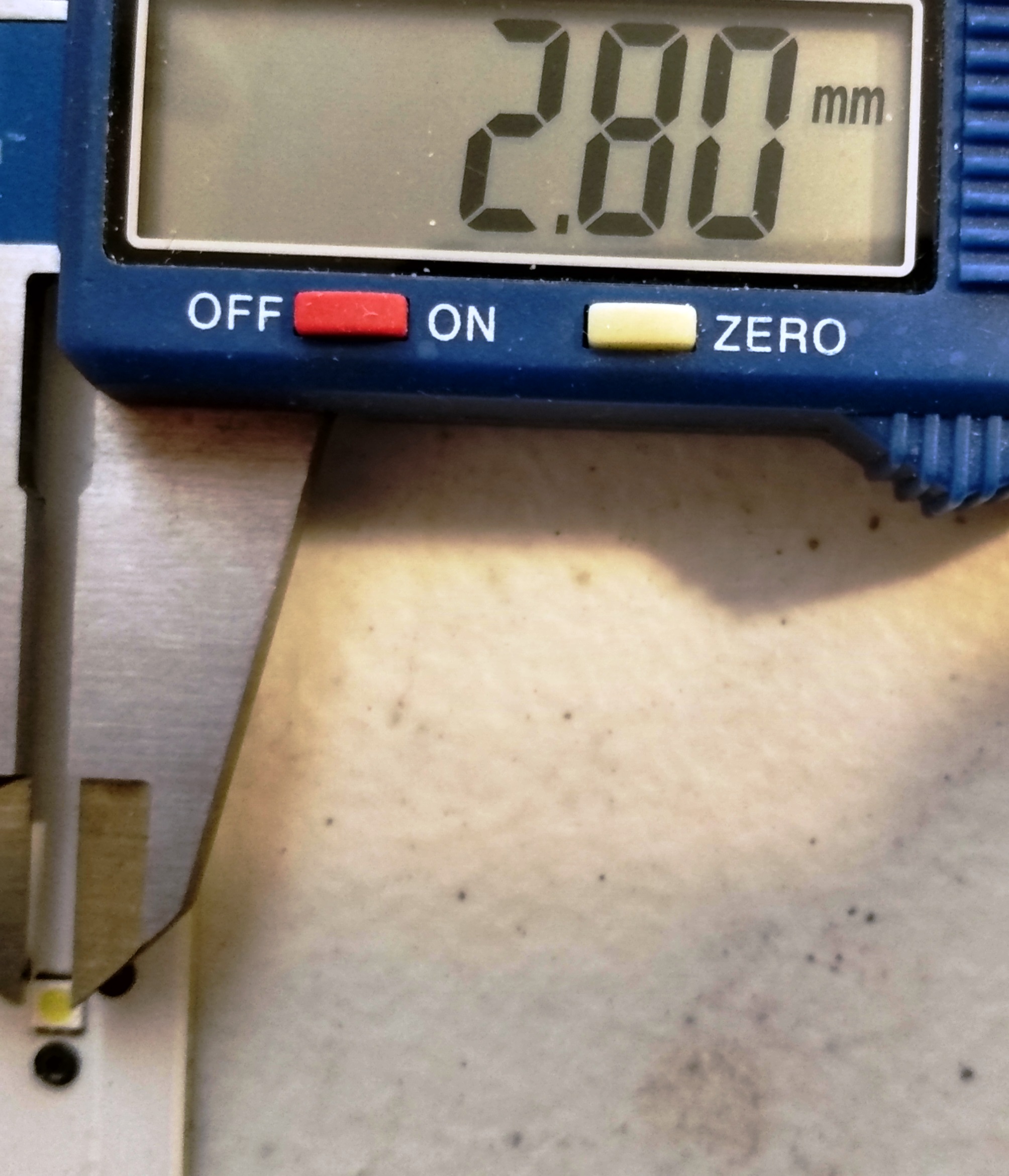

    I measured with my digital caliper I get about 2.8mm X 3.5mm
    I set my meter to diode and get .765 and .764, with leads reversed I get a dimly lit LED.

      I was planning on rebuilding the old strips sometime in the future but looking at the lens and the black dots where they were glued on
      would be impossible unless the black dots are removed and new lens installed.

            I searched "pola2.0 60" on ebay and got lots of matches. I also searched "2835 1W 3V LED" and got lots of matches as well.

                          yours Innotech 3825 Forward Current:400mA Forward Voltage:3.05-3.65V
