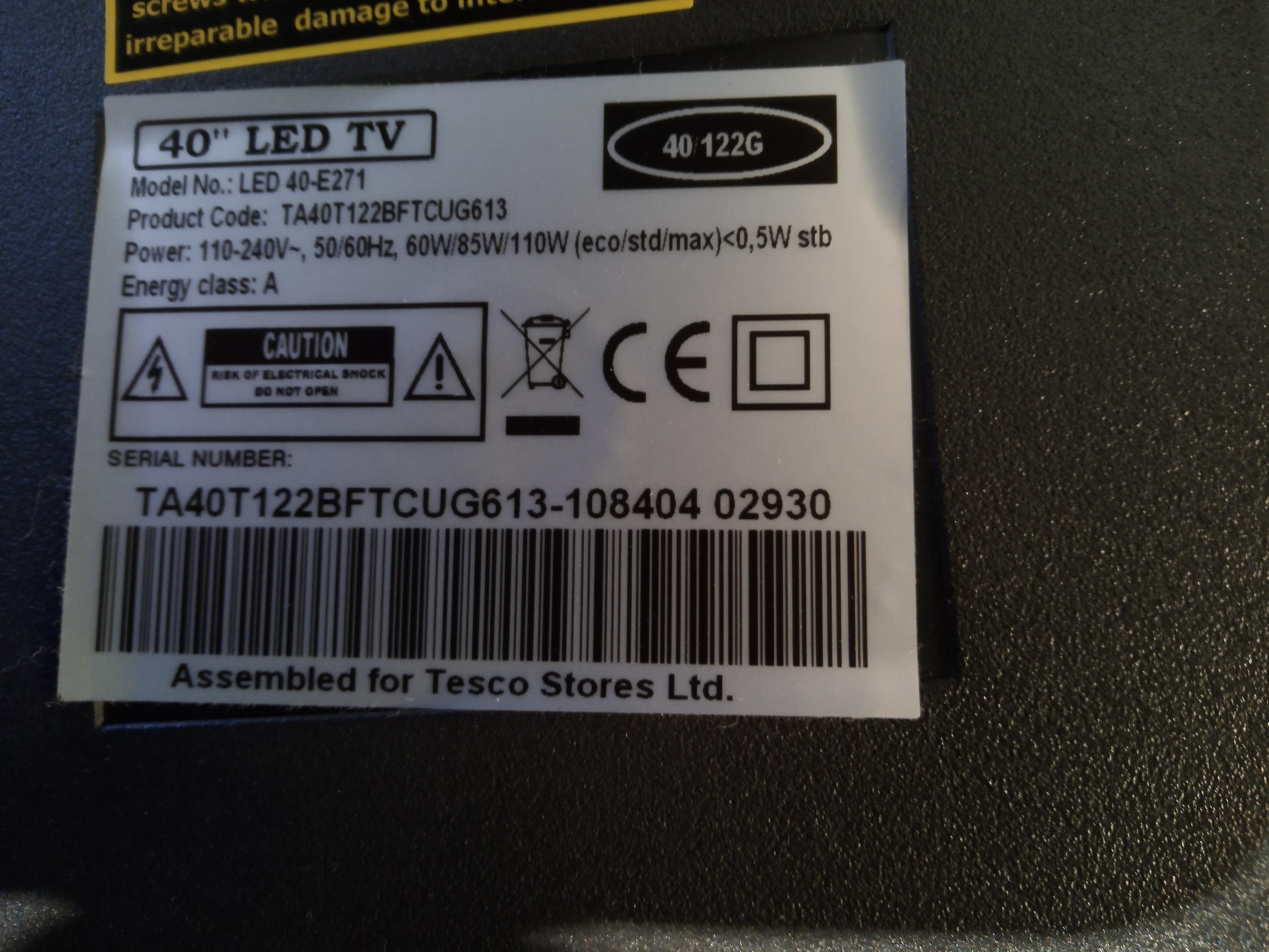

                    Send me a picture of your rear label of your TV and I will get you the firmware file for you. Out of interest what's your screen model number?
                    • jimbofz
                      • Apr 2013
                      • 539
                      • uk
                      Re: technica led 40 e271 not storing channels
                      heres the pics thanks
                        I should be able to get it for you on monday.

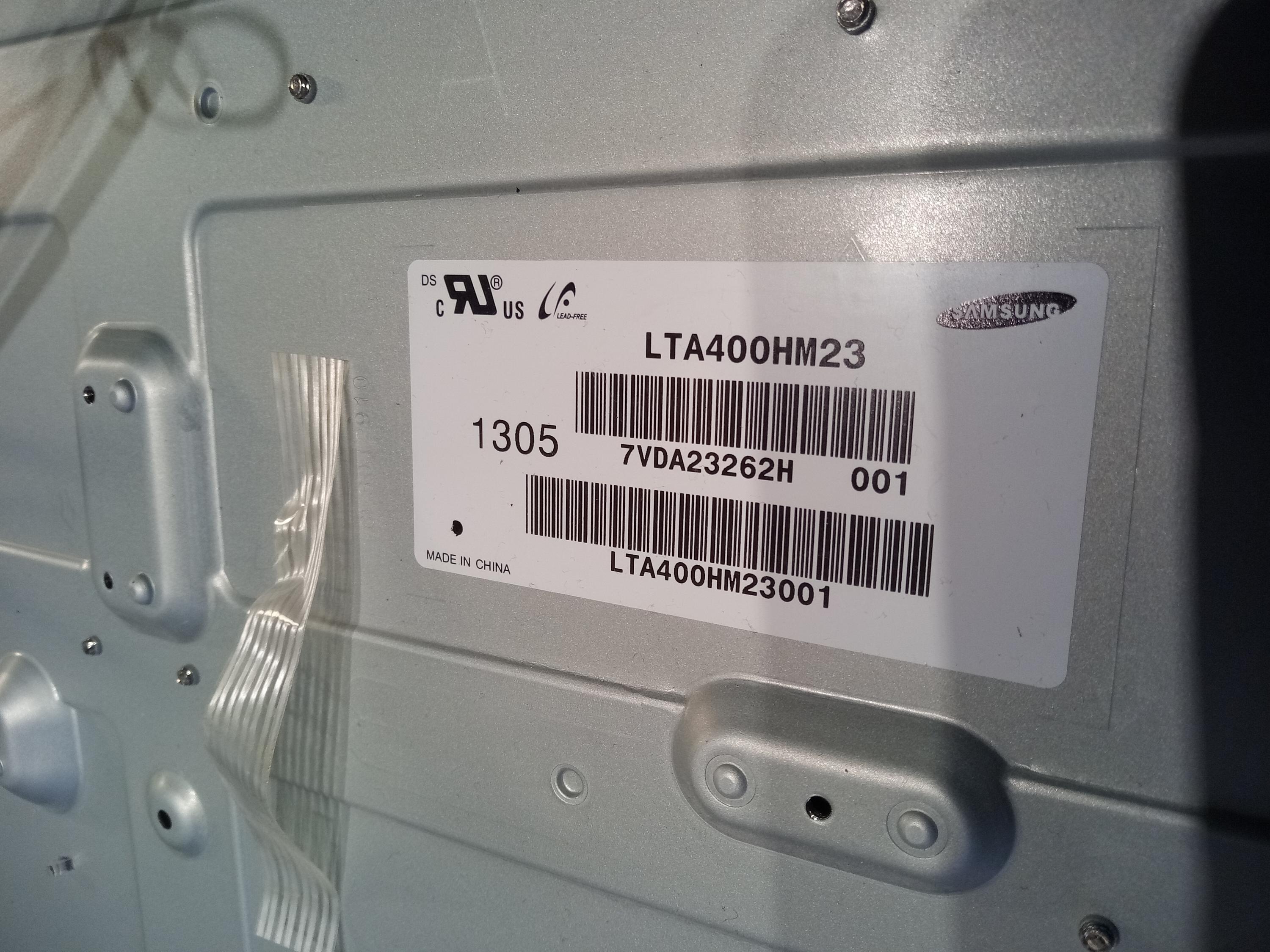

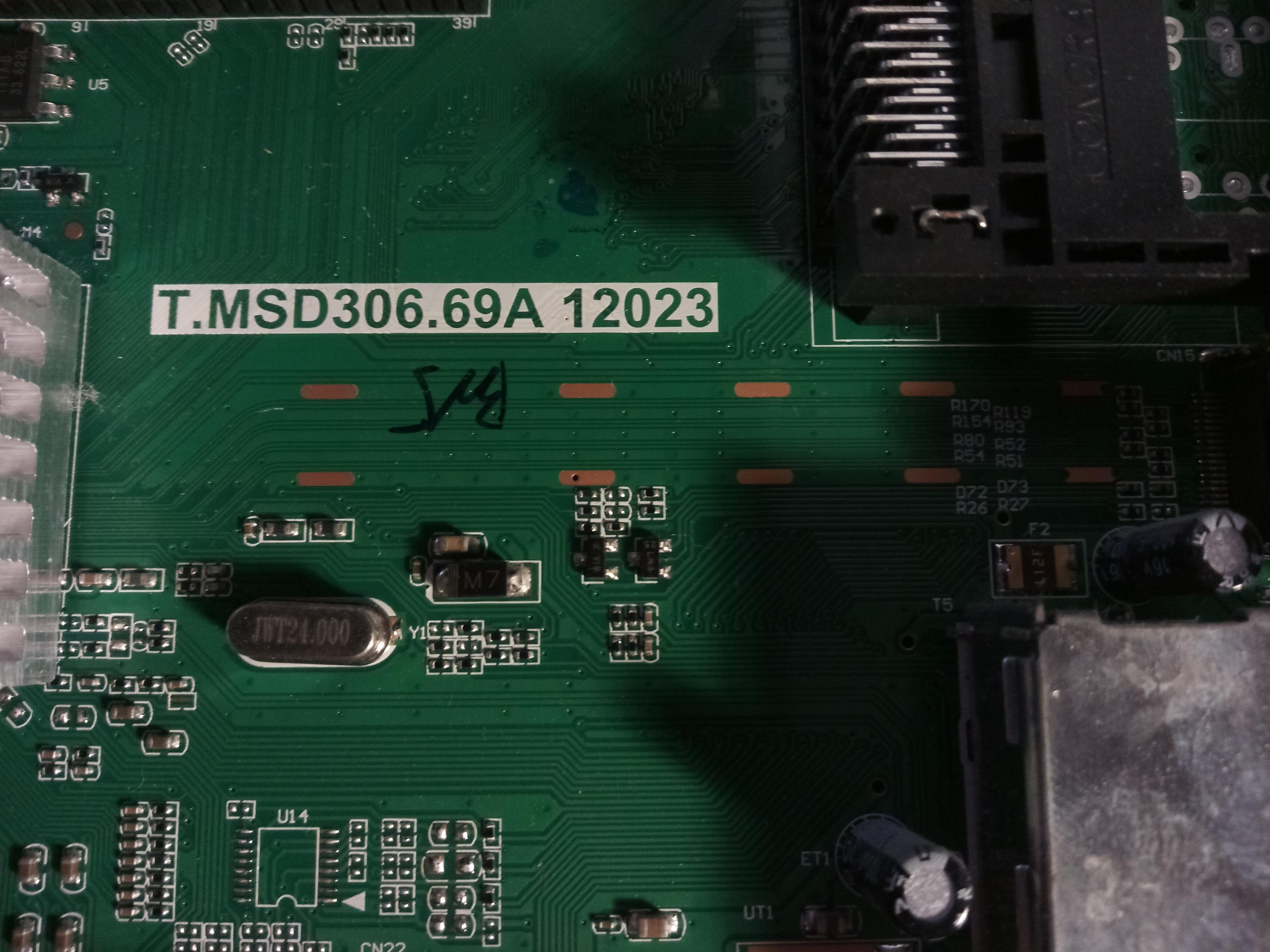

                                If possible could you post Model Number, Panel Number, Mainboard Number and Tcon along with the bin file on th EEPROM thread.
                                It would be helpful for others who have the same problem.
                                • jimbofz
                                  • Apr 2013
                                  • 539
                                  • uk
                                  hope this can help someone ,with same problem:
                                  technika led40 e271
                                  panel num:lta400 hm 23001
                                  main board :tmsd 306 69a 12023
                                  theres 2 bin files extract to clean usb ,insert and apply mains wait 20 mins to complete ,it took me 3 attempts before it would accept the f/w
