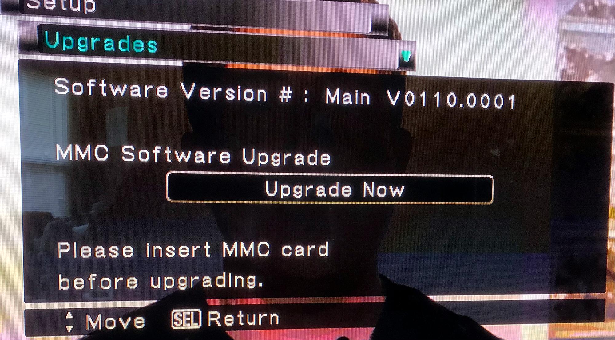

                So, you are using a 7-pin MMC that is formatted FAT, not a 9-pin SD using FAT32?
                And you had the file DW1UC105.E06 as the only file on it?
                Interesting because I get no indication whatsoever that it is recognizing my KingMax 256mb MMC card -- file or no file.
                My firmware version is V0110.0001. What is yours?
                I'm attaching a picture of my setup screen.

                  Re: Hitachi 42HDT52 Plasma TV - HDMI initially has no sound on Power-up
                  My set is the 55HDT52 and it's main firmware is V0101.0001 It was the latest from Hitachi a couple years ago for this model. I used a 9 pin SD card, I can't remember if that is what I used to upgrade it in the past or I used a borrowed mmc card.
                  It should recognize if a card is inserted, my SD card had the label out (pins toward front of tv)
                  If you have a MMC card it should come up with something when it is inserted and told to upgrade.

                    Thanks. I've tried 9-pin SD card and the older 7-pin MMC card. The card is inserted with the notch down (only way it will latch in and the way the update instructions show). I've not seen any indication that the card is being detected.
                    What is the make/type and size of your card that's being detected?
                      They are Ultra Secure data Card 128 meg
