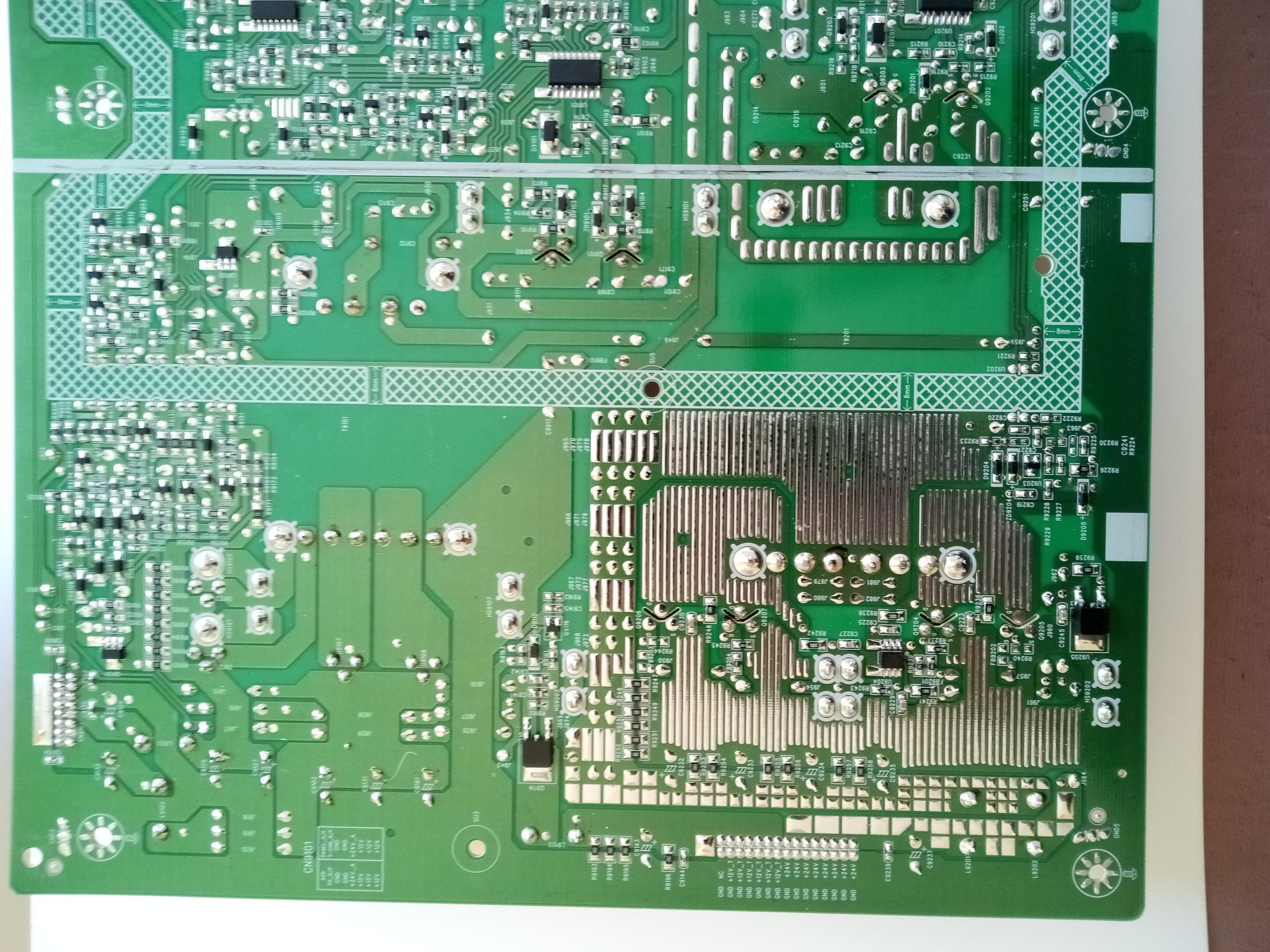

                    can you show focused high resolution photo on both side of the PSU. and remark on the photo the 24v_a pin
                    also did you checked after crack at the soldering !!
                    EDIT: i am afraid if the printing label wrong LOL but the 24V are very common range to supply audio section too .. other wise i will do this test.....>
                    you can try after you are sure its should be 24V. to put every things in place as original. and just slide the 2 wire of +24V_A from PSU socket. and test them with DM if they are both connected at mainboards so you can feed only one from the 24V of the panel 24V PIN and then turn on.. LOL
                    so the set should turn on with complete picture .... or it could jumping high to the moon... LOL so funny issue.

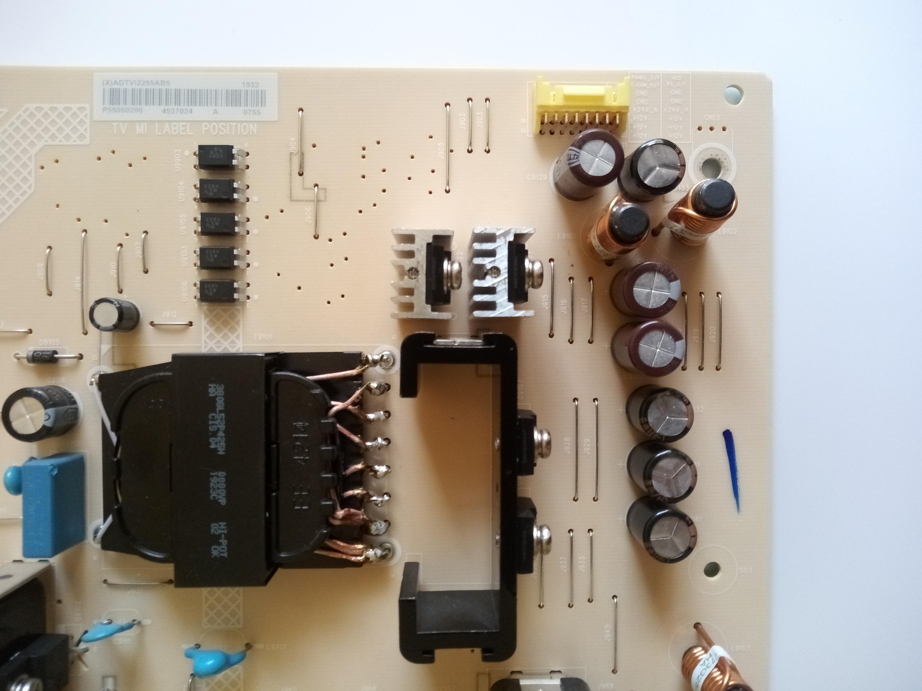

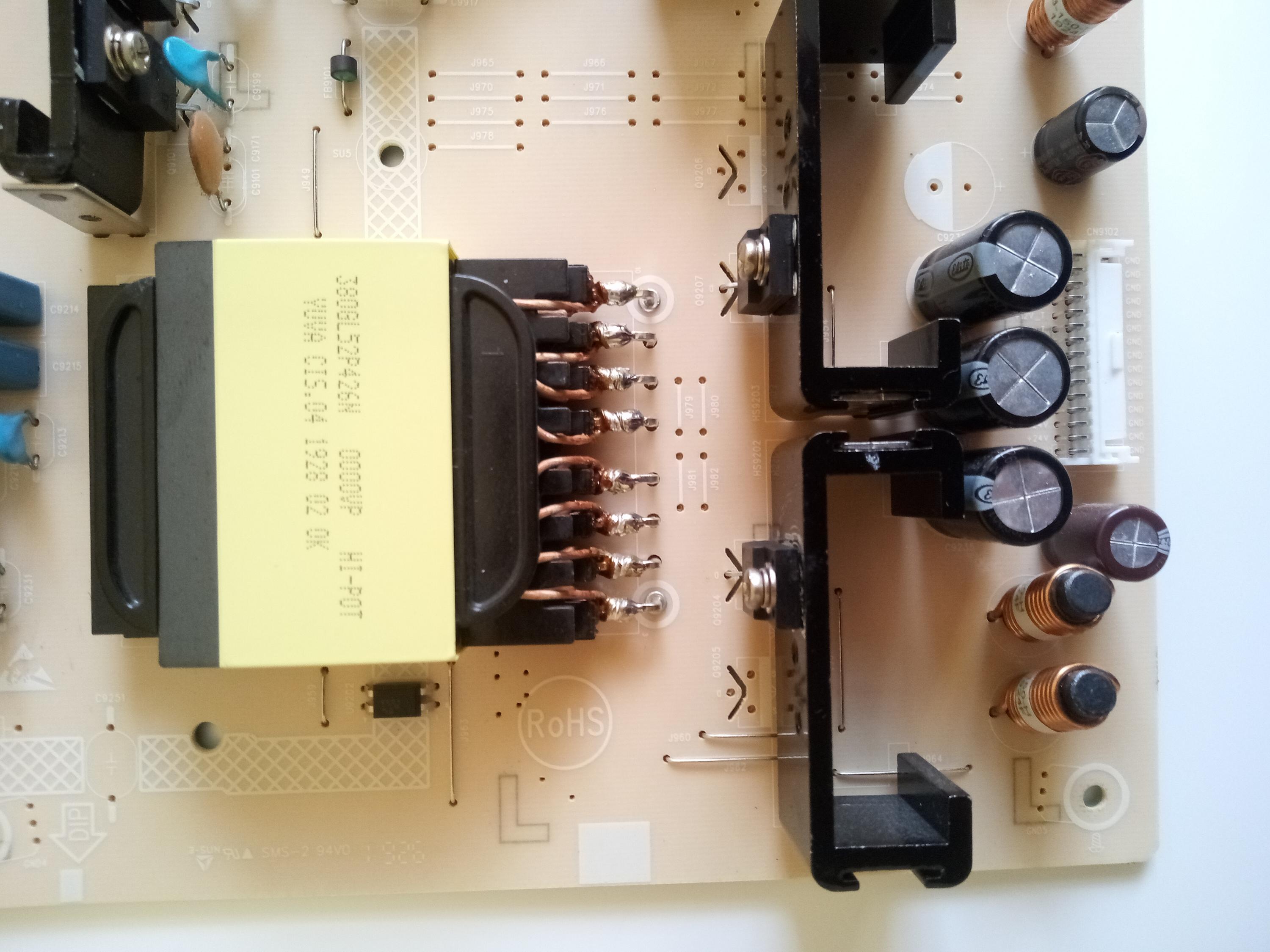

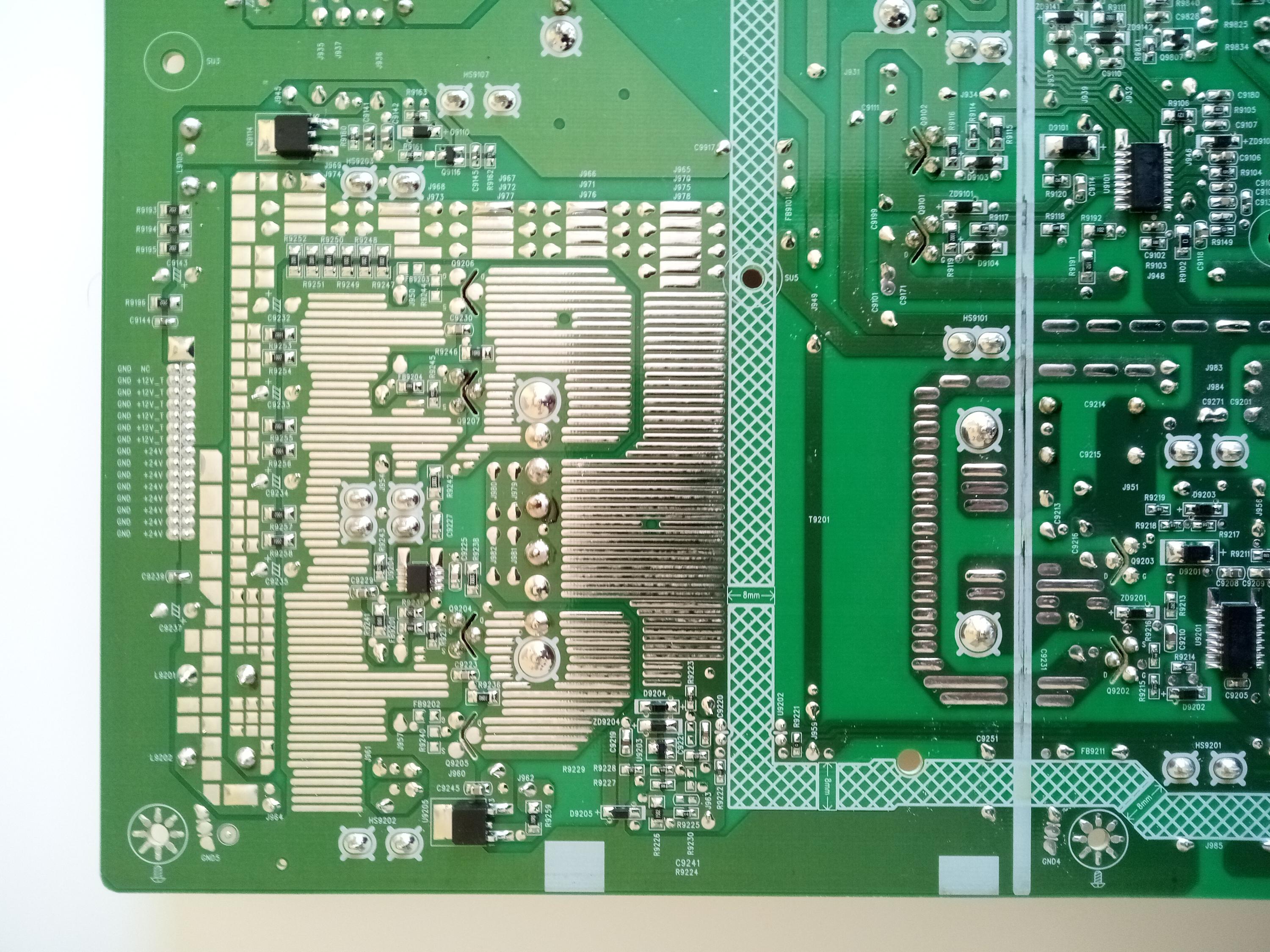

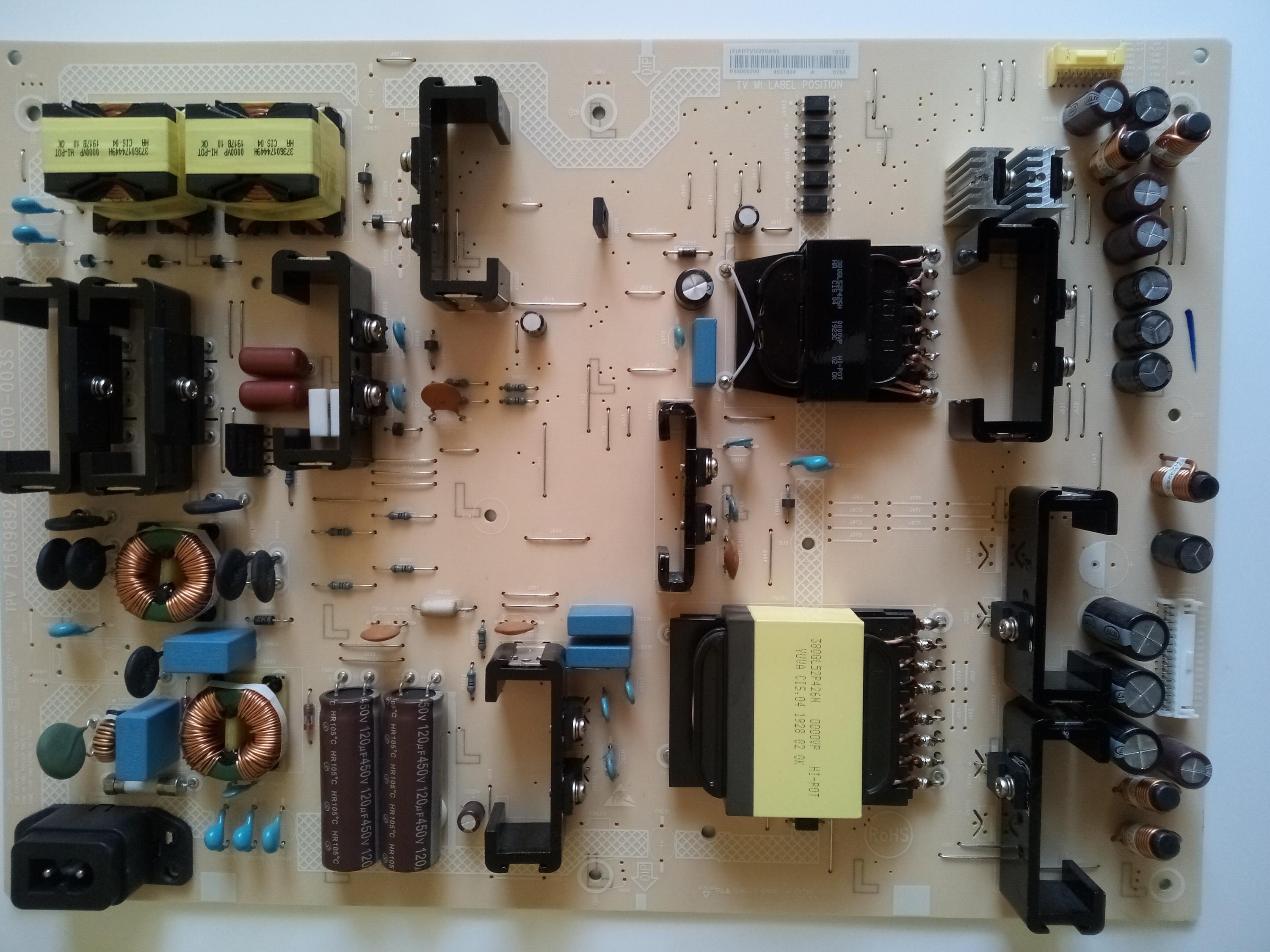

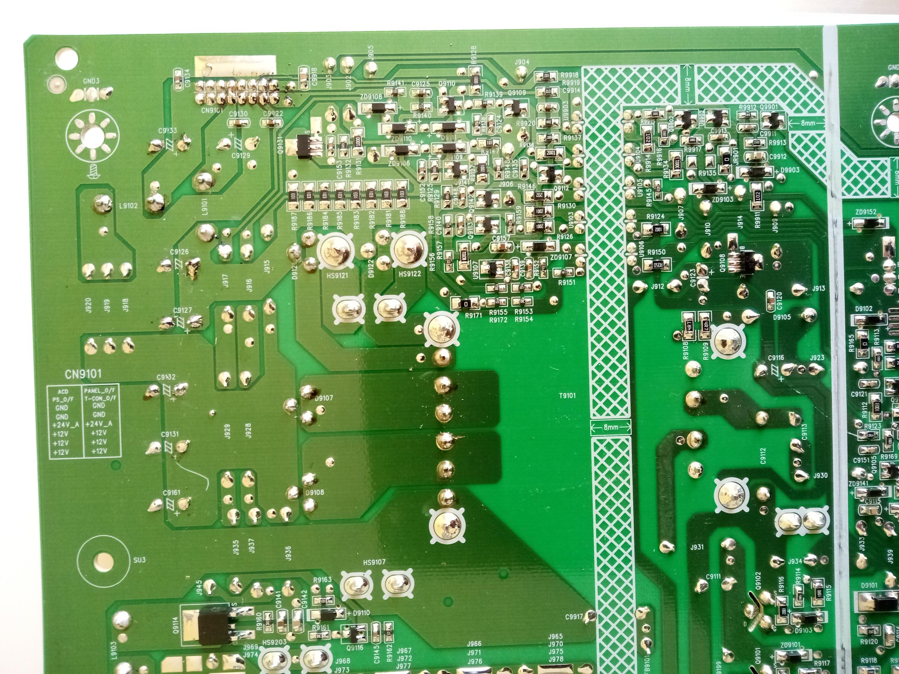

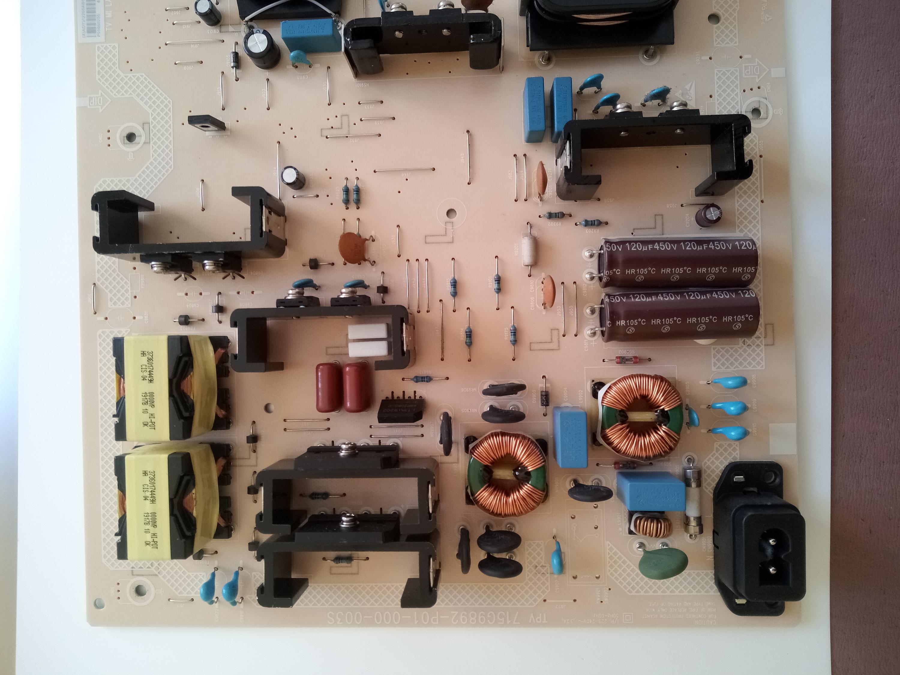

                      #30
                      Re: philips 55 oled 745 /12 3 blinks
                      heres some pics of psu
                      i have soldered any joints that might have looked bad with magnifier
                      although the board still looks like new
                      with regards to the +24v_pins , they are joined together

                        #31
                        one things more.. you wrote at your picture 24V_A read 12V at STB... so it mean it booted high to 24V after PSU turn on... same way to some of Philips PSU which they read 12V STB then goes high to 18V after turn on.. !!!! mysterious

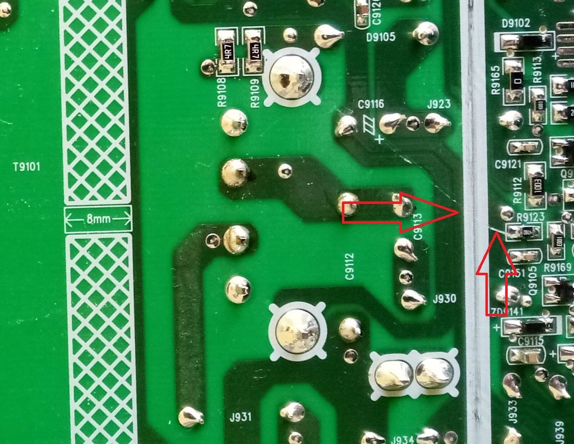

                              clean this section in the photo ... ist from you or some one play on PSU before you ?

                                  ok will do the mark on board is a minor scratch nothing to worry about .
