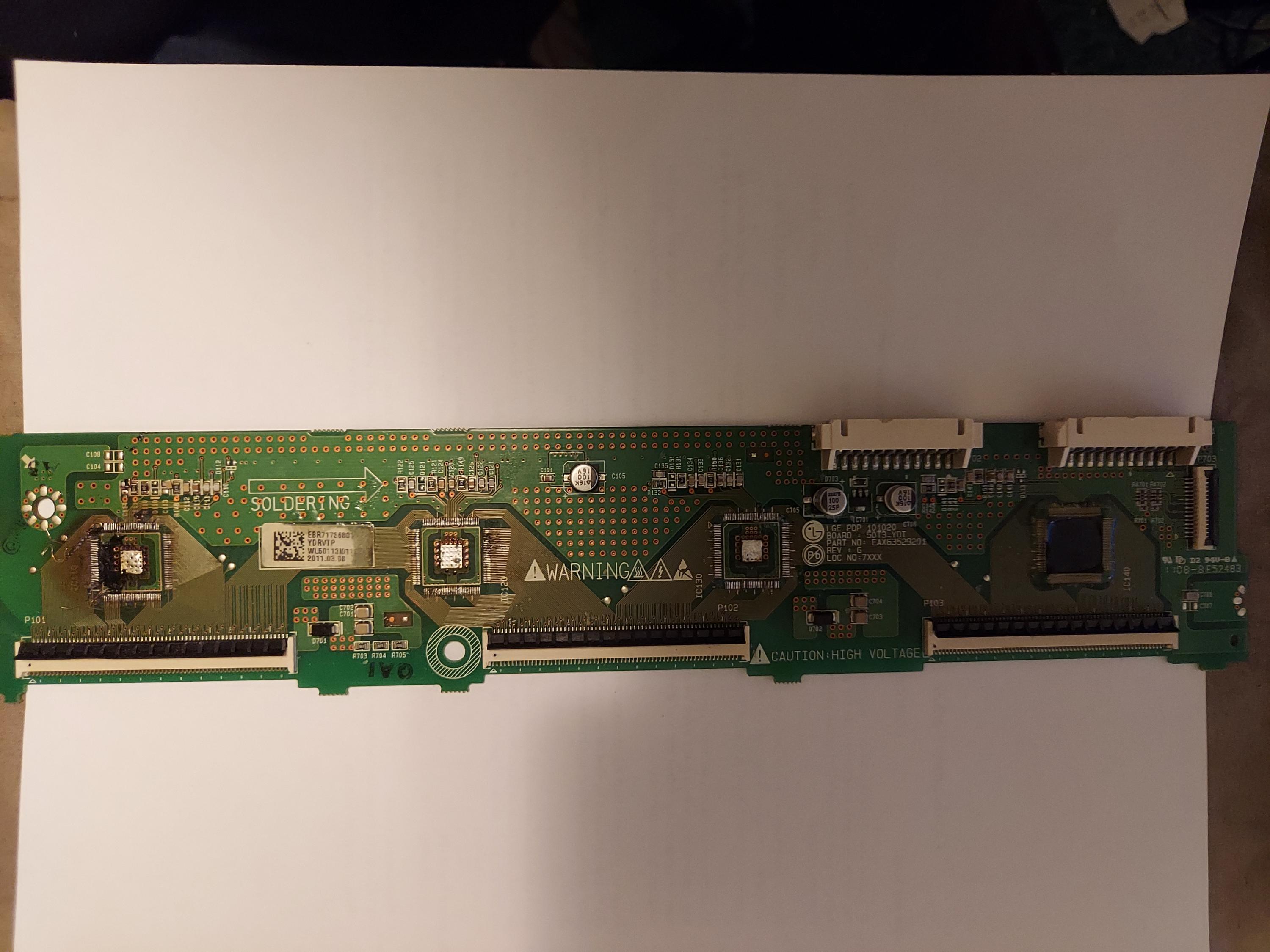

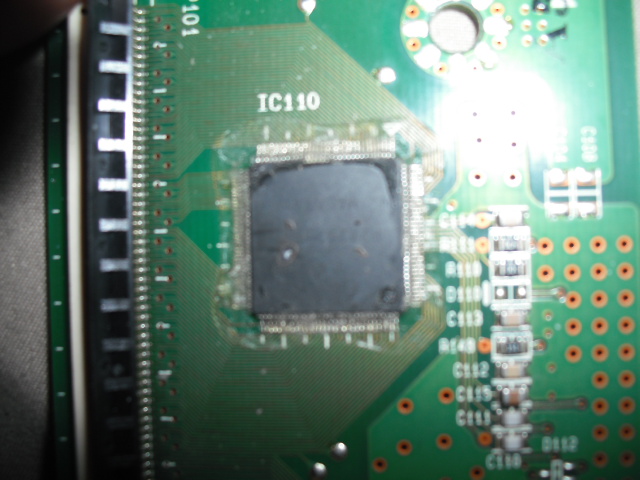

    This is the upper video buffer board interconnected to the Y board and plasma ribbon connector. My question is on my board IC 110 blew up and I'm not finding anyone who has a complete board in stock. I have googled all the chips numbers and don't see any datasheets or information on this chip.
    I'll attach a closeup of the chip below.

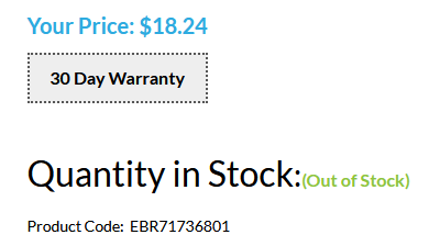

    Could this be what you're looking for?
    https://www.tvpartstoday.com/EBR7173...br71736801.htm
    I found it by googling the thread title with quotes around the serial number, since quotes specify that the search results MUST have that phrase in them.

      Re: Lg ebr71736801
      Yes , I found that site as well they don't have any boards in stock and I am assuming that my hot air rework station can lift this chip and I can put a new one down using a flux pen and a good solder cup.

        Re: Lg ebr71736801
        The IC may well have the underide soldered to the circuit board which makes removal a little more tricky, not impossible.
        What was the chip number?

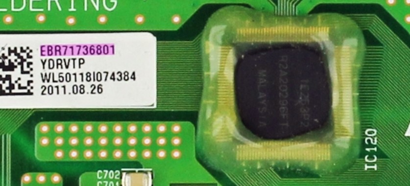

            Re: Lg ebr71736801
            From reading the various threads on this site it appears to be a good idea to preheat the underside of the IC to between 100 - 120 deg C prior to heating the iC itself
            1. to stop the board from warping
            2. to help remove the IC more easily if its base is soldered to the board.
            The IC looks like RA20296FT and are available on Ebay

              Re: Lg ebr71736801
              Yes I found it by placing the chip flat on my flatbed scanner and setting the scan to 2400 DPI resolution. It is indeed a R2A20296FT and it ranges in price from $1.50 to $3.84 plus shipping. I have a very good Hako FR-801 with the correct adapter for removing this chip. It has an automatic vacuum suction cup that will remove the IC in about 5 seconds and then will cool the pads not to risk damage to the board. From past experience all the pads will need to be vacuumed with a de-soldering hand piece and cleaned with alcohol prior to fluxing the board for rework.
              Thanks For verifying IC 110.
              As a safety issue I am going to verify none of the other IC's are shorted out.
              At this price it is much more economical to repair than replace. I will also check the lower Y buffer board for shorts.
